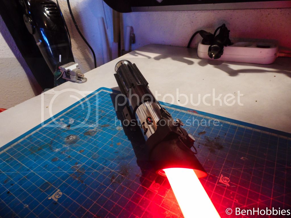

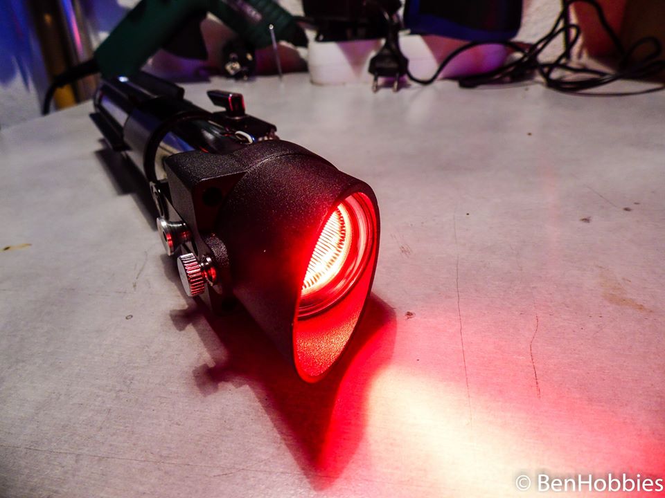

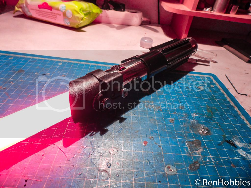

So my Anh / Esb Mpp hybrid needed an update before Rogue One:
New Specs:
- Old Parks Mpp replica hilt
- Graflex 2.0 Korbanth grips
- Red, brow, white and blue cosmectic wires
- Custom 1 inch blade holder using original pars
- Custom blade plug using original parts too
- Two parts retention system, setscrew underneath and spring greeble on the top
- Metal shroud
- Hidden main and aux switches
- 3 cree xpe2 R/G/Rb
- Copper heatsink
- Full 3D printed chassis
- HC-06 bluetooth board for wireless RICE, wired but not working yet
- Plecter Labs Cex
- Plecter Labs Prizm 4.0
- Solo's Hold 18650 3.7 volt panasonic 3200mAH
- 2W 28mm 4ohms bass speaker

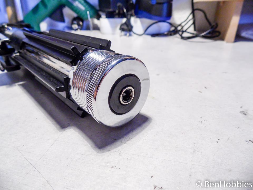

- Switchcraft 2.1mm recharge port
- Ptfe Mil Spec wires thanks to Darth Alice Sabers to inform us about that moths ago
- Slight weathering with oils, pastels and flat black powder, no clear coat
- Fake crystal chamber with red and orange leds
- Original front openings concealed sound vents

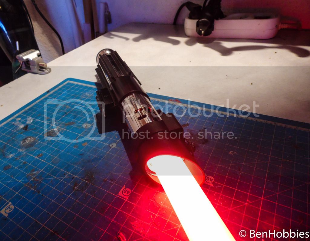

The blade in the video is not the final one my buddy Tyler Saathoff is making one for it.

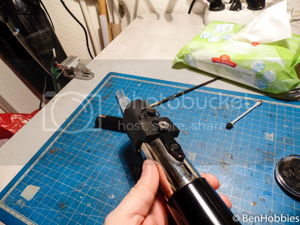

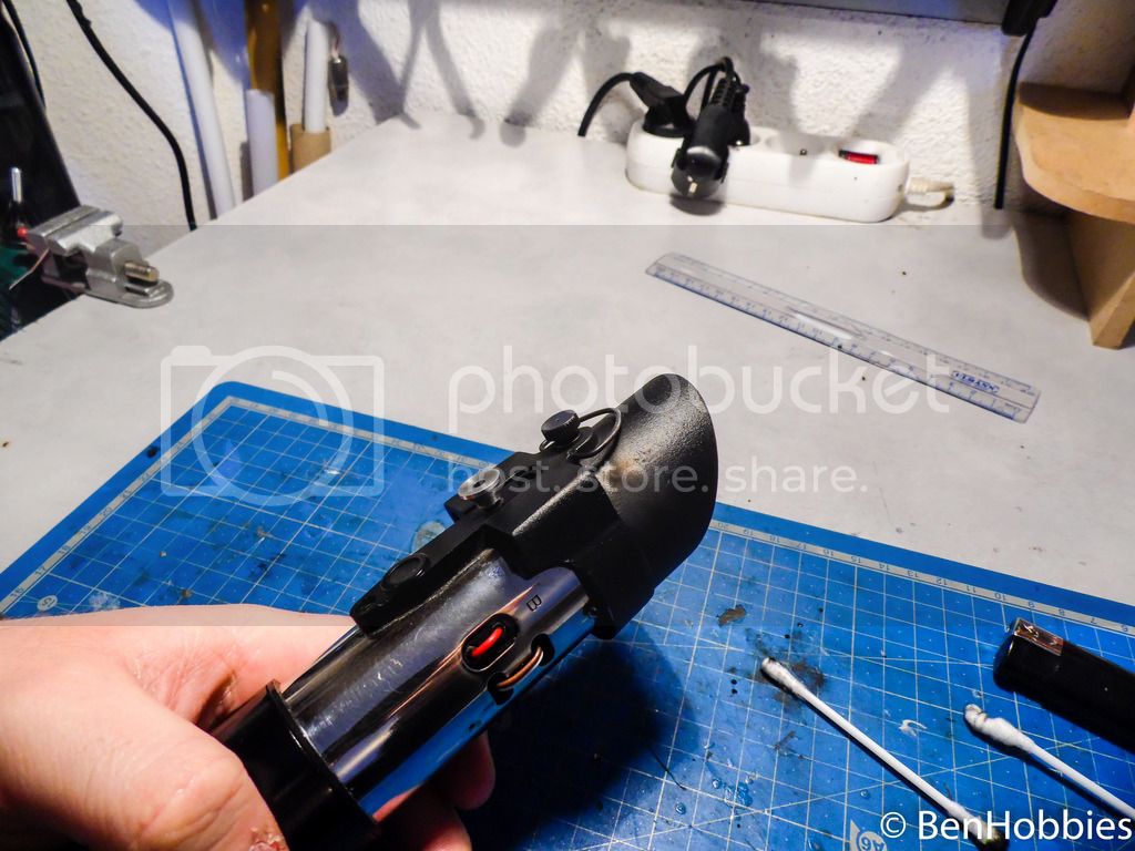

So I tacle the last think I hesitate to do, adding a d-ring on my Vader :thumbsup
Tiny space here but I managed to drill a 2mm hole and mount a modified d-ring into it :rolleyes
I know this one is not that accurate but its the only size I found that can fit in and still some mods to do :wacko
The point here is more to have one to be abble to wear the saber when my armor will be complete than to be super accurate. Weathered to fit the rest of the saber ect :cheers

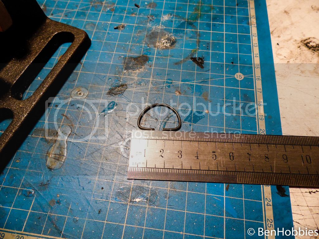

This type of D-ring is to big in diameter to fit BUT mine looked realy too tiny after you showed me this one :lol
Looking through my other models and boxes of stuff I found nothing else fitting :cry
I was going to shearch again on the internet when my lovely wife just recal she have some steel 2mm wire in stock, I love my wife :love
This is perfect for this application and its steel not stainless steel and you know what that mean? Yeah RUST, love me some rust on Vader saber :love
Just weathered with oils and pigment but soon the rust will add naturaly to it :lol
Here is how I done it, pretty simple in fact :rolleyes
Yeah I broke a tiny bit of the shroud on one of the holes spot :eek
But you know its happen when I was extracting the previous D-ring, something that Vader himelf or the person in charge of his weapon could have done or that just could happend after years of use through the galaxy :rolleyes
So even If I have 2 left over shrouds, one other metal and one plastic, I choose to let it that way, love me some real weathering :love
Now I'm completely pleased with this D-ring

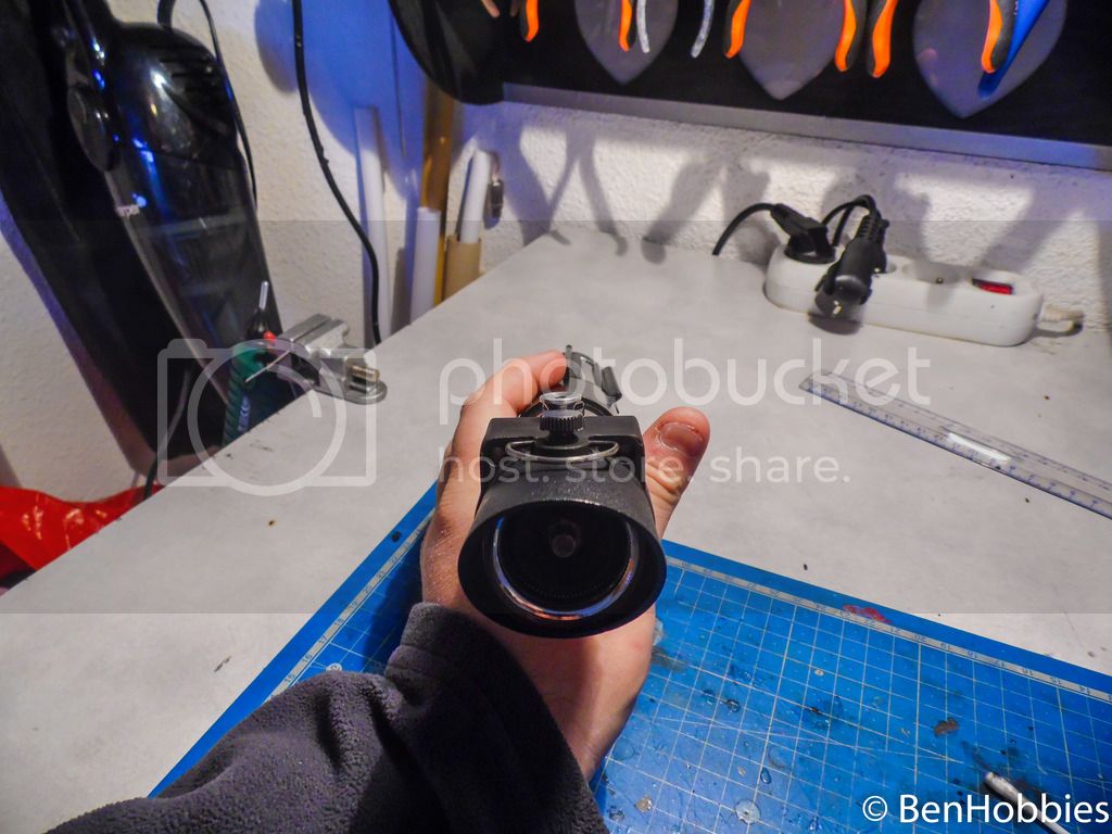

Hum yeah I did another one :lol
Going back to what Sym-Cha said to me about the Kobold D-ring given the fact it will not fit with this shroud I decide to copied it with the steel 1.8 wire that fit perfectly :thumbsup
And I'm glad I did it, this one is the one, I will keep it that way, thanks again Sym-Cha :$
Now onto fine tune the weathering in this area again :lol

After the last sound font I want to add on the board will be load on the sd card I will not need to unscrew the pommel often ;)
Actualy I will not need to open it at all exept in case of internal problem but its realy unlikely, so soon I will add full lenght grips soon ;)

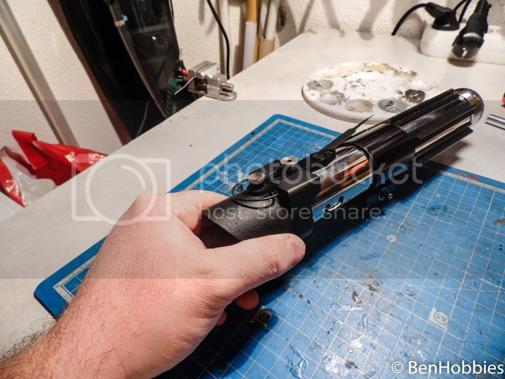

Actually I think your first custom D-ring looked better being a bit smaller than the ESB Kobold clip ... here's mine, just a bit to roundish, yet on a real MPP :
And here's the actual prop though from ROTJ ... see it's smaller than your last attempt?
Though it maybe the width 1.8 you used is what throws me off ... my D's are larger in width . . . and more shiny :wacko
Chaïm

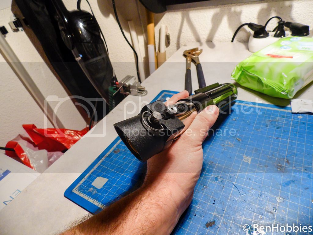

You were right about that, you were right... *Dying Vader voice*
That didn't jump to my eyes at first but now I see it, its definitely to big :facepalm
So I have done another one smaller like the previous one and more neat this time :rolleyes
Its definitely better now :love Not shinny I know but the red blade is.... :cool
