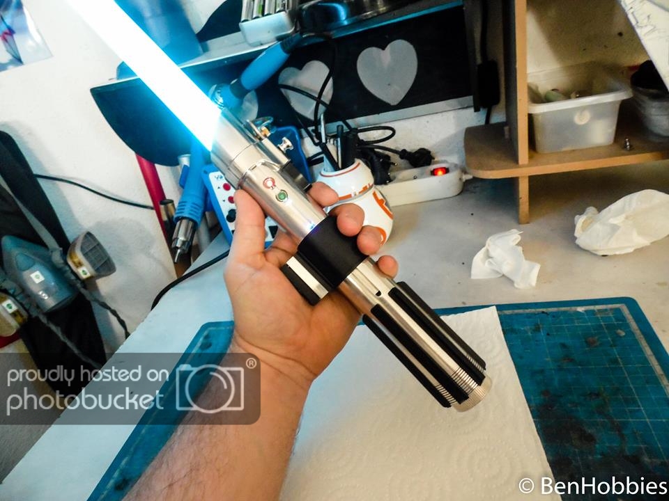

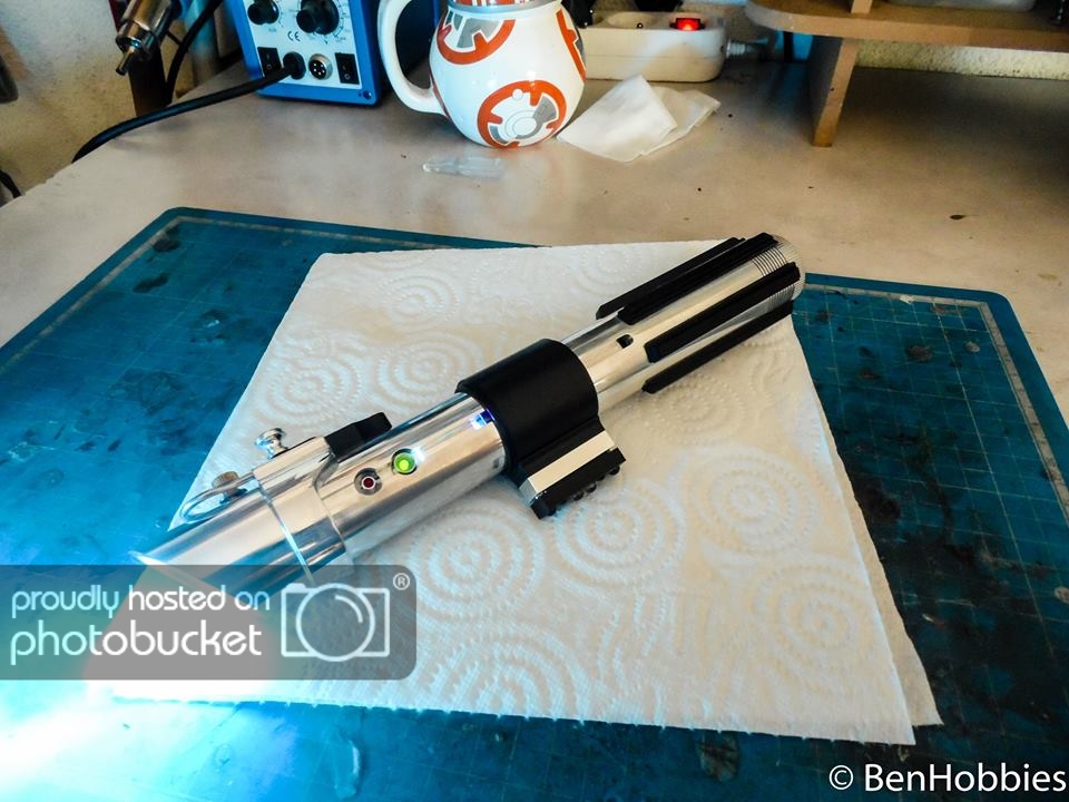

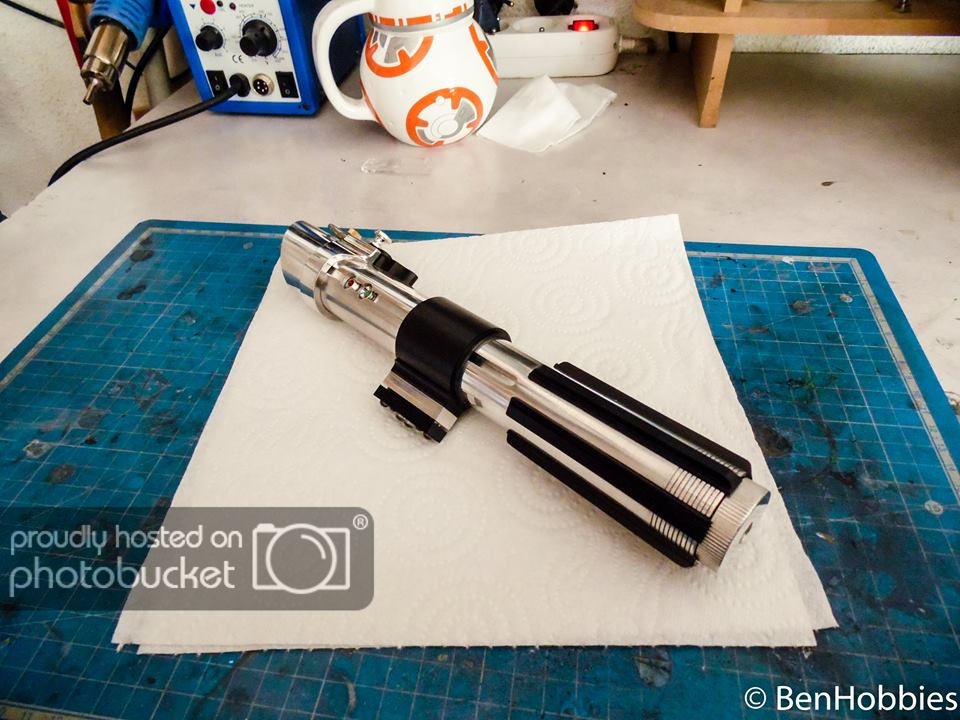

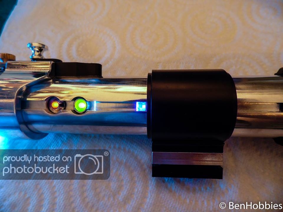

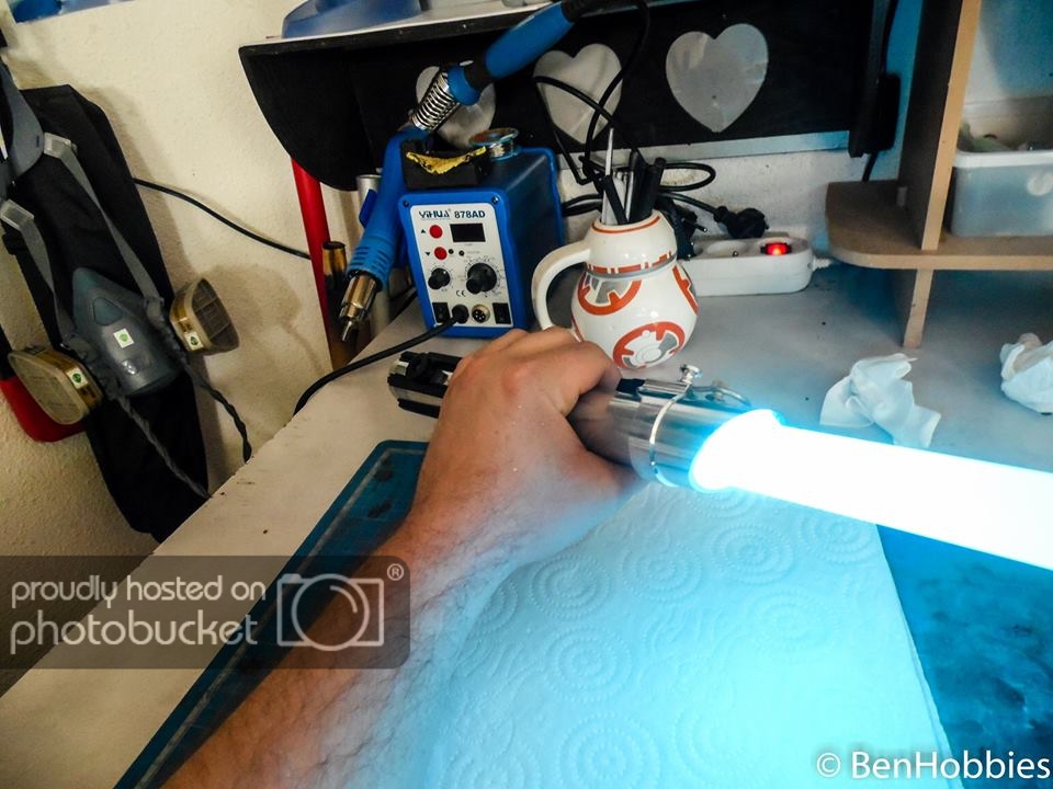

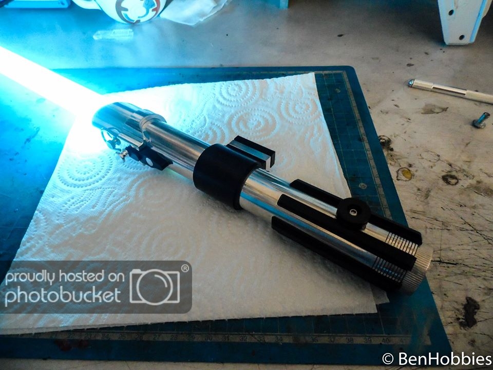

Specs :)
- TridCloudWalker Ani Aotc kit, remachined
- 3 cree BBB
- TCSS moded led module
- Working red and green accents leds
- Custom machined delrin, brass, steel, alluminium and chrome plated brass
- Genuine quartz crystal
- 5mm blue led
- Two tacliles hight quality switches, brass hat
- Control box leds act and aux switches
- Custom delrin chassis parts to work with the heavely modded central core
- Prizm v4 by Plecter Labs
- 2.1mm switchcraft recharge port
- 28mm 2w bass speaker
- 30awg ptfe teflon coated wires
- 2 parts custom machined bladeplug
- Push cap pommel, thanks to Scott Juarez again to have came up with the idea in the first place
Pics :)
Video demo :)
MTFWYA :$:$:$
