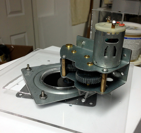

Jason, I have some questions, if it isn't too difficult to answer or point me in the right direction for answers.
Is any of that equipment from an RC tank kit? I notice that you made a simple sliding lever mechanism using a servo for the recoil movement. Can you point towards anything useful in understanding how to program all of that? I'm not quite sure where to start learning how to make that. I assume the recoil, sound, remote and elevation controls might be taken from a tank kit, but I don't think you did it that way.
Just looked online. I'm thinking the thousand bucks for most tamiya RC tanks might be a deterrent.
Thanks for showing the mechanism! It helps a lot just to see that much. Great stuff!
So it's looking like what I got is going to work, so this might answer your questions. Expect to spend around $400 or so:
I got the following from Curtis at Immortal Hobbies: info@immortalhobbies.com - he could help you get the same thing (tell him I sent you):
Clark TK22 board (customized by the maker to include the sound effects)
Turnigy 9X radio
Battery
Gearbox from a tank (this provides rotation)
Speaker
Receiver
From Tower Hobbies I had to get:
Hitec HS-755HB Giant Scale Karbonite Gear 2BB Servo (I got two - one for recoil and one for elevation)
Duratrax Onyx 210 AC/DC Peak Charger w/LCD
I also got a single pole switch for on/off, and I had to get a Potentiometer as well:
10K Ohm Potentiometer: Amazon.com: Industrial & Scientific
Ah, ok. Thanks. And to make it all do what you need it to do, does it require using a computer to talk to it somehow? A mac hopefully?!

No - you just plug it all in, swear some, make sure the radio is paired to the reciever, try again, and it works... But seriously - out of the box it should all work (you're paying Clark for the programming!)
When it's all done, I'll label a pic so you can follow along.
Ah cool! Plug and play is nice! Thanks.

Lasercutting some mockups for the rotation rig...
