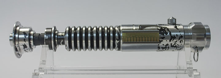

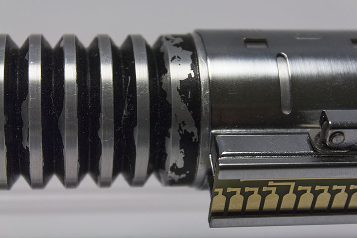

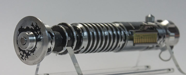

Thanks guys! The masking fluid can be tricky to use on something like smooth metal. It takes some getting used to. I wouldn't recommend it if you're looking to replicate every shape of the weathering perfectly... it just won't cooperate enough. That being said, the end result looks so much like real chipping paint, you just have to know what to expect.
Some parts of my saber are done this way (emitter, rings/body, all the corners/edges). Basically I just made crude stencils myself for the areas that were flat cylinders.
It´s often used by kit modellers, they handle tasks that are (due to smaller scales) often much more difficile than what prop builders are confronted with.
Readily available templates are great, but usually you get "one of a dozen" results only, nothing bad with that but working with masking fluid (while it needs more patience and practice) can bring much more impressive (and individual) results.
when you guys are saying "masking fluid" are you referring to something like liquid latex?
I tried some in painting my creepy uncle and it was infuriating. Honestly, rubber cement would have worked better on metal I think.
Yes, its a liquid latex originally intended for masking parts of a canvas when painting. I first used it following a tutorial for painting my Boba Fett helmet, which it work fabulously on. But that was porous resin/plastic, which it stuck very well to, and I was able to follow the drawn on lines very easily. On this shiny metal, it very much wanted to bead up and stick to itself more than the surface. Very much a lesson in patience.
As I said, if I were going for less accurate, but more random and genuine looking, I'd do it again.

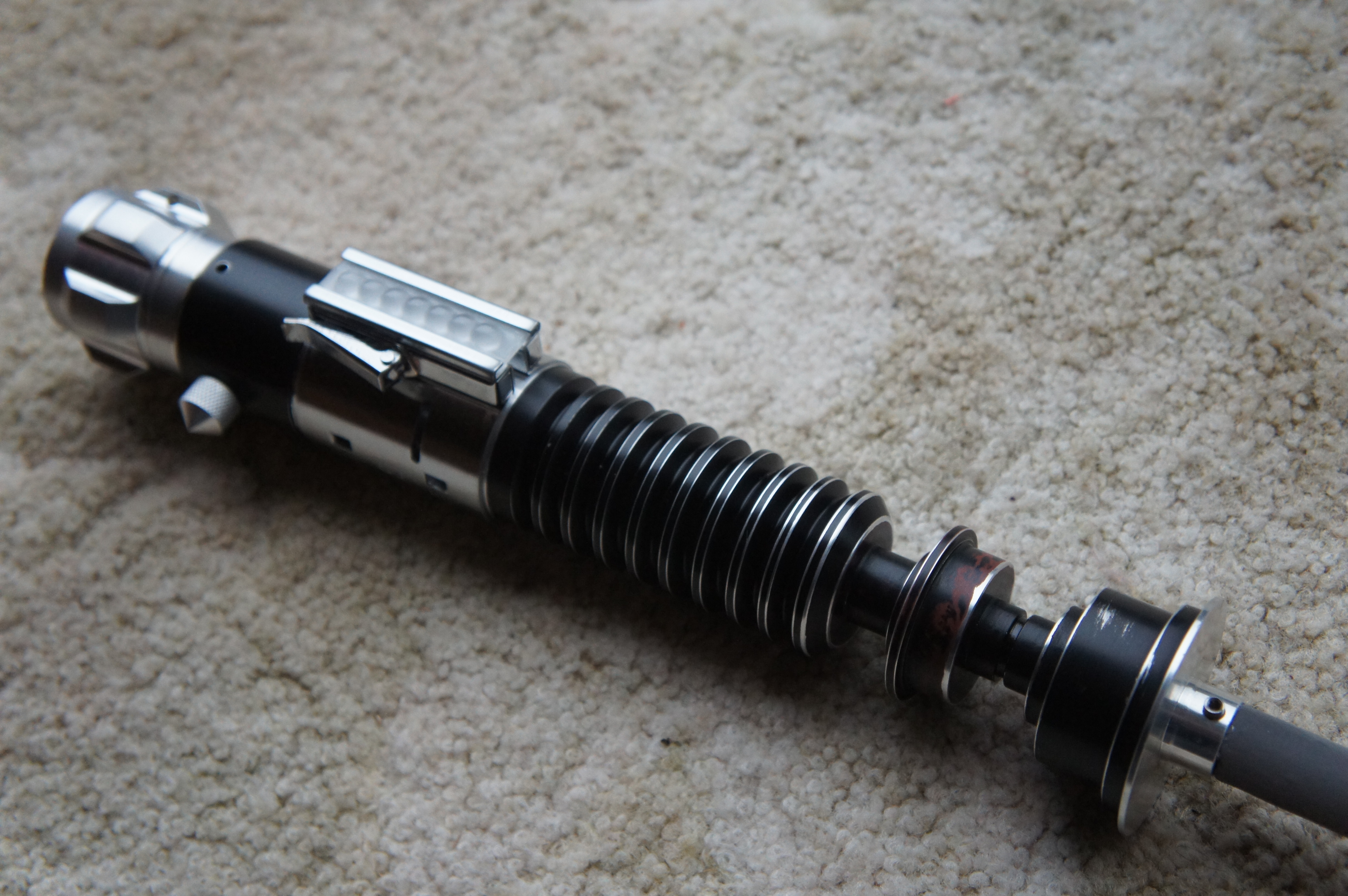

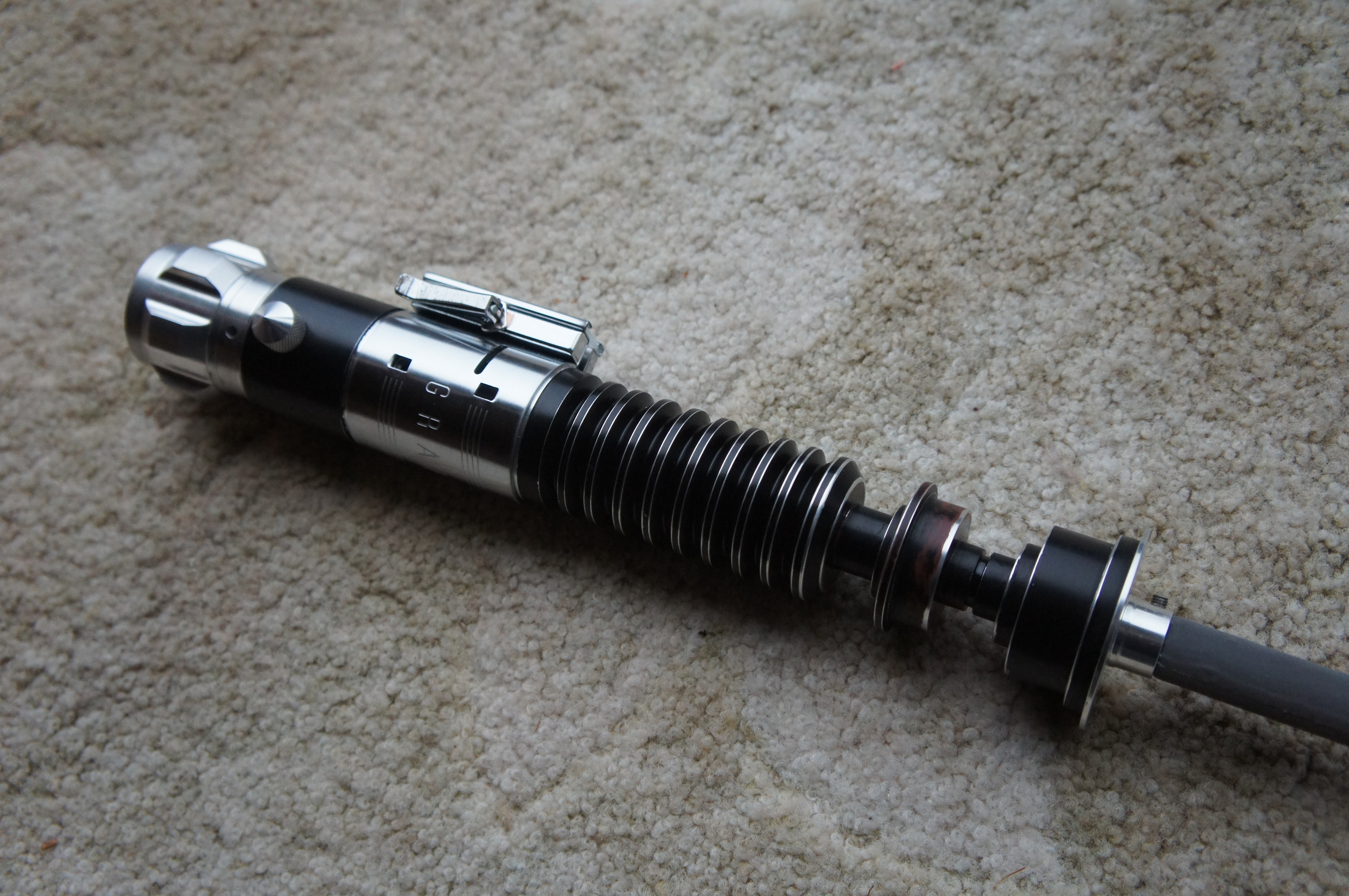

Hey - do I get to show off too? (Solo's Hold).
Sorry to tell you but Solo's hold V2's are supplied unpainted & have no blade. I painted this one & made the reflective blade. The red bit has photographed a bit too red , it's red iron oxide primer that I sanded back to once I'd sprayed the black. This isn't a 'copy' of any screen seen one either, just how I wanted it. Thanks for the ego boost.
Can we say "late to the party"? I wanted to show this off while it was still relevant. I am signed up for the new run, and will make every attempt to make that saber as 100% screen accurate as possible. Once I had signed up for the new one, I took accuracy on this a little less seriously and just had fun and instant gratification. You can see in the third pic, where I used masking fluid instead of a "stencil", and just eyeballed shapes from photos. While the shaping may not be very accurate, you can see how genuine the paint chipping comes out looking this way.
