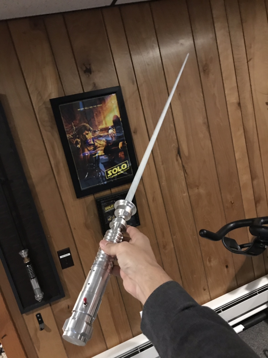

the rod and motor set-up look very professional.
Thanks Tom. Really appreciate it, can’t say it’s professional. I’ve just been fooling around with this for a long time
Gone threw many different versions. Even a aluminum drive shaft, carbon drive shaft...
Last night I was showing trent me new bushing setup, changed a few things around
Saturday can’t come soon enough...
Jedi WeedWacker!
It’s loud as hell, need to tweak the speed controller
With the blade on it spins slower and more accurate and with that it is much quieter

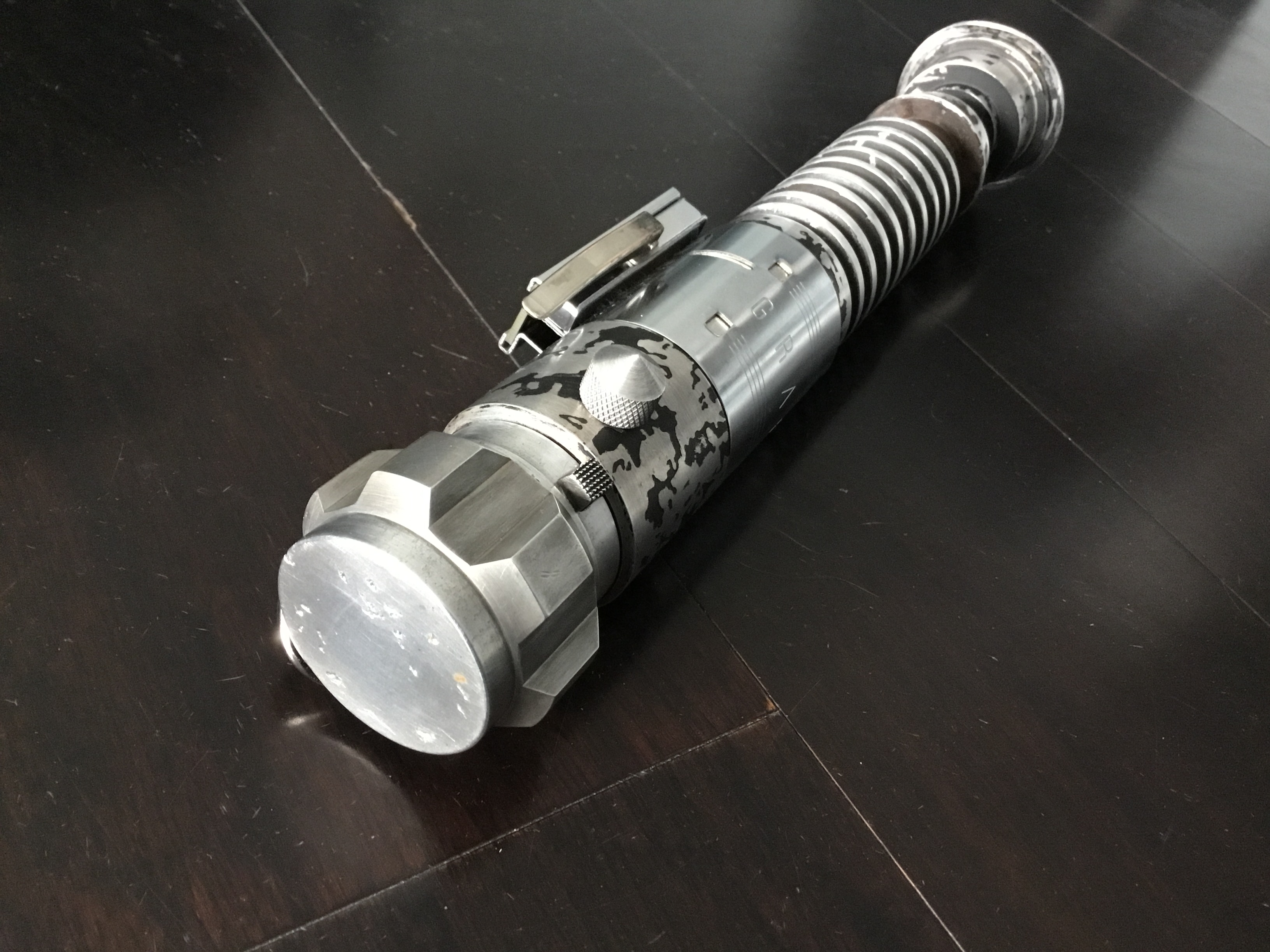

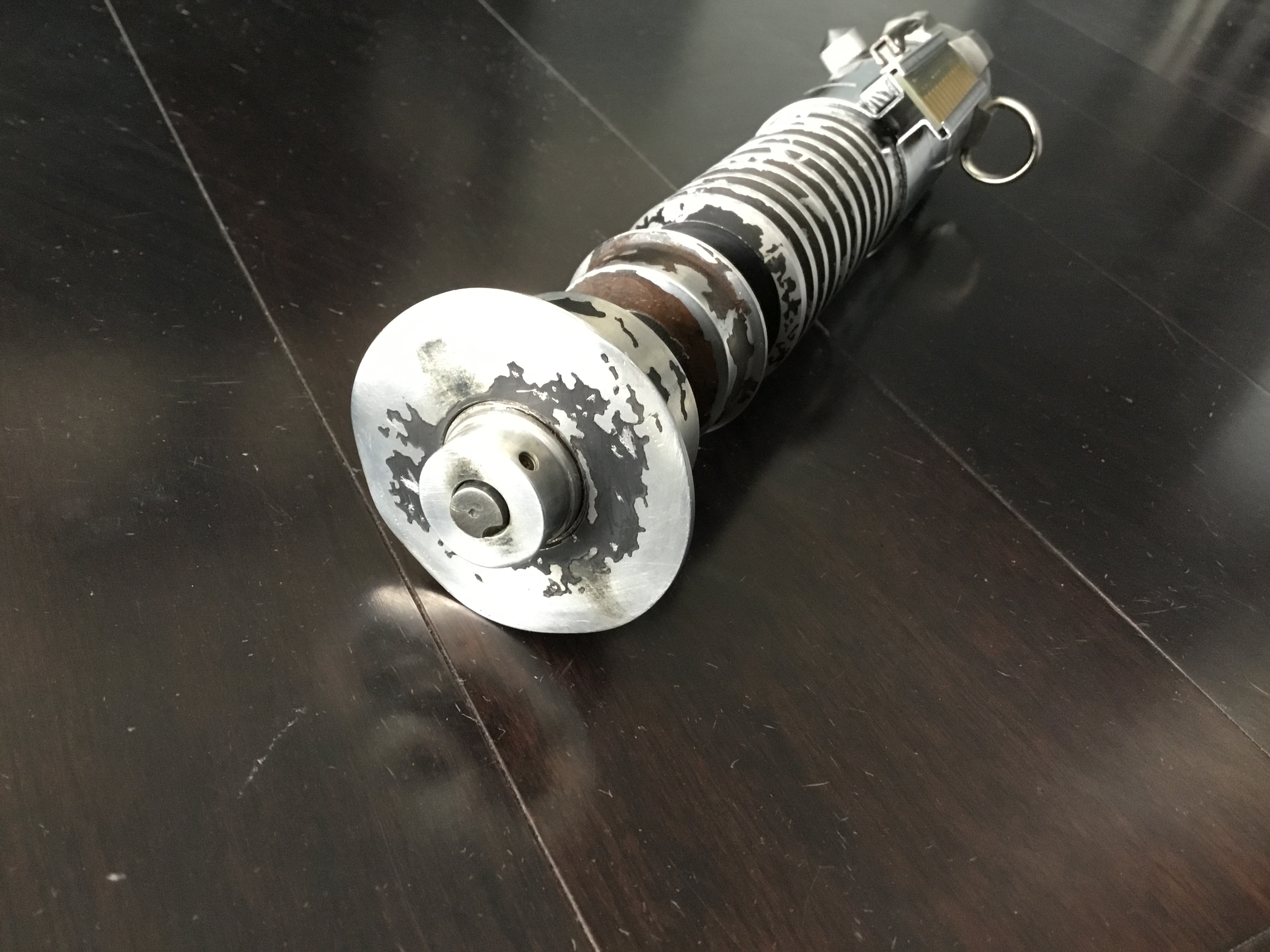

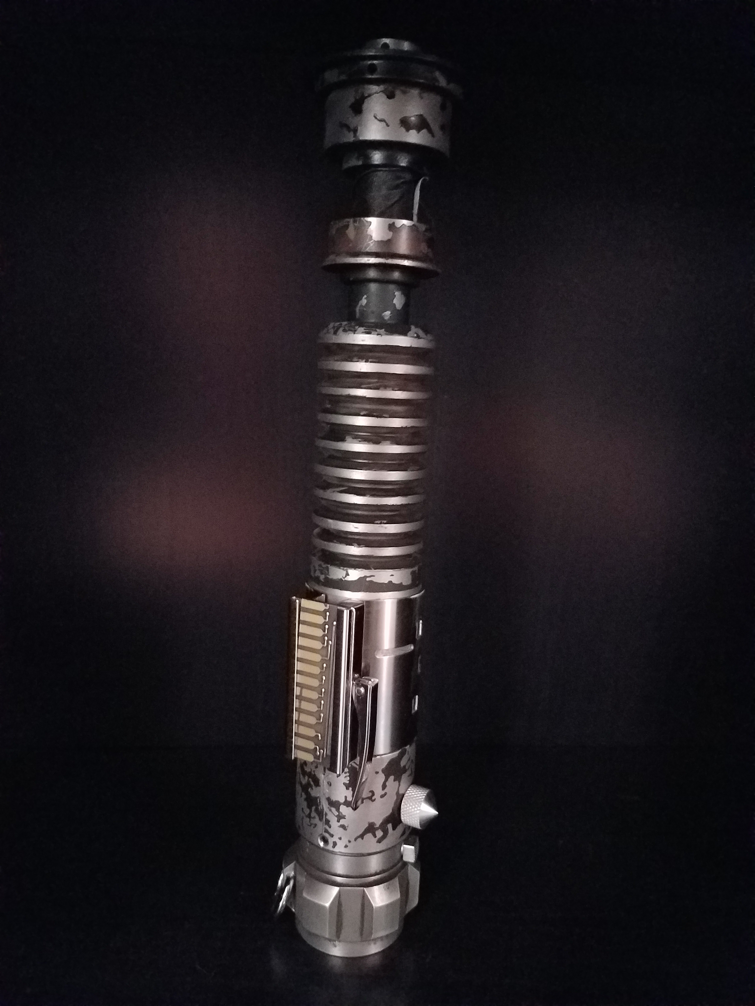

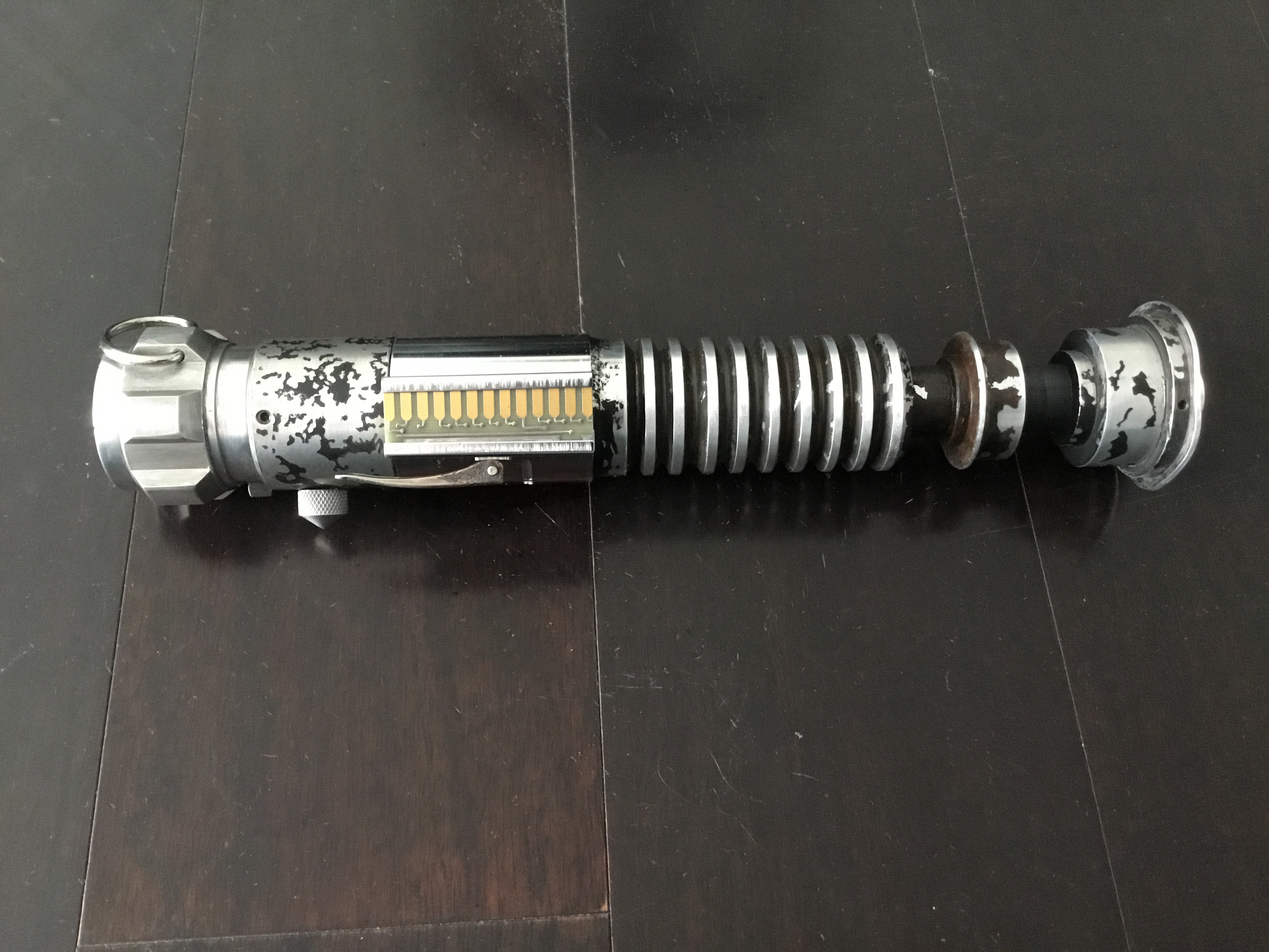

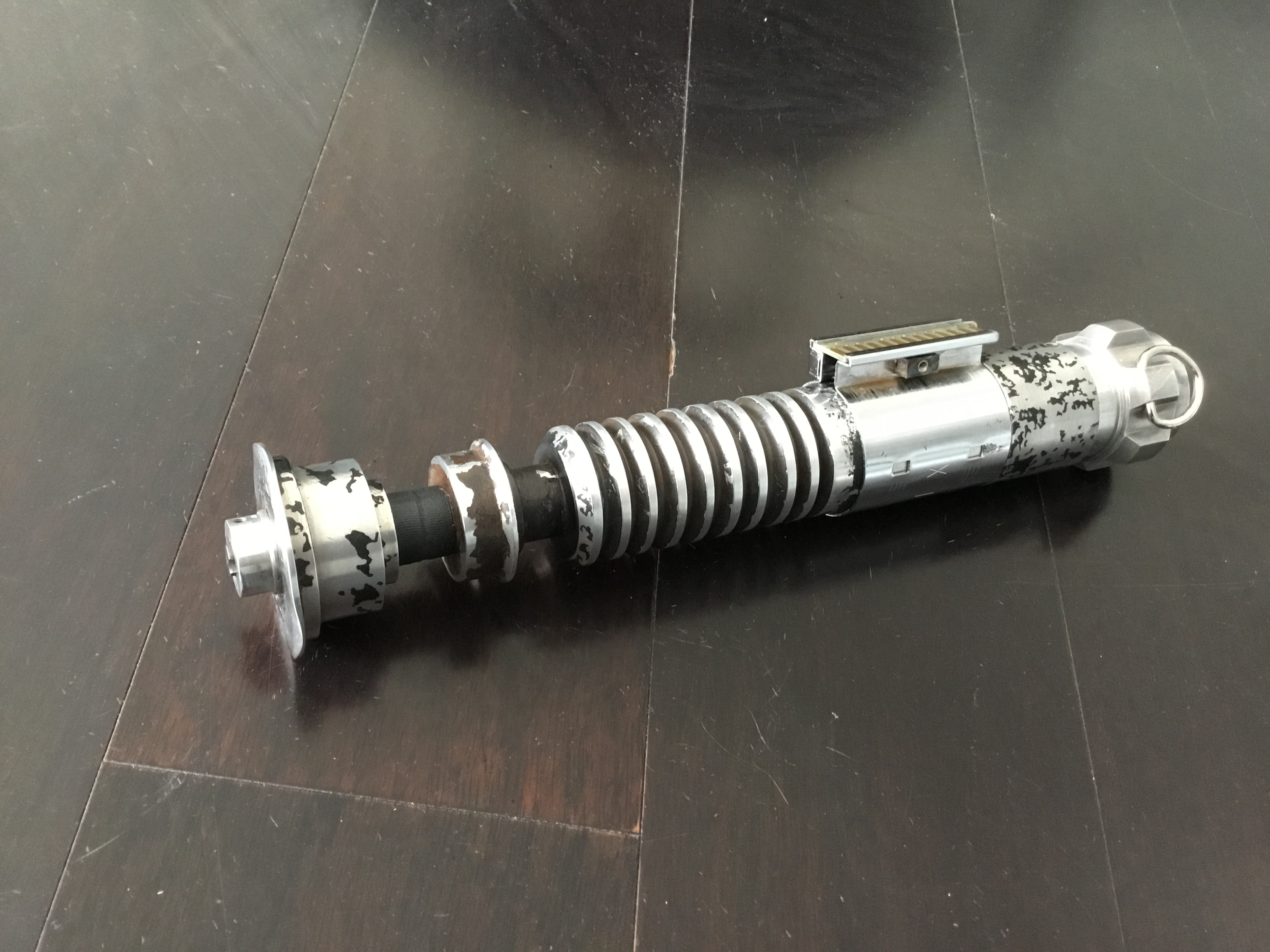

I have finished mine. I got off to a rocky start (thanks Starkiller for the bail-out) but am pleased with the results. This kit was amazing, and the Halliwax videos, and Trooper Trent's stencils made it a blast to do!! This project was a great time seeing the community pull together with so much info and help.

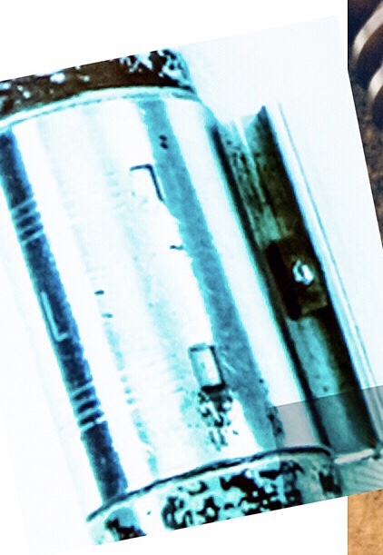

The flash and lighting make the ring weathering appear to brown, I may address it at a later date after I have lived with it for a while.
big thumbs up there buddy! she looks great!! if you want you can lightly file the top of the cone knob. seems that she isn't that sharp anymore. but its totally up to you.

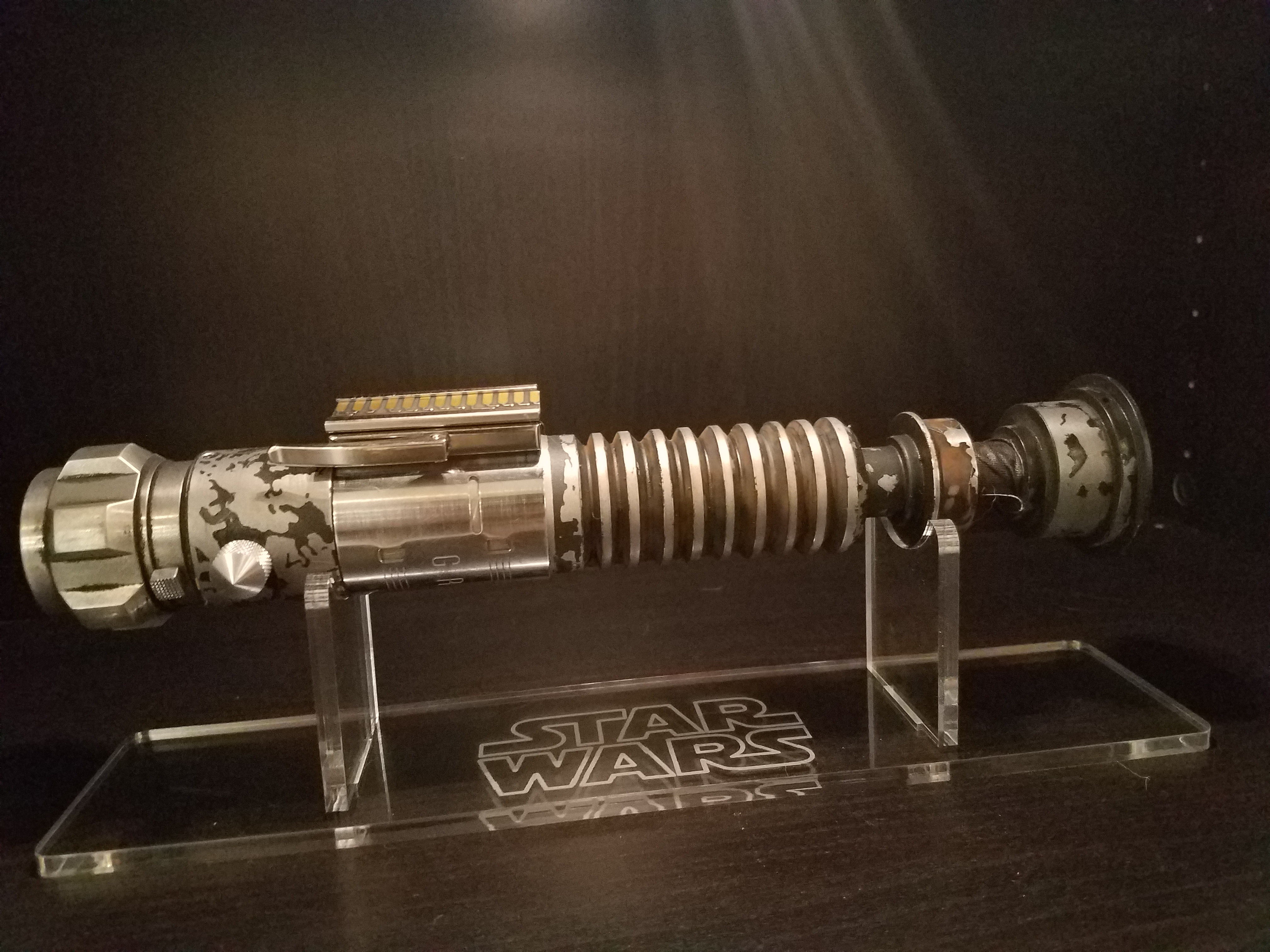

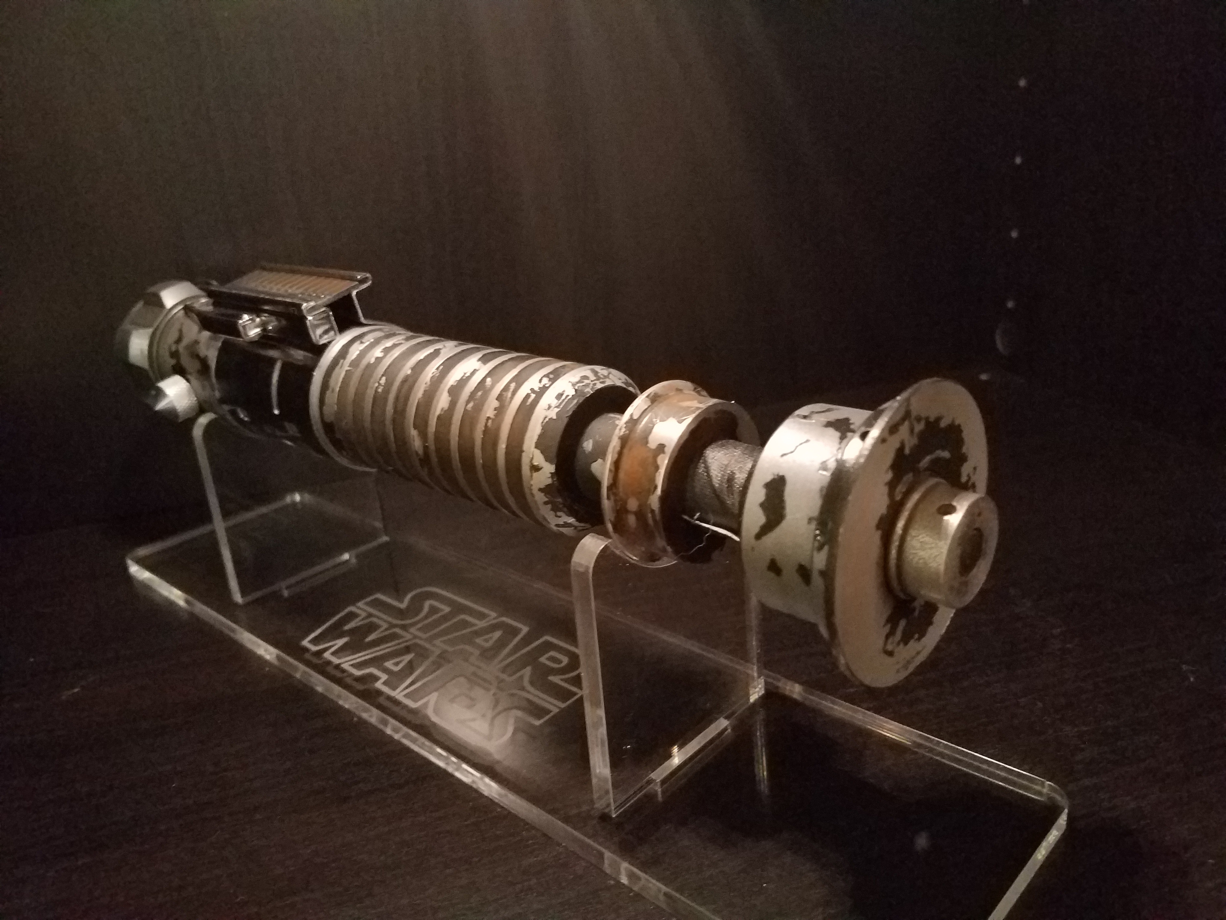

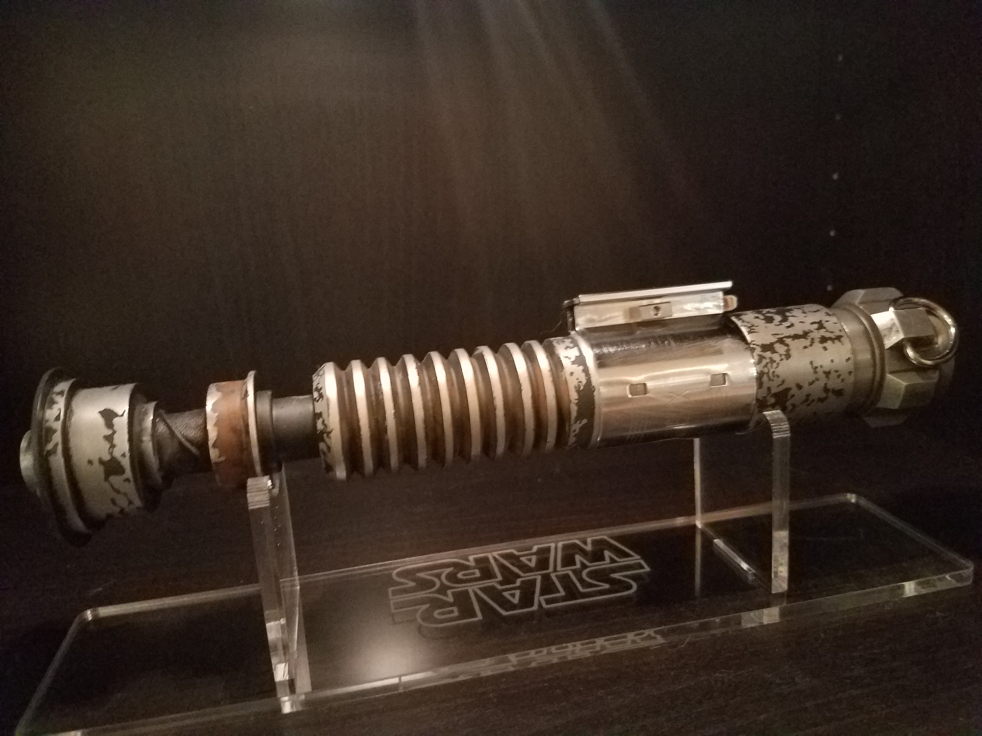

My V2 is finally done! Finally scratched that clamp itch!
I’ll get some photos when there’s daylight! Thanks to everyone who helped make this possible!
