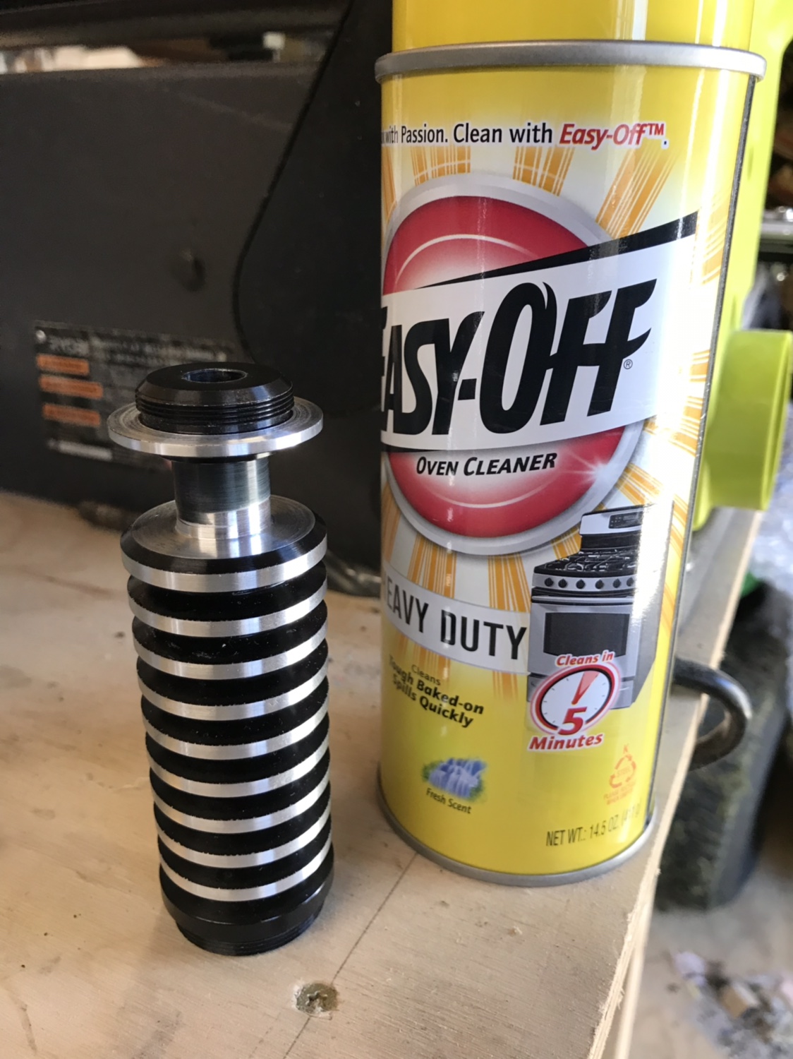

Anyone have any experience in using oven cleaner to remove anodizing? I think I'm going to try and attempt to do that on my KR V2 today :unsure
Re: Anakin Starkiller FX V2 - Aging Weathering & Stencil Tutorial
That’s what I use all the time, and of course you ask this the day after I backed up/ transferred all my pics on my phone lol
https://youtu.be/bdkrYgCARlw
Here’s a old video of me using oven clean to remove the anodizing on my praco flash
I used the same trick on my romans balance v4 (halliwax’s creepy uncle edition)
I put it in a soup can, and let it soak, then scrub with a old tooth brush, comes off with ease
