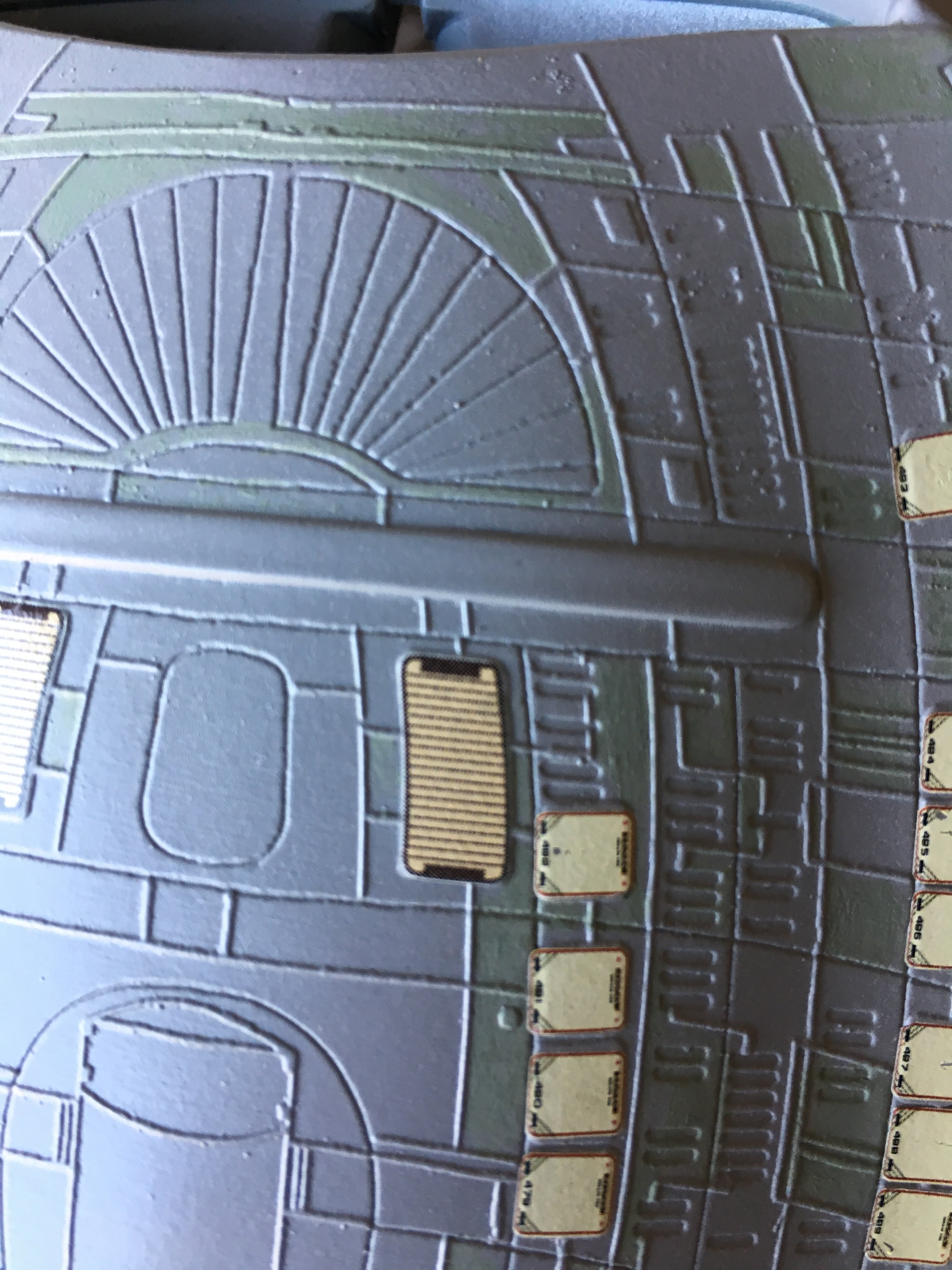

Not sure what you're asking. Which transporter emitter? Both look correct for their respective locations.
Is that what the gold rectangles are!? LOL...
Was going to use the after-market set, but damaged one.
The version with the heavier black lines is the original kit decal. The more "plain" one is the after-market set

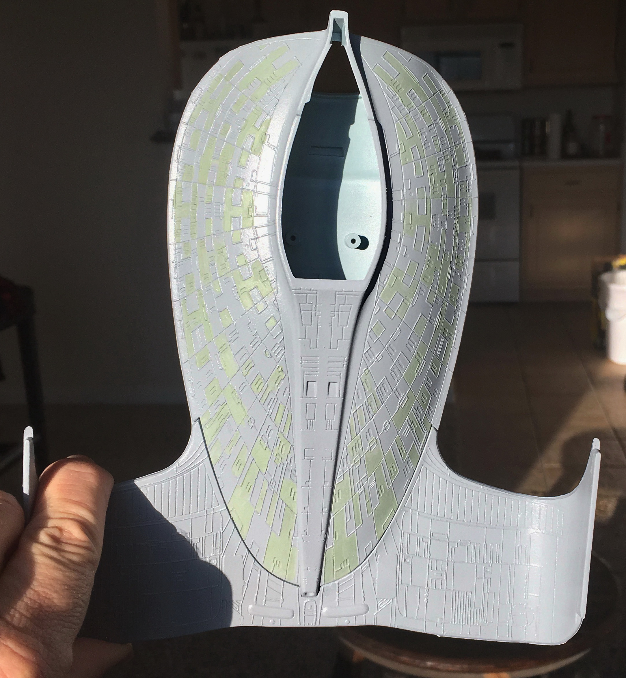

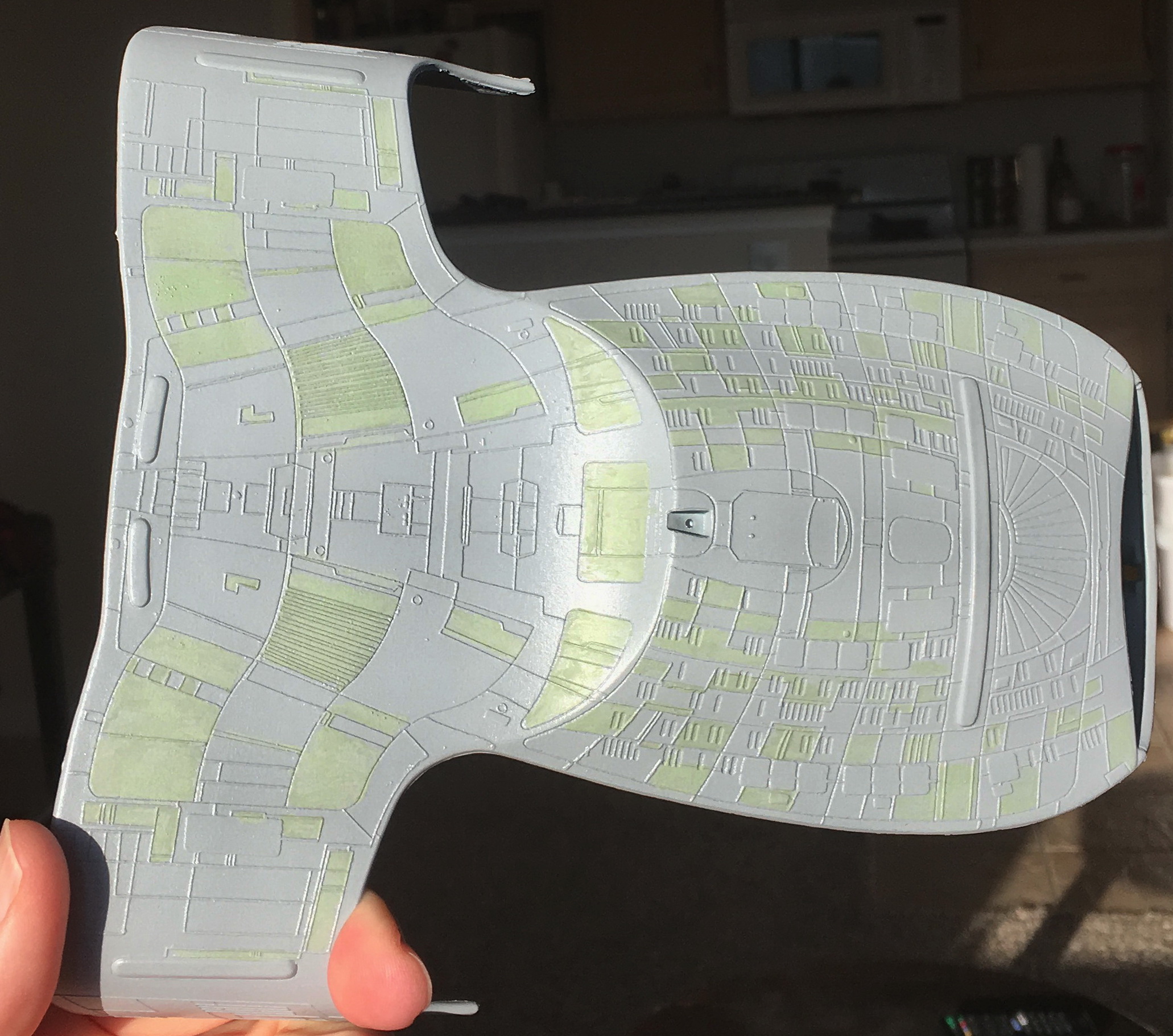

Personal preference. The kit has way too exaggerated surface detail. I've spent ages sanding and filing off raised aztek color separation lines -- that are misaligned anyway, transporter emitters, escape pods, adding, filling, and reshaping windows... I frisketed each segment as bounded by engraved shield lines, phaser strips, and window cutouts and traced the emitters and pods before flattening everything. I like the series version of the lifeboat covers better than Generations -- a little height. A square hole punch the right size and some cardstock and boom. But the transporter emitters are conformal. The only significant surface detailing is the power transfer conduit covers on the fantail top. Decals are more accurate than photoetch, there, and I prefer JT's aftermarket decals to those supplied with the kit.

I ended up using the original kit decals for all four transporter emitters on the ventral surface, since I had to use two already. Vote is still out for the remainder.
Torn on the lifeboat hatches. The after-market decals have the additional markings and numbering from the Generations version, but my model will largely represent the opening credits model.
