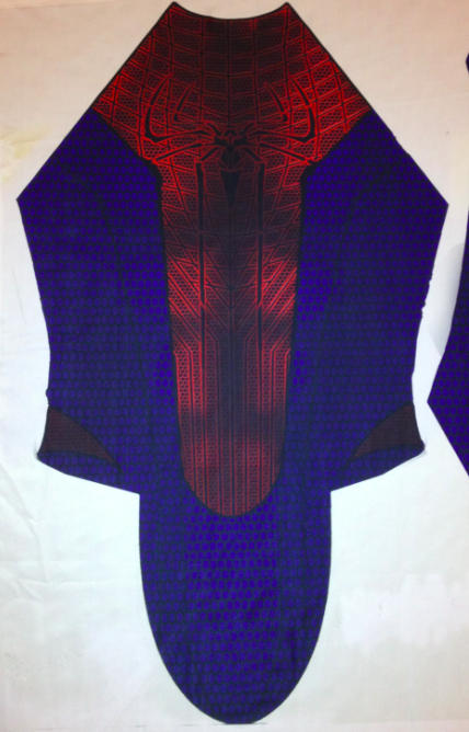

Alright I'm at the crossroads.
Do I hunt down a seamstress and get them sewn first?
Any Taylor will be obligated to say "uh oh ok sure I guess".
Or do I start Puffing?
I am concerned to give a heavier print with puff to a seamstress but I feel like I am wasting time not starting.
Also people are saying it needs to be stretched and worn a little before puffing.
So many tough instructions for a seamstress.
Make the web in the middle of the mask, 4 zippers and a belt flap. On and on. I have a mom and pop up the street but I am not sure they would take this as seriously as we do.
They are my only local option.
I feel like I am worrying too much about these prints but I've seen what can go wrong.
Also they were hard to come by.

I started puffing, without any stretch. I did a little bit of the chest, let it dry and did a stretch test.
Seemed to do ok. But I found a seamstress so I'm going to stop and have it sewn. Just waiting on the instructions. Then I'll puff again.
Sent from my DROID RAZR using Tapatalk 2

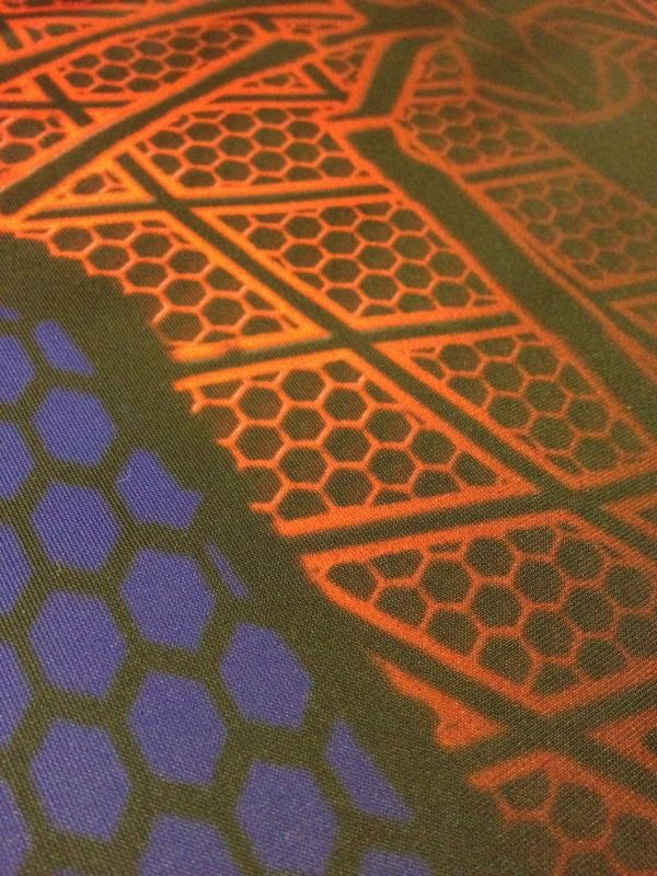

It's amazing how much the puffy adds.
The red looks fantastic.
With DGP's darker background these will be the cats pajamas.
i received my print from DGP, looks good. My plan is to get it sewn first then put it on a mannequin and puff paint. Im taking my time and not rushing I am not trying to get it done by this halloween. still excited !
detail is great
The suit does look dark in pics but looks absolutely perfect in person. Paul shipped this extremely fast and I am very satisfied. Would recommend to anyone. I am not rushing this so I will not be completing this for a few months. As for puff painting before and after, I'm sure it would be easier to puff before but I don't know how much to stretch it out. And are there any sewing instructions anywhere
I've been wanting a comparison between Taylor's and DGP. Thank you for all the input and answers. Which fabric DGP or Taylor do you like better? I like how DGP is dark and useful for paint puff. But Taylor's is thicker and I would imagine thicker feels better?
