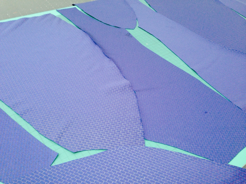

The blue and red bricks were printed, not the webs. I just don't think it's possible with how screen-printing is done to get that kind of thickness, unless you're screen printing many many layers.

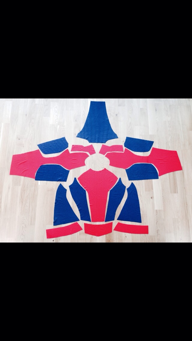

Something that nobody seems to be taking advantage of with Lunaman's photos is how obvious the seam lines are. The mask looks like it's very similar to McLean's shapes, and the shoulders are way different from the other patterns out there. And obviously, all the red and blue pieces are separate and then sewn together.

I counted around 39 individual screen printed pieces and that's not counting I between the fingers [emoji12]

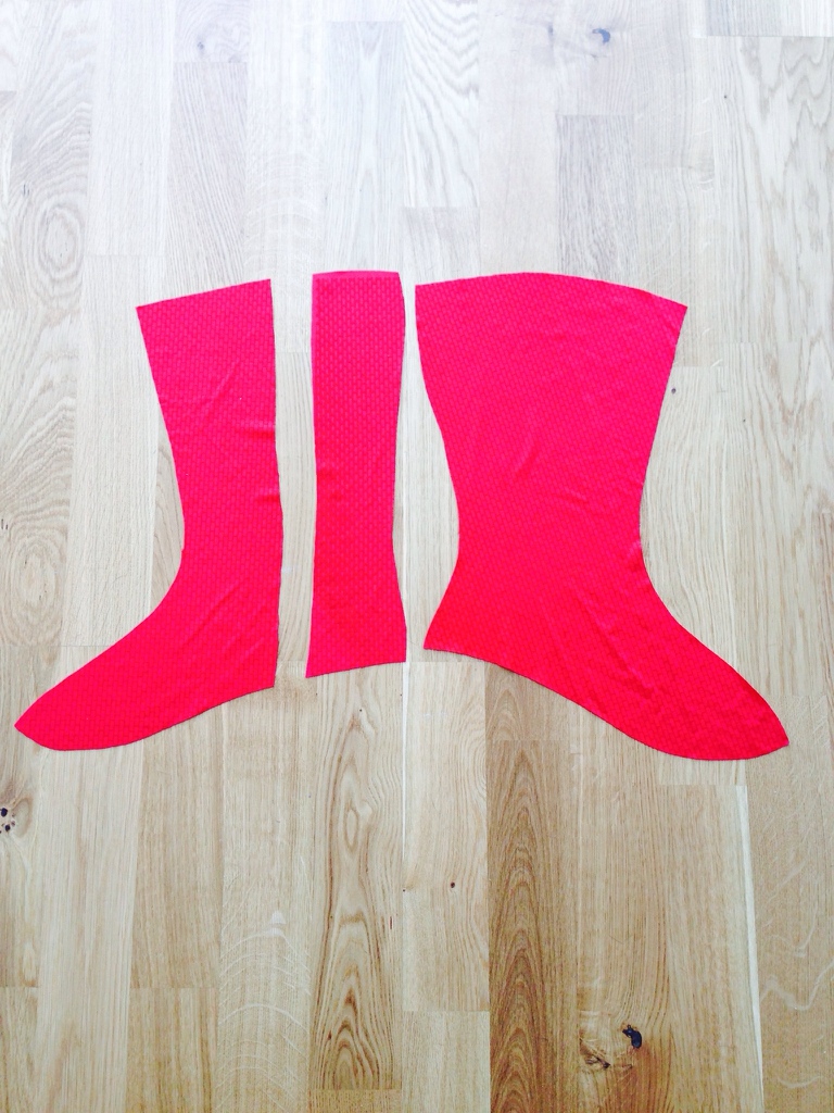

Your pelting looks very good, though I will point out that the front belt is only one piece, not three:
@Jake, it's entirely possible to screenprint webs that thick. The fact that the webs are uniformly bonded to the material and made of the same substance as the bricks on the blue portions of the pattern seems to indicate that they were screen printed.

Why do people believe that the webs aren't screen printed? None of the applique webs from the Raimi films ever adhered or aligned so perfectly, and you can see the subtle texture consistent with screen inks. There are several methods to screen print 3D texture. Puff additives, High-Density inks, puff plastisols, and silicone inks like the ones they used on the Superman/Man of Steel costume to make the chainmail. The silicone puff inks seem likely because they'd exceed the flexibility of the 4-way stretch fabric. I can't think of any reason to assume they used anything else for the webs or blue bricks - is there some documentation I haven't seen on the suit's construction that points to applied webs?
