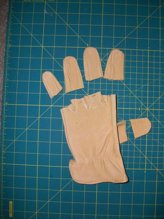

I did sort of cheat on the gloves. I got some leather gardening gloves and cut the fingers off:

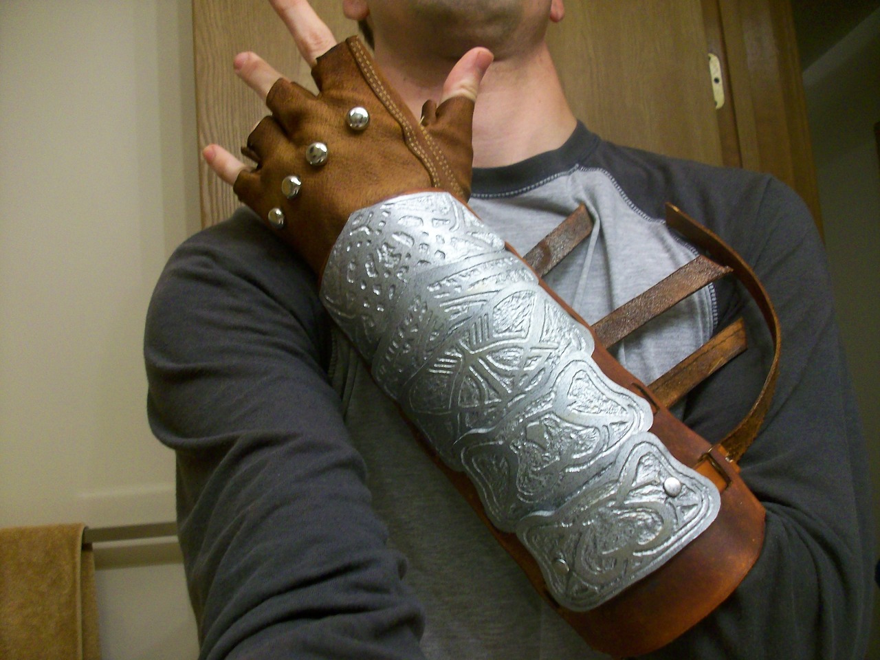

Finished right glove and the armor panels for the left vambrace. The pattern for the armor panels was drawn onto styrene plastic and then dremeled out by hand:

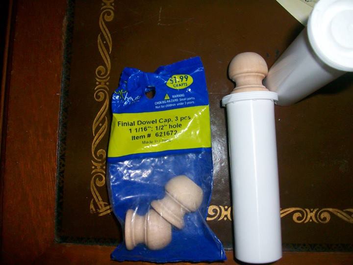

Had a bit of inspiration randomly was the two belts tubes for Altair. I ended up making them out of M&M Candy tubes and wooden dowel caps from Hobby Lobby:

Left Vambrace and Glove:

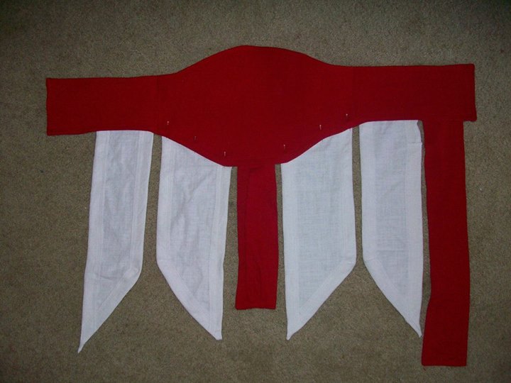

I decided to attach the upper "flaps" to the red sash, so that they would always be in position:

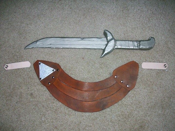

Also started working on the scabbard attachment system to the abdominal armor. Also pictured is the short sword made out of EVA foam, sealed with Plasti-Dip, and painted with Acrylics. This was my first time working with EVA foam floor mats for a prop.
