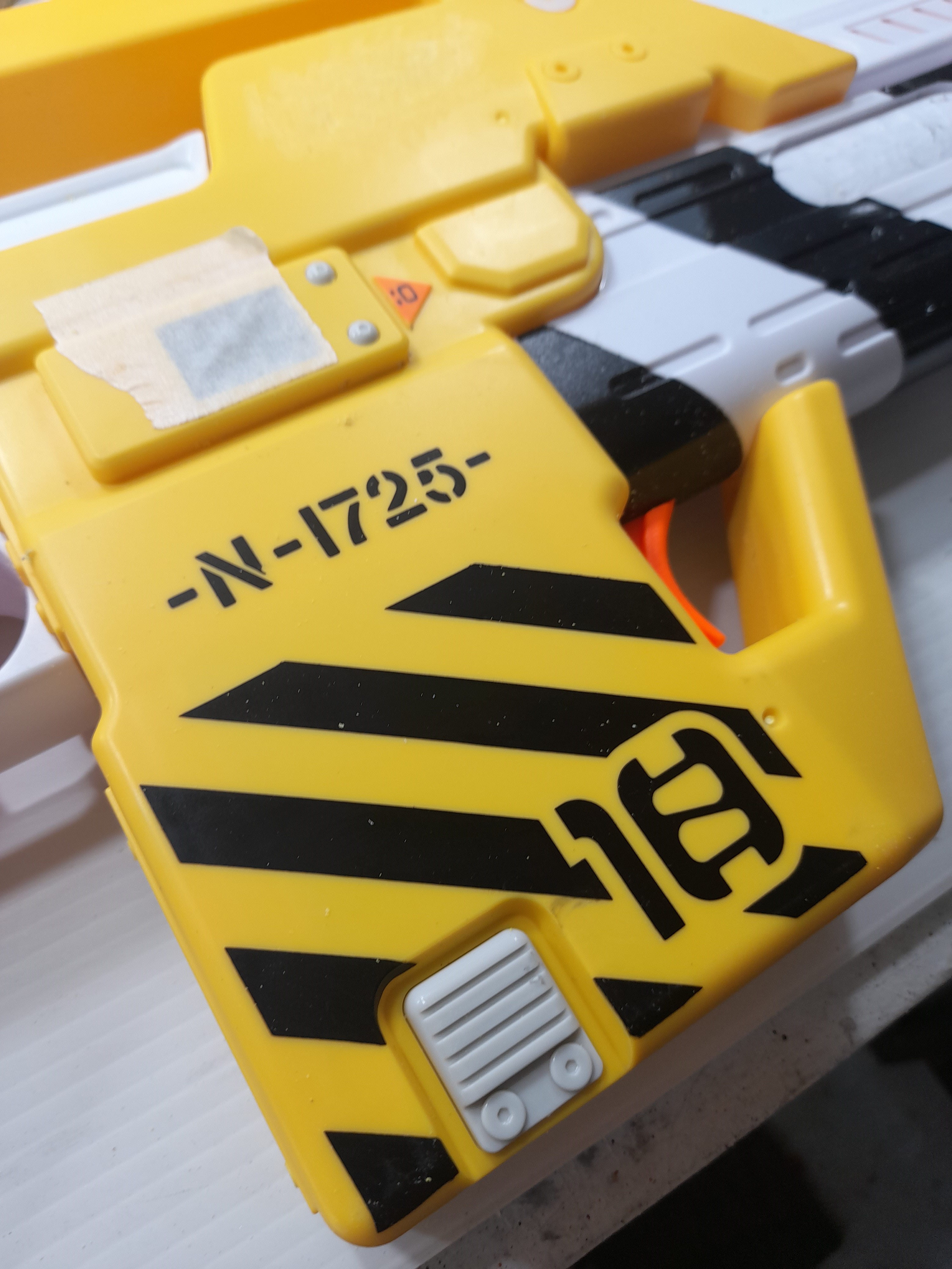

20221001_160438.jpg20221001_160107.jpg20221001_154426.jpg20221001_154354.jpg20221021_145133.jpg

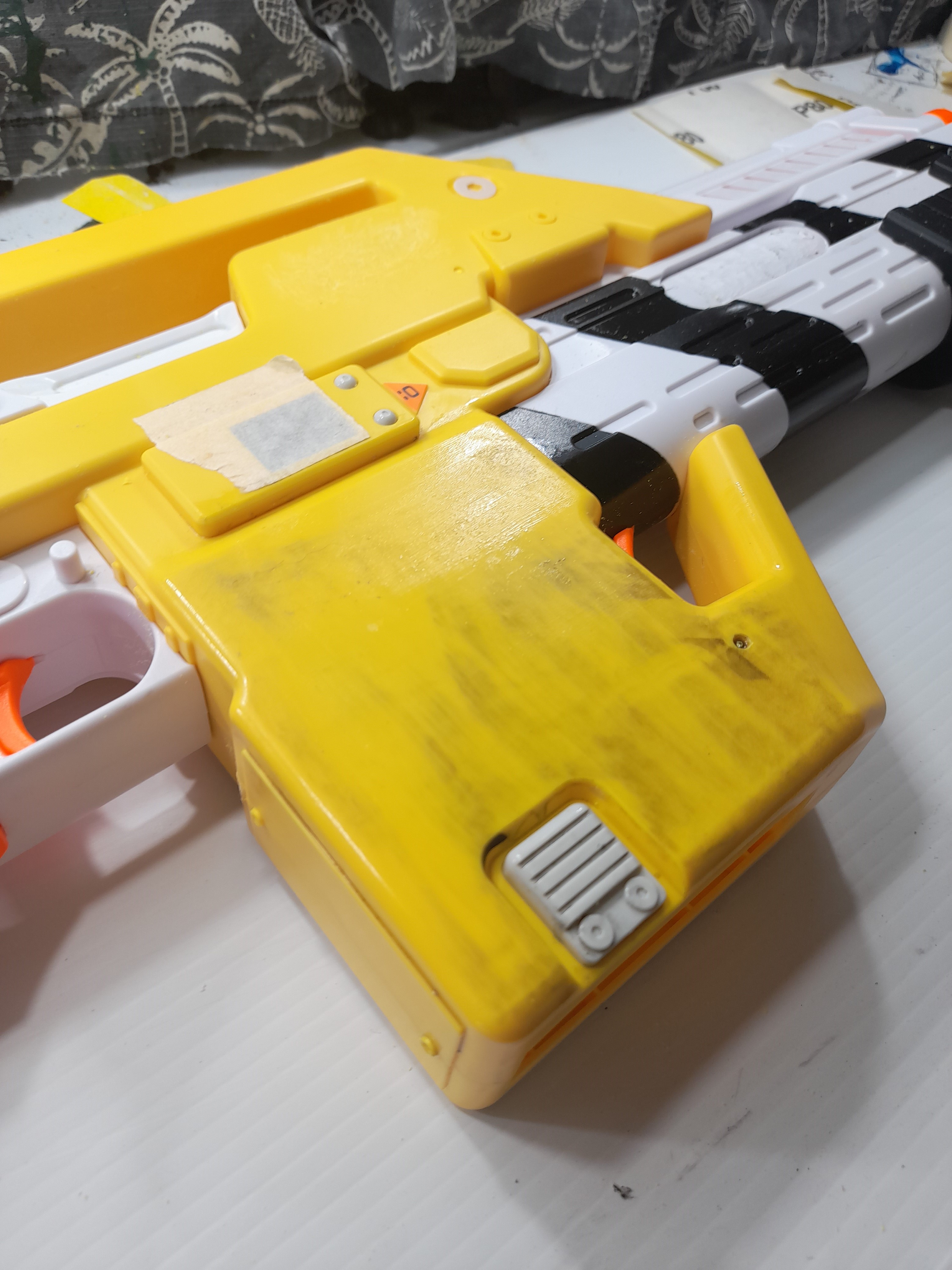

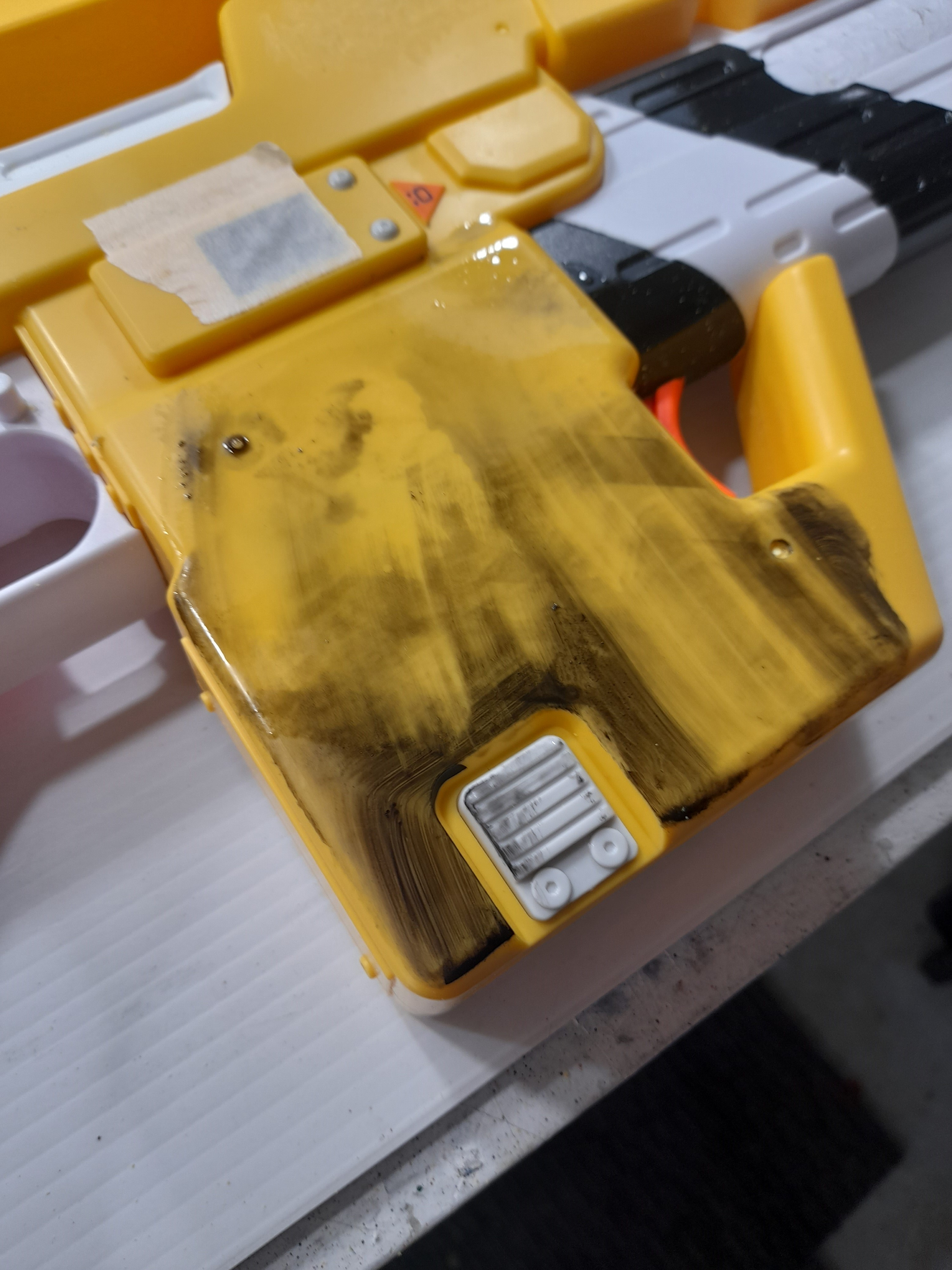

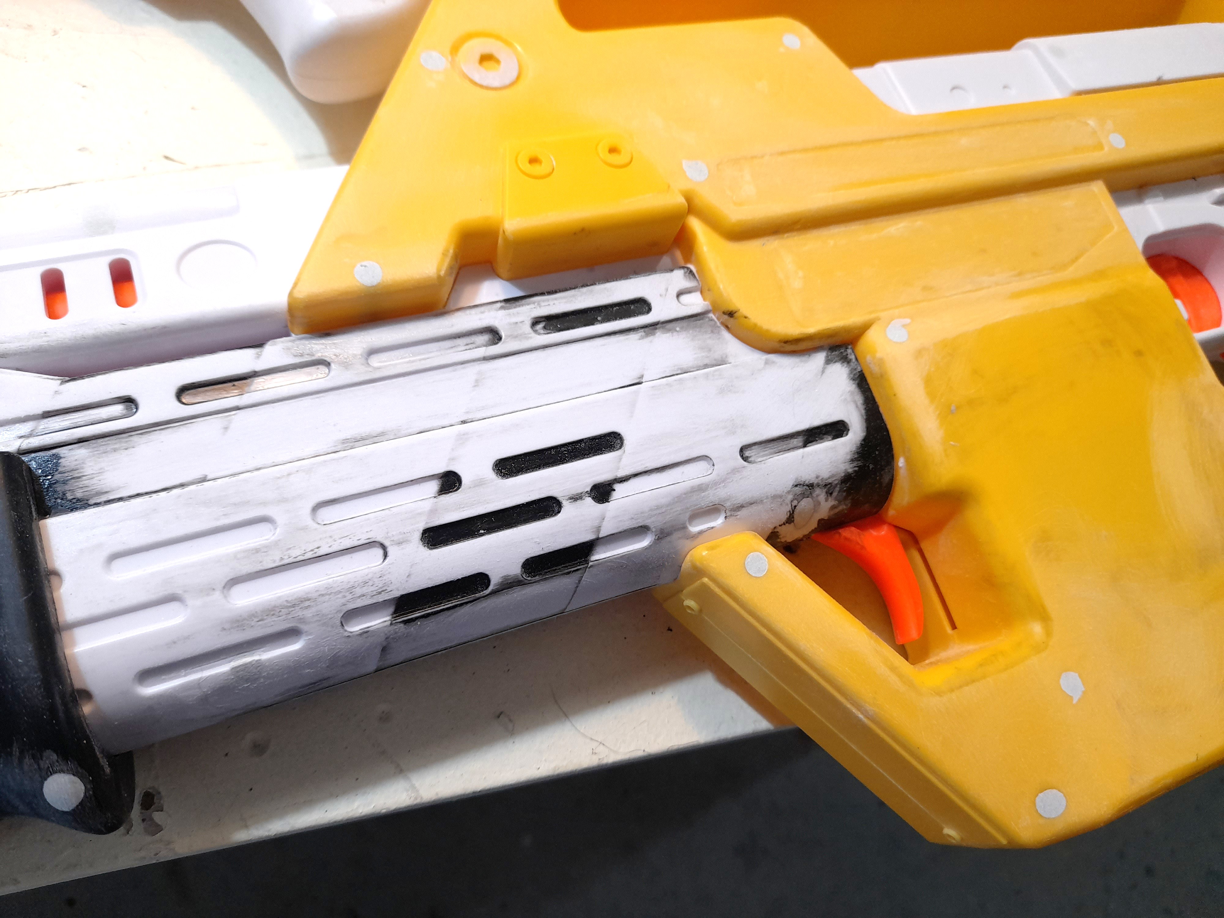

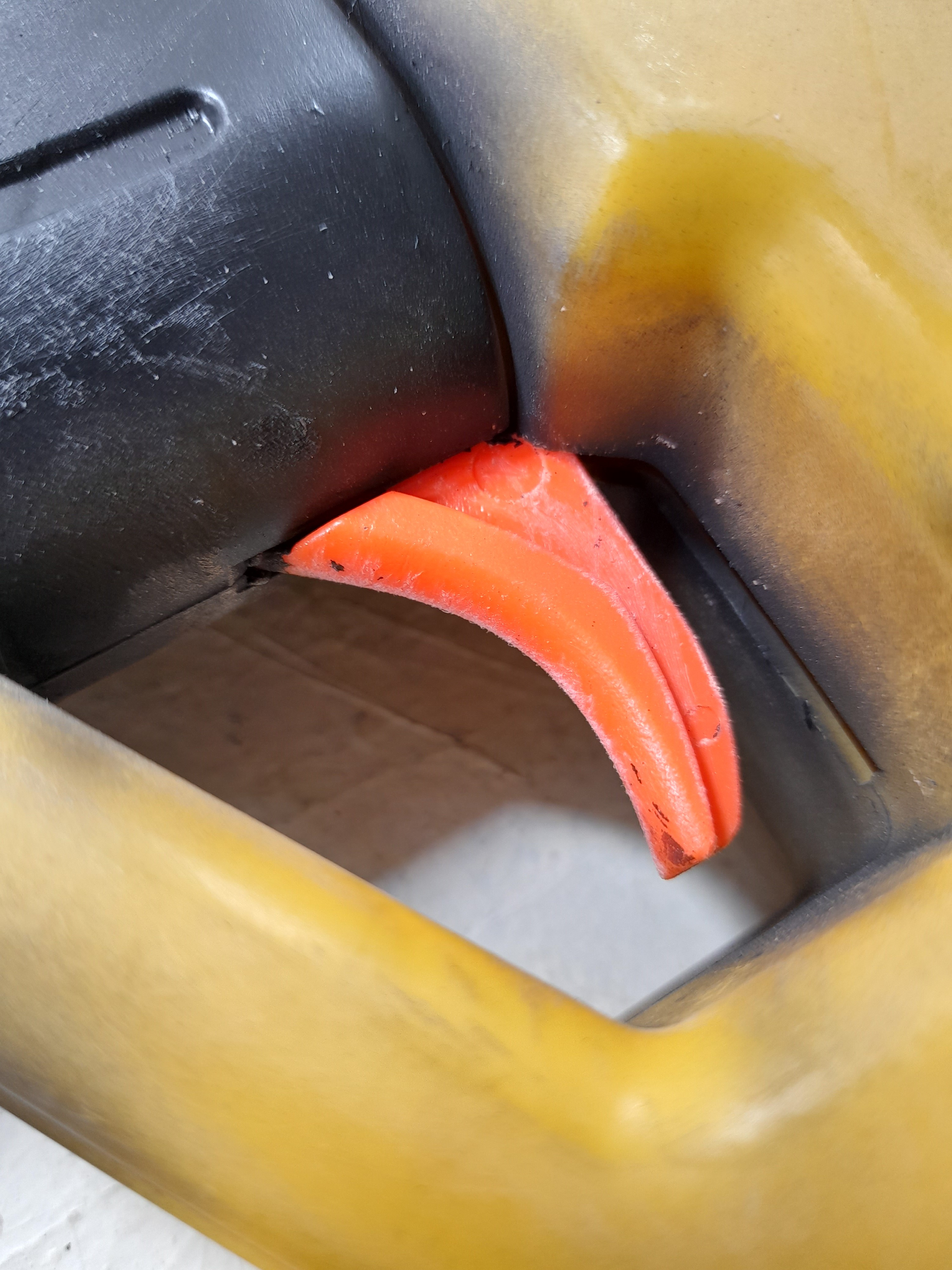

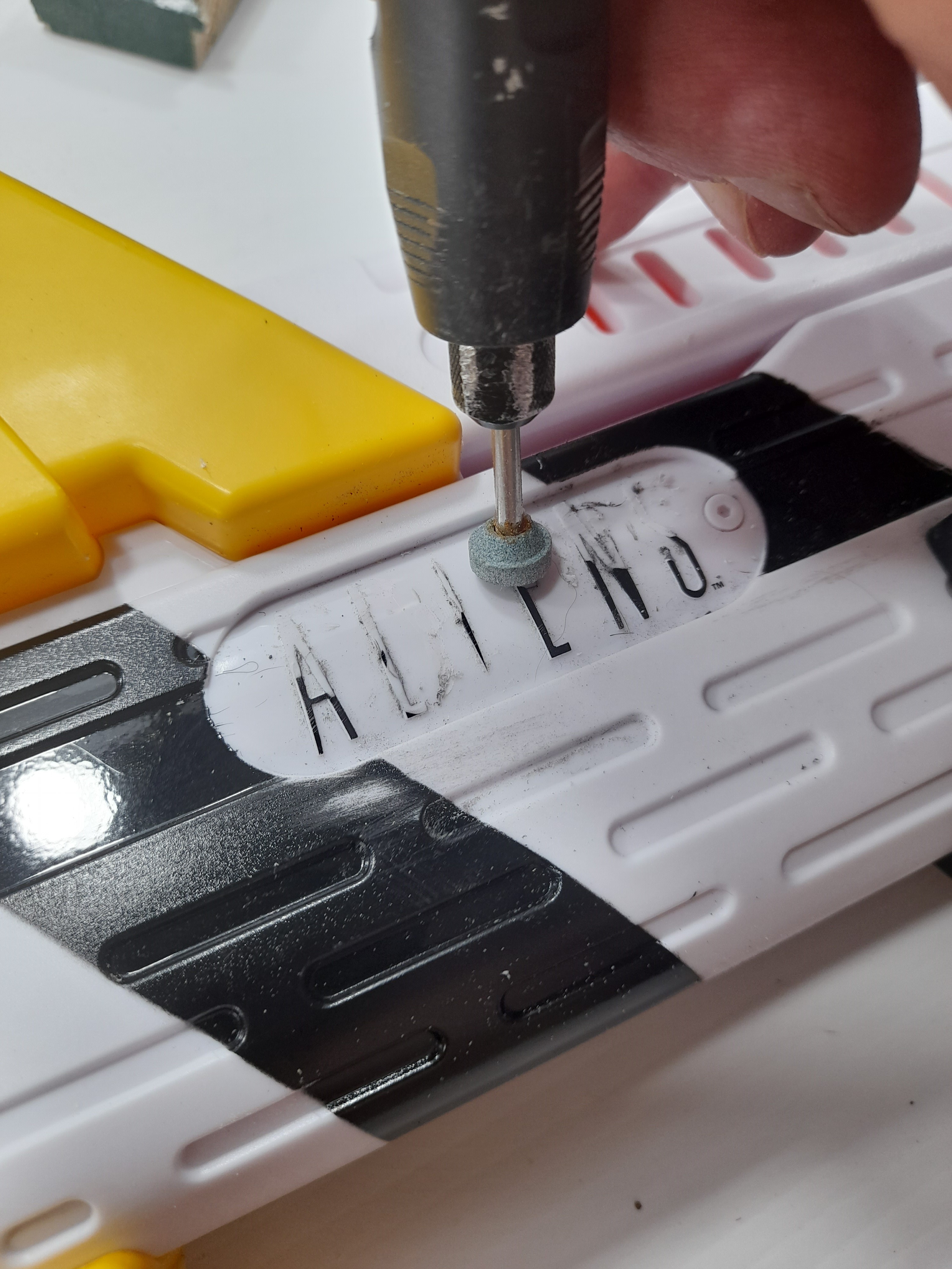

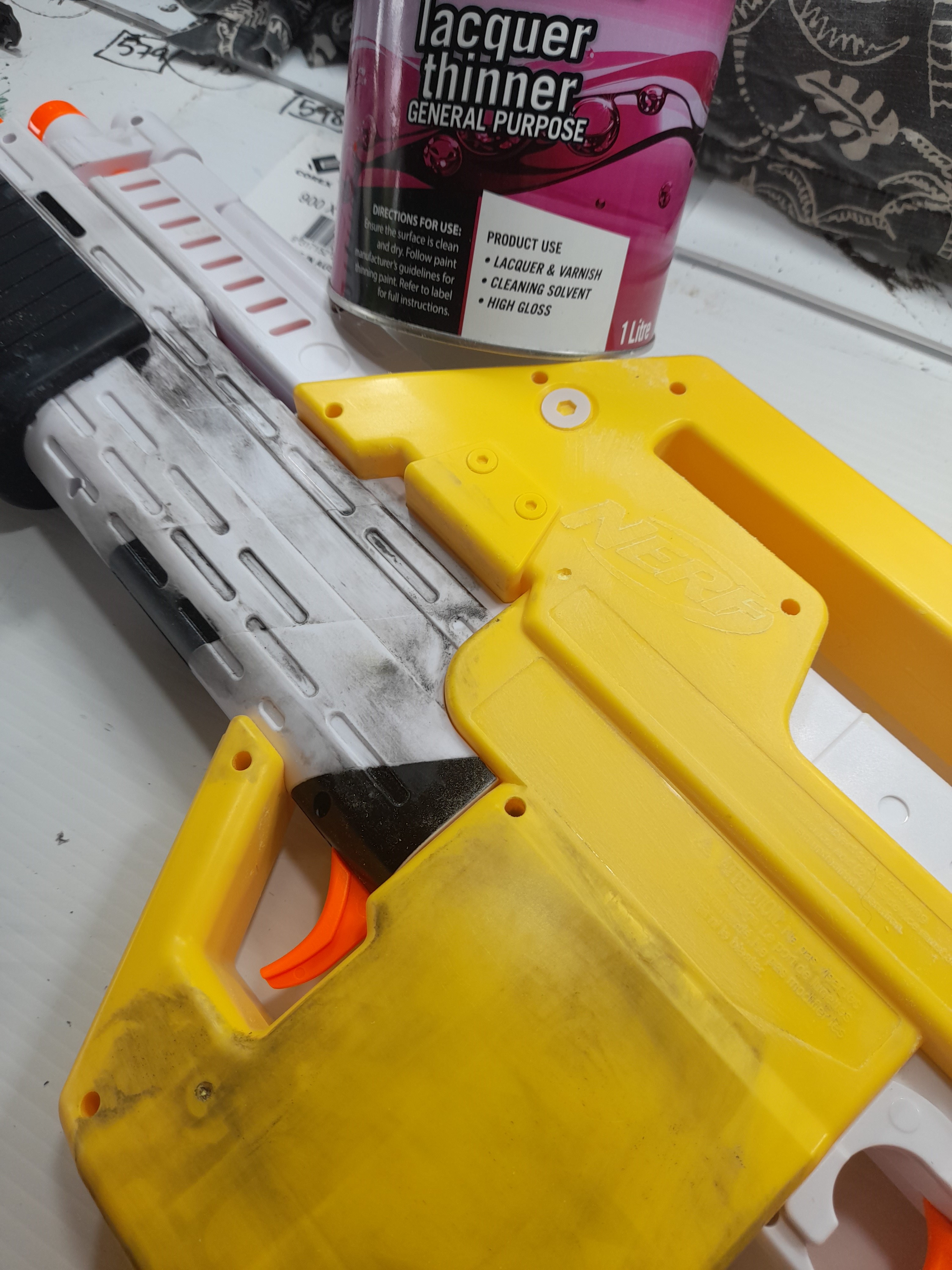

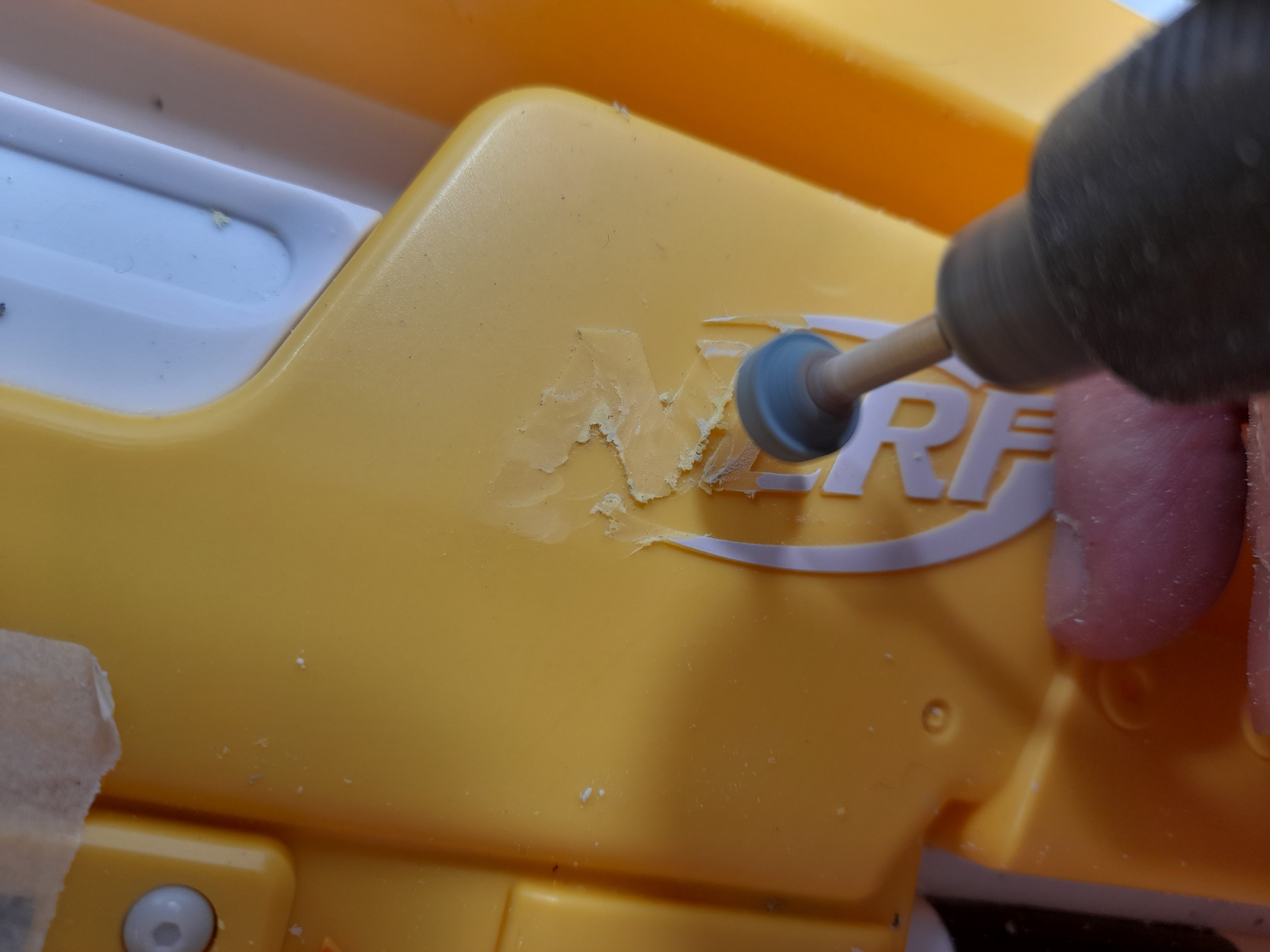

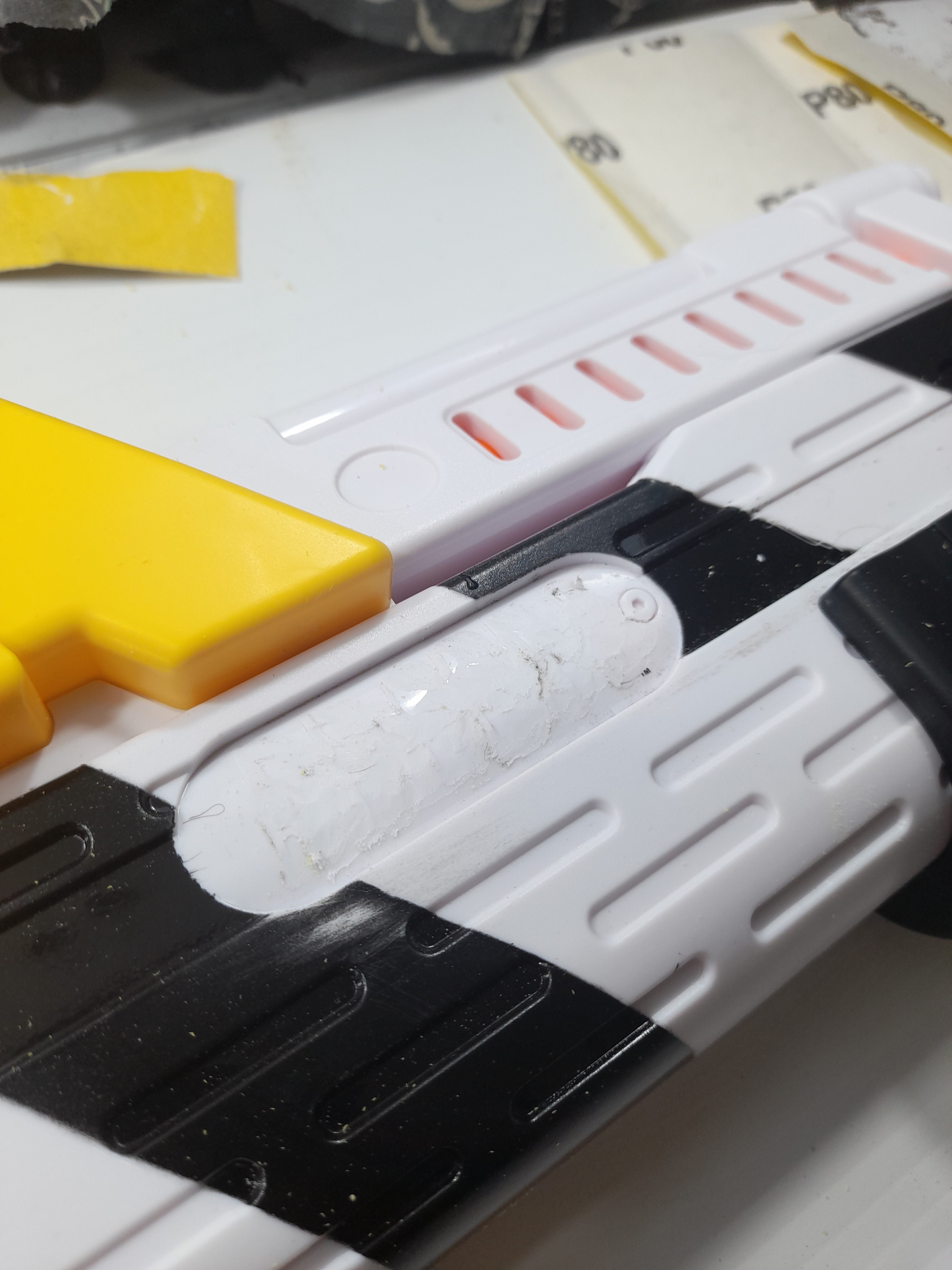

All the logos and warning text has to go, I wiped the black prints off with lacquer thinners and the heavy logos, Dremel and will sand.
Colours - they are black and brown in the films with lightening giving a green tone to them, but I prefer the army olive green and black, so will go with that.
Paint - I'll use Acrylic Lacquer. The thinner in the paint melts the plastic slightly creating strong adhesion, no need for primer.

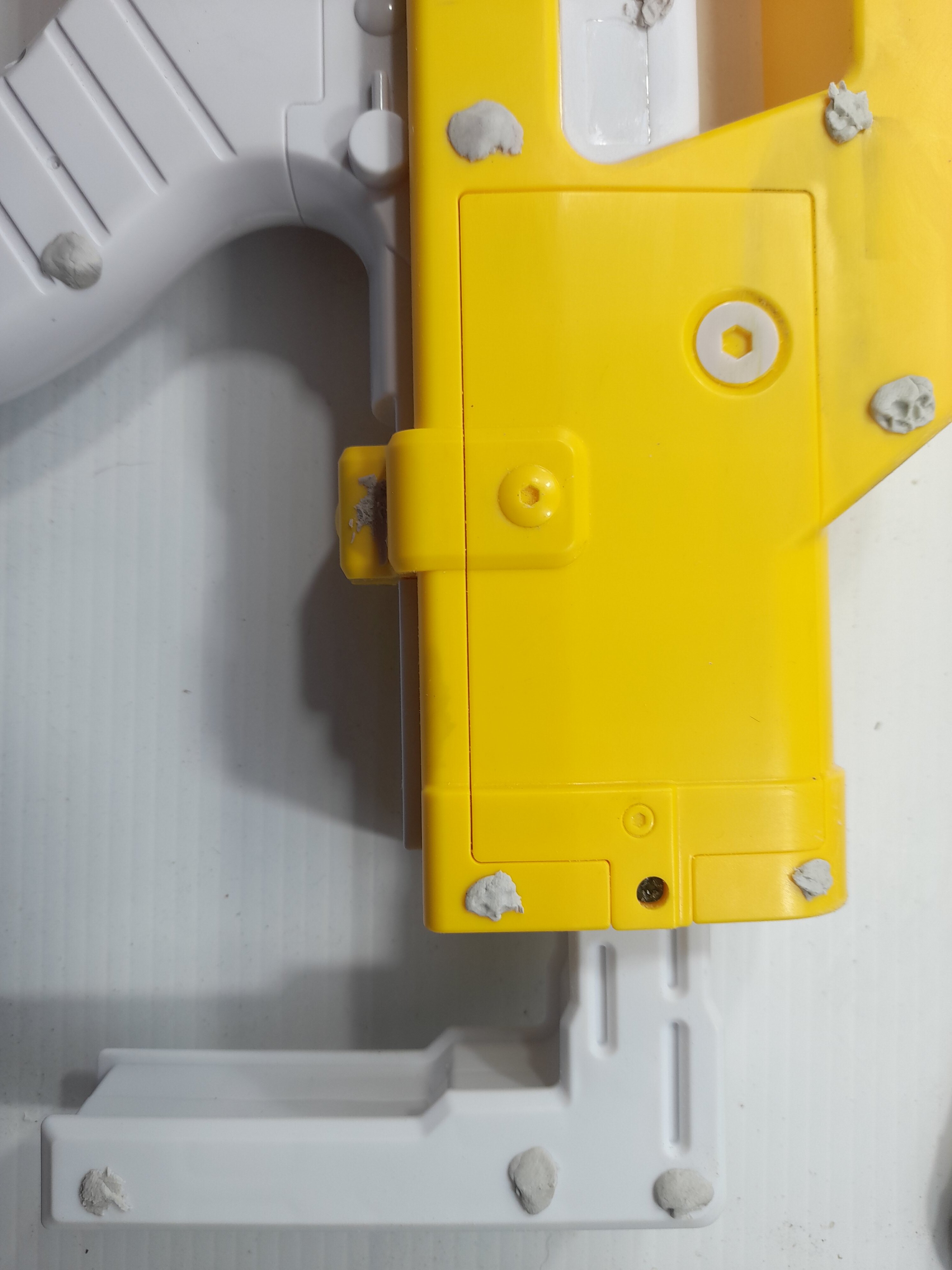

20221022_123233.jpg20221022_123308.jpg20221022_123358.jpg20221022_122656.jpg20221022_122859.jpg20221022_122254.jpg20221022_123404.jpg20221022_122200.jpg20221022_125340.jpg

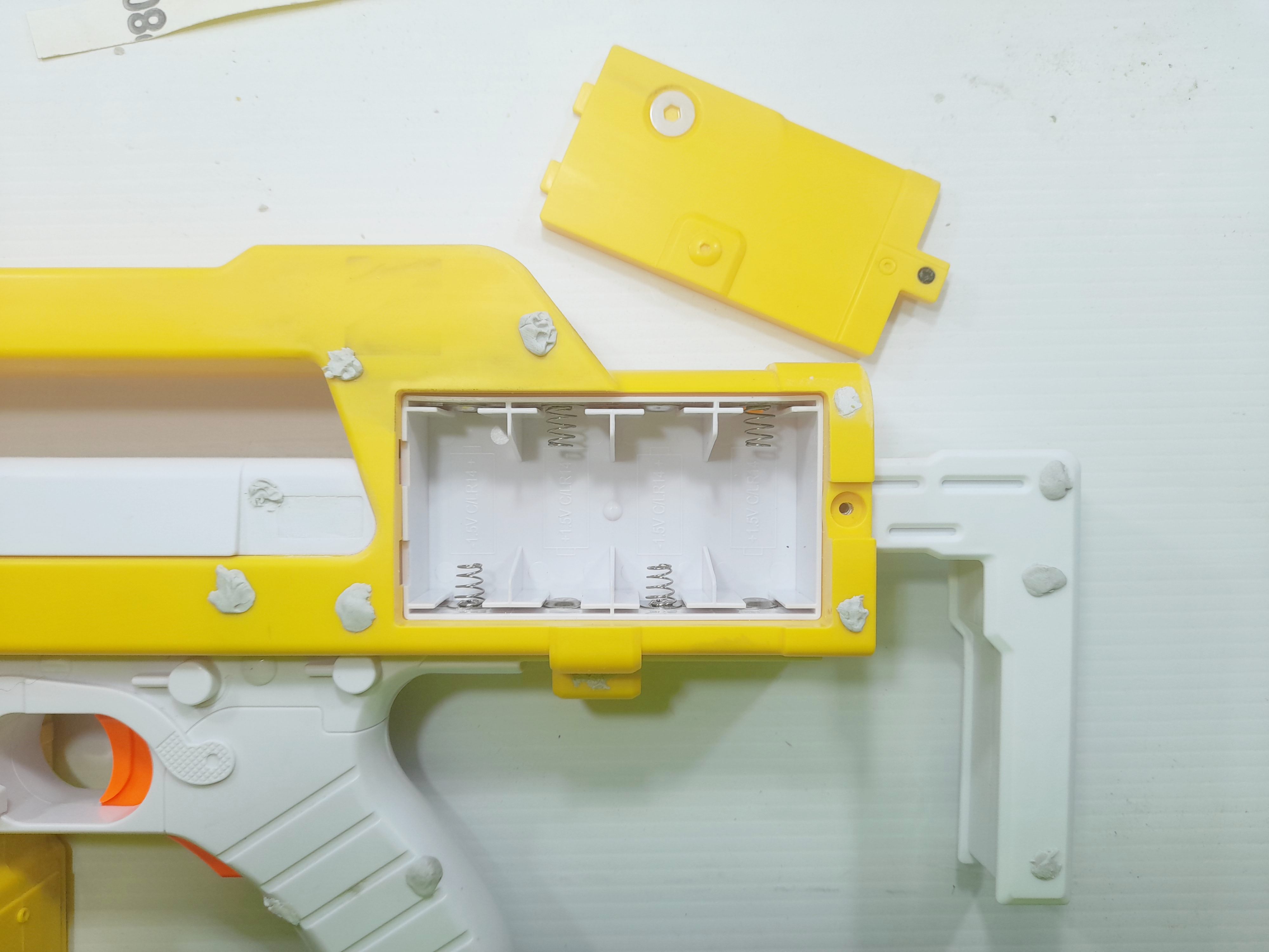

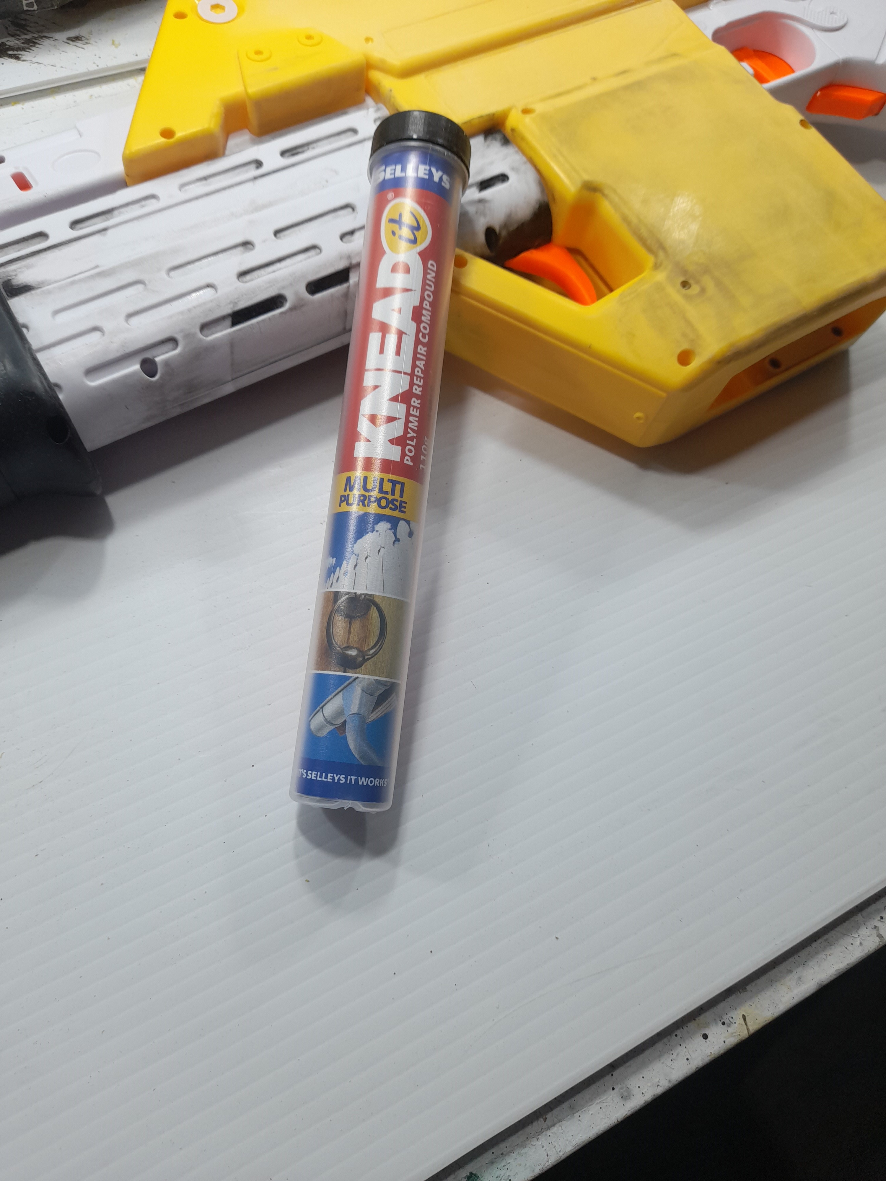

Filled all the screw holes. This is a great filler, 2 part, sets in about 5 minutes and is super hard.
I thought about rebuilding the stock and make it a pull out version, not too hard to do, but then you have to remove the battery case making it non functional....so not for this one, might do on the second one.

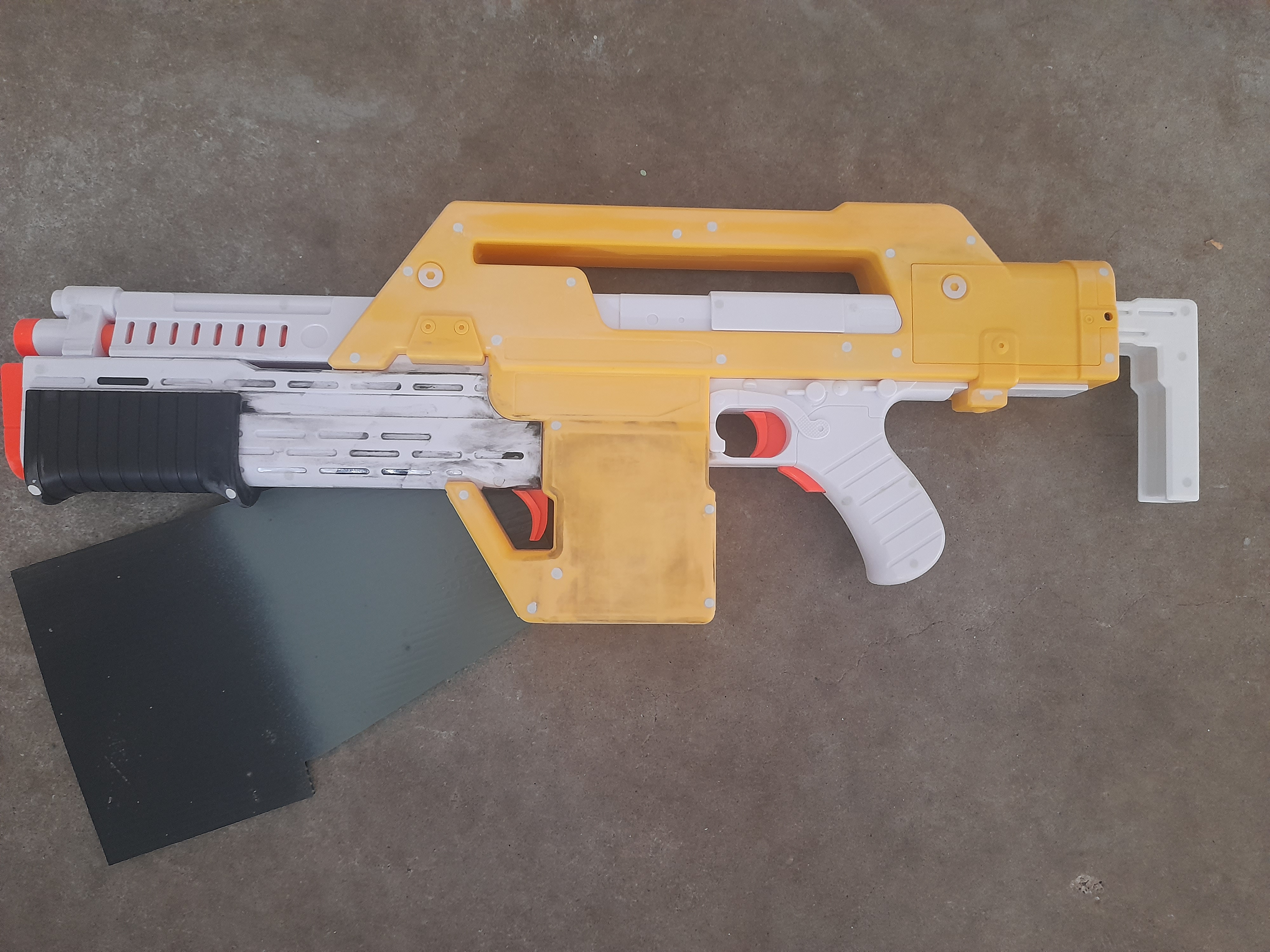

Got all the screw holes sealed and sanded, grabbed some color from my stock to see what the green and black looks like. I'm was convinced the green was the go, but I might have to paint the second one the brown.:unsure:
Put some batteries in and OMG it sounds AWFUL, the firing is not too bad, but the motor running sounds like tired old bagpipes....:lol::lol:

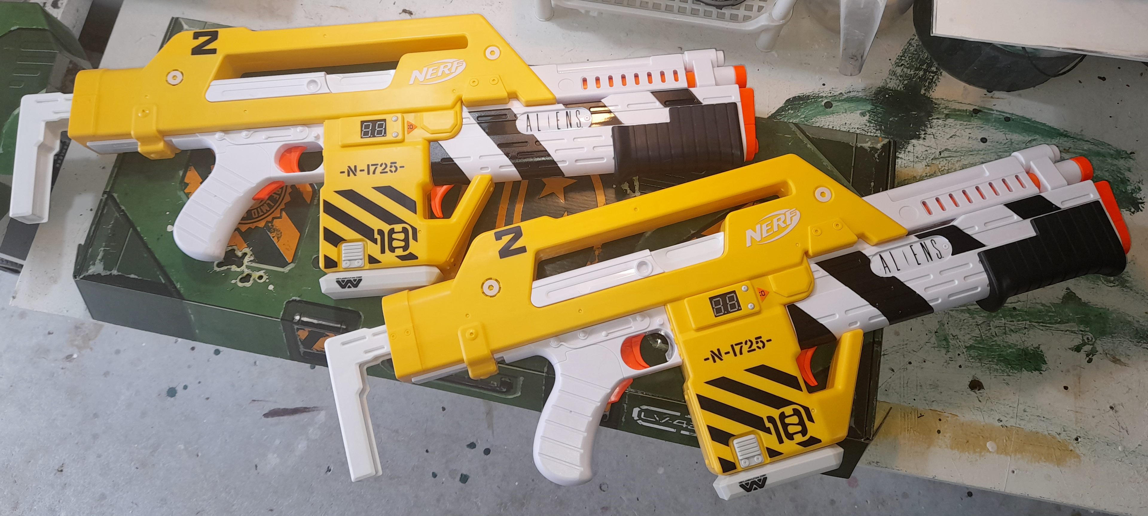

Not much of an update....Out of the 4 rifles, I'm going to paint 2 and make some display stands for them. Don't know about the other two....:unsure:....might gut one and get the movie firing sound added.
Holes filled and sanded...next up paint time...!!:cool:
It's slow going...lots of stupid life stuff getting in the way... :lol:

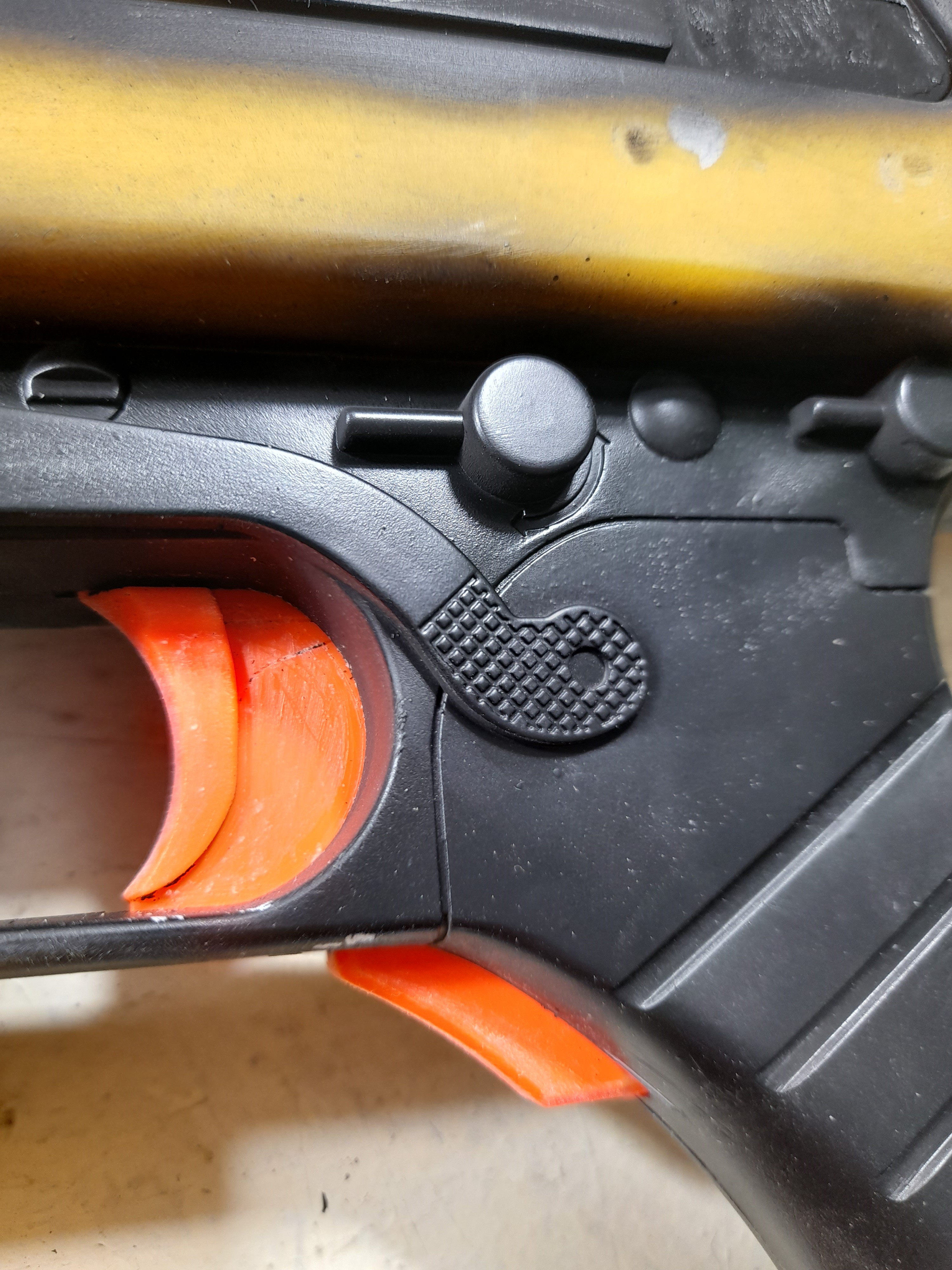

The orange plastic is super waxy and the paint fell off where I didn't sand hard enough, but it should stick now.
