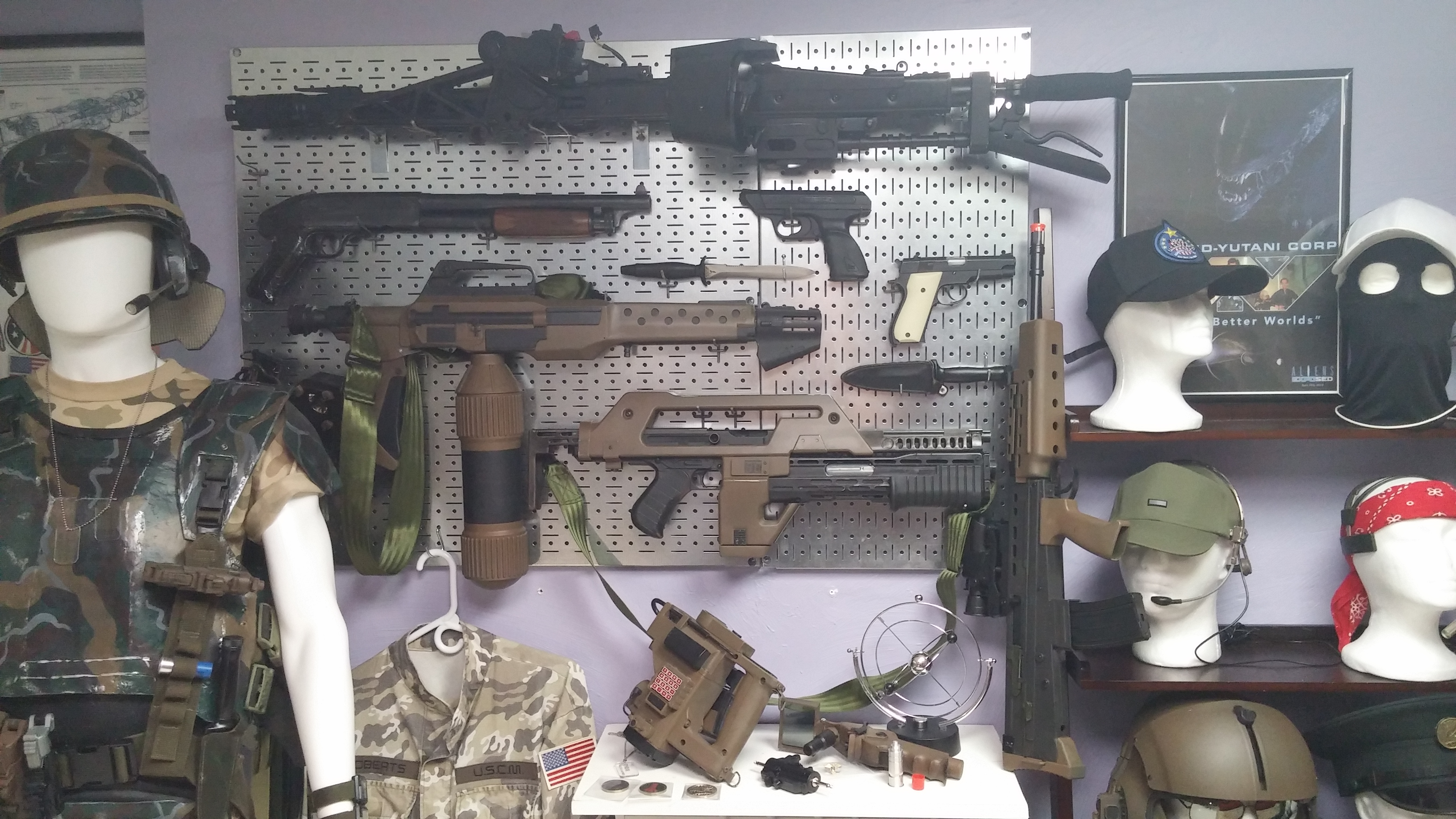

Tiny update regarding the 'display' Overall it needs a bit of tweaking and cleaning up, but, but the new weapons wall is coming together. Also, of course the smartgun up top is not anywhere near finished but I just wanted to be sure it had its place marked out.

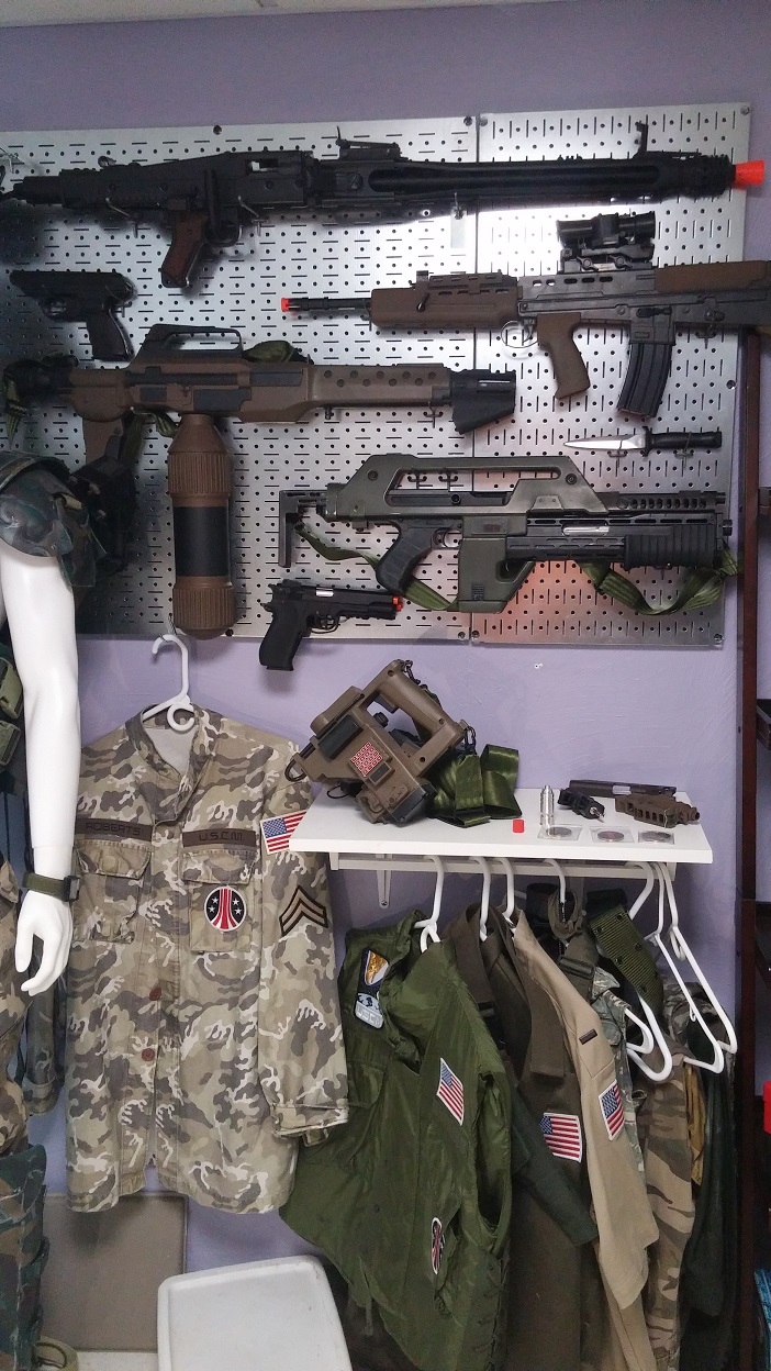

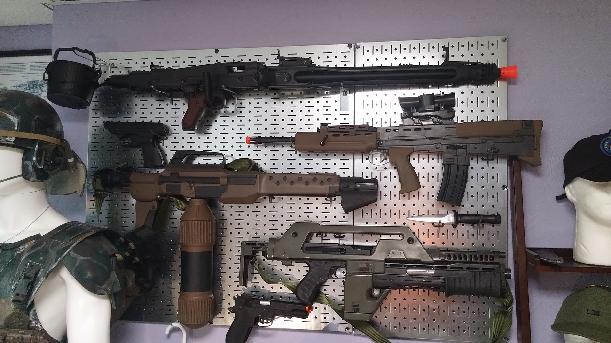

The wall has actually been updated quite a bit after I finished up some other items. Pretty much got one of everything from the film now. I think I'm done?! :rolleyes

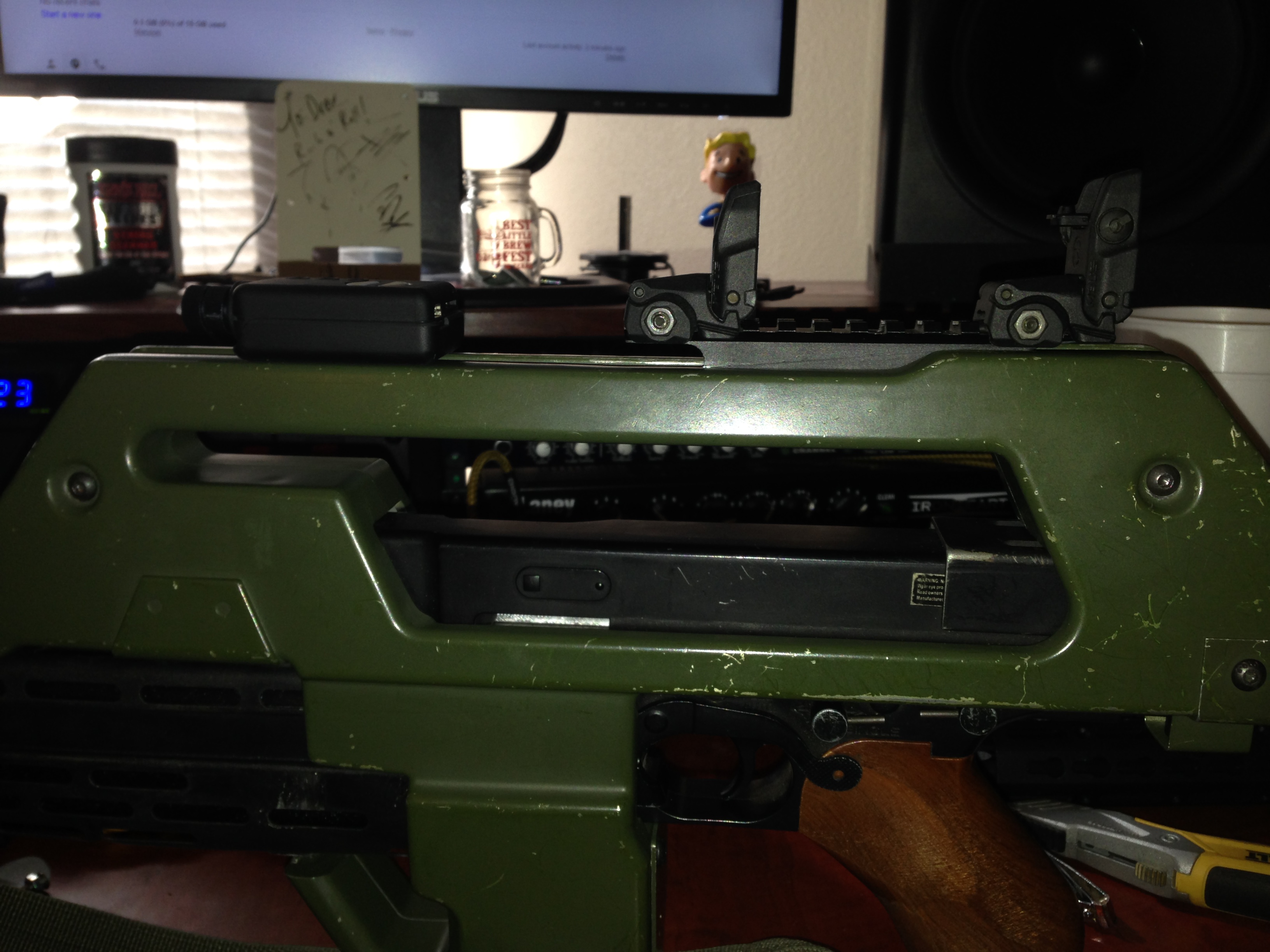

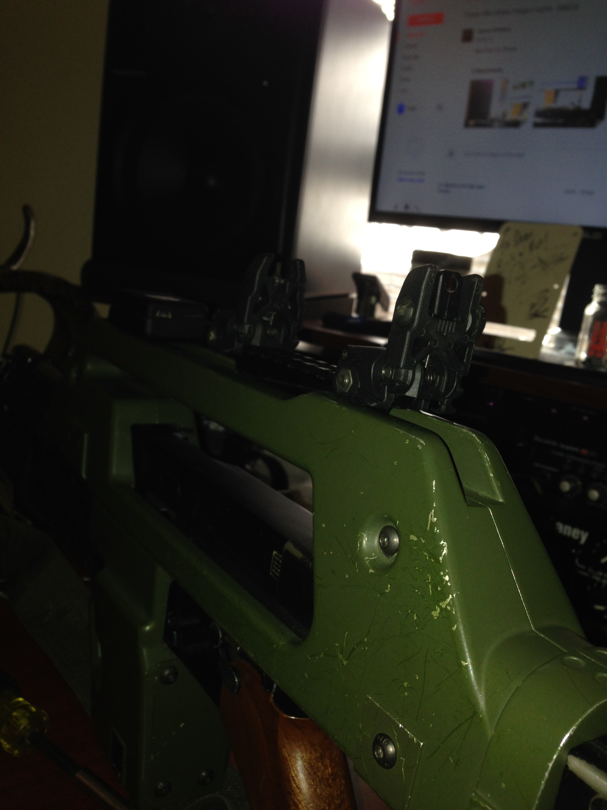

Ideas for placement of rail with mbus2 flip sights
Yes I realize the rear sight is backwards but hear are some more pics with them the right way and with my mobius action camera.
