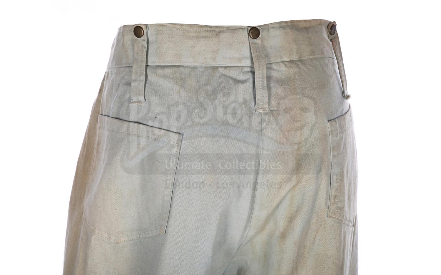

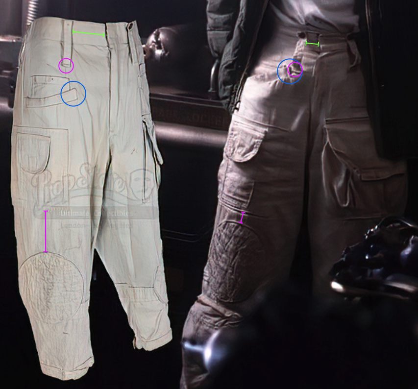

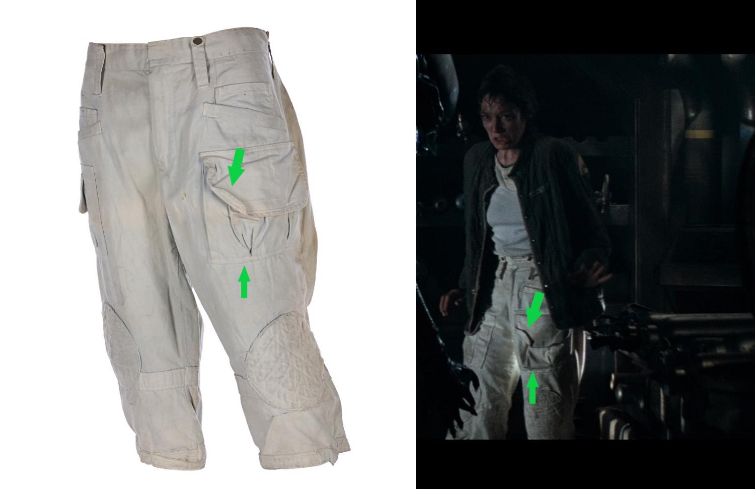

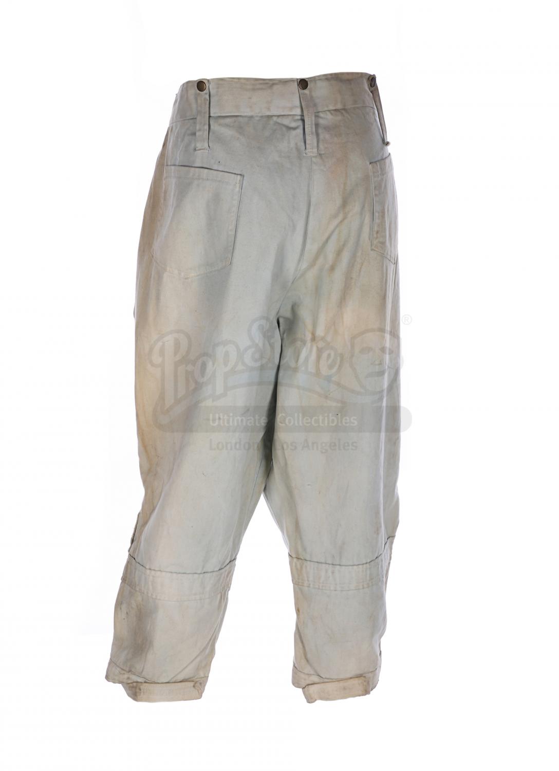

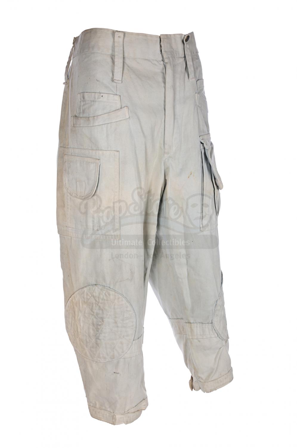

From Propstore: "The pockets of this pair appear to match Lambert's (Veronica Cartwright) death scene through distinctive folds and creases on the front left pocket. However, it seems these trousers were later repurposed for Ian Holm’s character, Ash. Modified for use in subsequent productions, the trousers' knee patches show evidence of alteration and the large shin pockets seen in the film are no longer present." Or were they Lambert's repurposed for Ash? Knee patches definitely lowered. If these are the Lambert death scene pants, why does the pocket appear closer to the belt loop on-screen? Also it looks like the pants close a lot closer to the right belt loop than on the Propstore pants. I've seen pix of Ash where there are small differing pants details so they must have had multiple costumes for each character.

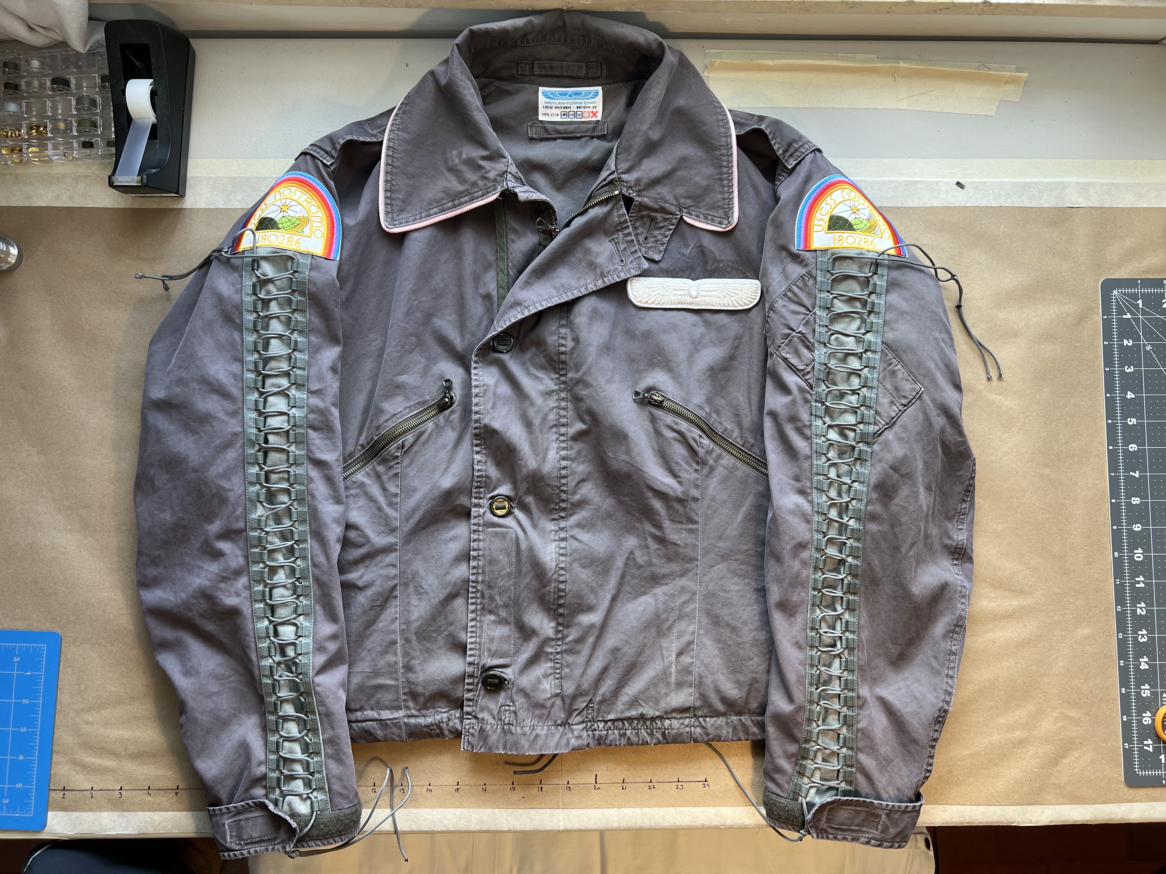

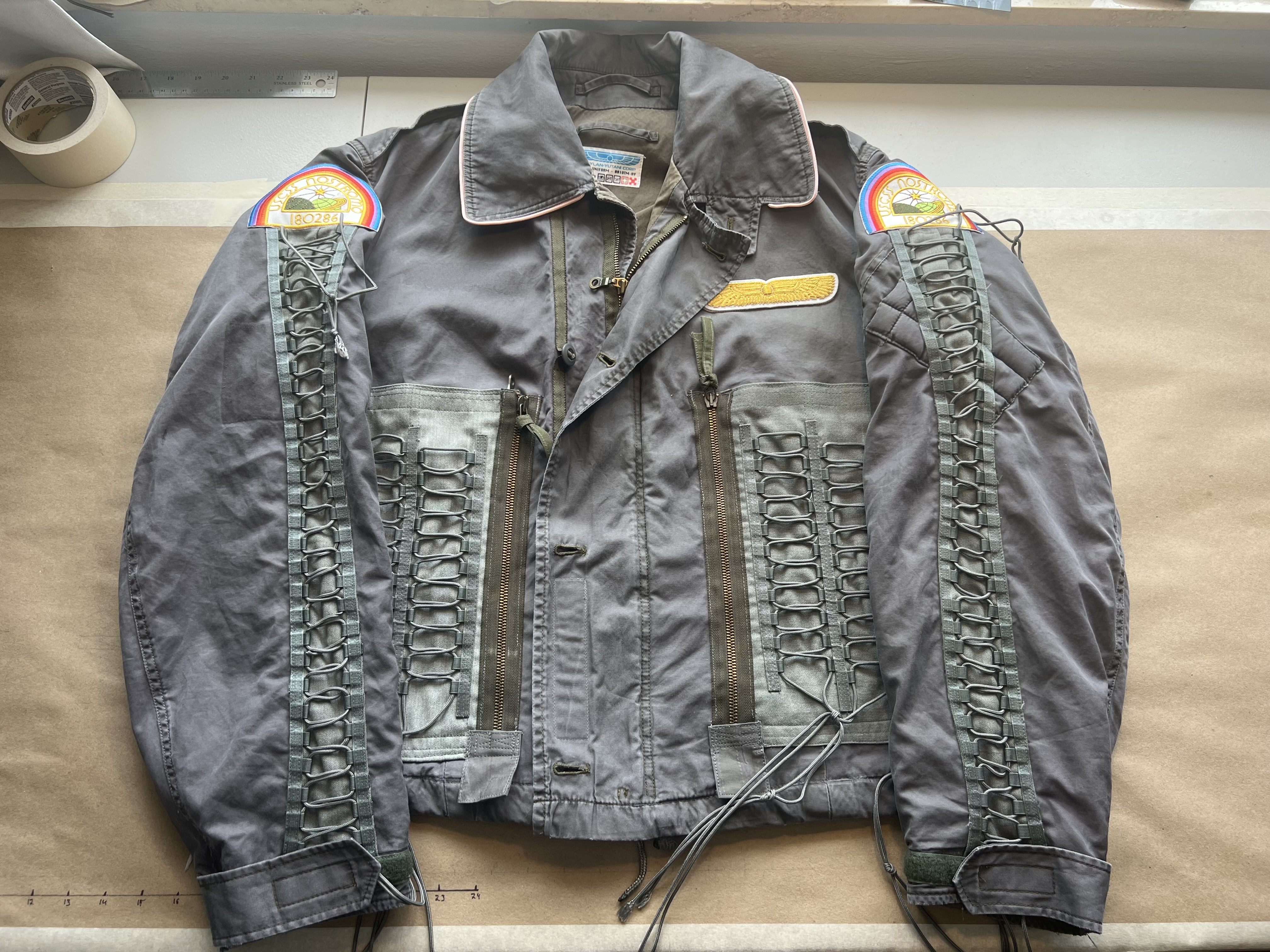

Having a go at a Kane version jacket (got my Mk3 from Merliner back in the day!) and pleased with my minimal efforts and a lot of help from SG-RB's excellent sleeve lacings.
However, my attempt at the Nostrom lettering on the back has turned into a bit of a mess. Years ago, Banzai88 was kind enough to supply a vinyl stencil, but after a continental move in late 2021 that is buried somewhere in storage.
However, many moons ago I scanned the stencil into my computer just in case I needed it one day. Stencil card was used and then my problems began. Either my paint was too thick so it took on a slightly lumpy appearance, or it would be too thin when mixed with some water thus bleeding under the stencil masssively leaving no sharp lines.
Most of the few letters that were attempted were washed out after I realised it was better to stop.
It did not help that my greatest error, probably, was not having the jacket completely flat with no lumps and bumps visible.
So calling on the RPF and anyone with experience applying the lettering to help me out...
On replacing my crap self-made stencils, is anyone out there producing these for sale? I'll need two, haha. I have two jackets...
I feel a message to Banzai88 is in my future to see if he still makes them.
Hope someone can help...
Thanks in advance.
Steve

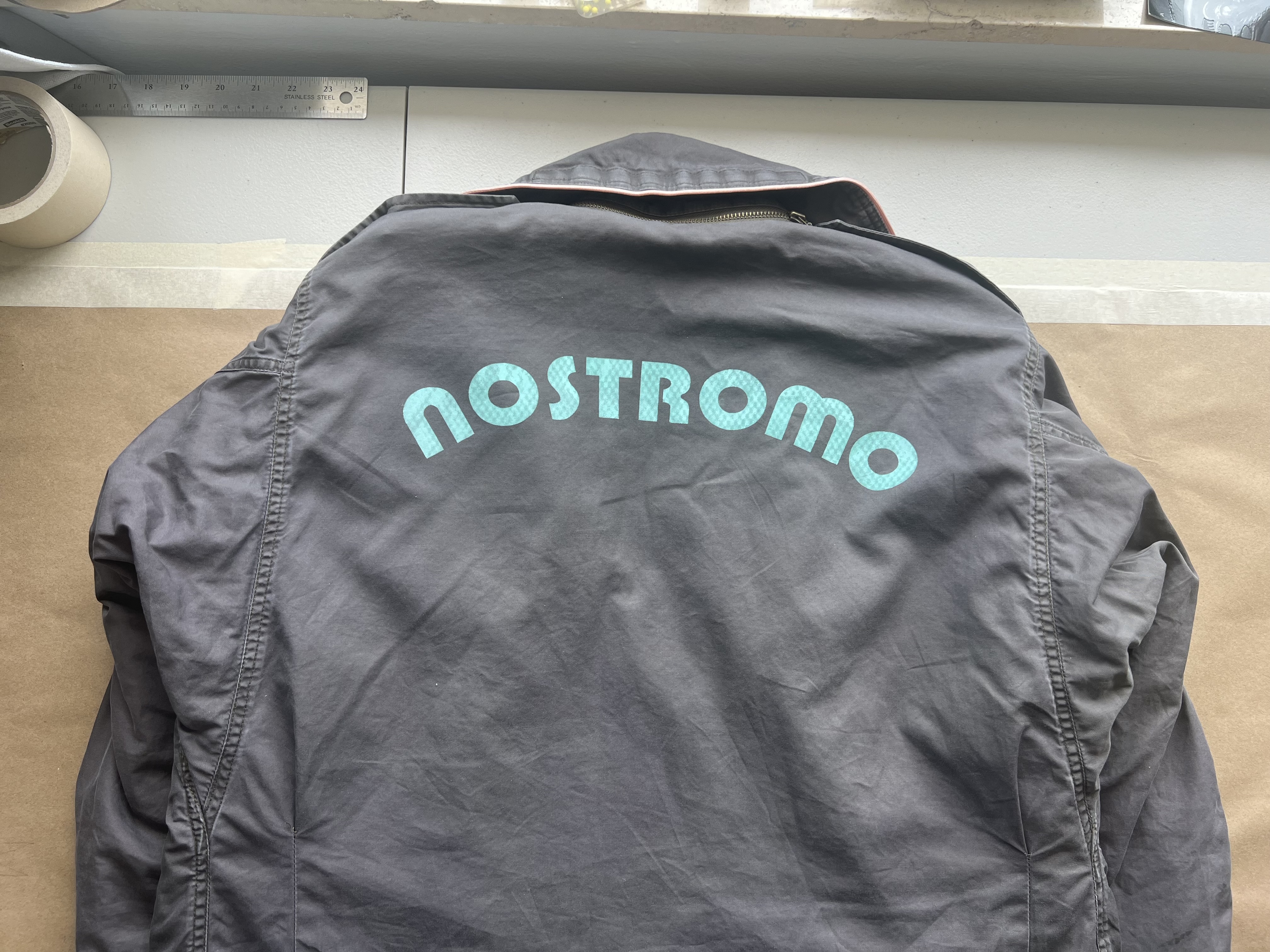

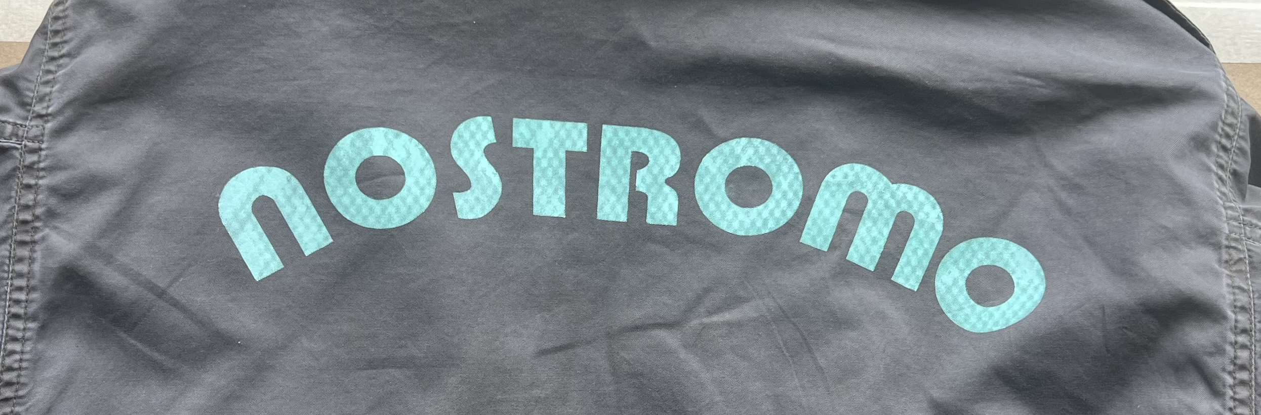

NOSTROMO Back Lettering

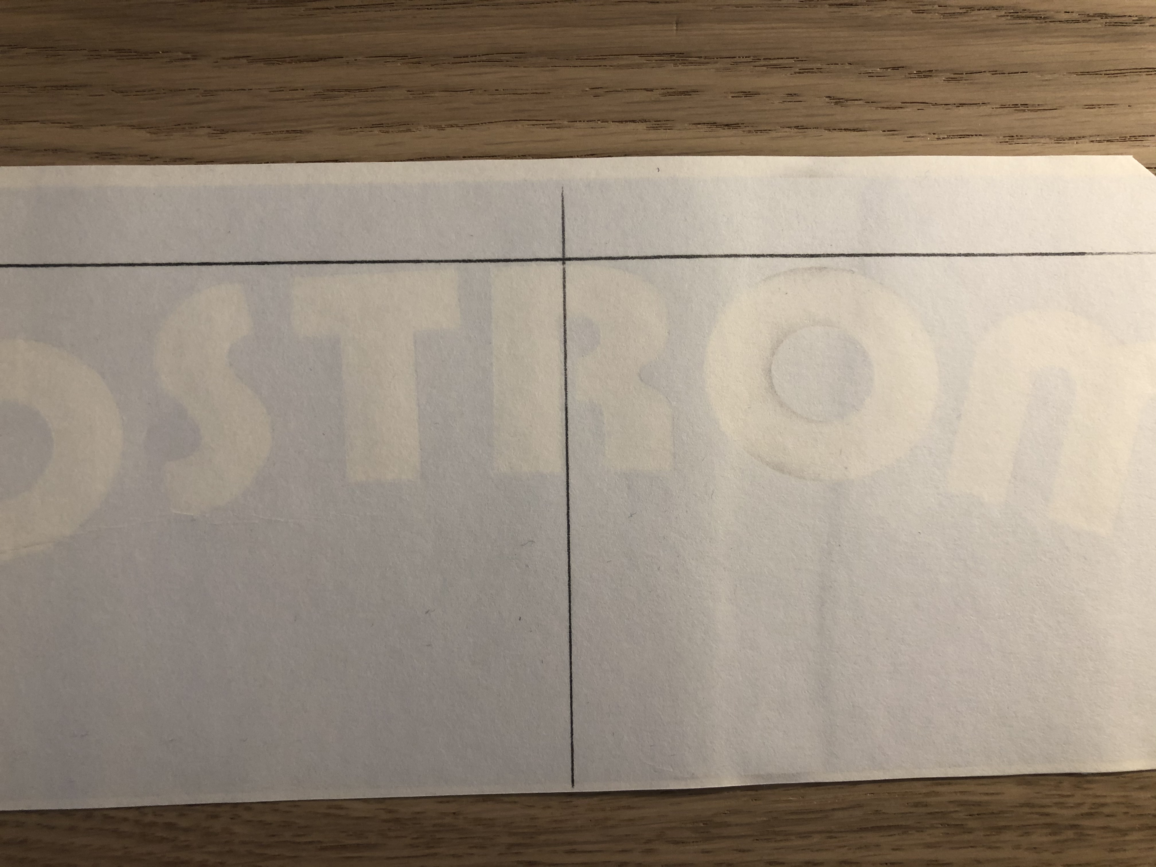

Here is my method for applying the NOSTROMO text on the back of the jackets, I experimented with different methods, but find this the most consistent and produces a result that is close to the screen worn jackets. After dying my jackets close to the correct color, I use a vinyl decal stencil, The ones Banzai88 offers are excellent.

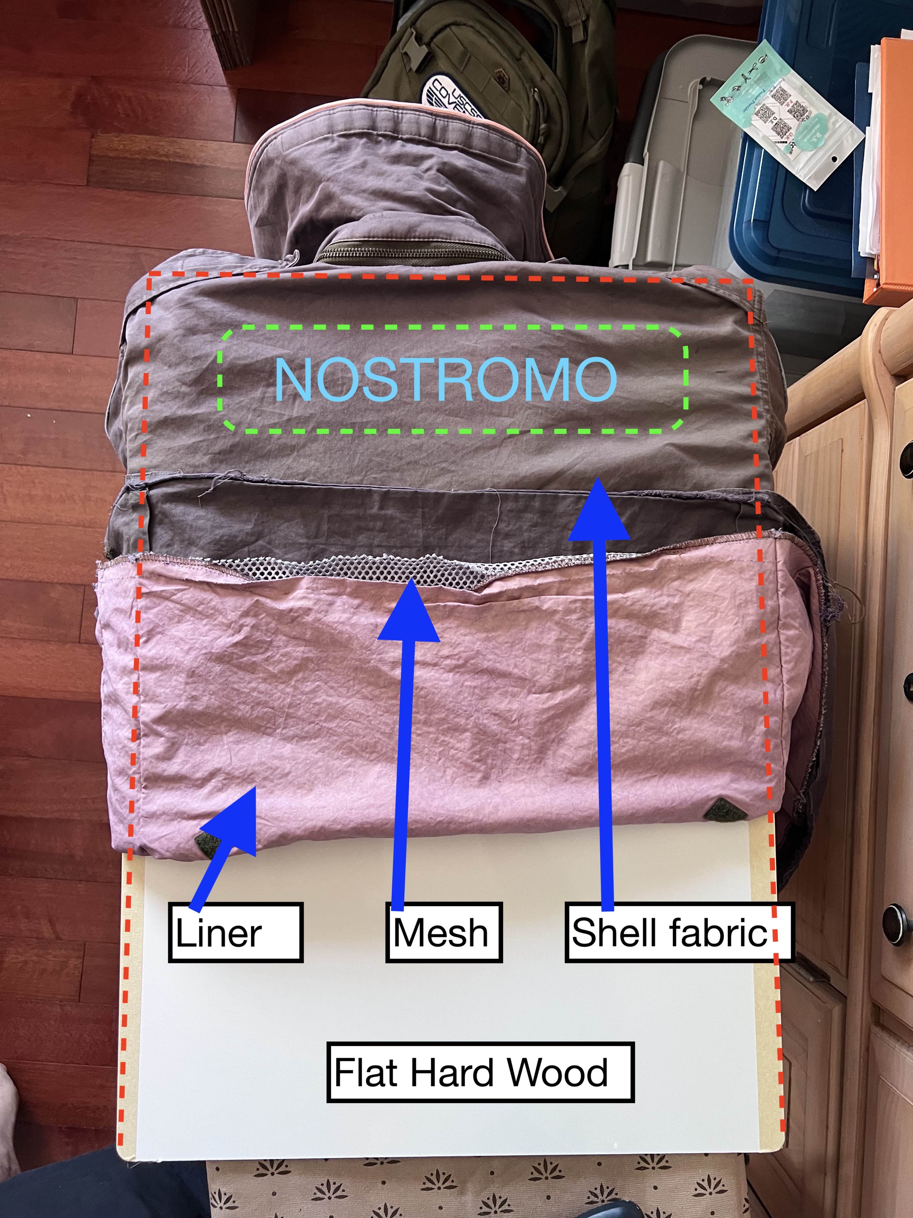

1. The Set-Up - Using a flat hard surface to dress the back of the jacket against, making sure there are no folds under the area where the the text will go. In this order: Hard flat surface - jacket liner - middle mesh - outer jacket fabric.
2. Measure - Carefully making sure the stencil is at the center with the middle top of the “R” right in the middle and approximately 4 inches below the zipper.
(Since I do this a lot I made a jig that helps me align everything:
3. Apply the Stencil - to that exact spot. I tape the top to the jacket, then flip it over carefully removing the bottom paper, then pressing and adhering the sticky decal to the jacket. Now carefully remove the transfer paper. Use the first non sticky paper to go over all the text making sure all the corners are well pressed and stuck to the fabric. And loose bits, and you risk paint bleeding under the stencil. Now the jacket and surface are ready for the paint.

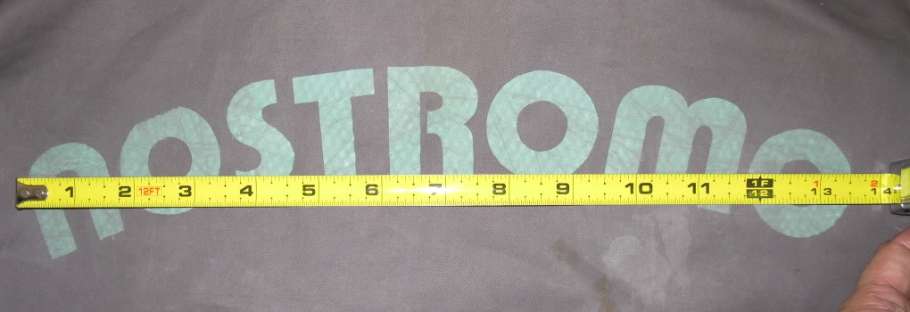

4. The LOOK - Since I wanted to achieve not just the text but also the texture that can be seen IN the text itself, which is not even and varies in shades and consistency. Early on I realized that this texture seen on the screen worn Kane jacket was there due to the aforementioned mesh lining that exists in every MK3 jacket. The costume department must have screen printed the text in this method, and that is why we can see the mesh “imprint” in the text on Kane’s jacket.
[Photo of the Kane screen used jacket, part of Bob Burns’s collection. Photo thanks to stephen210 . Note the mesh imprint and imperfections in the print. Beautiful!]

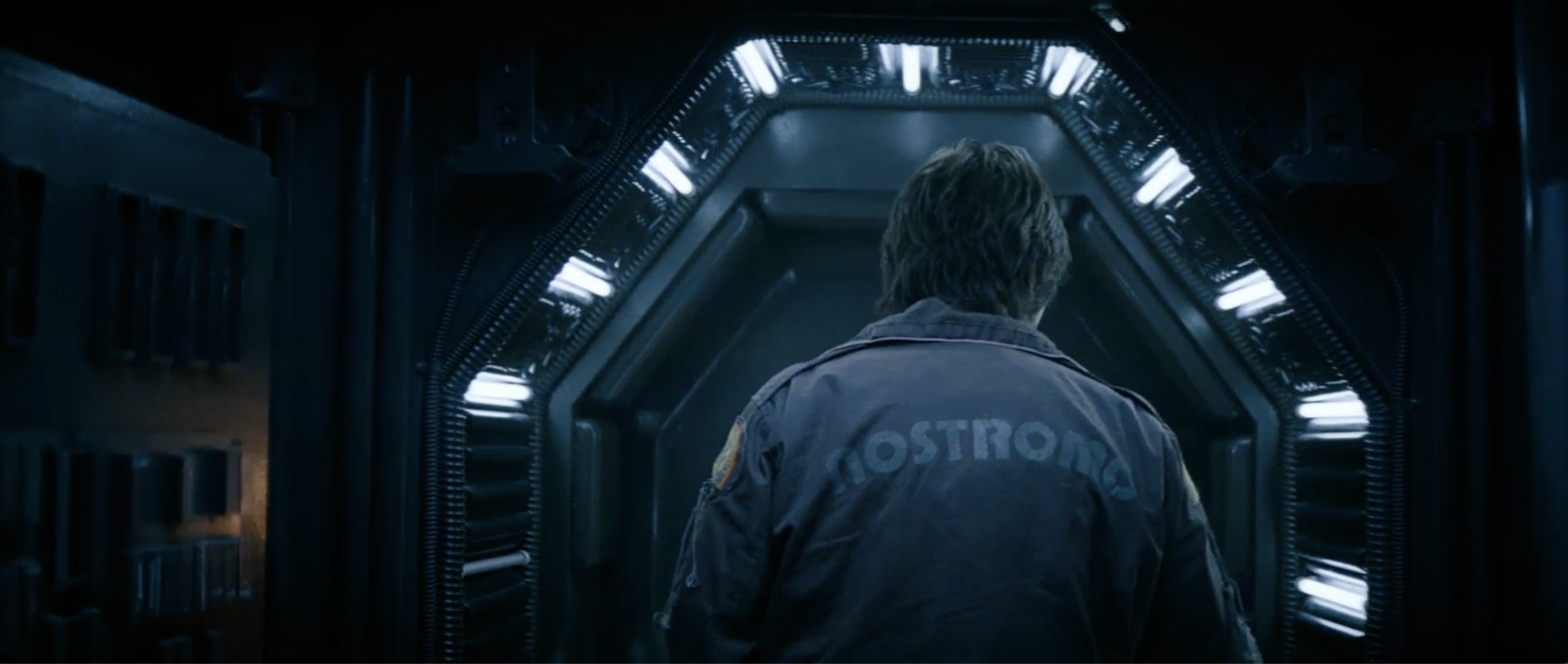

The Dallas jacket:

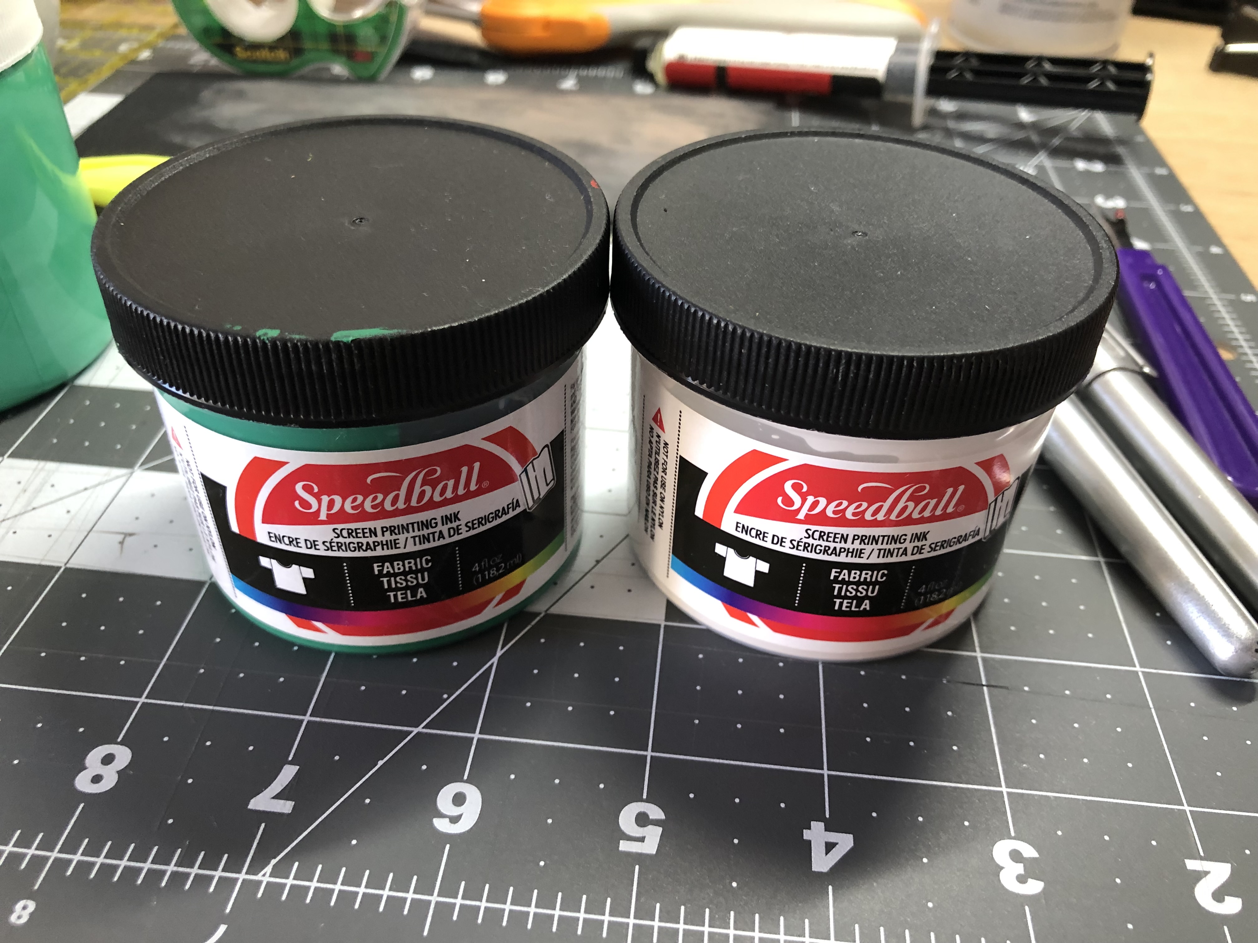

5. The PAINT - In order to achieve this same look, I use Speedball screen printing paint, which is of course intended for this exact purpose. Its fairly cheap and easy to come by. The color is a faded aqua, which I achieved by mixing the white and green paints. This paint is also fairly thick, so the risk of bleeding is low. I recommend testing on the beaver tail scrap fabric.

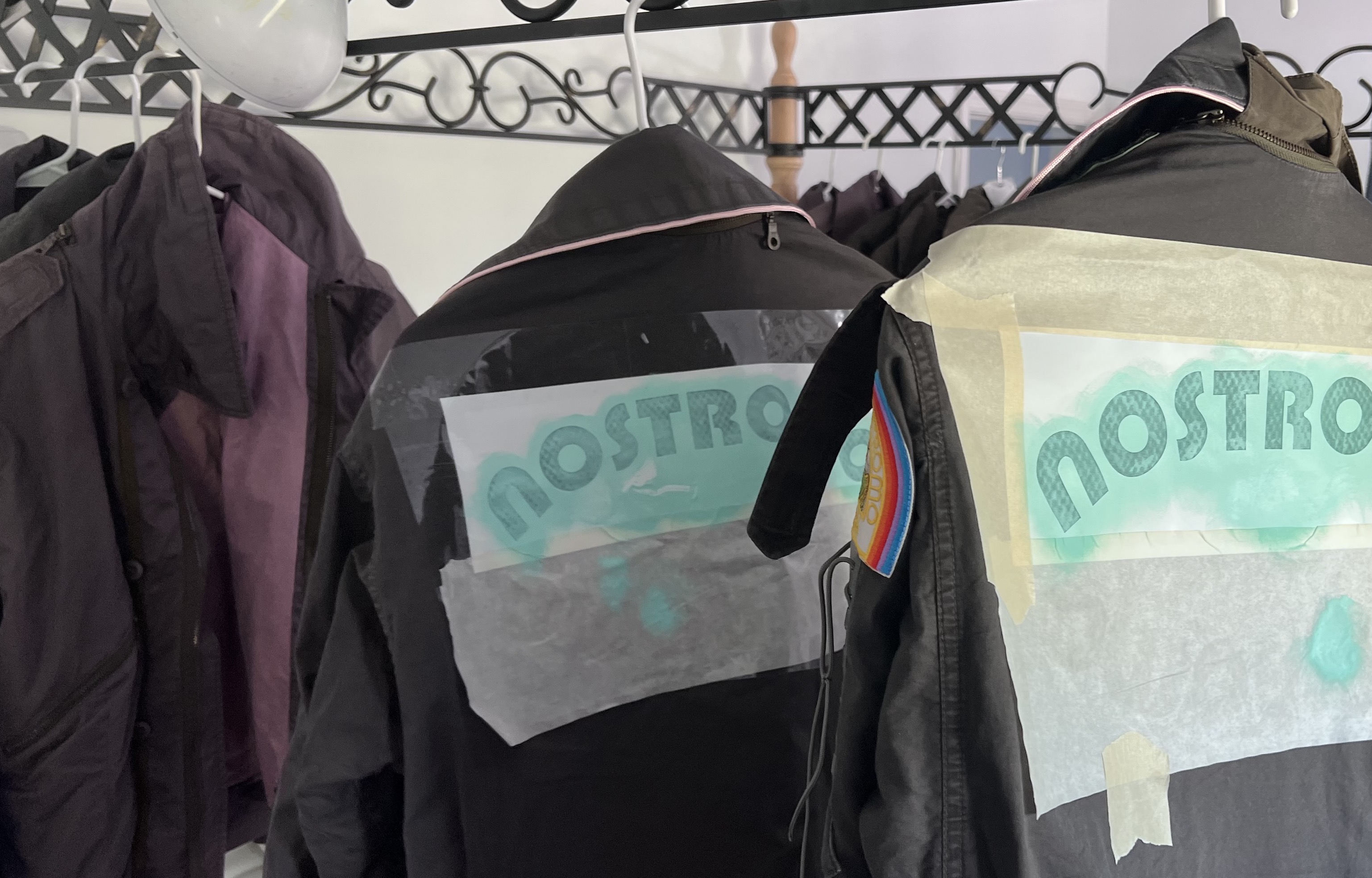

6. Room for Error - Tape all around the stencil to reduce the risk of getting paint on unwanted places.

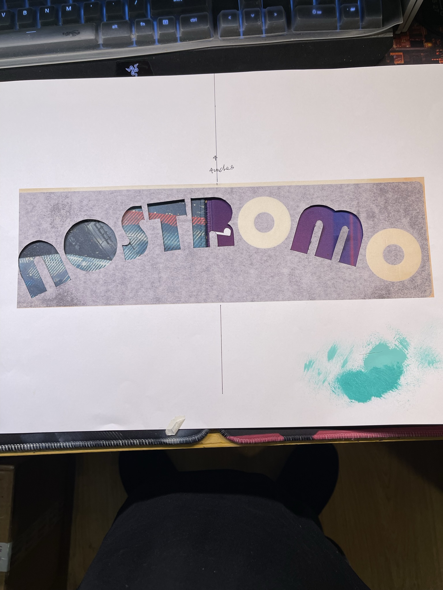

7. Apply the Paint - I use a think sponge and hand apply the paint just a little bit at a time with light tapping against the fabric and you should immediately see the texture come out. Too much thick paint and the texture will be lost. This is because I do not want my print to be a uniformly even perfect print. This being said I do think that mine are still too pretty. They need to be even more unevenly applied.
8. Dry - Once you are happy with the paint job, leave the stencil and all on the jacket and let it dry. Ideally in the sun.
9. Heat Treating - After removing the stencil, it is time to follow the paint’s instructions in order to make the print permanent. Also called CUREING. 300-320℉ for about a minute. You can use a hot iron and parchment paper in between. Make sure to cover the entire text.
10. Done!
Dallas:
Kane:
Hi Adam, wow! When you said you would provide a tutorial, I didn't expect the above. This is a great reference and will be a big help...
By coincidence, when measuring and cutting I came to the same height conclusion as you! lol
