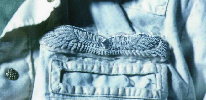

Jacket version of the wings, which is truer to Mollo's original sketch of a straighter 'boxed' shape:
Thanks to a few members of the RPF, namely SG-RB and Funky, [EDIT Sept 3rd: Correction. It was stephen210 and funky]I have been able to get pictures of Kane's original jacket, which is a part of Bob Burns’s collection. These pictures are valuable in order to fully understand the design of the original screen used wings:
Kane jacket original:
Dallas shirt:
These pictures gave me a proper understanding of the making process that went in to these wings, namely the specific threading technique, placement, use of gold or yellow thread in combination with the metallic coil and dimensions of the piece as a whole.

And as they are stunningly beautiful, I couldn’t help but notice that his wings were made from one type of shiny finish metallic thread. Whereas the on screen wings used a combination of shiny and matte finish.
As illustrated here:
And can clearly be seen here, here and here:

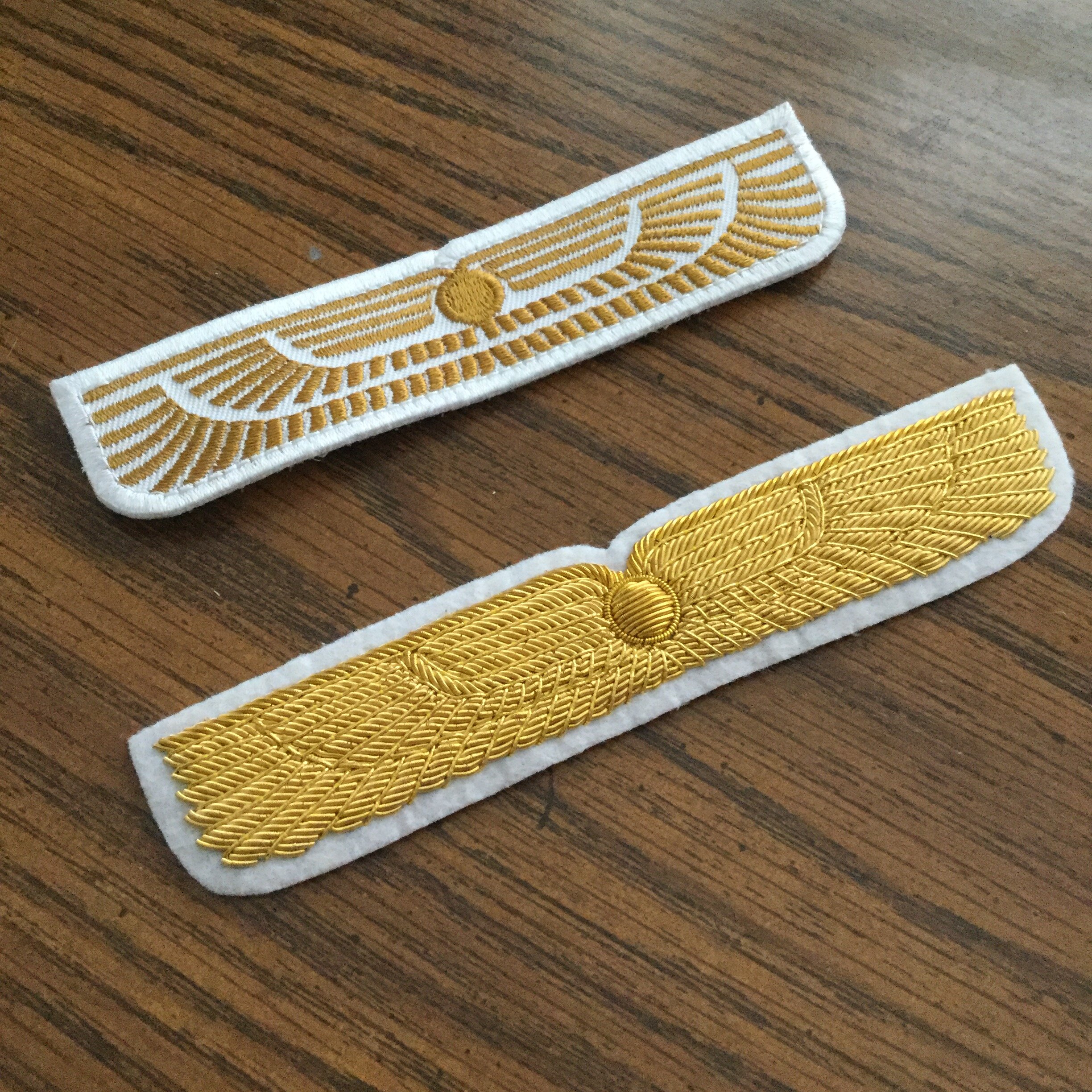

I received mine and the pictures truly don't do them justice! Here's the wings I've been wearing on my jacket (standard patch embroidery from a random ebay seller) next to a pair of these hand-made beauties.

I've been enjoying my new wing set from NostromoCrew . Very solid, highly accurate, and (I think) the best available coat/jacket wings available. Great proportions, well-made, and the different bullion/metallic threads really does add to their look. Gorgeous.
The gold wings at the bottom of the image are from a vendor out of South America. Fun and funky, but...
The gold wings at the bottom of the first image are from a vendor out of South America. Fun and funky, but...
Thank you rickhoward, I'm so glad you are happy with them!
That comparison picture of the machine sewn wings and my wings is the reason I've decided to go down this rabbit hole.. very pleased with the results!
