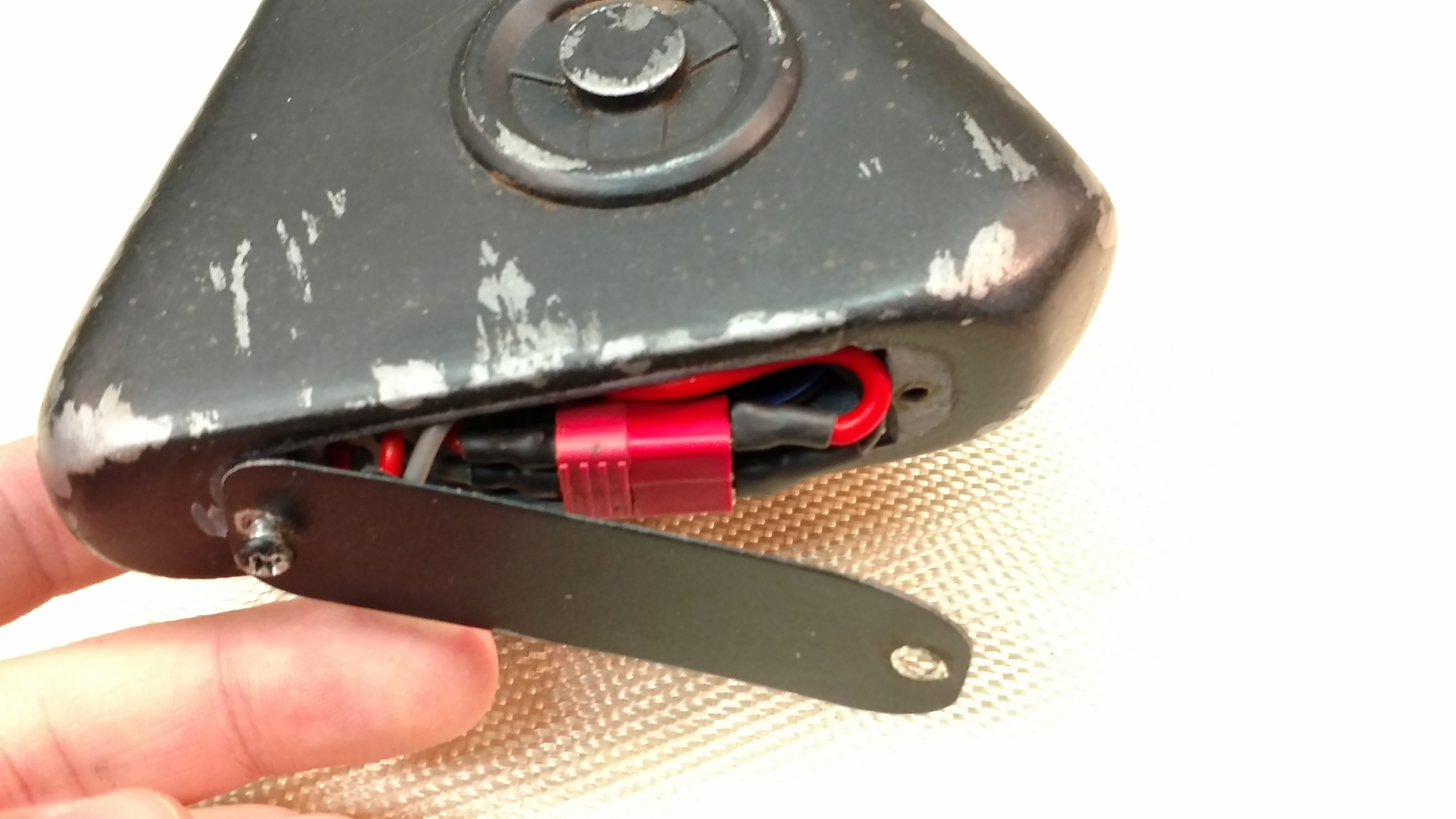

Stock close-up. We cast it with foam inside so that we could easily remove the foam afterwards for the battery, wiring and fuse.
G&P 8.4v Lipo Battery, fuse and wiring
It's a little snug, but everything fits and functions!
