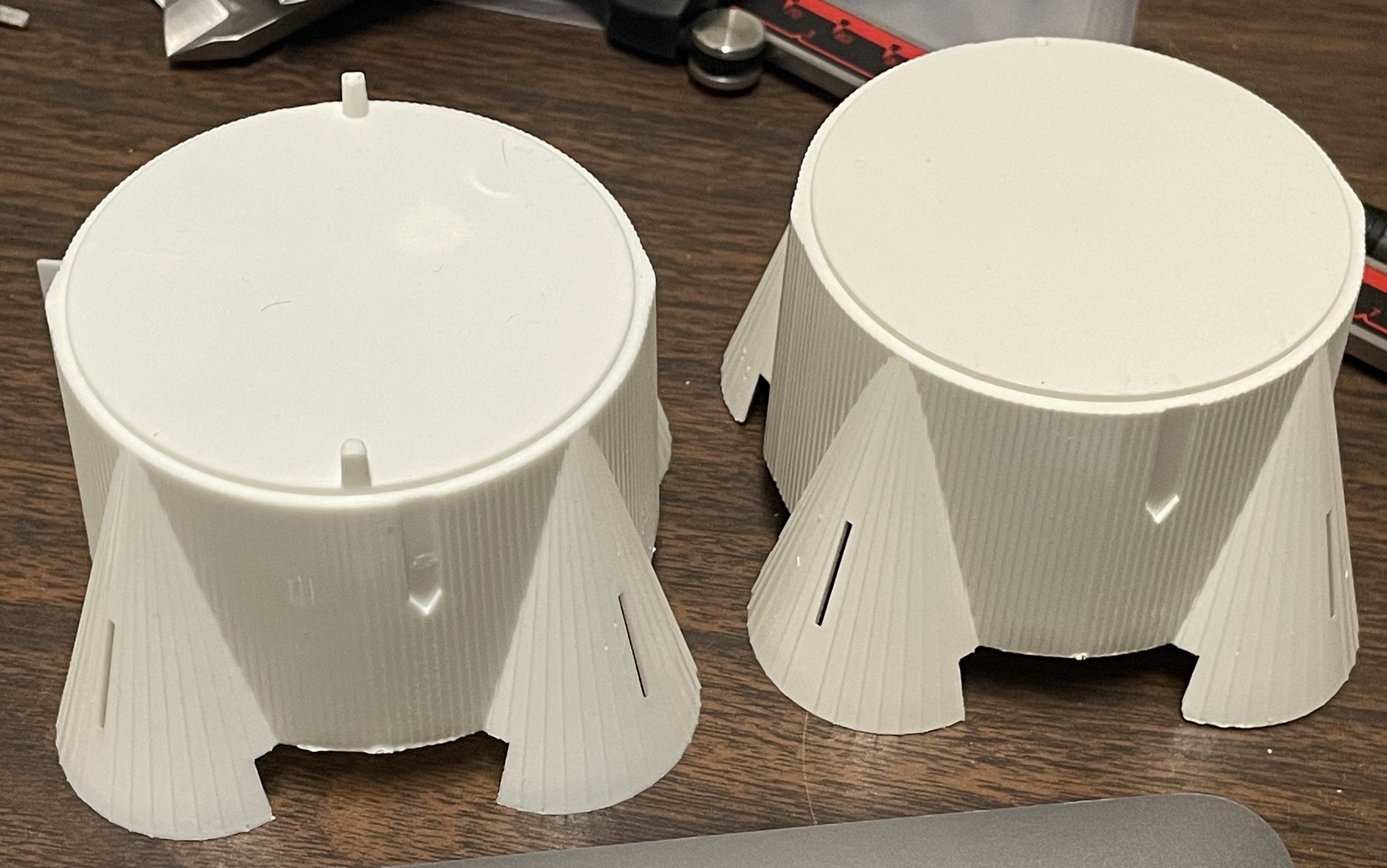

It very much depends on what parts you need. Attached is one example of a change that happened in '81. With the added pins. I'm working on a number of SS subjects that use the square stand and it was driving me nuts trying to figure out when that changed. Again, turns out this was in 81. BTW the square stand actually returns in some later kits, including some versions of the Airfix Vostok of all things.

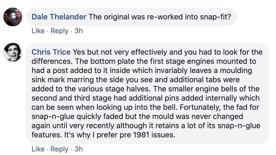

Also here are some notes from one of the old 1999 forums by Chris Trice who has probably forgotten more about SS Airfix kits than most of us will ever know, pointing out how the snap-and-fit re-tool made other, albeit subtle, changes. Again it largely depends on what parts you need and/or if the small changes bother you or not. Study the reference well.
