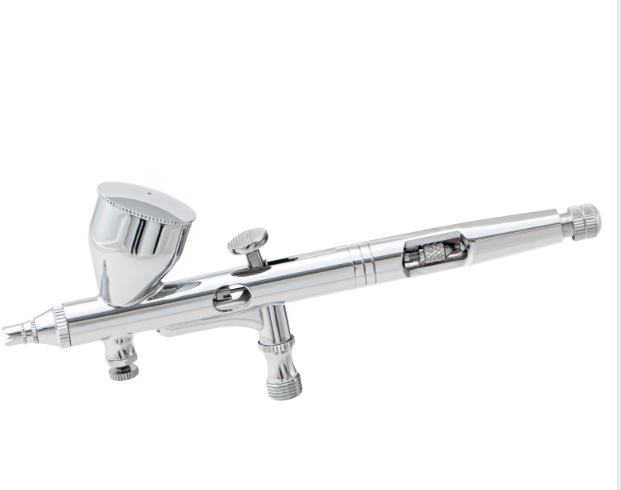

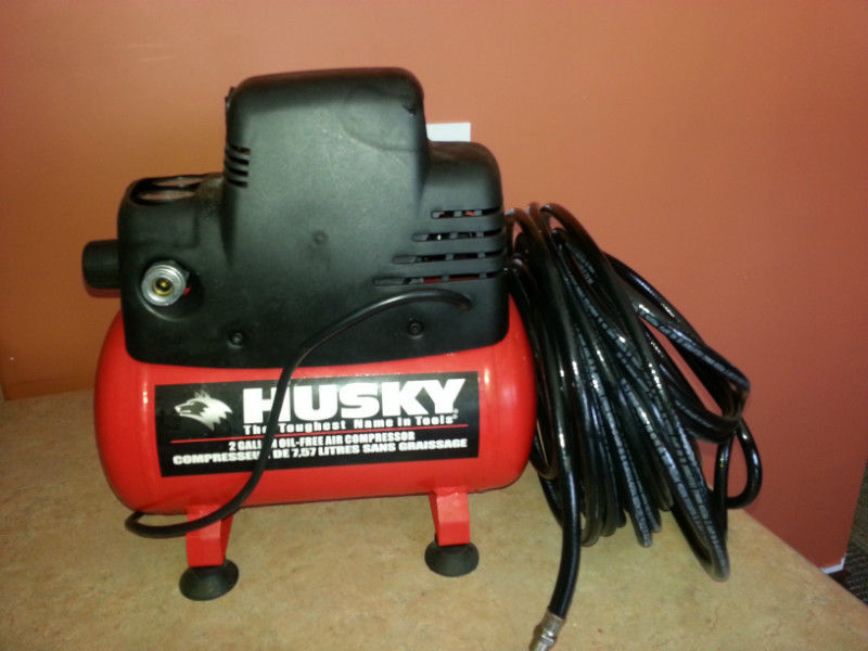

I have never even held an airbrush before but it is time to learn. I am wondering if these would be suitable to learn with or would I be throwing my limited savings away? The only details I have on the compressor are 2 gallon tank, electric, oilless and 0-100 p.s.i.

I'm personally not a fan of oil less air compressors. They tend to be loud and disposable. The only brand I would buy is rolair. Look into them.

Having spent almost 30 years as a commercial illustrator / graphic designer / art director I am partial to double action Iawata's, and a compressed air tank.
If you use a compressor you need an H2O trap between the air out and your brush. It sucks when your compressor spits h2o on your work. Like that never happens.
If your just planing on model work I would recommend a single action Paschae (sp?) or Badger as they are both relatively inexpencive and do the job.

The airbrush is locked down. (I will be watching tutorials on cleaning and care) I will let you know how it works. I have tons of acrylic paints so that's what I'll be using. If you can recommend which tutorials are best I'll head straight to them. As for the compressor the seller claims it's about as loud as a vacuum cleaner. I don't see a water trap on it, thanks for that heads up retiredaguy I'll get one of those. Can I just add one on?Screen Shot 2015-02-08 at 3.11.04 PM.png 777261.jpgSomething like or this? Let me know if you think it's worth "pulling the trigger" on the compressor he wants $45 for it.
