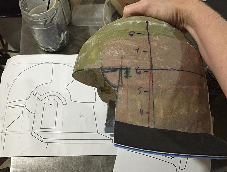

I've been working on an Agent Kallus helmet. As a bearded redhead, there aren't many opportunities to jump on in cosplay...
I didn't 3d model it, I just built 3-way views based on stills from the episodes, and cut out disk-like cross-sections from hardboard. I stacked them up on some dowels, filled the space with foam and I had a 3d form for the helmet. I papier-mached it for a more head-friendly inside, and then fiberglassed it and pulled it off the form. Here it is so far, I just rough-tacked the prototype neck shield in place to see how it looks, It looks weird without the cheek guards.
I see a lot of bondo in my future.
Of course, as I get about 3/4 done someone will probably release a beautiful pepakura unfold and I could have finished it in half the time and a quarter of the work, but I'm learning a lot...
