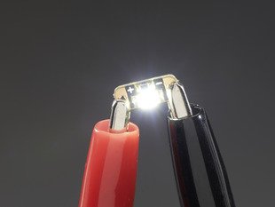

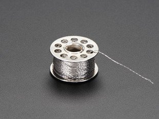

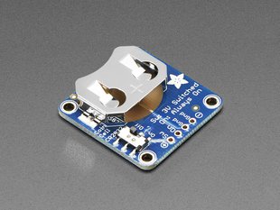

This is the absolute best way to attach LEDs to a costume and they're super bright. Adafruit LED Sequins can be sewed with stainless steel thread. I used the red ones to put some red LED lights on a Blade Runner blaster. All you need are the lights, thread, and a small battery holder with an on/off switch. Links below:
https://www.adafruit.com/product/1758
https://www.adafruit.com/product/640
https://www.adafruit.com/product/1871
