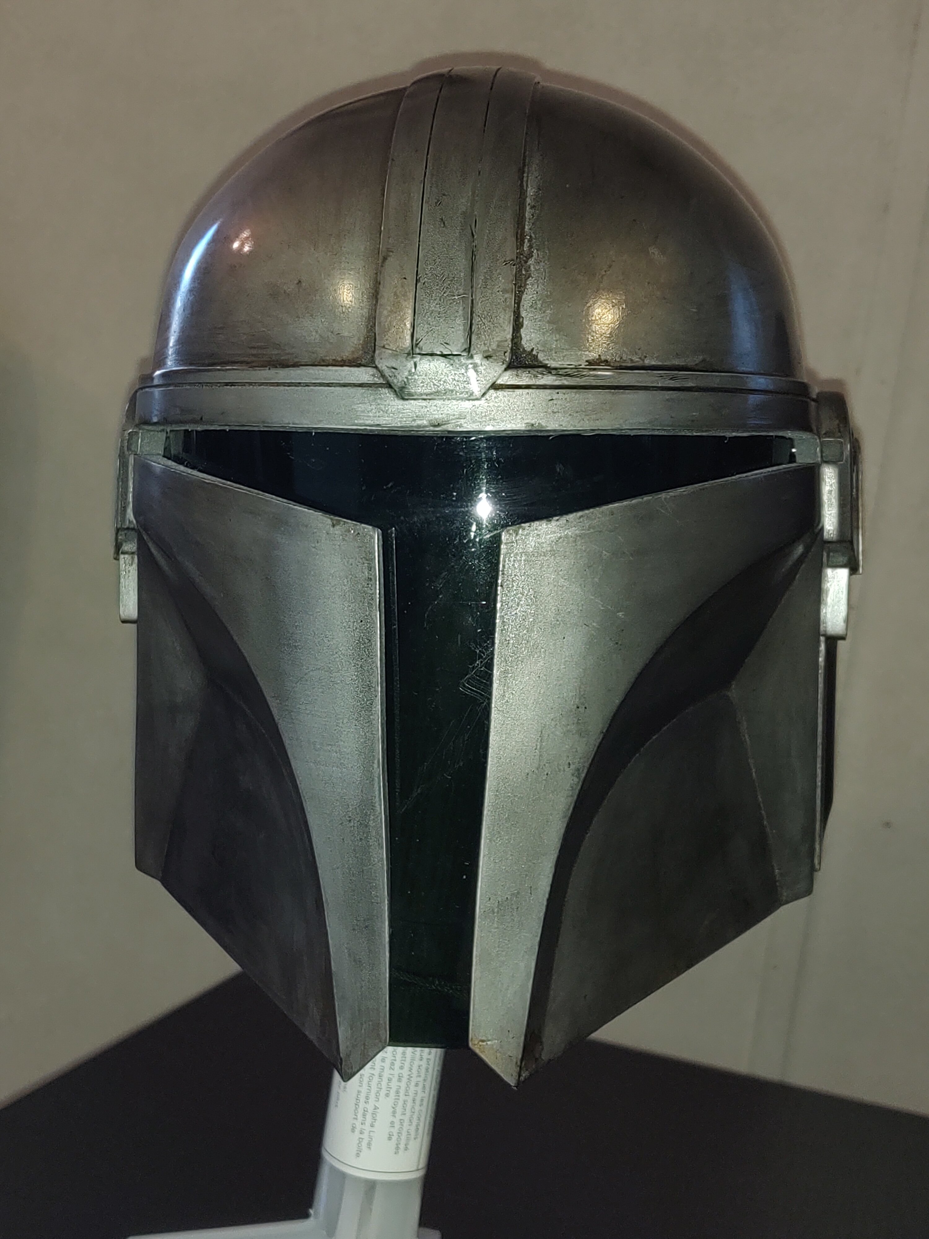

I’ve never used wax.. I’ve always used clear, then acrylic over the clear.. that way if I don’t like it I can wash the acrylic off and the clear coat protects everything under it.. so I don’t have to worry about washing anything off except the acrylic wash I applied
So first clear the helmet, then seal it with floor wax, then weather it & Boom finished? Never heard of using floor wax before. Who else has done this & what floor wax is recommended ?

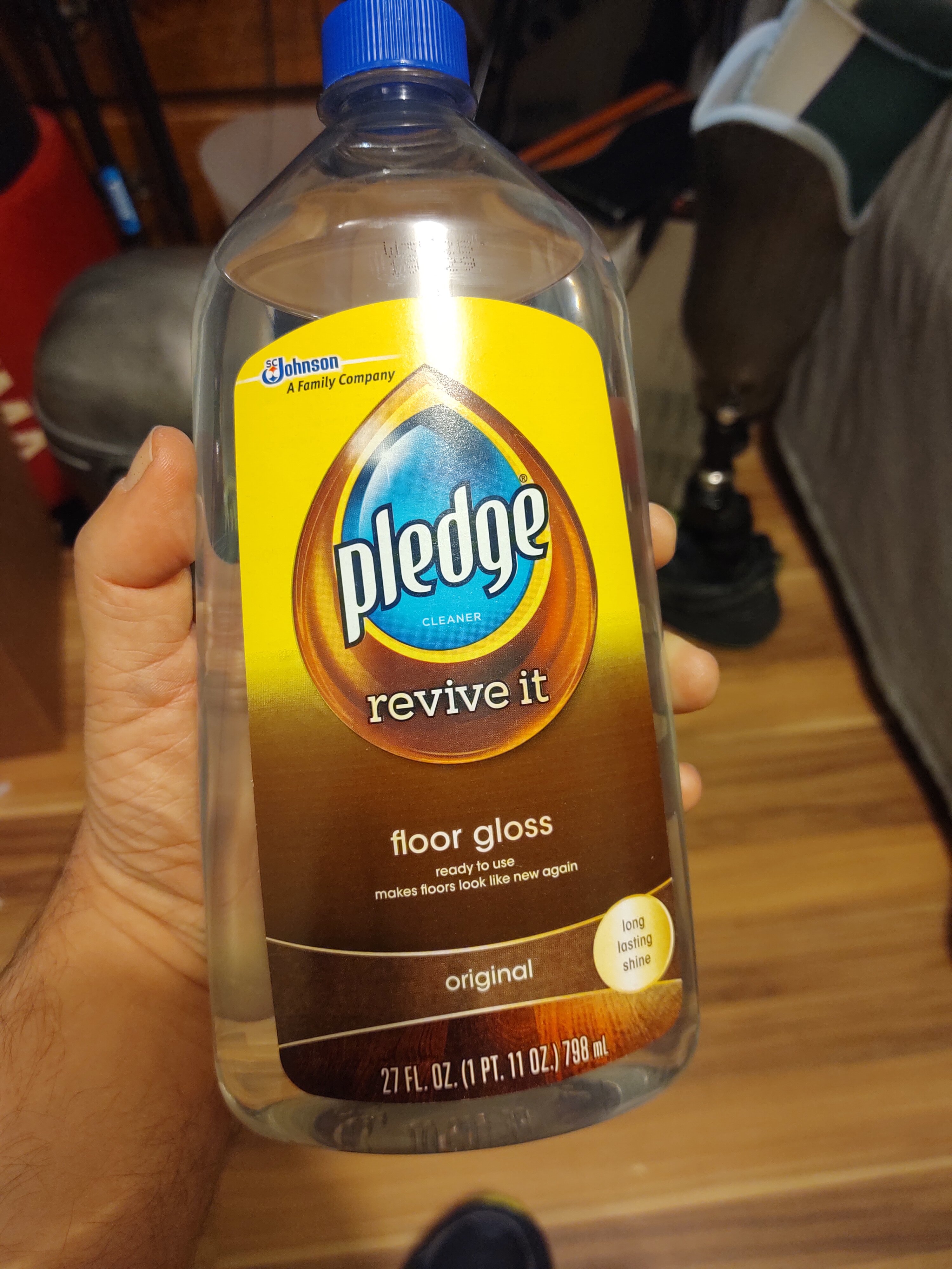

Future floor wax is the go to, it’s a clear liquid acrylic that dries super hard and shiny. Using it as a clear coat is about as old as model kits, I remember first hearing about it from the guys at the hobby shop when I was a kid.
Edit: it’s called Pledge now
Search Youtube for "model pledge". There are multiple videos showing how to clear coat models with Pledge Floor Gloss. It has gone by several names. It used to be called Future.
This is not the Pledge you use for dusting furniture.

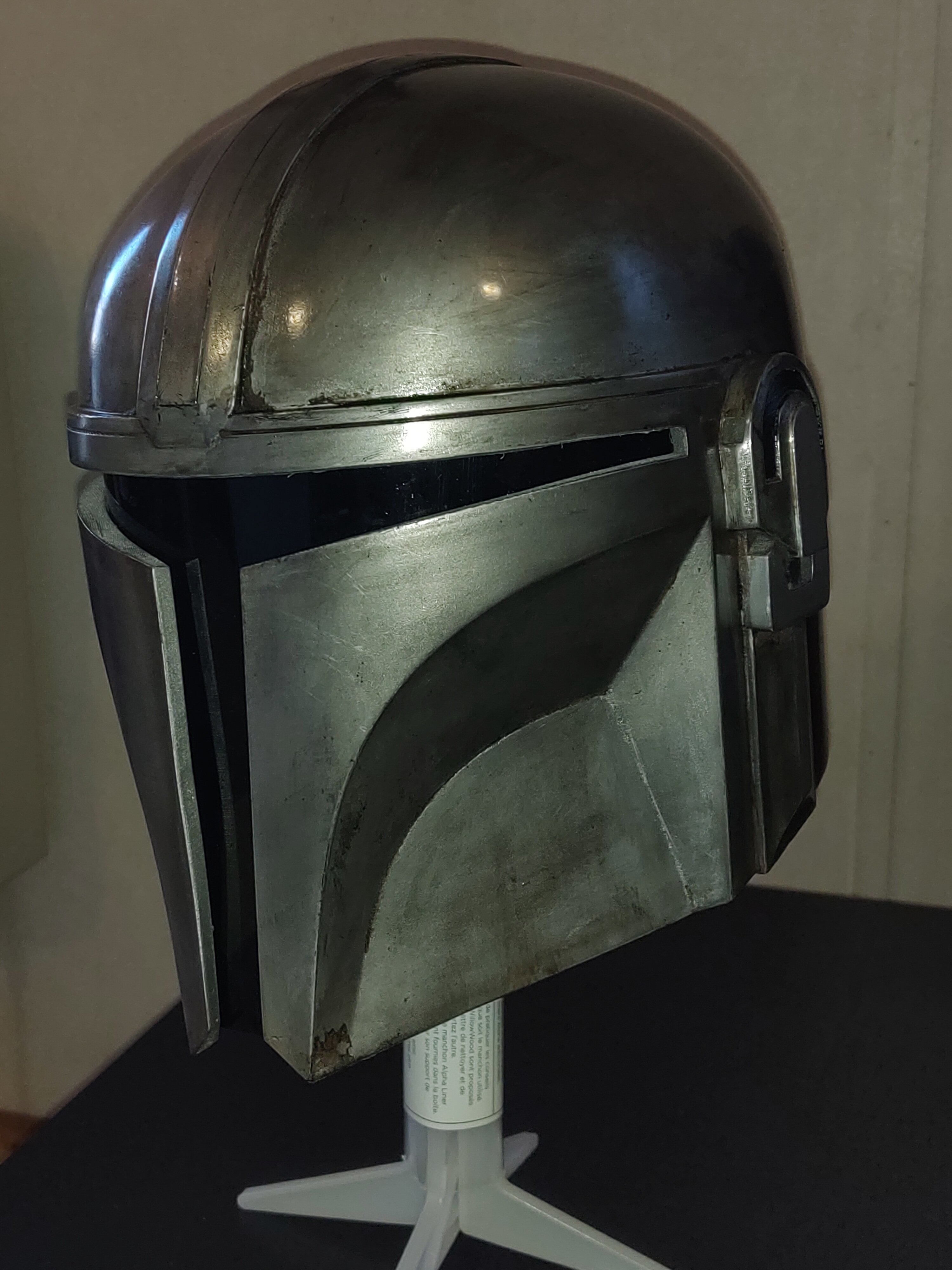

I used it on my 3D printed helmet, but didn't have an airbrush. I just used a nice paintbrush & applied several thin layers. I then used acrylics for weathering & applied a few more coats to seal everything.
So you don't HAVE to use an airbrush if you don't have one.
This is what you're looking for.
Hope that helps.
