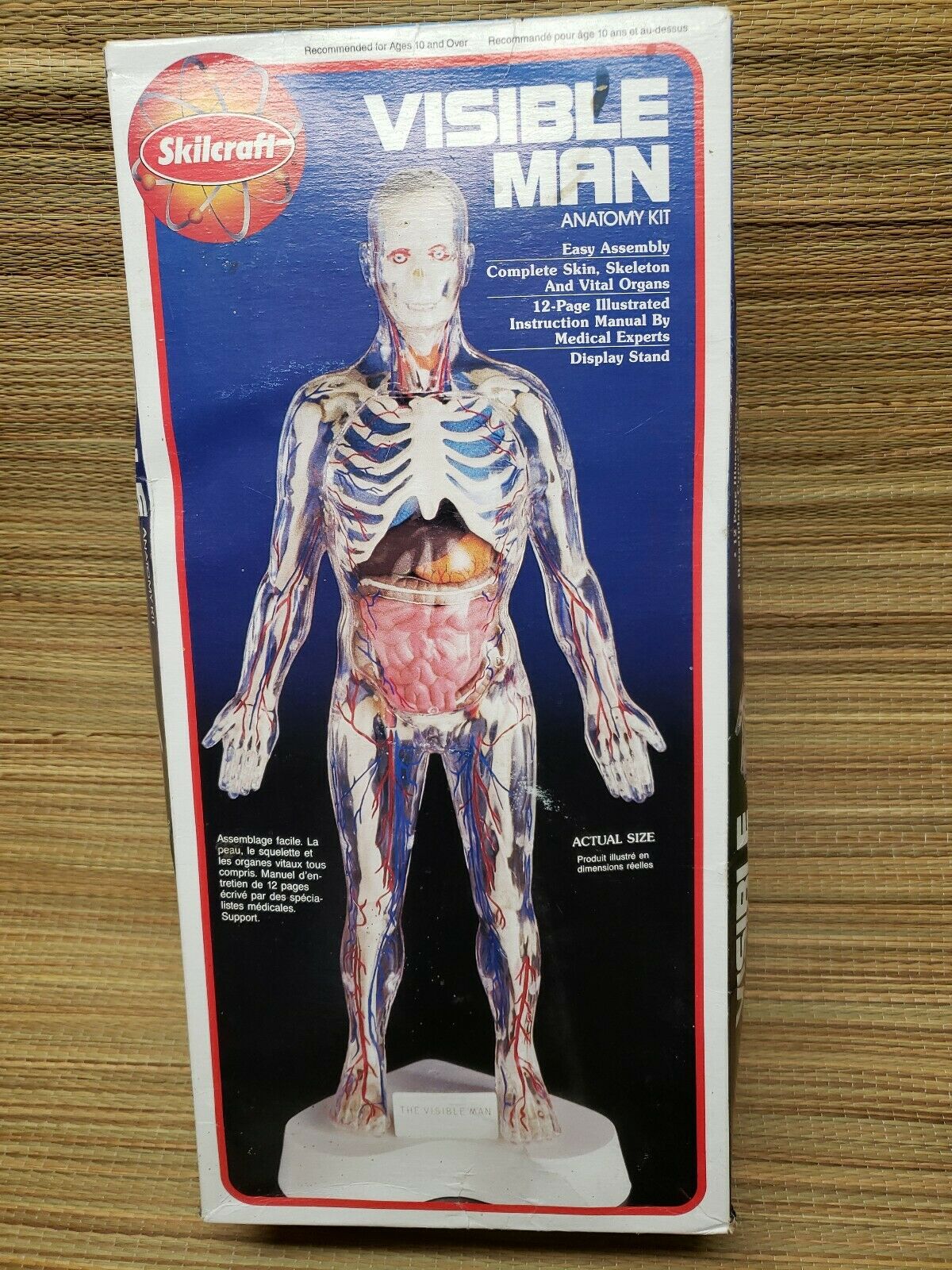

Seeing this...stirs up memories. Going into Max's Toy World (long out of business), the smell of Testors paint...and my dad breaking the pieces and painting them before I could even put them together. Asking when I could help as it was my model mom got me for Christmas. Being told he should handle putting things together...holding the skull for all it was worth because it was the only piece I put together....ugh...it's 1990 all over again.
