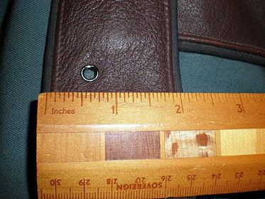

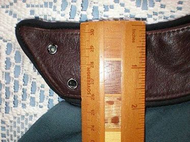

I have a Series 1 Garabaldi uniform myself and know of five others with the EA uniform. A member here, starbuc has an actual uniform from the show and was kind enough to send me photos of the jacket which I want to share them here. Have you decided on which rank you want? You can find the EA chest symbol, rank bar and cloth patches fairly easily online but you will need to scratchbuild the rank pips, collar pip and the jacket
buckle. If you have any questions, please feel free to give me a shout.
These photos are fantastic, exactly what I was looking for! Thank you for sharing them.

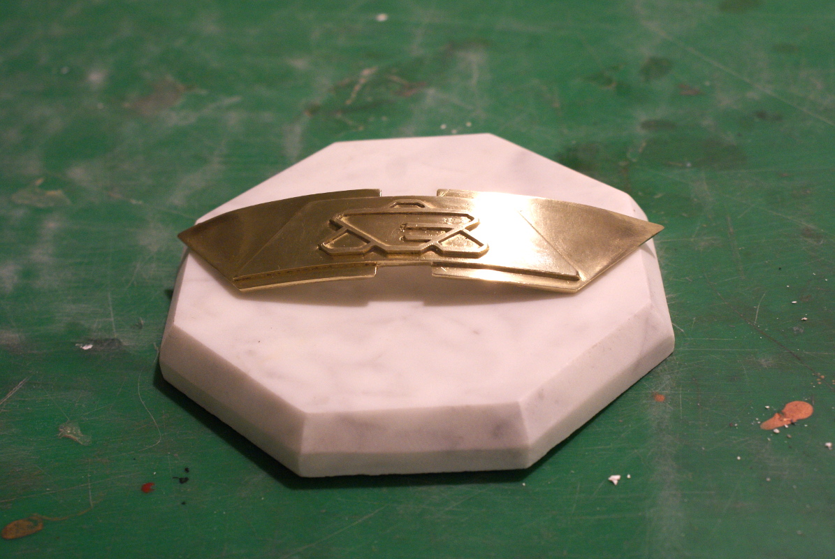

Sheet brass was what I had used for mine and I made some for a few friends as well. Polishing them was all kinds of fun, LOL.

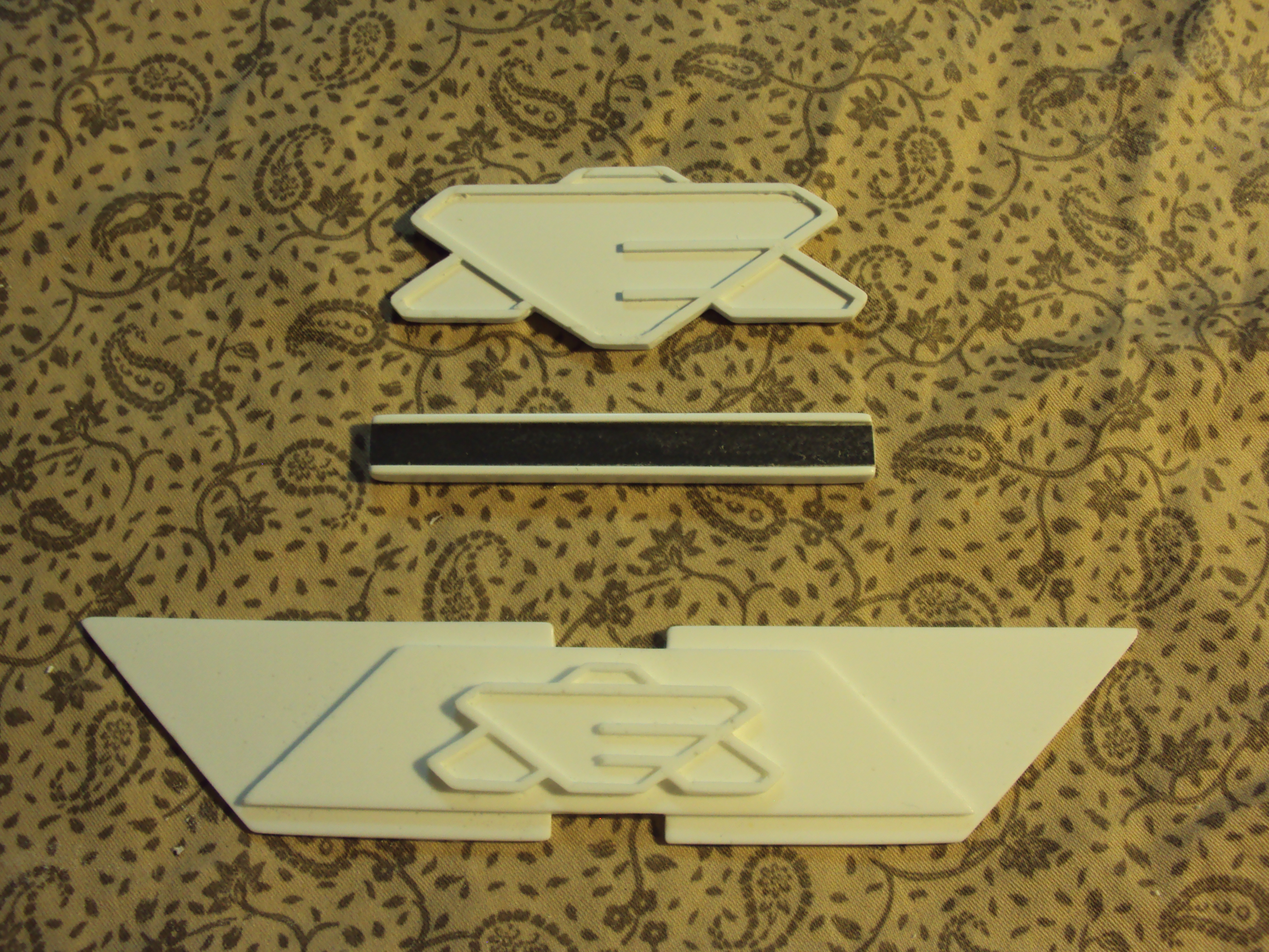

I scratchbuilt all of my insignia including the jacket buckle out of styrene and them made molds to pour resin for them. Sadly, the molds have degraded past the point of use. My buckle is slightly oversized.
Those look fantastic. The only piece I haven't sourced, yet, is the waistband insignia.
There was a woman in the UK who had done them as well as a now defunct costume site. I couldn't find anyone doing the waistband/jacket buckle so I made my own. I did get a metal artist to cast my design in brass but he made it too thick. How are you are scratchbuilding?

I had looked at going the 3D route but the facing of the buckle would have had too many striation lines and need a lot of clean up and filling. Not sure what the new generation of resin printers would turn out but they seem far superior to the filament machines. Another consideration is to go non-officer, you won't need the large leather patch on the front.

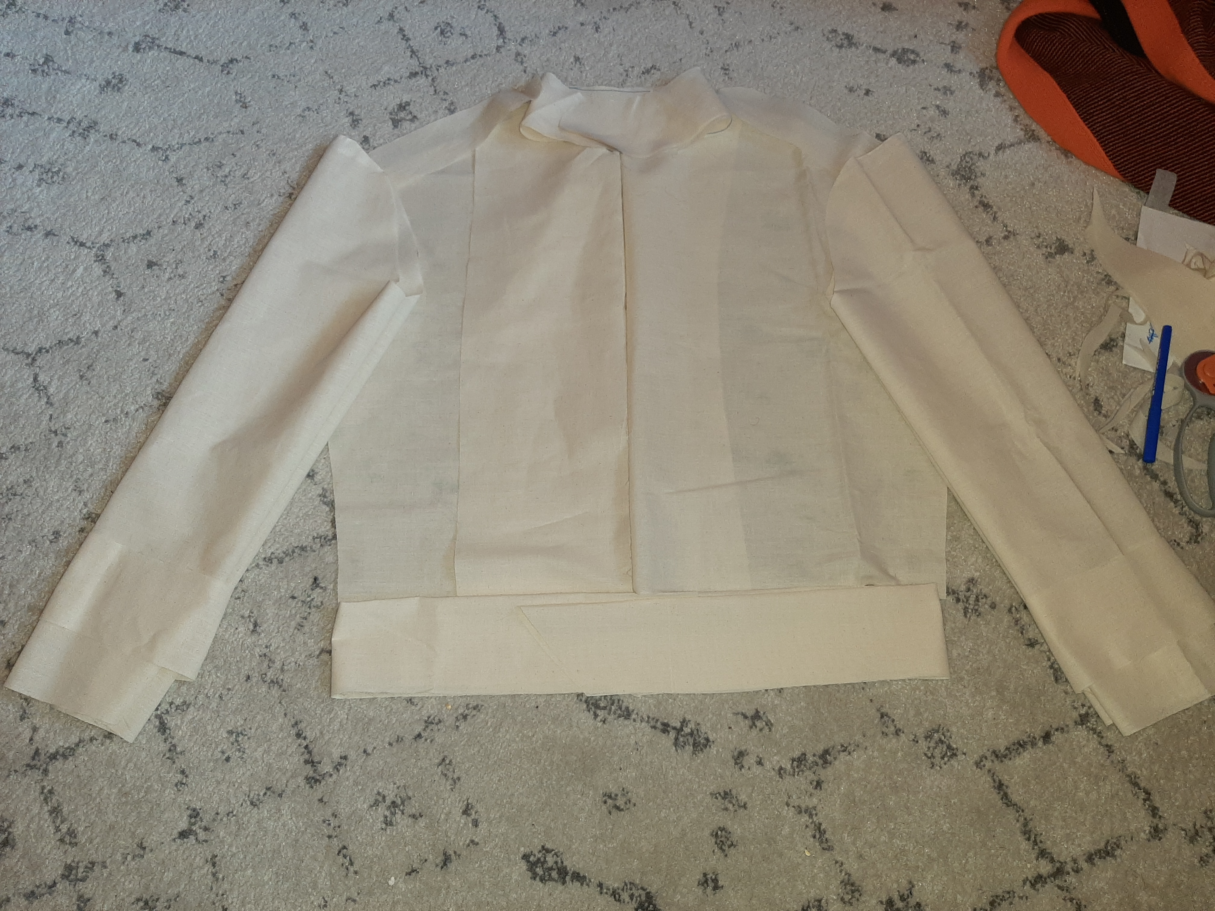

Got my muslin test jacket cut today. Thank you to 19narvik40 for providing photos that helped me get measurements correct.
I've got a lot of piping scraps that I'll use on the test fit, but I think- generally speaking - I'm on the correct path.

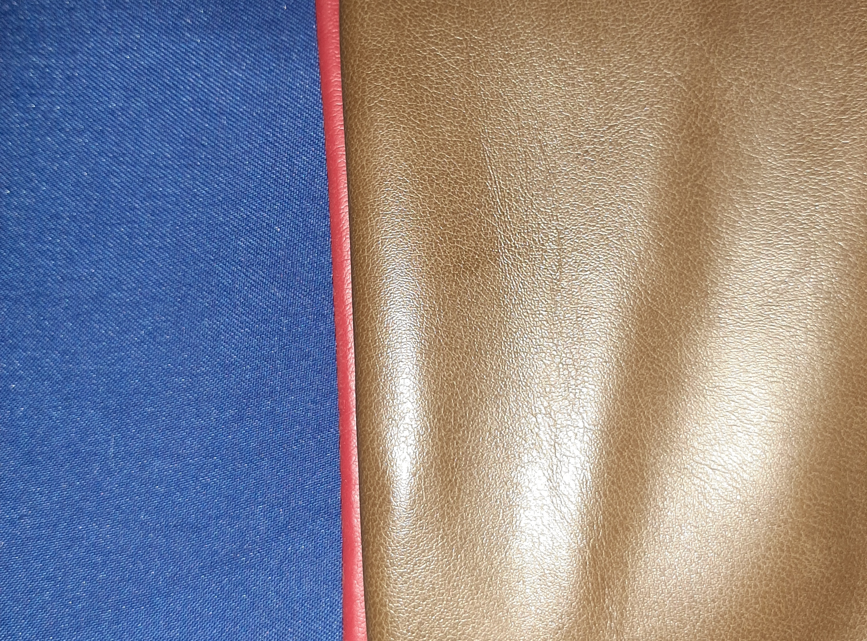

Not a super exciting update, but my gabardine came in today. I'm pretty pleased with this color scheme.
Looks like you have a good match there. Any images from the show make things difficult due to the lighting so that leaves it up to the individual costumer to decide what they want. I've seen darker and I've seen lighter but as long as you are happy with it, go for it !! As soon as my cortisone shot kicks in, I'll venture into the Catacombs for the jacket buckle to get the measurement for you.
Most of the muslin test is sewn together - parts just pinned for now - and I'm really glad I did this because I can tell parts will need to be made a bit larger than the pattern called for to accommodate my shoulder width; shouldn't be too hard. I didn't put trim around the epaulets, either, because it'll be a three-piece application, and I wasn't interested in doing that for the test.
Haven't done anything with the collar yet because that's been giving me fits as it pertains to planning. I think I may have to leave the bottom edge open and do some hand sewing or top stitching to finish it. I guess that's what the test is for.

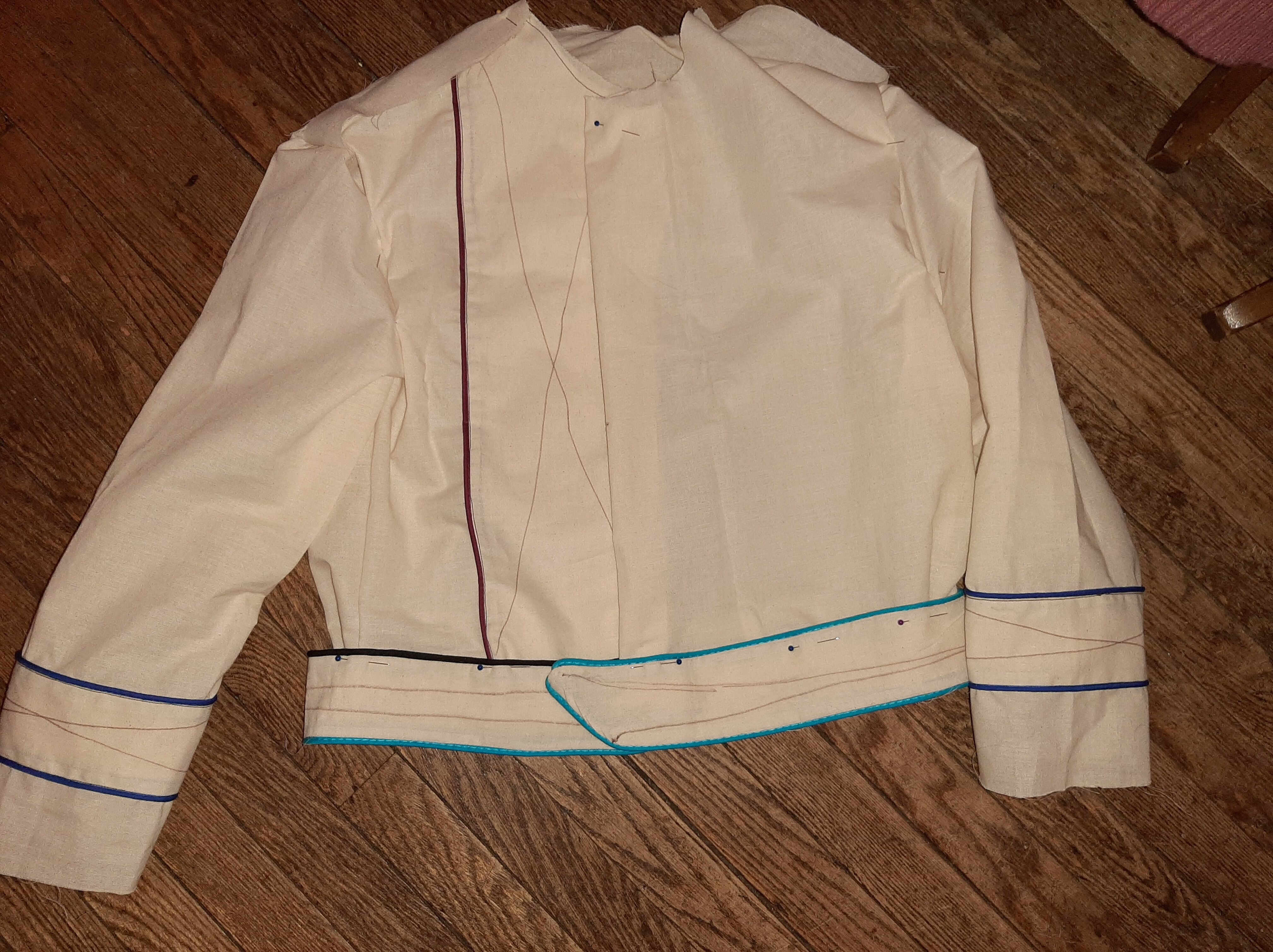

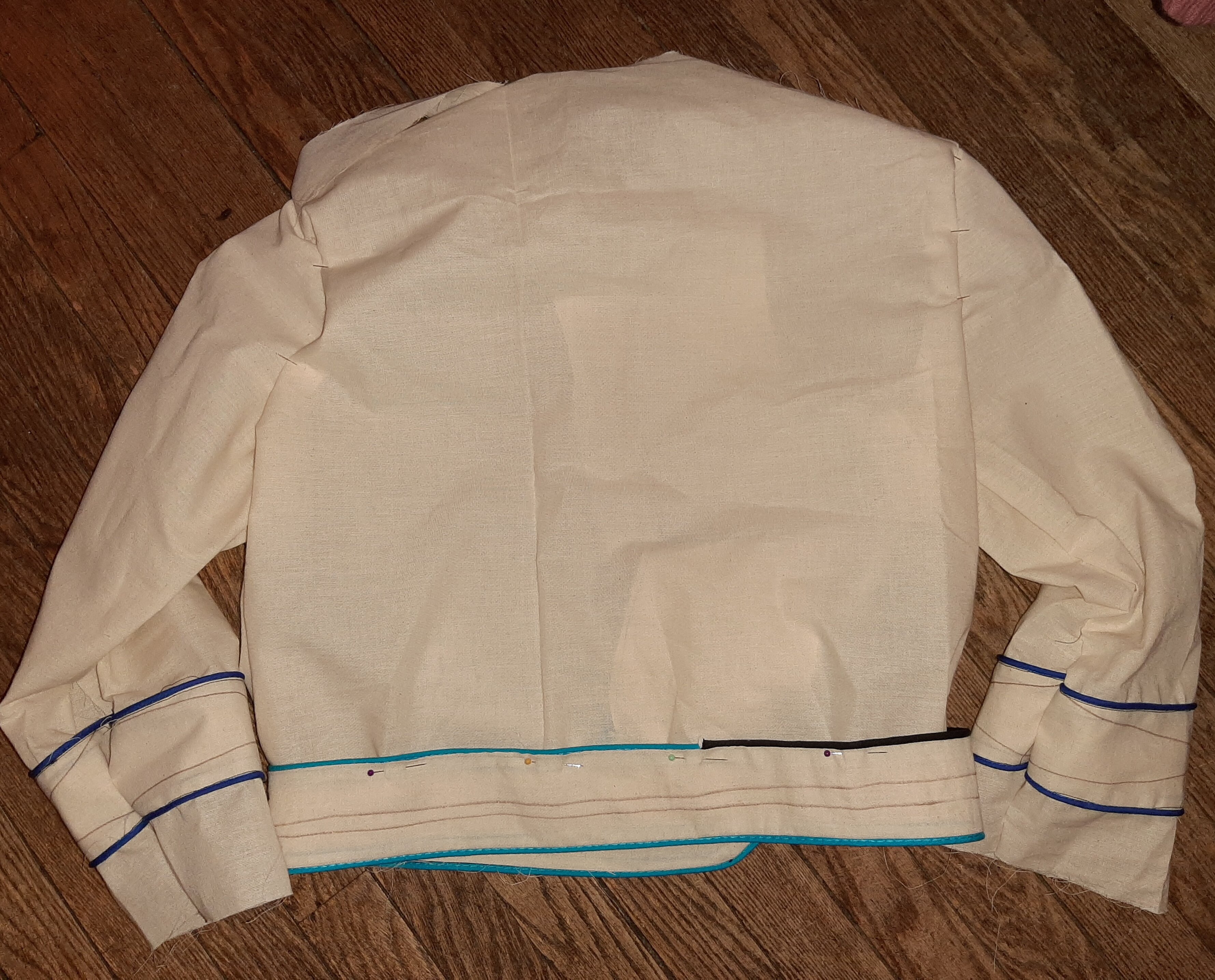

One thing I can see that may be an issue is the 'tab' on the waist that crosses over the center of the jacket. You need to extend it so it ends just below the right hand edge of where the leather chest patch will be. Another is the width of the wrist/arm cuff, you need to make it narrower. I hope these images are of some help.
