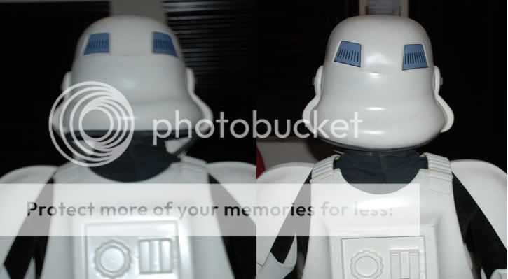

No, sorry, it is not some illusion of photography. Even when the angle is different, the swoops show the same corresponding differences in the amount of curvature. If someone can duplicate the way this Elstree TK helmet looks with one of their replicas, then I'll believe you.
Here's a quick demonstration (sorry for the image quality):
Same helmet and armor (TE), on the same mannequin, from different camera angles with the mannequin looking slightly down and slightly up.
How the cap back is trimmed, and especially how the neck trim is configured, could make quite a difference as well.
Most certainly the angle of how any single helmet is viewed matters, but what I mean is that for different helmets the amount of curvature appears to be different, so I was curious how much curvature was originally sculpted in. That is a good comparison and if you can show an angle like the one Brian showed it might be helpful...
Here you go:
I took several shots, and this was the closest match.
The TIE detail piece seems to suggest a straight line that might make you not notice the swoop, especially when viewed from this sort of angle.
