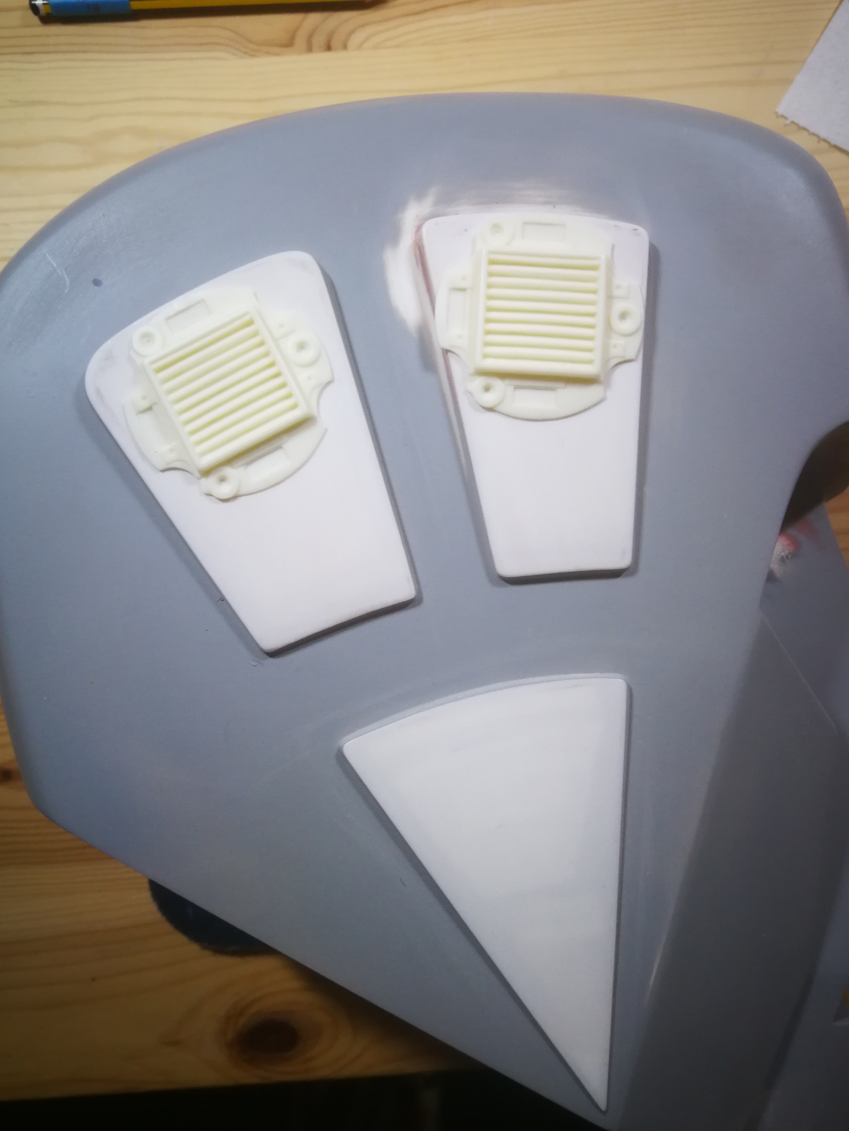

The grills overhang the front side plates on both sides of the head, i will put a small fillet under those to support the thin cross section of the grills,
it can be left as is or removed with a file or dremel.
if i leave it without they will just snap off especially taking it out of the mold. i certainly don't want to make the plates larger so they don't overhang cause i'm down with the droids dawg.

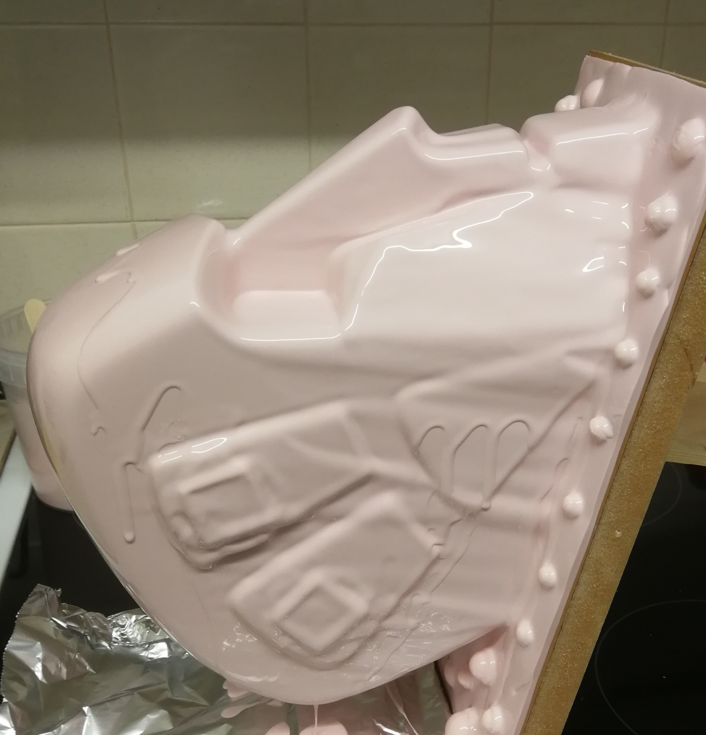

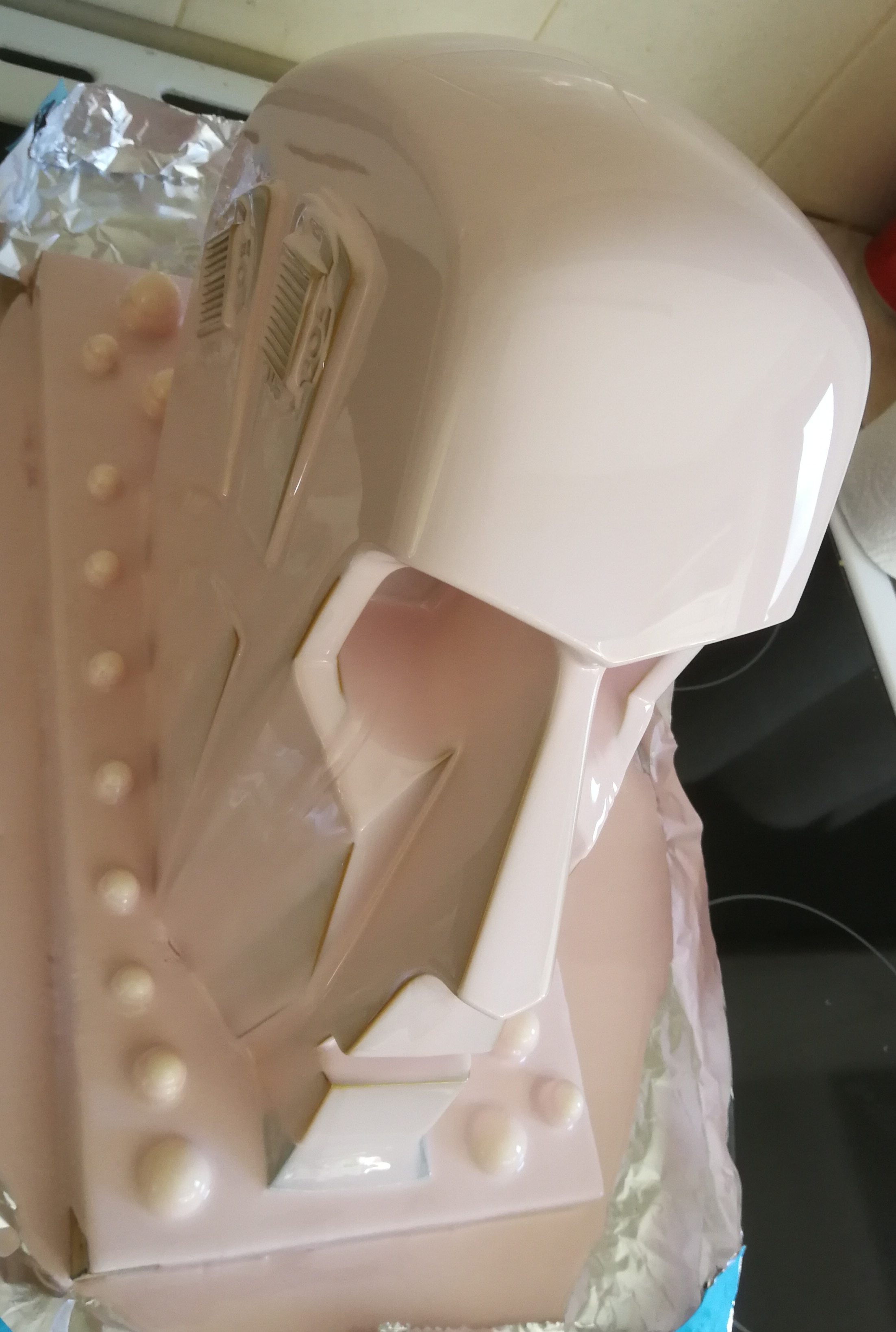

silicone got degassed for the initial 2 layers
tilted him back to fill the eye sockets with coat 2
i added a further 8-10mm of thixo silicone layers to build up the wall thickness,

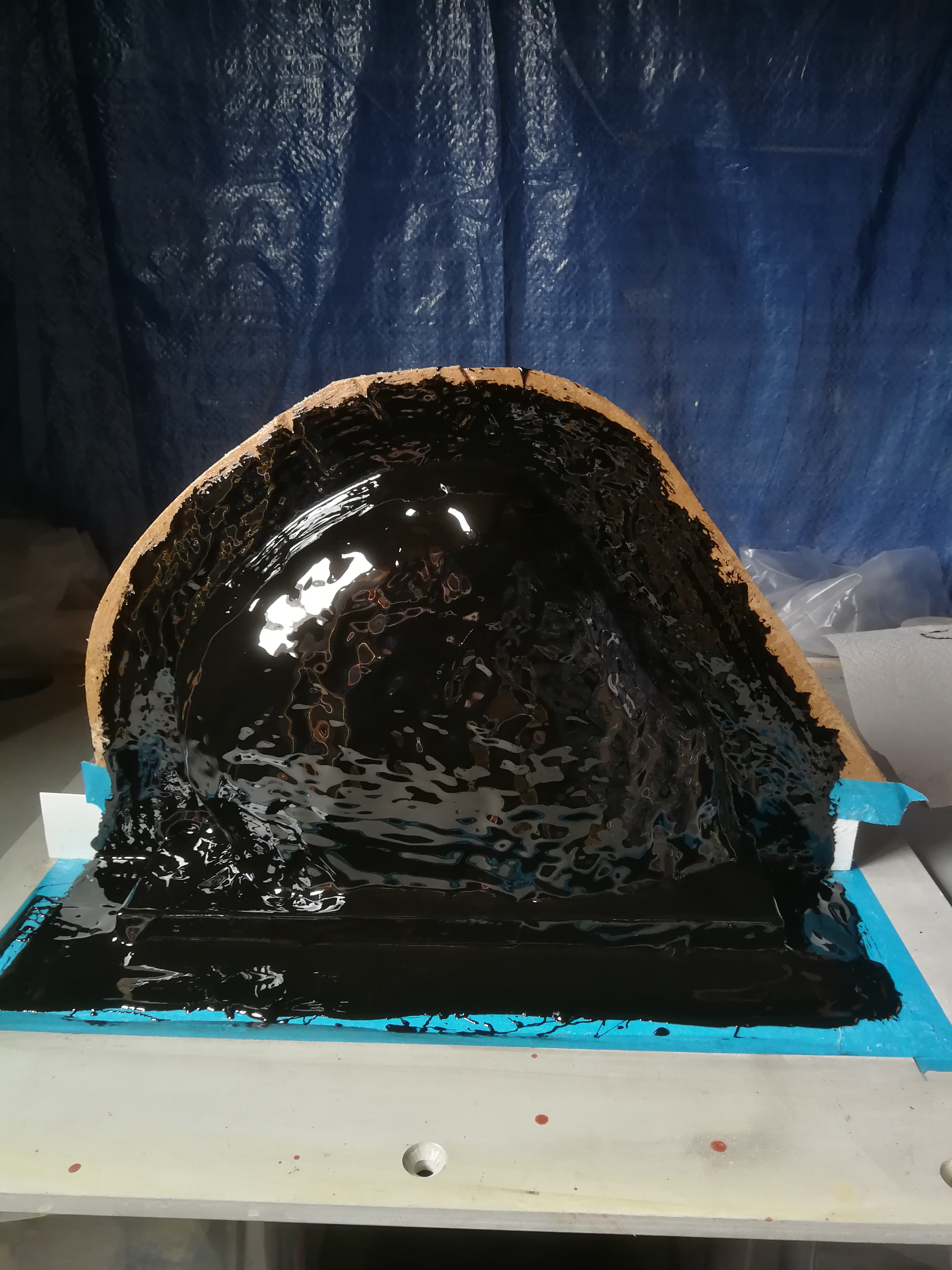

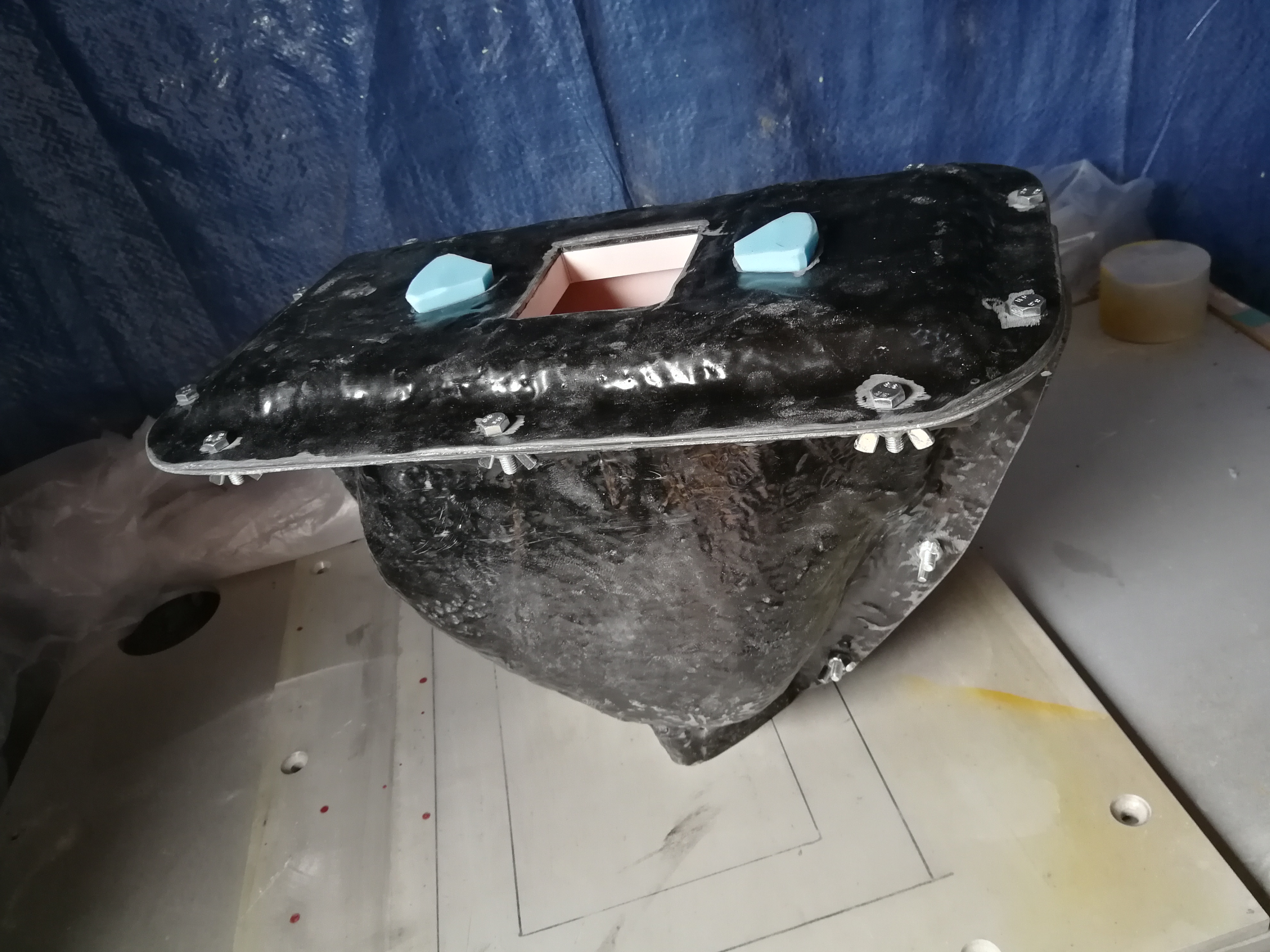

then took him outside to to my tiny work area, the first of the mother mold shells waiting to cure
this is where he is at right now. gel coat-fiberglass layer-gel coat
other half tomorrow.........
i hope to have a casting by the weekend if it all goes well.

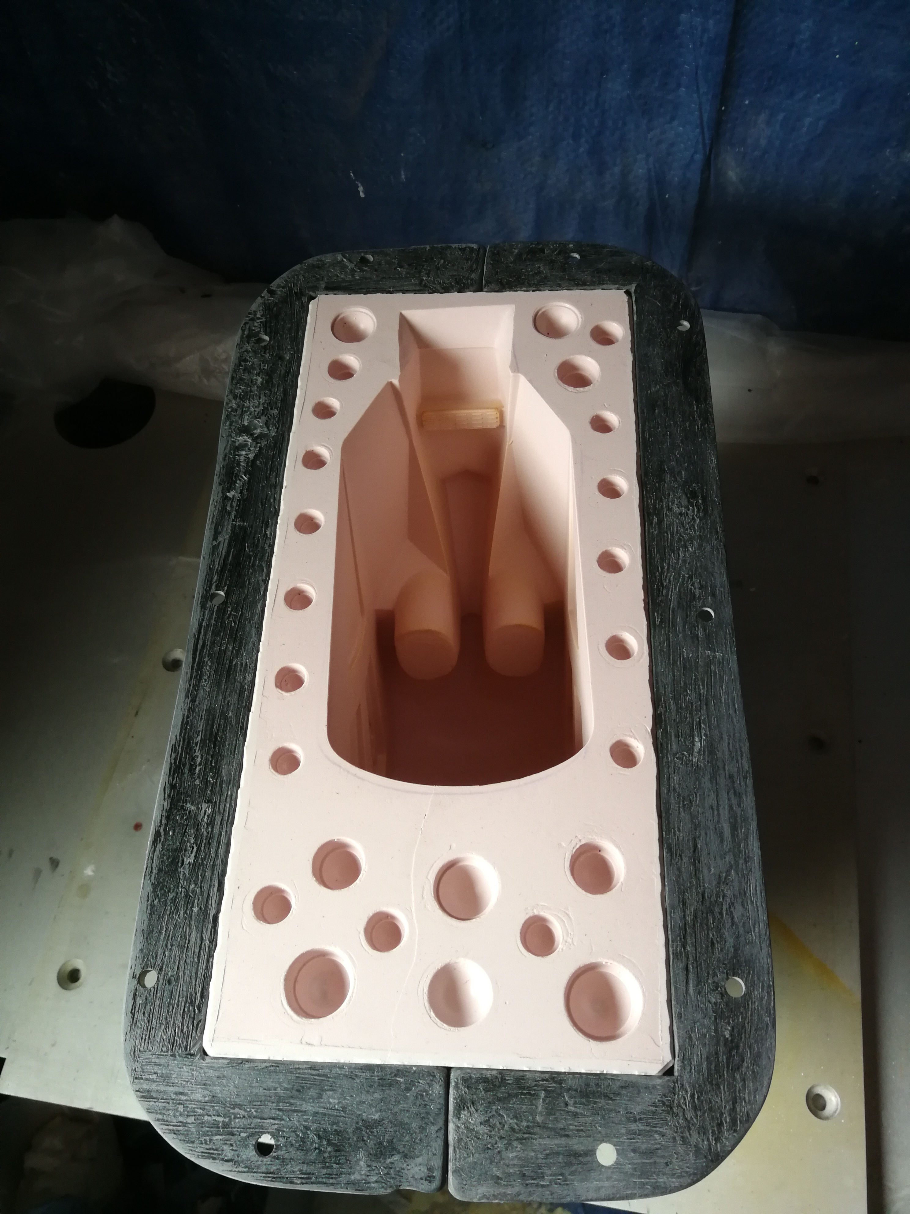

got the mold sorted out today, just finishing up the silicone plug for the square hole on top. i have to make my molds a different way now as i have a behemoth of a rotocasting machine, i can't use it at the moment due to lack of space, but anyway here it is. ill just hand cast it for now. this is about 6 days work. did i ever tell you i hate making molds?

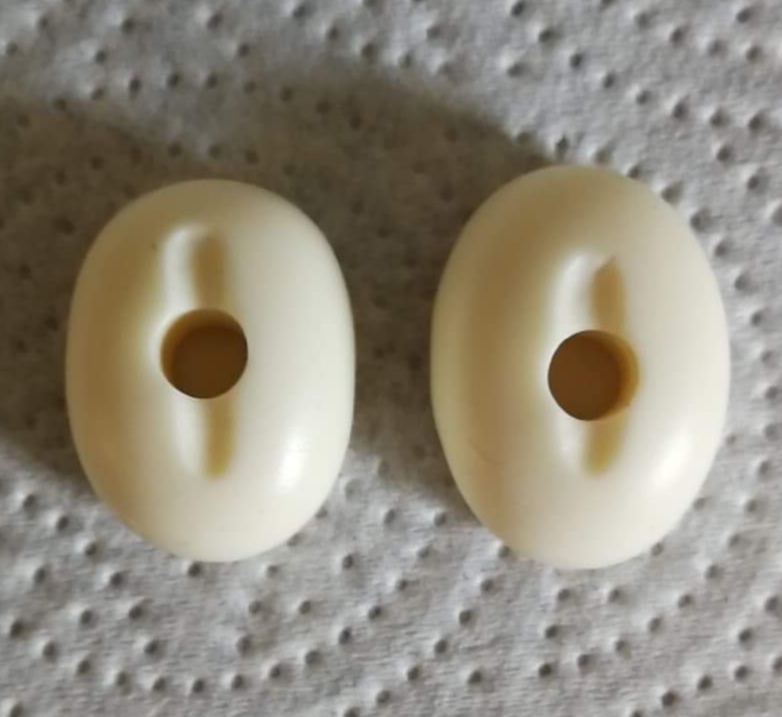

i forgot to show the eyes, they are 2 separate sculpts, this is how you see them looking at the droid. the right one is larger and slightly different shape, the groove on each eye is different also, i've tried to replicate this as close as possible, there is also a tiny dent or groove on the lower right one which i need to add.
i have aluminium tube that is inserted onto the hole and a warm white flat top led inside that.

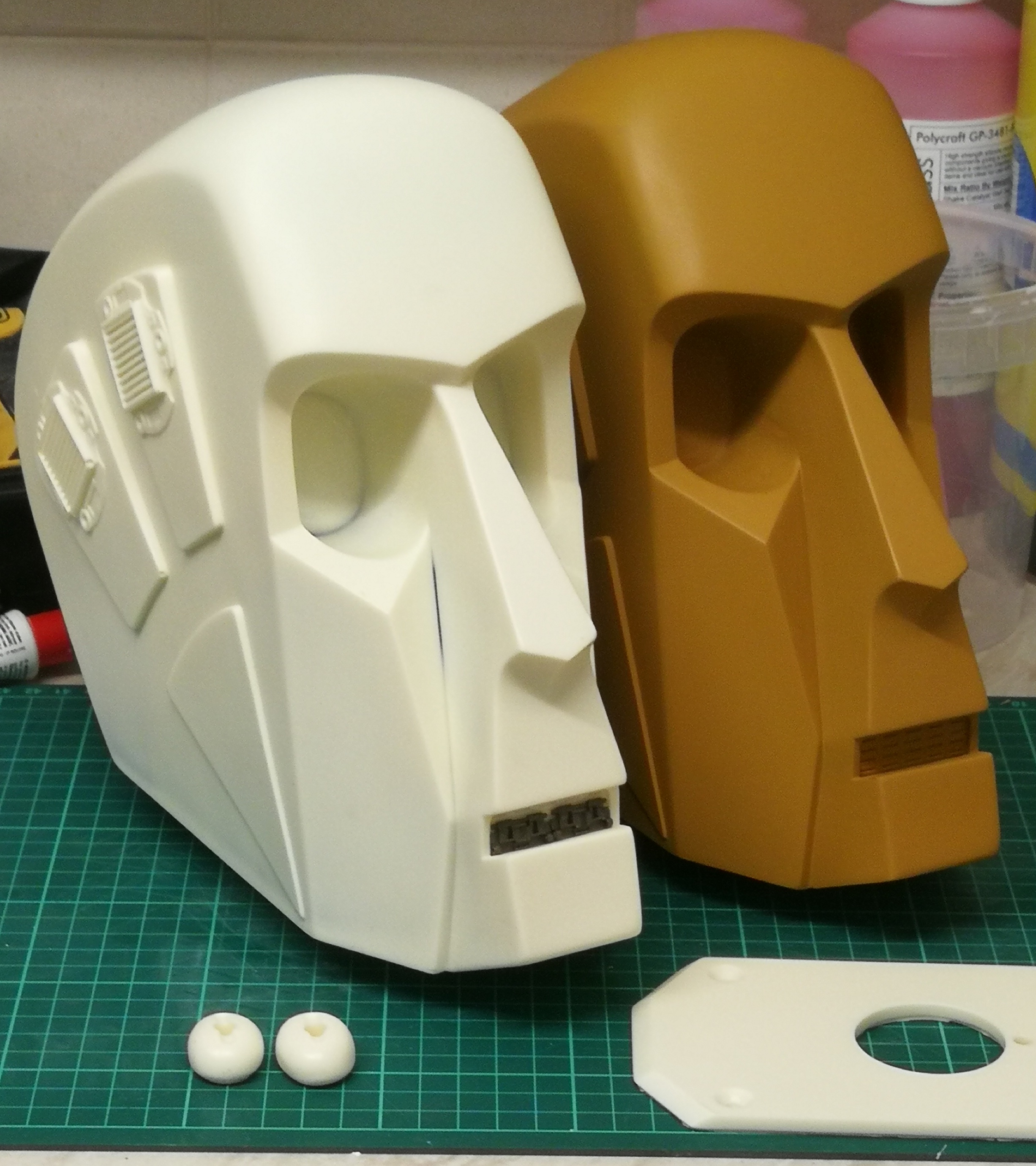

hope to have a head cast tomorrow if all goes well.

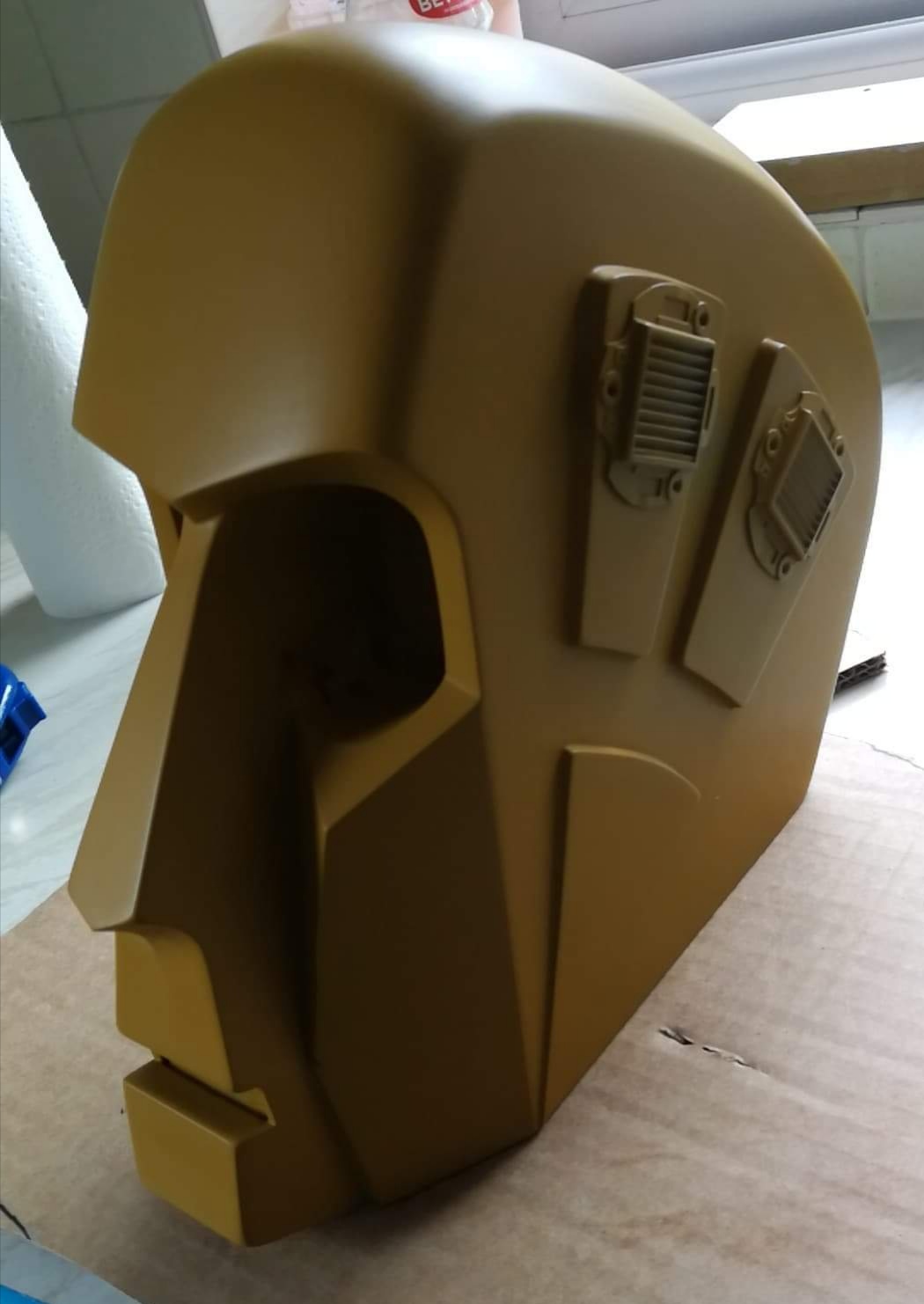

this is the master head from which the above mold was taken
smooth as a babies.......
