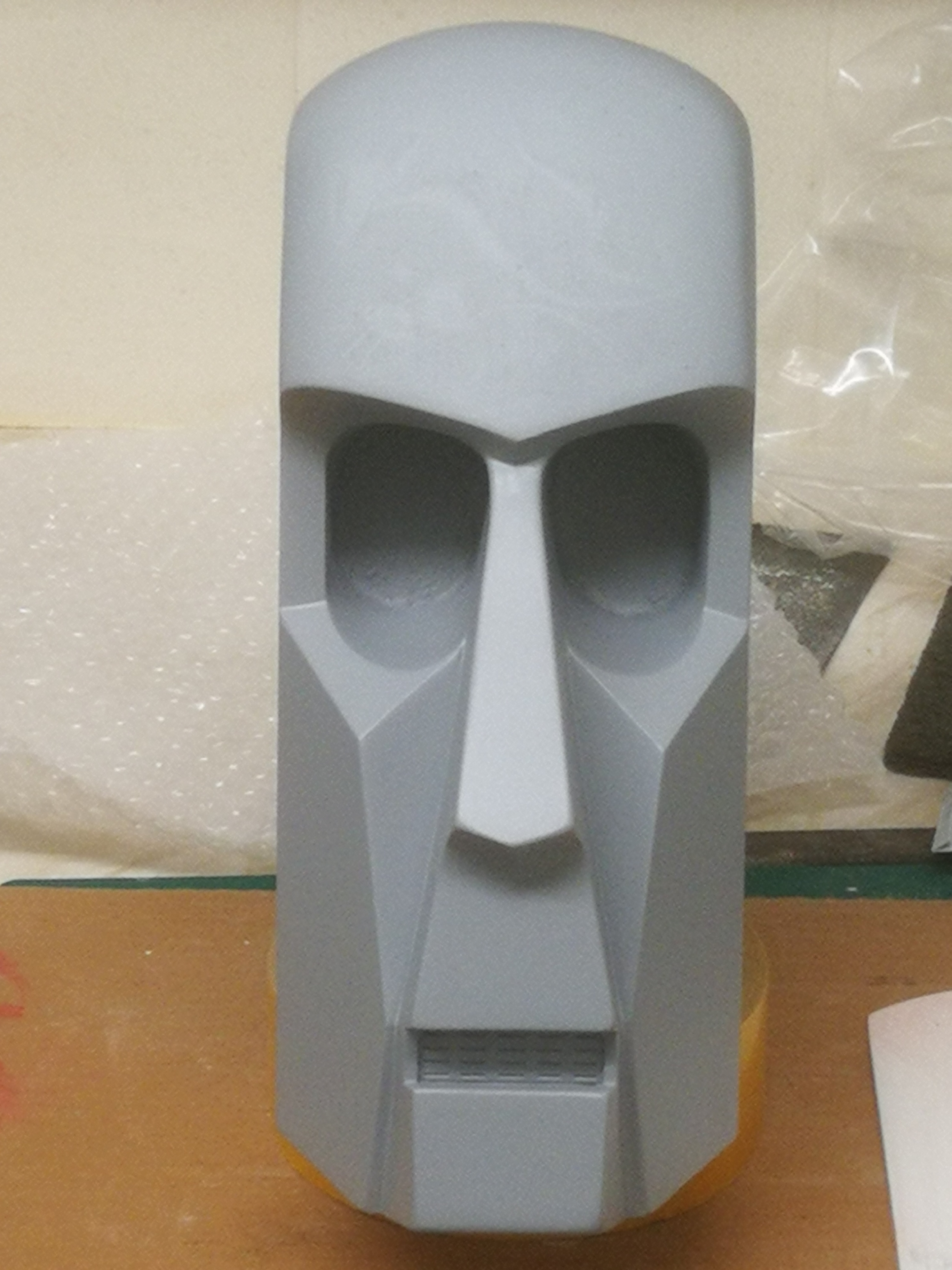

i want to get this as square as possible, i used a sandwich of sculpting foam in the interior with 2mm plastic card on the external surfaces, i want to use thick plastic card this time as the last sculpt tended to warp, i'll get the general shape at the rear and top first to get the proportions and angles then work on the face, getting the face right is the no.1 priority, the other parts are easy ish so they can wait. side plates and grills will be last.

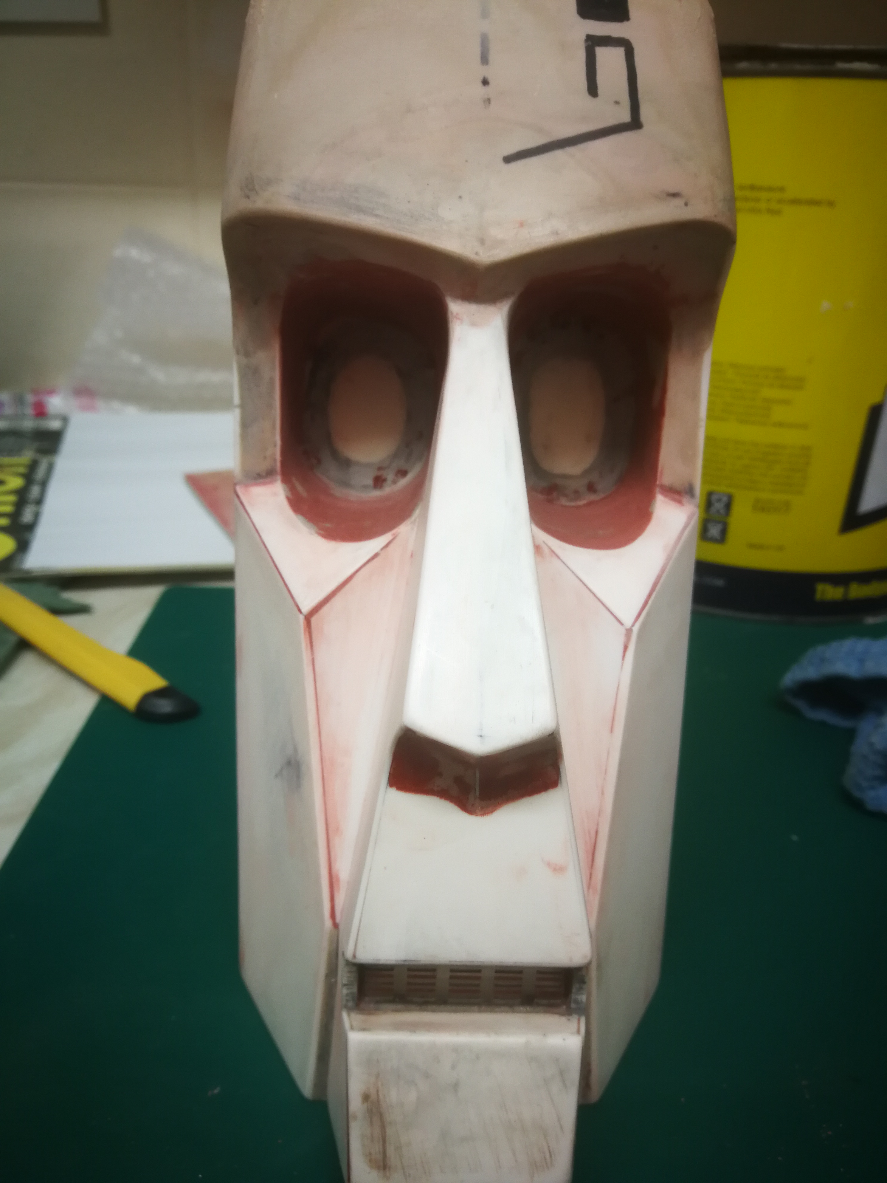

sides of the nose done, nose attached and nostrils blended in.
getting the angles down is pretty tricky, i'm also rounding off corners and edges just like the real one, the chin is particularly bad (good? i don't know). the 2 edges either side of the grill are quite rough so i've tried to incorporate that.
i brush paint on from time to time just to check for seam lines where the plasticard plates meet.. i must point out they are visible in places on the real droid, i'm going to try and avoid that because im like that.
its not pretty under the skin but its just a master and just needs to survive being molded.

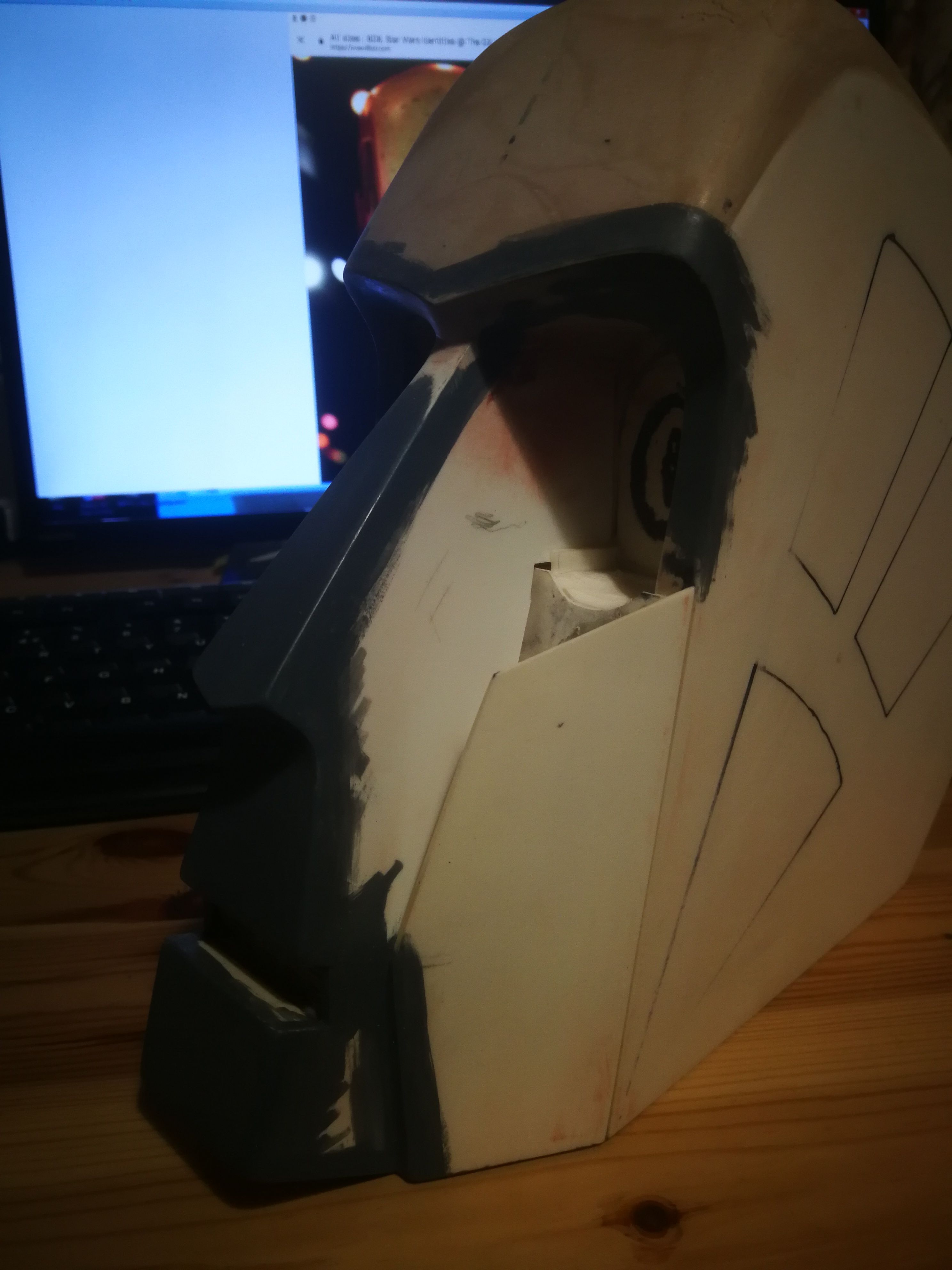

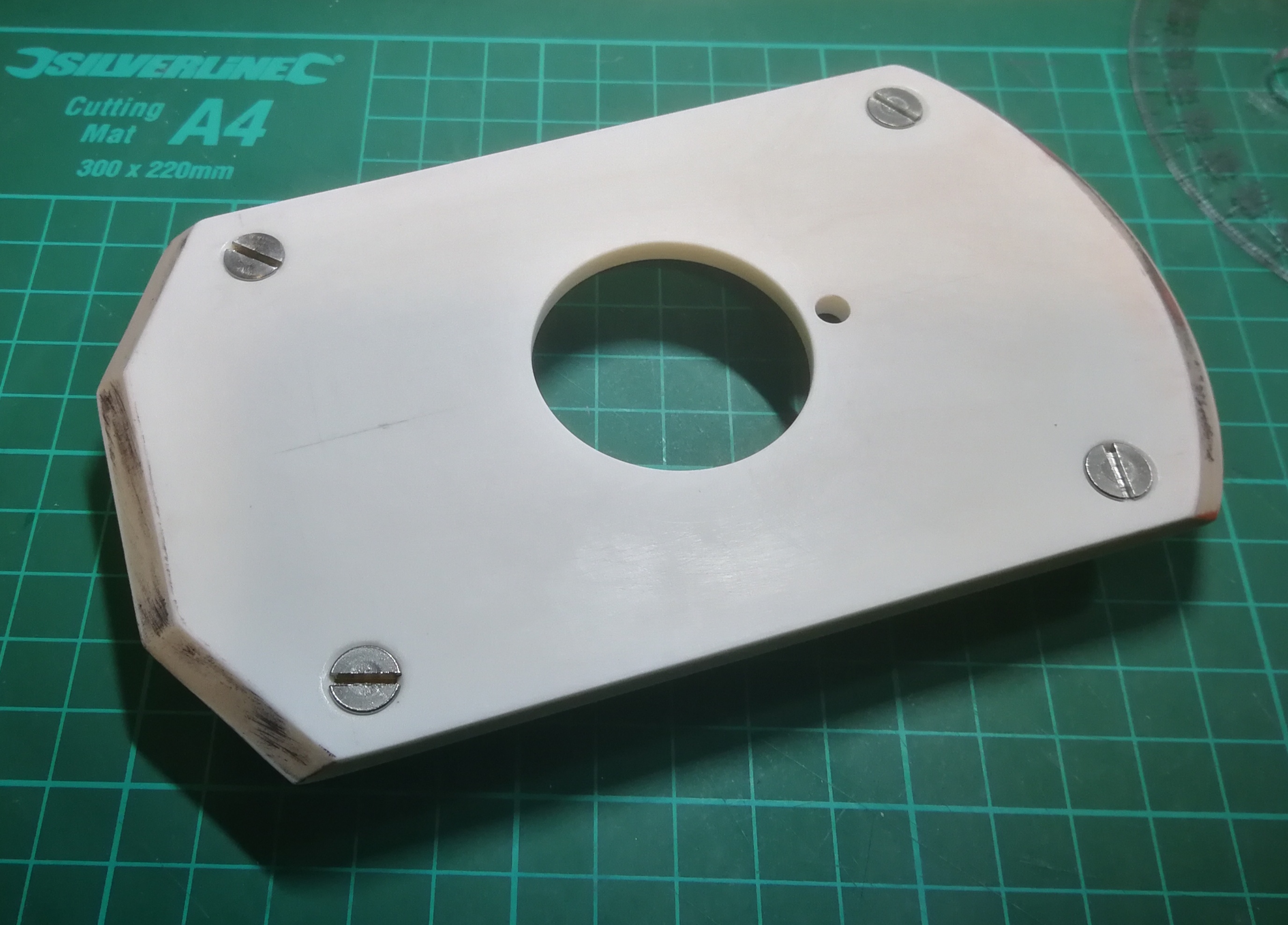

bit more done to the cheeks and got the bottom plate finished.
i think ill supply the flat screws rather than molding them into the plate, i also plan to include the inventory sticker that is on the rear of the plate
what you think?

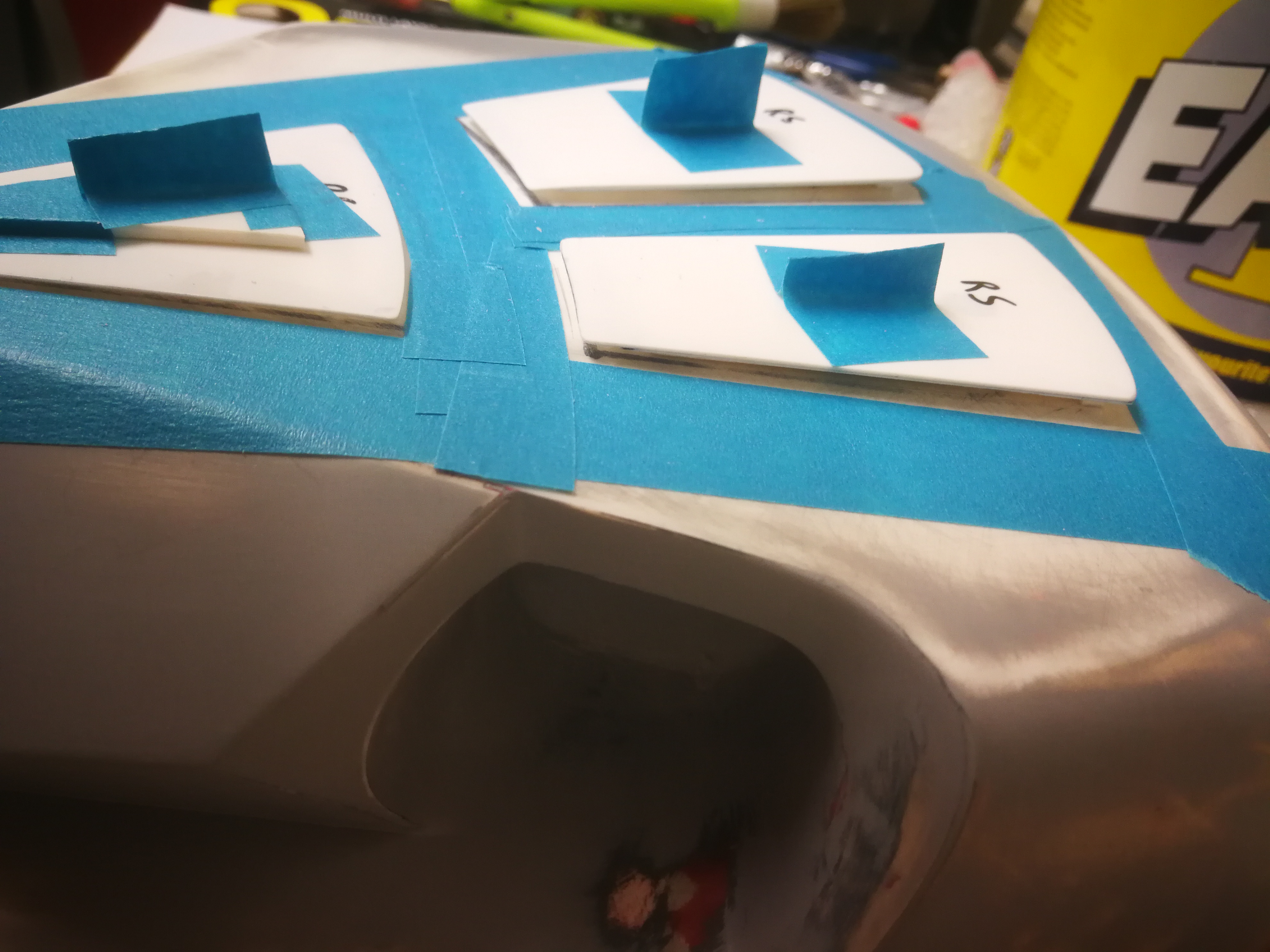

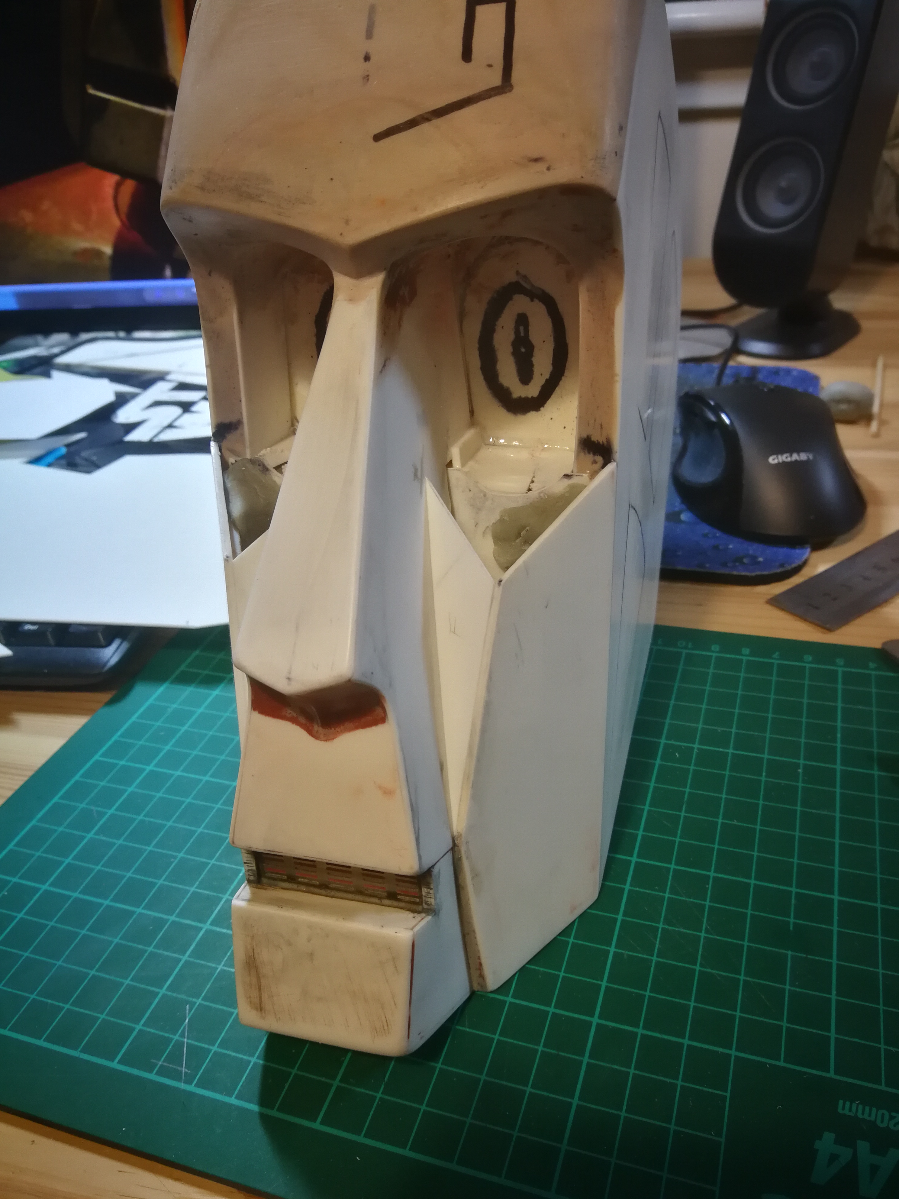

i am putting lumps n bumps at the back of the eye socket just like the real one. looks like they painted it with one part dirt one part paint.
i added the three rivets on the grill part and cast them up, the ones on his left side are on upside down from the other side, something i missed first time around
