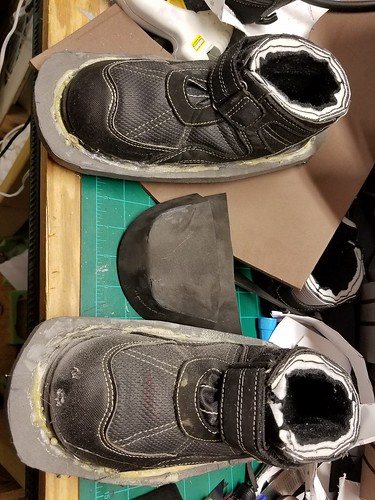

Like with the Hulkbuster build, I started with the boots and worked my way up... I took a pair of boots he could fit and I didn't mind destroying and then gorilla glued a base of floor-mat foam onto them with enough clearance that normal walking would keep the foam exterior off the ground.
After roughing out the boot armor I damaged it up with a wood-burning tool and prepped it for plasti-dip/paint/finishing.

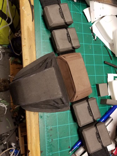

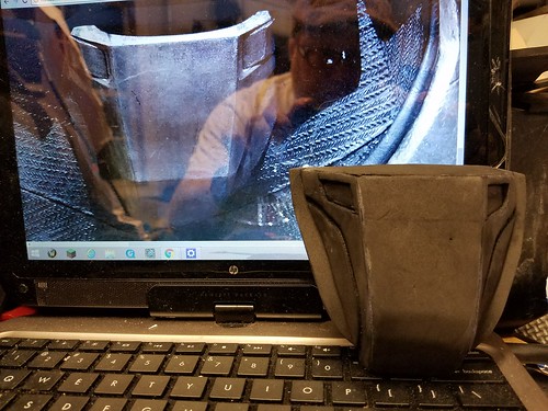

I took some measurements and then basically free-handed the cod-piece and belt.

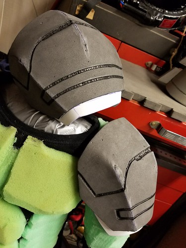

And shoulder armor...
And then, finally, his chest armor...

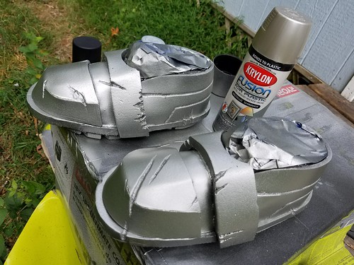

Step One: Plasti-Dip
Step Two: Adhesive Promote (nothing to see really - it goes on clear)
Step Three: Final Paint - in this case it's a Krylon 'Metallic Shimmer'

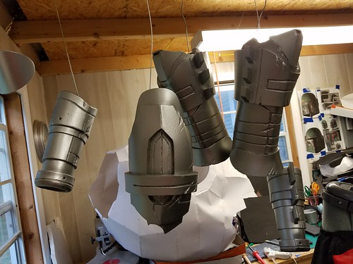

Overall, I'm thrilled with the effect. Here are the other pieces in their basic paint.
And here they are finished...

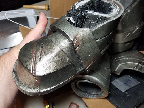

Boot close up
Shoulder piece:
Forearm piece:
Lower Leg:
And helmet...
May I ask how many pieces you used for the bottom leg part? like mine is to squareish idk how to do it rounded did you use only a blade? also what glue do you use?
Two pieces. Lower leg (with the knee piece attached to the lower leg), and then the upper leg. The lower leg is supported by sitting on the boot. And the upper leg is supported on the lower leg. They are not 'attached' to each other - the upper leg just sits on the lower leg.
I leaned very heavily on the tutorials that STEALTH did on his build. He's using Gorilla Glue branded Super Glue rather than hot glue. I used the same thing for this build (which allows me to use a heat gun to help form some of the shapes (as hot glue would just melt and come apart if you used a heat gun).
