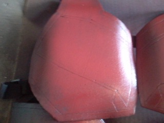

So it is kind of difficult to see but I spent a lot of time cutting in a outlining and some details with the exact-0 blade

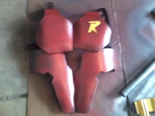

The Chest Armor

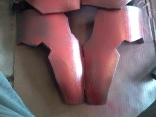

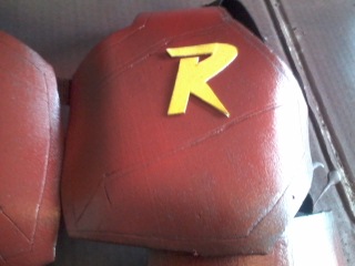

For the chest armor I started out looking at some reference from Arkham Knight Robin and I sketched out some templates which regrettably I forget to take pictures of. So I saw that there were four pieces of armor involved in his chest, two upper chest, two abs. So I used my templates and cut them out (I used no relief cuts, just made the details pop more) so I then took all four pieces and shaped them with the heat gun (this was really fun to do because this is when the armor really came to life) Afterwards I freehanded the design with my exact-0 knife and carved away at each piece until I was satisfied! Then I took some strapping and attached the pieces together. Then around the back of the abs I attached strapping with a buckle which went around my back and strapped. I then added two around the shoulders with no buckles that attached to the back. I then PVA'd the armor and sprayed it black, then after ten minutes or so I sprayed it red lightly (letting the black show a little bit through the red making it look a little wore down) I then made the R out of some matt board I had lying around and hand painted it yellow (I still have to attach it)

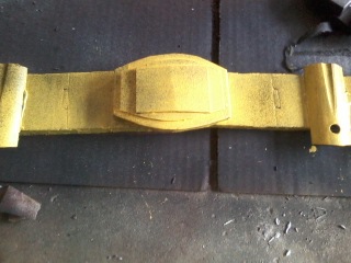

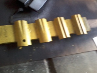

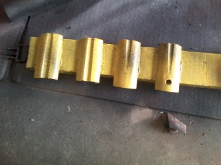

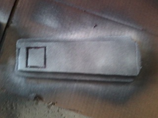

With my time and material restraints I had to improvise a bit. I started with two strips of foam which collectively fit around my waist. I then cut out the first layer of the buckle out of foam and added a slightly smaller piece of matt board and then a smaller yet square piece of matt board. For the pouches I took to two rounded rulers and I knew I wanted eight pouches so each was three inches long. I spread them out by approximately an inch, I glued it all together added two halves of the buckle on opposite sides. I then PVA'd it and sprayed it black, waited for it to completely dry and then hand pained the whole thing yellow (lack of yellow spray paint) and then spritzed some yellow on.

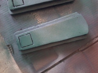

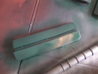

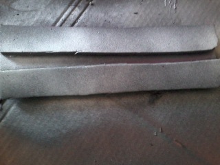

I started out by cutting two layers for each bracer (one layer is slightly smaller) and glued them together on top of each other, at the end of the top layer I cut out a small square ring keep the actual square and glue in the empty space, this should leave a slight gap. Then add straps and paint textured silver then a dark green. Then for the Boots I cut out one square piece of foam round the edges cut down the middle and add a piece in the middle leave an inch gap, added straps then sprayed textured silver then dark green.

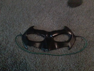

For the shirt I used a long sleeve black compression shirt. For the mask I sprayed one of my older masks that I had made and sprayed it black. For the cape I used a cape with a hood that my Grandma had helped me with a few years back (had to make some adjustments to the hood). For the pants I am using a pair of black pants that I made for my Mortal Kombat X Scorpion outfit. And for the gloves I used yellow kickboxing gloves that looked good with everything else
