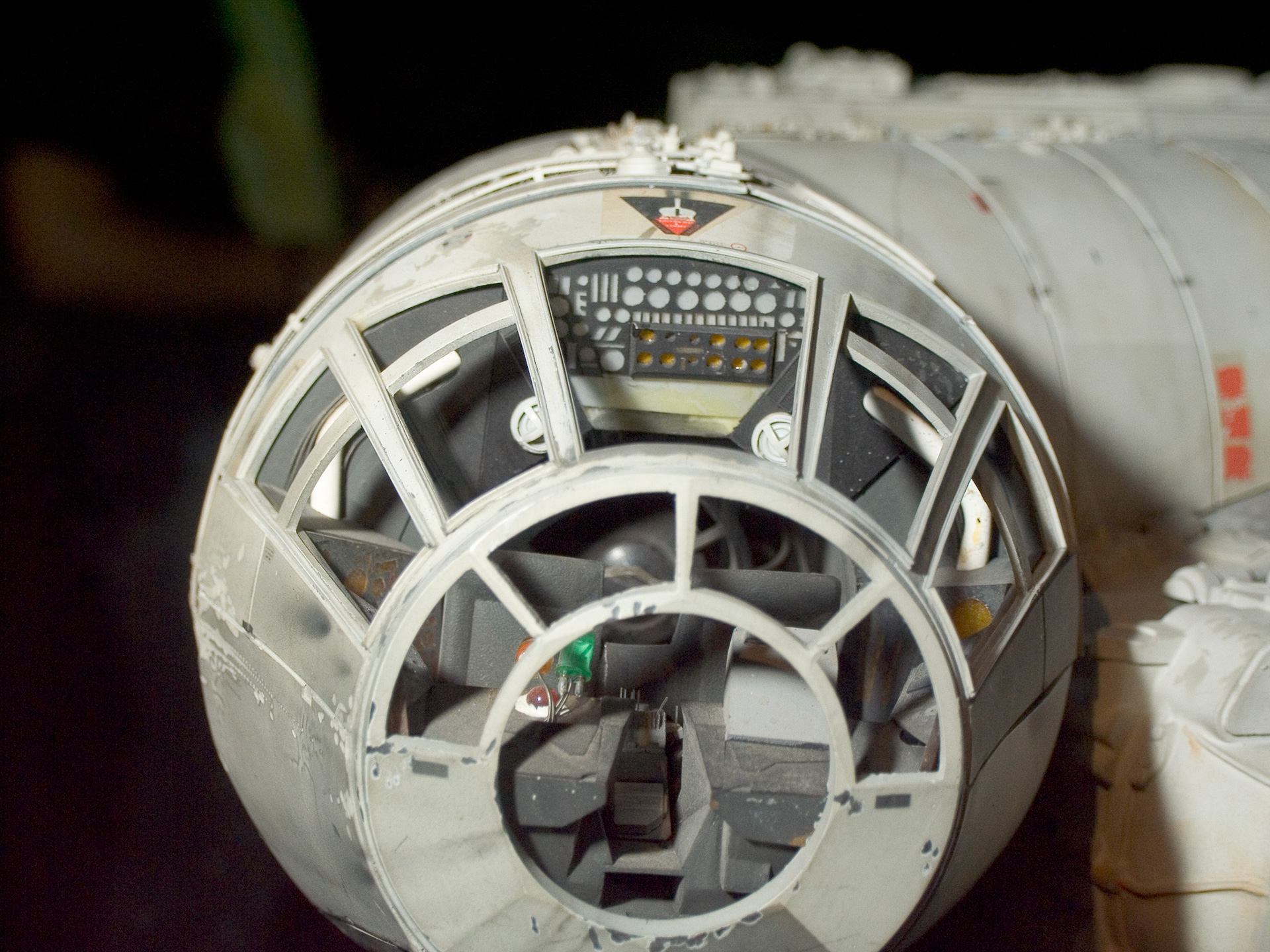

The port sidewall of the cockpit has a "lower console" with a sort of clock thingy on it. Does anyone have a clear photo of the starboard sidewall?
I'm trying to see if both sides have this lower console or not.
thanks
I don't. I don't think it's really possible for that part of the cockpit to be photographed when the model is on public exhibition. You'd have to be very high up looking down, and fans wouldn't be permitted to do that.
thanks
Here a collection of snips of images by curtsey of Alan Anderson, swgeek, raiders. Local contrast enhanced!
Not one clear shot but some pieces of the puzzle.
Love your cockpit!
Thanks, those bottom two are helpful. They do seem to indicate there's 'something' down there and I'd guess those would be pretty similar to the port side.
I'm sure as soon as I finish it, someone will jump out of the dark with some long lost photo showing the real thing and yell 'Gotcha! It's wrong!'

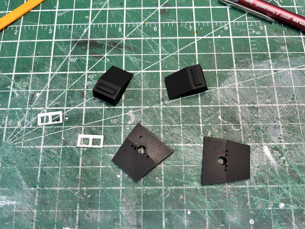

These arrived today. Worse condition than I expected and now I'm trying to figure out how to resuscitate them.
I'd really rather use original decals, but if worse comes to worse, I could use these as a template to screen print a new set. But I'd rather not.
Based on the scant few photos that show the cockpit rear lower 'instrument panels' (especially the starboard side), these are the patterns I've come up with. If anyone can offer corrections, I'd appreciate it.
thanks
Great work, thanks Dave! Really tricky to figure those out. I had a few minutes and tried also to align the few references available, now my brain hurts. Please consider just as a suggestion:
