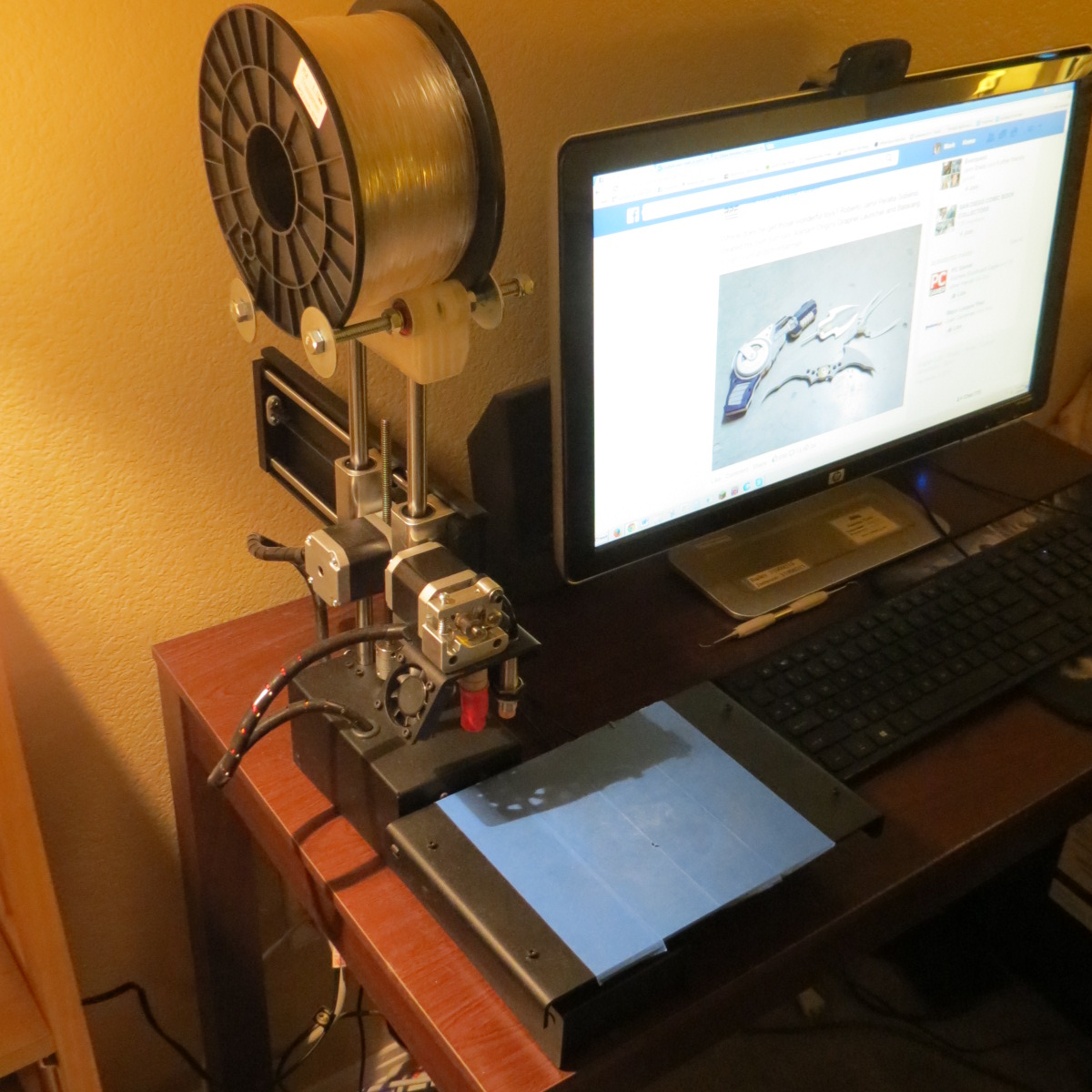

My wife surprised me this last Christmas with a Printrbot Simple Metal. This is $600 assembled ($539 kit) on Amazon. She knows nothing about printing but knew I wanted at least a 6x6x6" bed, wanted to spend around $500 and wanted decent reviews, which this one has.
Having no experience with 3D printing, it's hard to say how this stacks up against others, but so far, I'm really happy with it. There was zero assembly to do with it and you could get started on your first print fairly quickly. (Watch the large bundle of cables though as mine caught the Y motor and jammed it briefly!)

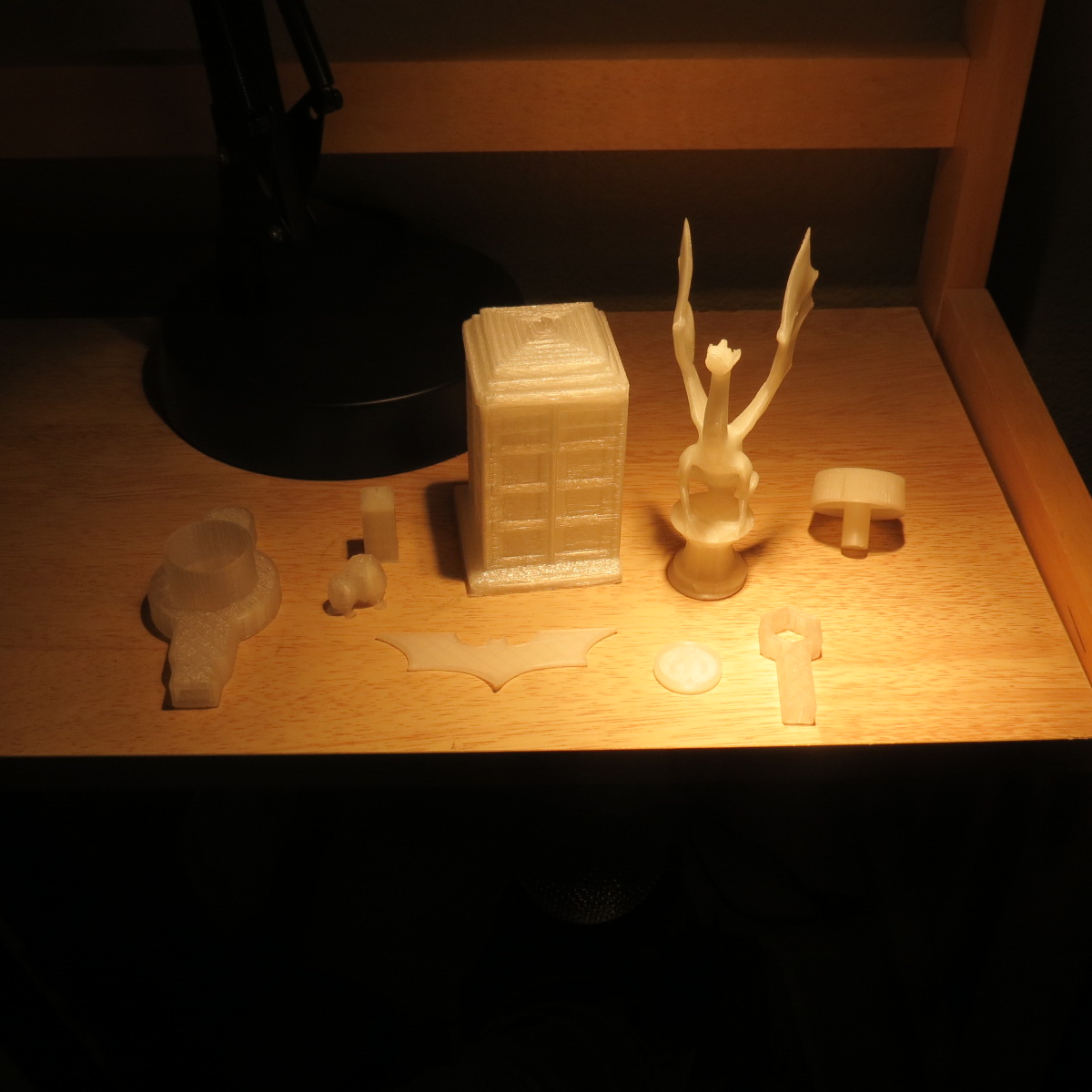

Here are some of the things I've printed.
The small round coin in the front (which is a Mandalorian coin but you won't be able to see it in the pic) was the first Cura print I made and it sold me. It's very solid with nice, clean lines. I then did the dragon, which took about 2 hours. Also, very solid compared to Shredded Wheat TARDIS. I know that it's just gcode settings and Repetier can be adjusted but I haven't hit it perfectly yet. The hardest part about this printer is setting the Z axis height and the help videos from Printrbot aren't very helpful. I've made some other assorted things like knobs and wrenches, batarangs, etc. Note that there have been plenty of printer fails along the way! Fortunately, not a lot of waste though. The first "OMG" moment was when I found a .STL file for a Nintendo DS stylus and printed one to replace what my daughter lost. The printed piece fit PERFECTLY into her DS. It looks like the original stylus.

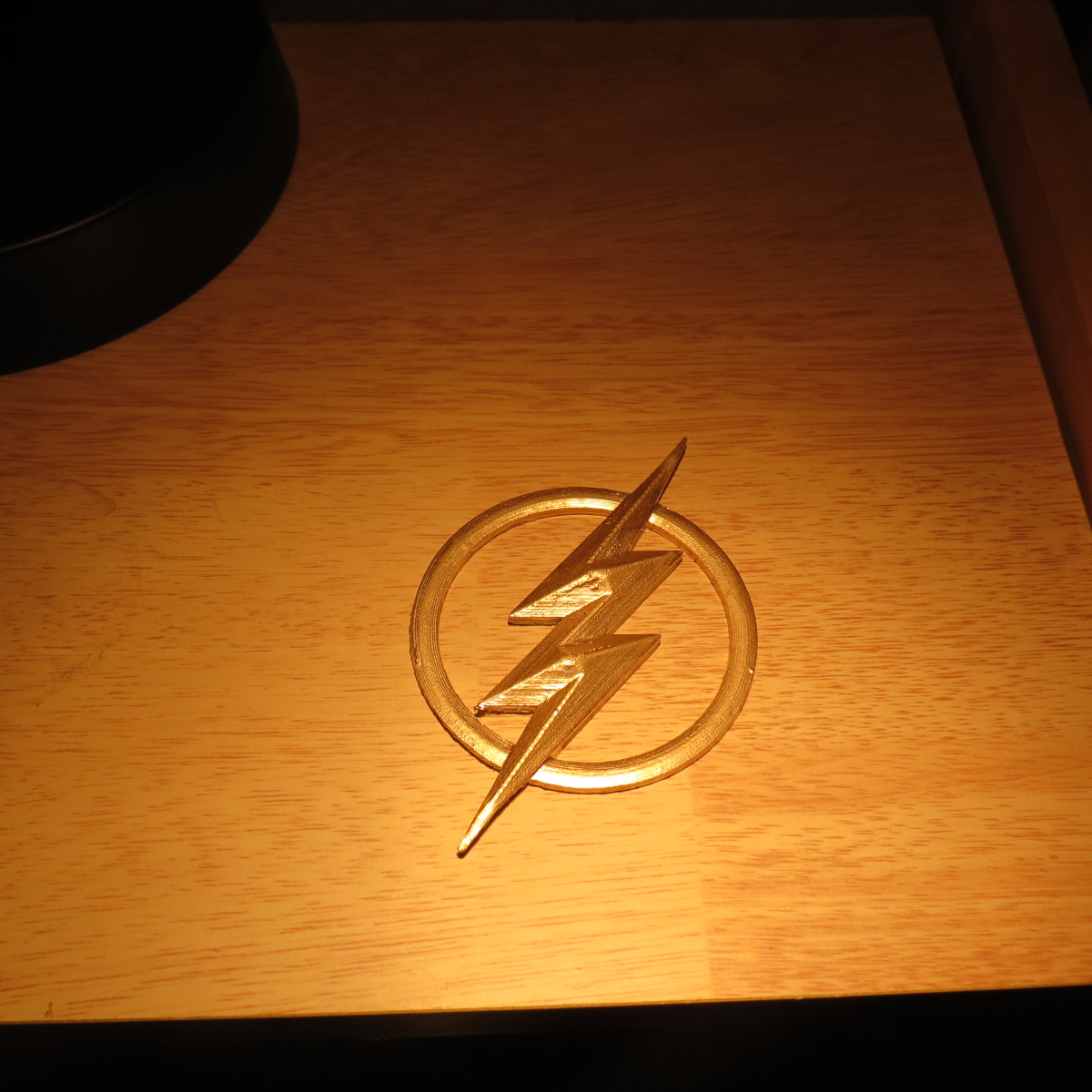

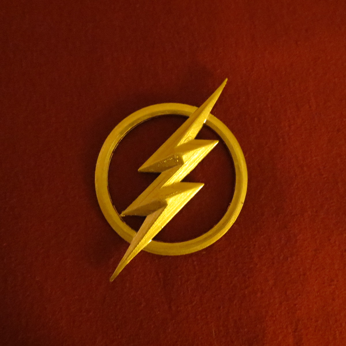

I printed this out for my boy, who is a big fan of The Flash (and this is the RPF, after all), and we decided to do our first paint test to see how PLA plastic holds up. I didn't have any white primer, so I started with a white primer / paint. I had gray primer, but I really didn't want a dull base coat. I then did a spray metallic gold but it wasn't shiny enough so I did one coat of Testor's metallic gold. It came out pretty nice, we think. I could have sanded better but this was a test. It's really tough to see what you need to sand on the clear filament. By the way, you can purchase all different colors of filament so I could have done this in yellow, if I had that color.

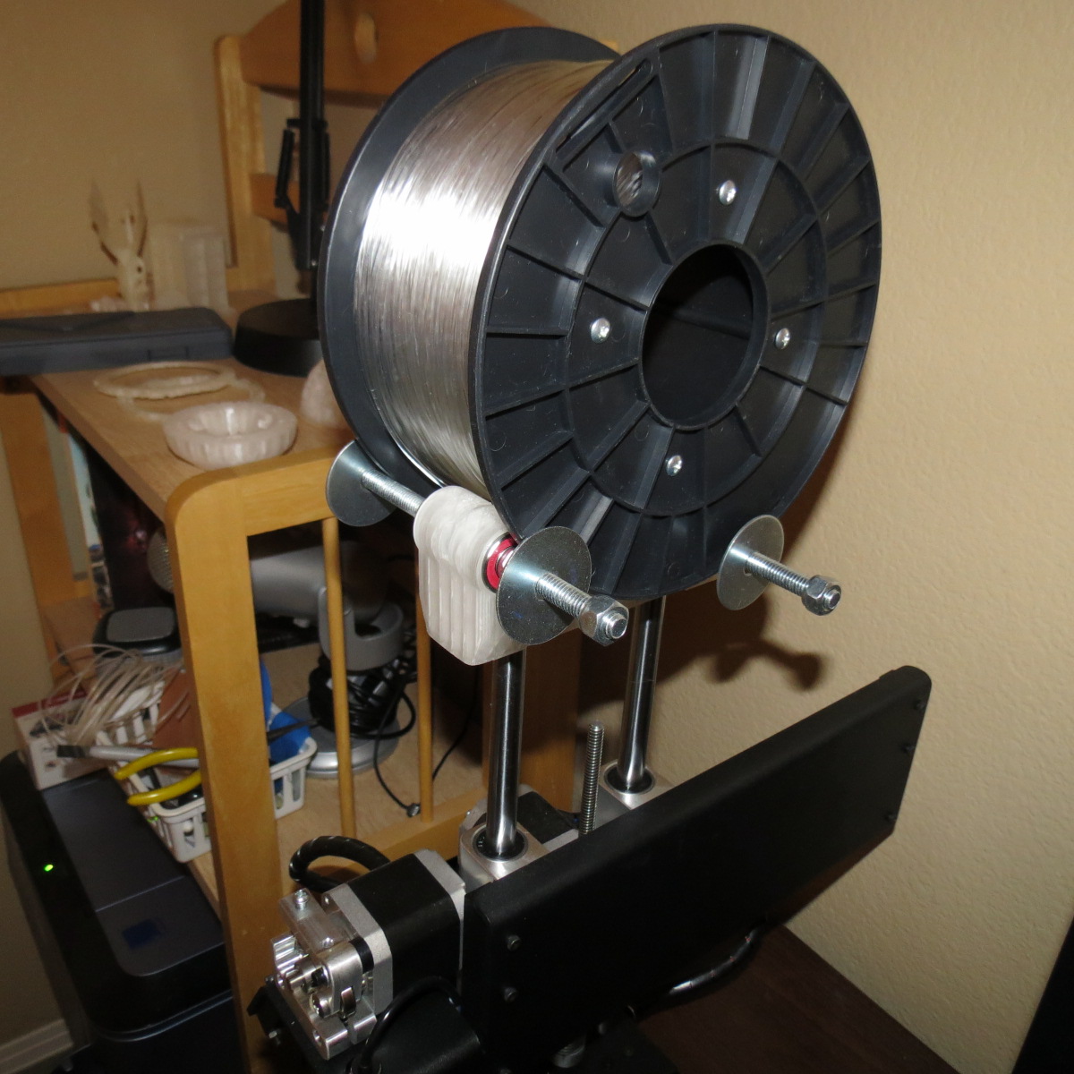

The printer comes with a small amount of PLA, which we used pretty quickly. I purchased a new roll from Amazon for $30 which was HUGE. One of the great things about 3D printing, is the amount of things that you can print FOR your printer. The Printrbot Simple Metal does not come with a spool holder. So, I looked up some different variations, and found this project on Thingverse. It uses 5/16 bolts through roller skate bearings to spin the spool as the motor pulls it. I printed out the base which attaches perfectly to the two vertical support posts and added the hardware I got from the hardware store. This has been instrumental in allowing me to do "walkway prints" where I don't have to babysit the filament so it doesn't bind or kink.

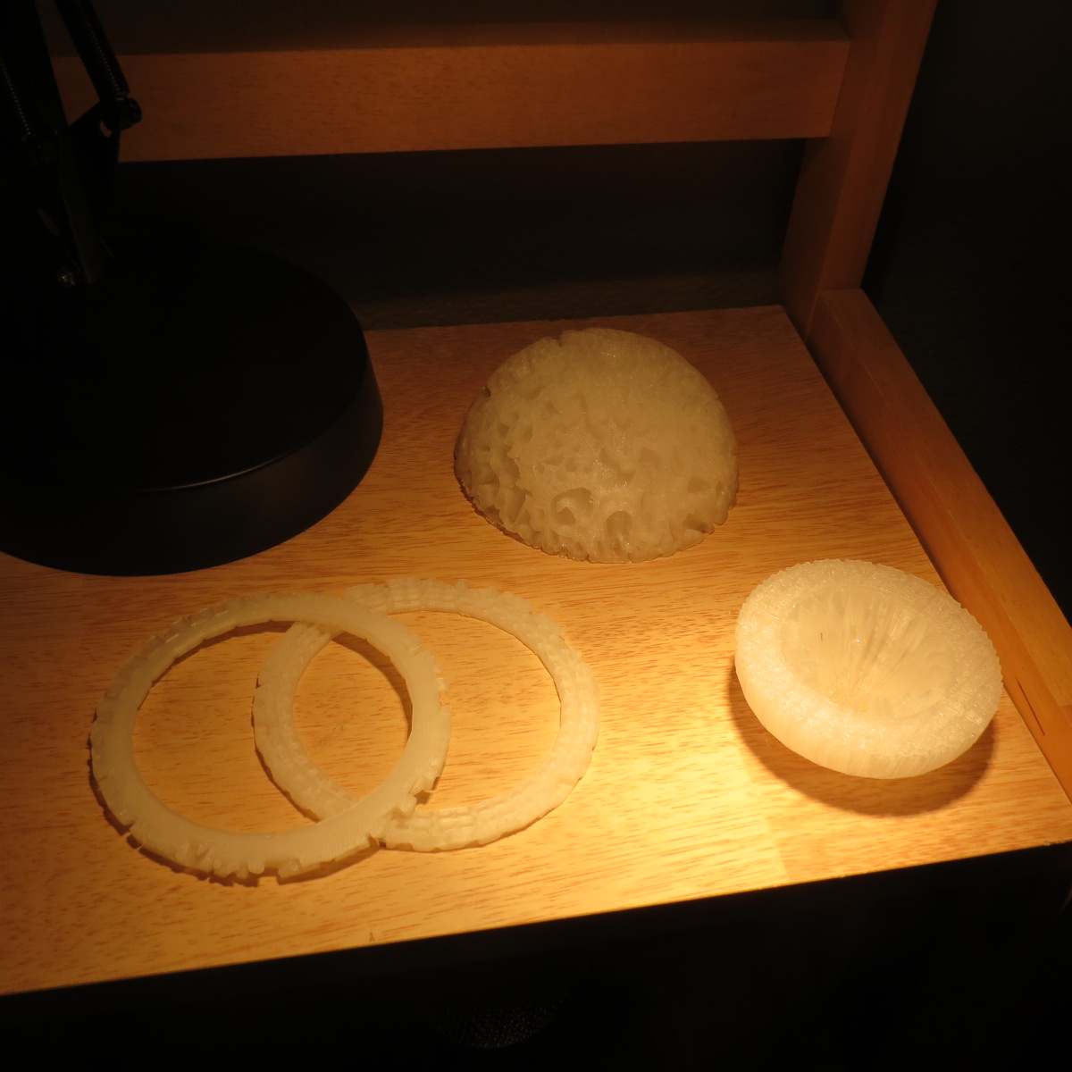

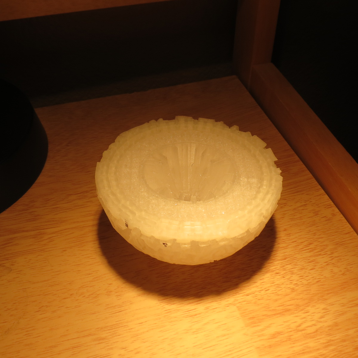

The big project that I'm working on now is the Infinity Orb from Guardians of the Galaxy. It's 6 pieces (excluding the stand or stands, depending on how I want to go with this). I have four of the pieces done here.
This represents 24 hours worth of solid printing. There are 2 inner pieces, 2 outer, and 2 rings. I printed the outer piece today and it took 13 hours. Yikes. I'll probably begin primer and paint on half of this tomorrow while waiting for the remaining 19 hours to print.

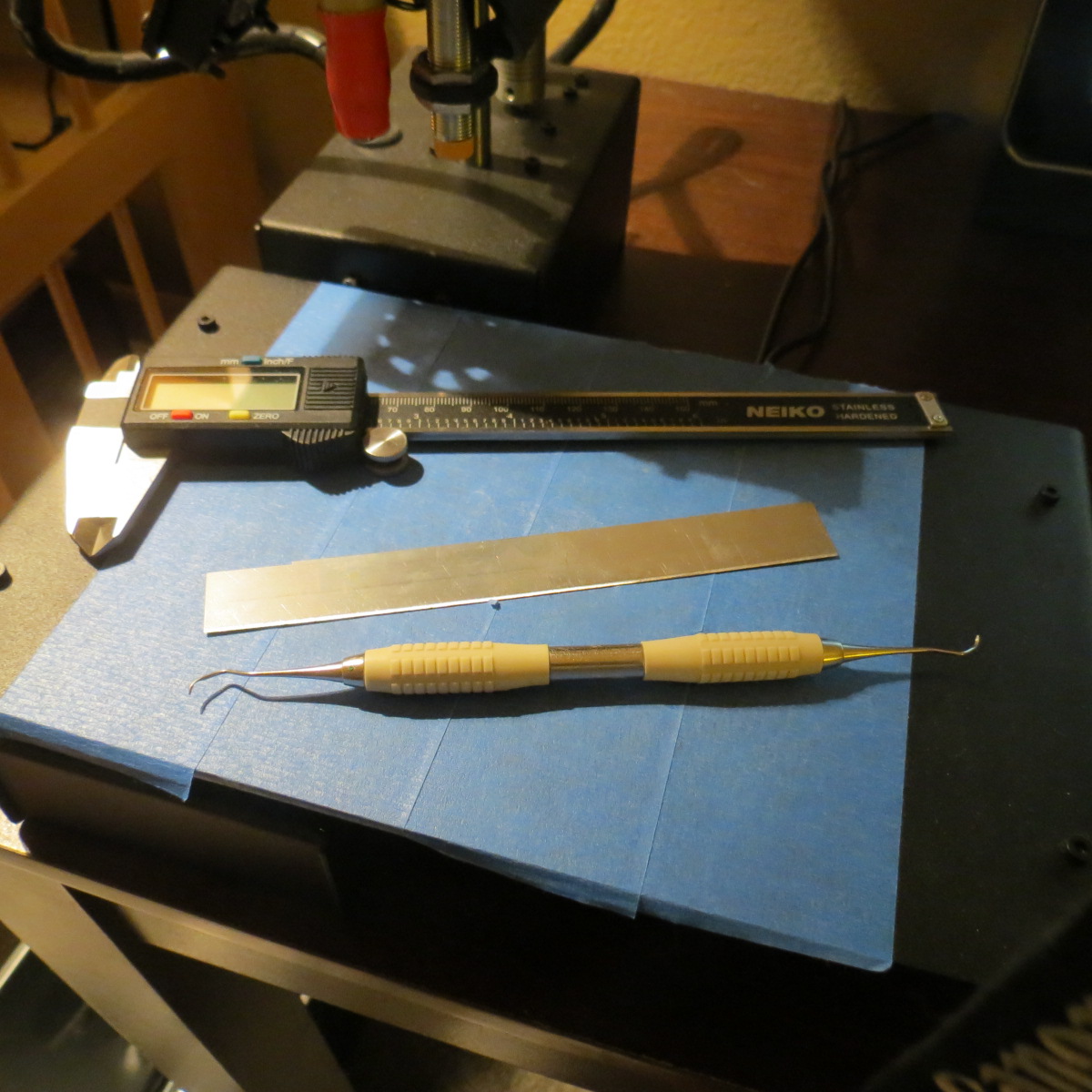

Aside from there's a couple of tools I would highly recommend you getting, pictured below.
I don't know how I've lived without a digital caliper for so long. $17 on Amazon. No brainer. You need this to test the thickness of your PLA throughout use. I haven't seen it yet, but I'm hearing that filament varies in thickness throughout a roll. The middle is a long, flat razor called a "tissue blade" (Amazon). I stole it from my wife who works with clay. This is terrific for getting the piece off of the tape when it's done printing. Some of these prints can be really difficult to remove depending on how much surface area touches the bed and how fragile the upper piece might be. By the way, you MUST put blue painter tape down on your bed to keep from scratching it up. And to help the printed piece stick to the bed, rough the tape up with sandpaper or acetone. Works like a charm.
Lastly, you MUST get a dental pick. When you begin any print, there's a chance the filament will glob. That glob WILL dry, and then become a wrecking ball swinging around your piece. The first couple of layers are critical and if any of that moves, there's nothing you can do but clean up and start over. I've gotten pretty good at using this, when I start a piece, to pull the globs away before they dry.
