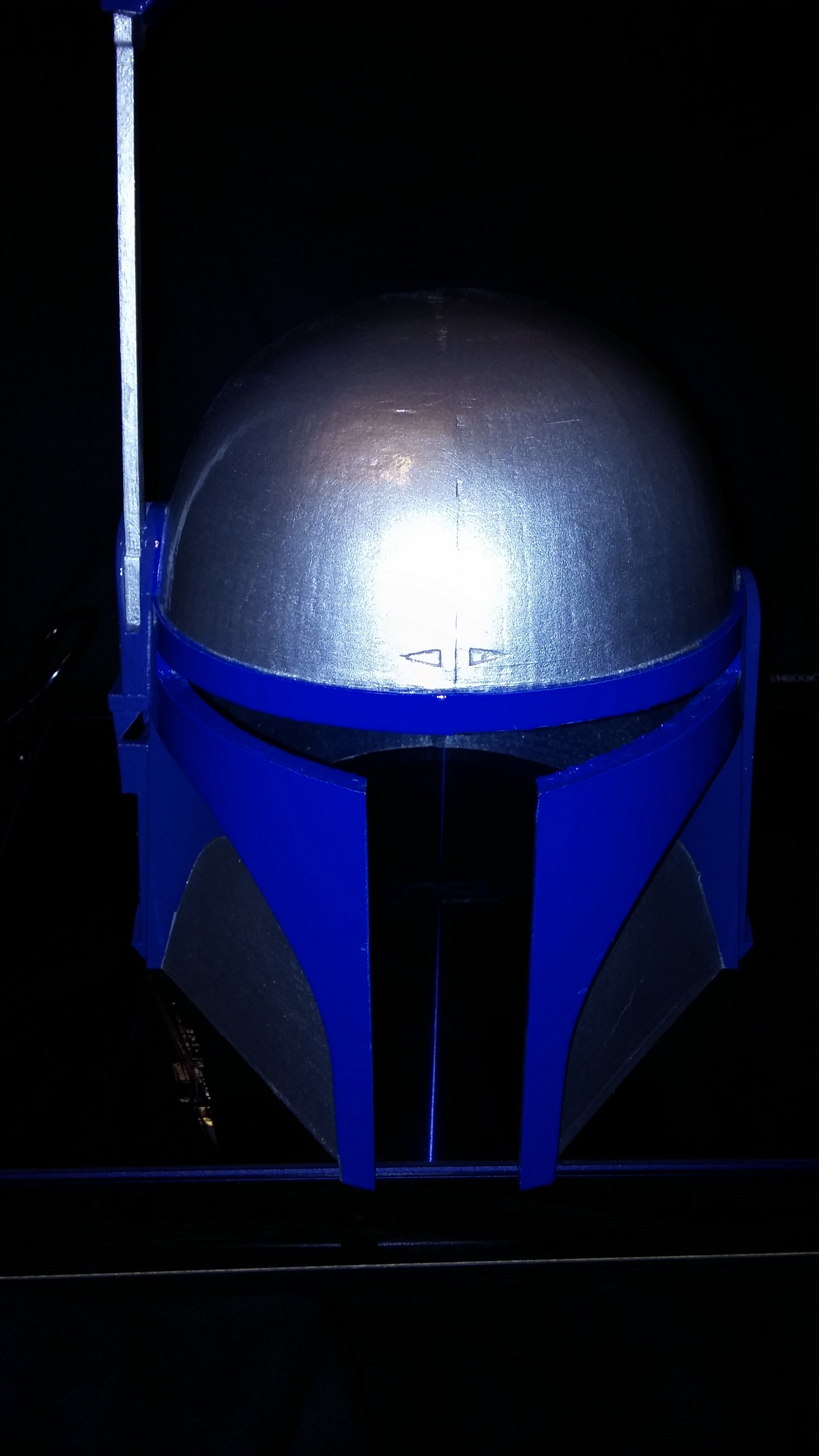

Mark,
I have been doing some different buckets as well as some other props with my Replicator 5th Gen. If your using 3Ds Max it is fairly easy to learn how to slice your build into smaller pieces in order to get them to fit good on your print bed as well as get a better quality print. Yeah they take a while to print out for the most part but the end result is great... In this link are some of the things that i have gotten printed as of now... http://www.thingiverse.com/Baddog01/about
I am not the greatest at any of this yet but if i can assist i have no problem with that... 20140921_185457.jpg 20141023_185849.jpg 20141023_185853.jpg 20141102_145617.jpg 20141228_184004.jpg 20150108_172358.jpg 20150111_174916.jpg
A few pics

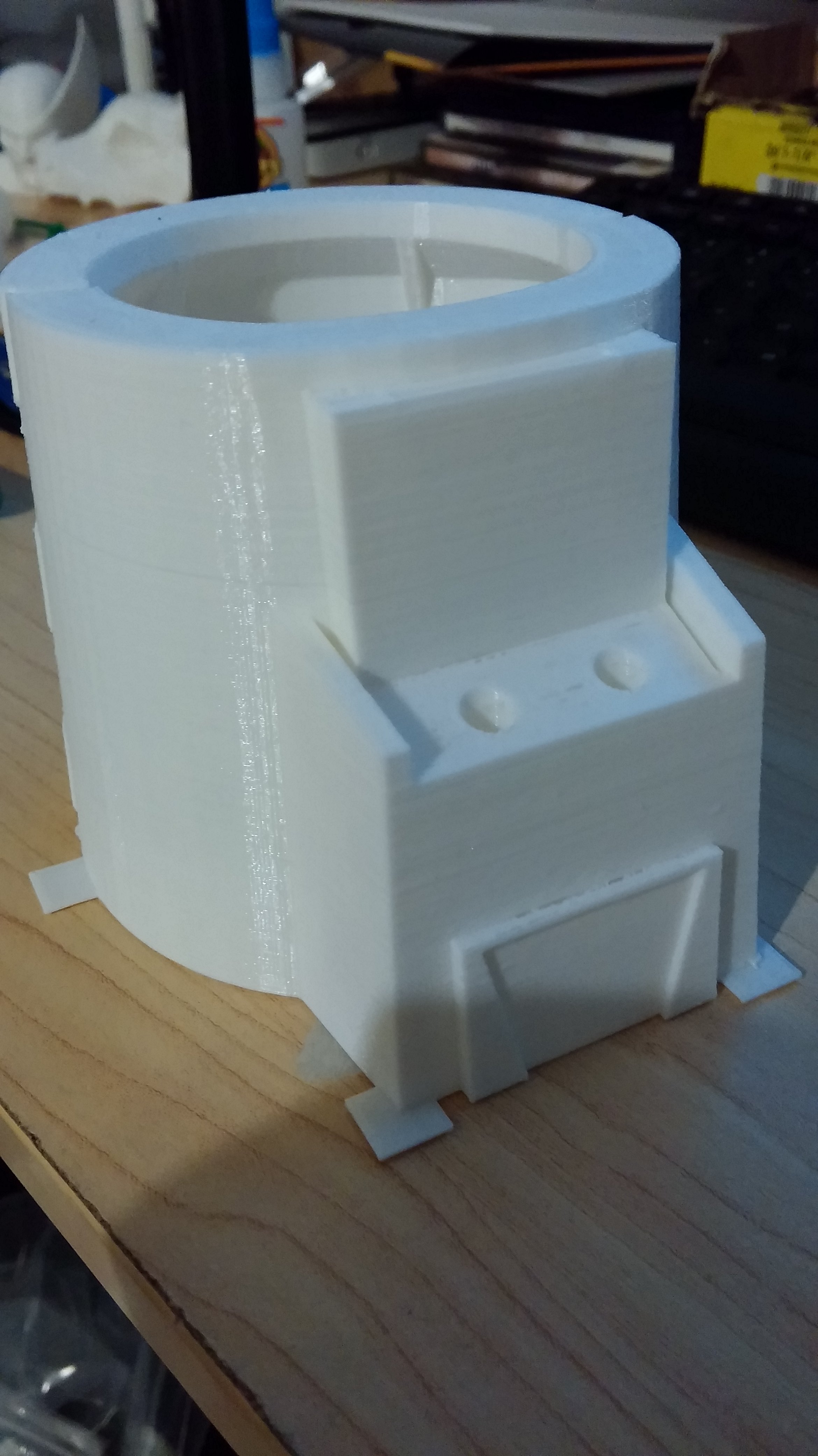

I hate to say it but the money might be better spent on netfabb pro so you can custom cut your models with dovetails and such. I have a simple metal and have done some simple cuts in netfabb to make parts print on the 6x6x6 and I have also printed a copy of "thorn" from destiny with the dove tail cuts and it goes together solid. IMO upgrade to the heated bed and better software before getting a larger printer. thats my plan at least.

Ive printed all the pieces but the sides of the reciever L/R warped so I need to reprint. As for 3DS max look into blender, its free and Ive done some simple models in it so far that have printed nice. Also, its auto face feature (Edit mode----> select all----> "F") is really good and making sure your model is manifold and it can import/export .STL with ease
