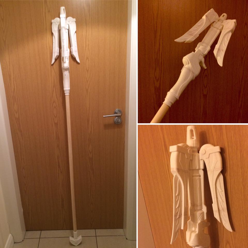

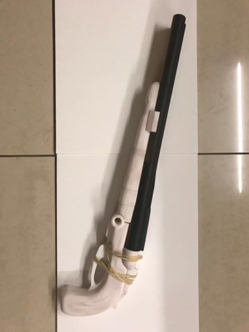

Some things I'm working currently working on, all printed on my Wanhao i3:
I did not model these, well I modelling the hawkman emblem and the base of Mercy's Staff. I usually outsource for more complicated builds providing the price is right aha
16142758_1788502254732950_7802081475873337617_n.jpg16195500_1791346124448563_8285418354226247436_n.jpg17191281_1807571099492732_4503627390821320855_n.jpg17200872_1808061726110336_2587884882152540345_n.jpg
