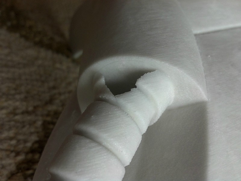

I forgot I had these pictures!
Back during the printing of the helmet the printer errored and left a deep triangular gap on each tube:
To fix this I filled in the holes with bondo and had to re-shape the tubes. It was such a pain, but now you can't even tell!
The error was caused by having faces inside the model (which from everything I've read is supposed to be safe to do), and the printer apparently tried to make the tube hollow in that one part. Won't be making that mistake again!
Very helpful information, was the tube modeled to be hollow? Love all the process pictures, can't wait to see more!
Re: 3D Printed Samus Varia Suit
The tube was a stand alone closed mesh that was intersected with the closed helmet mesh. Separately the printer would read each as a solid object, and together it should have read them as one big object. Instead it read them as a solid helmet and hollow tube, although it only tried to do it in that one small part. Also, no, the tube wasn't modeled to be hollow.
