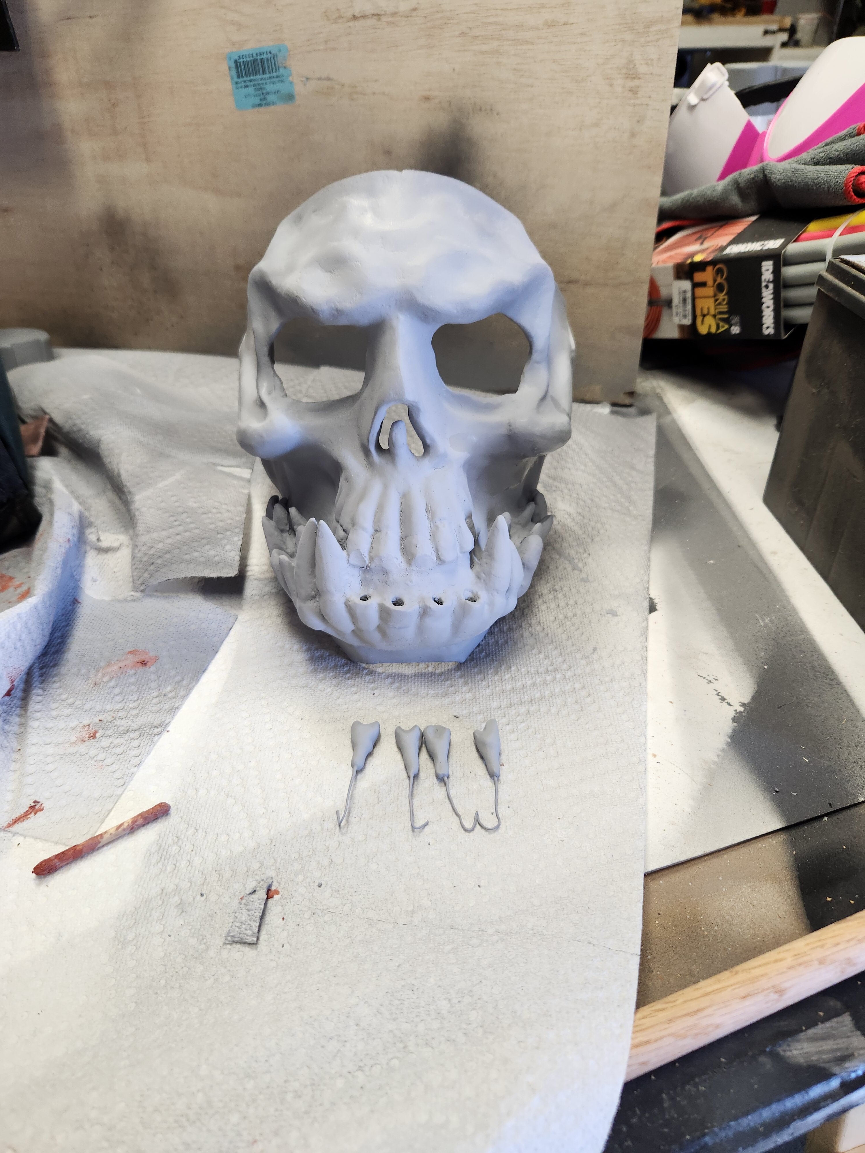

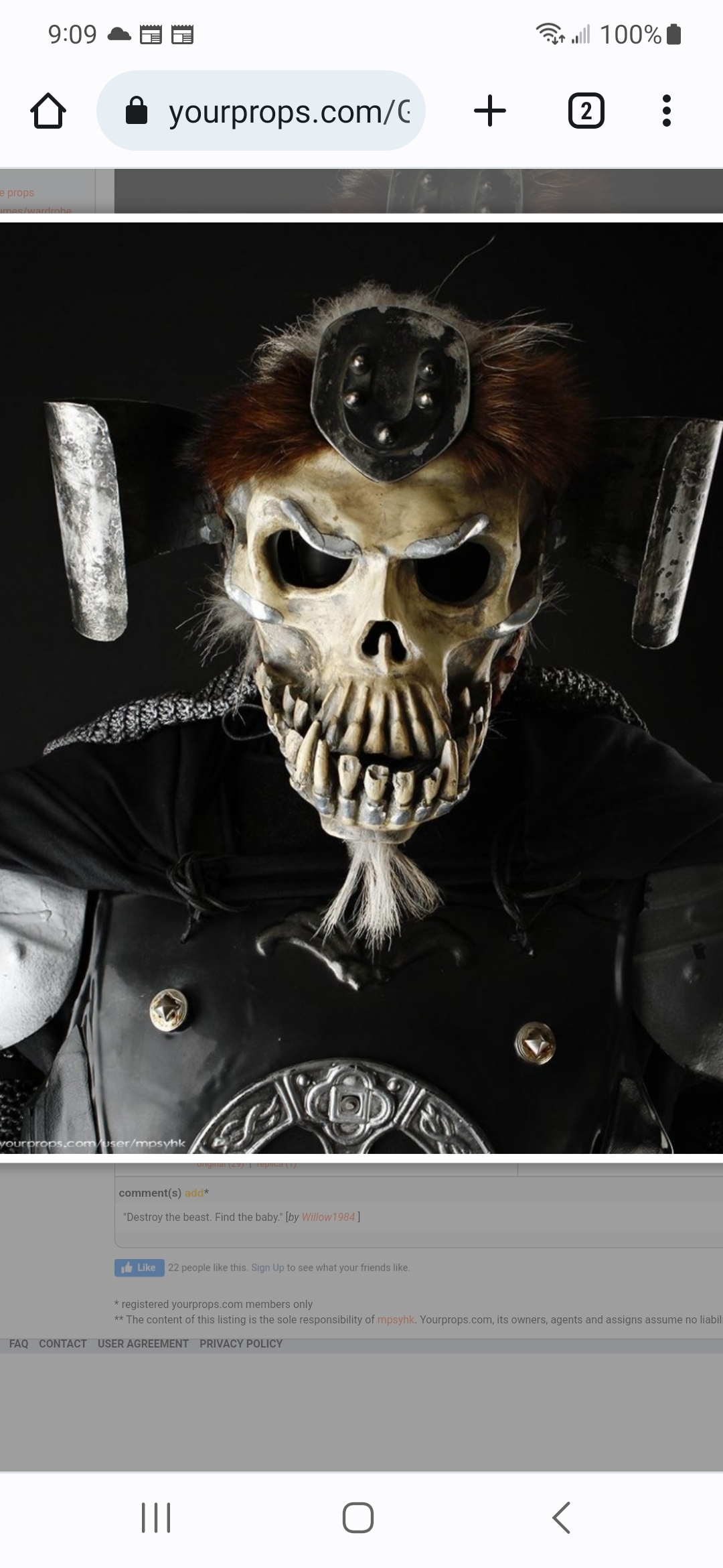

This it a pet project of mine I started back in september with hopes of finishing it before the new Willow series.
Sadly it just sort of sat on a shelf as I got sidetracked with other things.
I finally decided to start working on it again.
It has already been modified from the original print to more closely resemble the screen used masks.
I am currently filling and sanding it smooth. Afterwards I plan to mold it and make fiberglass reinforced resin castings.
I also plan on taking one of the castings and making a battle damaged mask replica and make a mold of it as well.

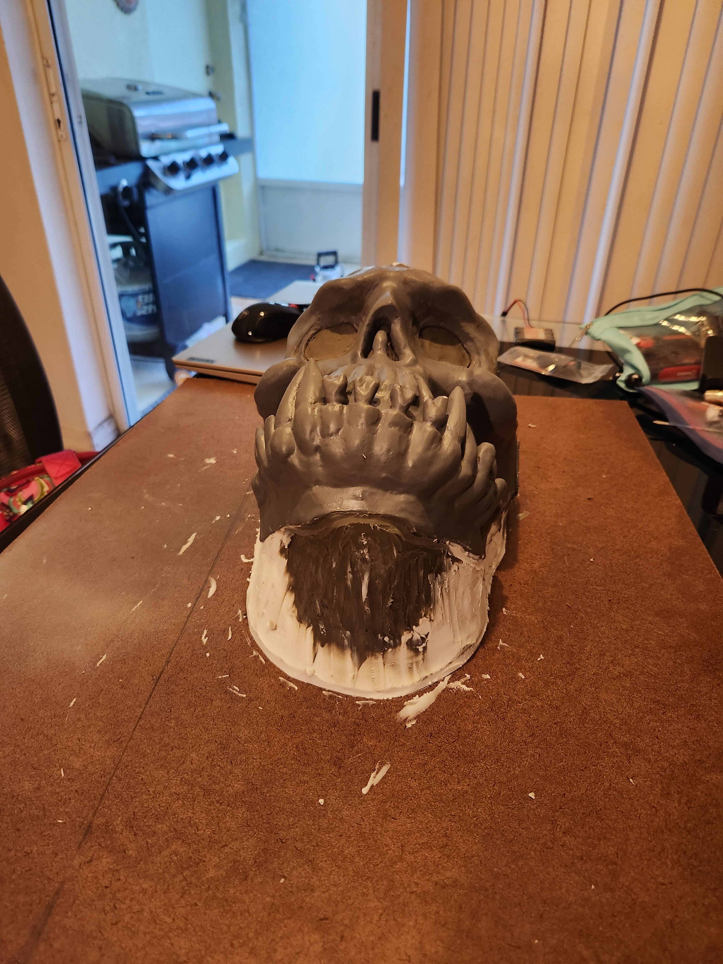

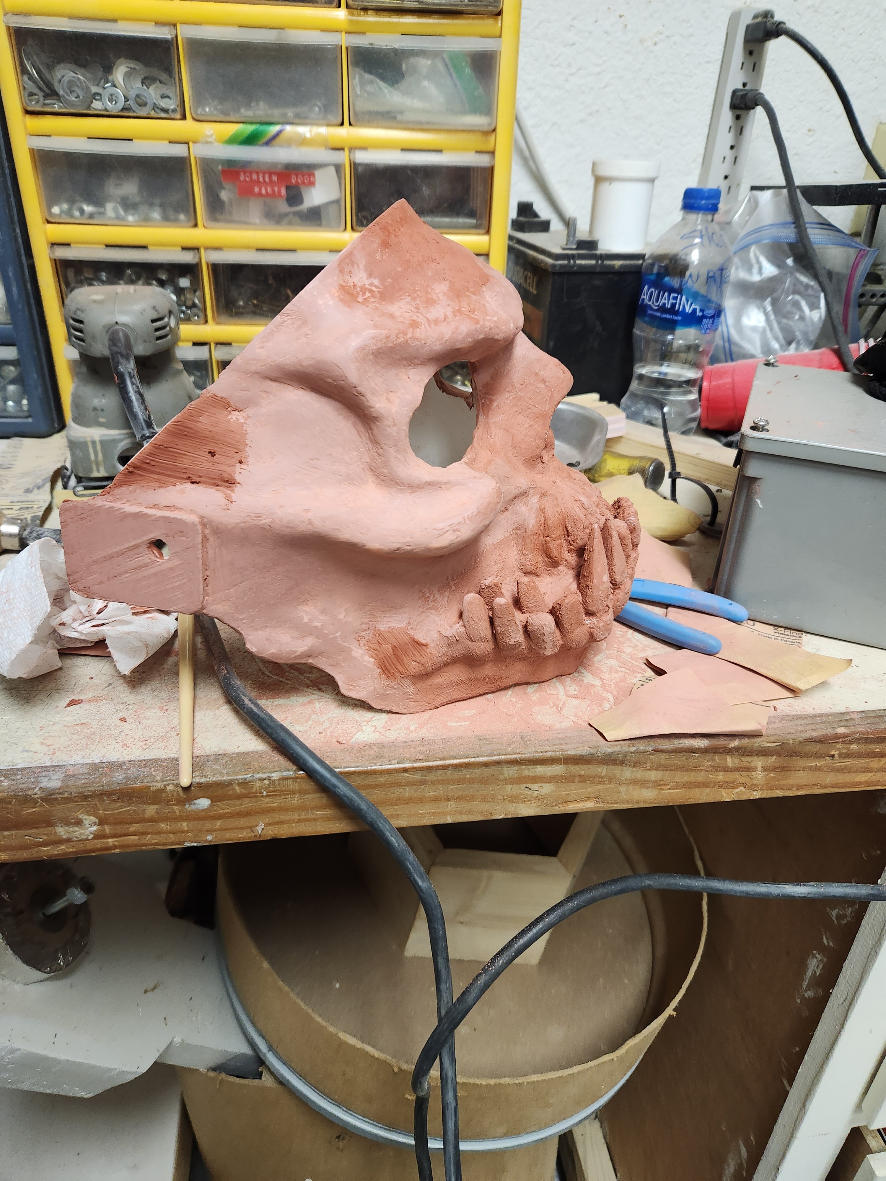

Looks like I'll be able to start the molding process either this afternoon, or tomorrow as the silicone thickener I ordered is out for delivery.
Just need to smooth out the clay around the mask. It is also my first time molding in silicone so wish me luck

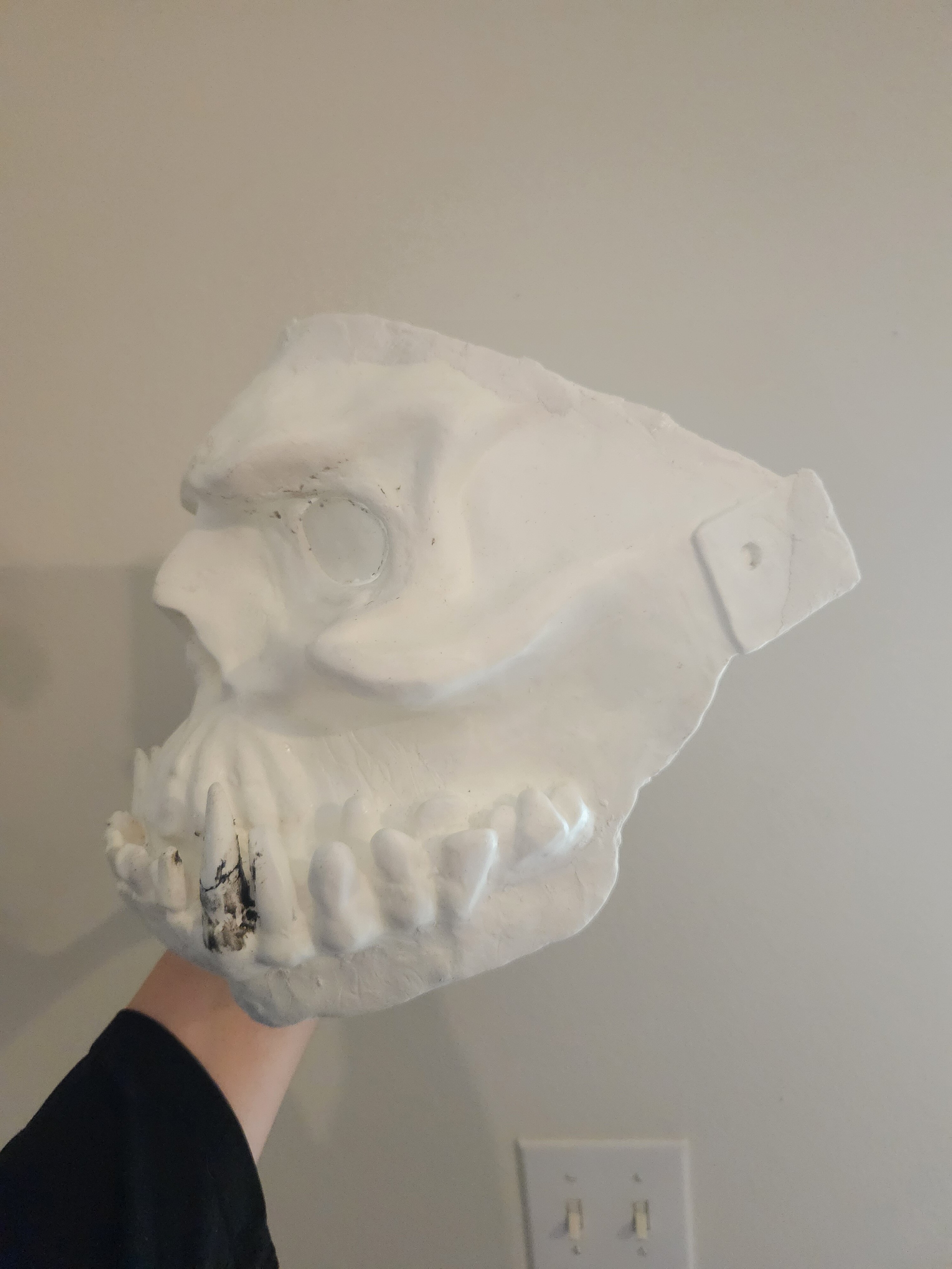

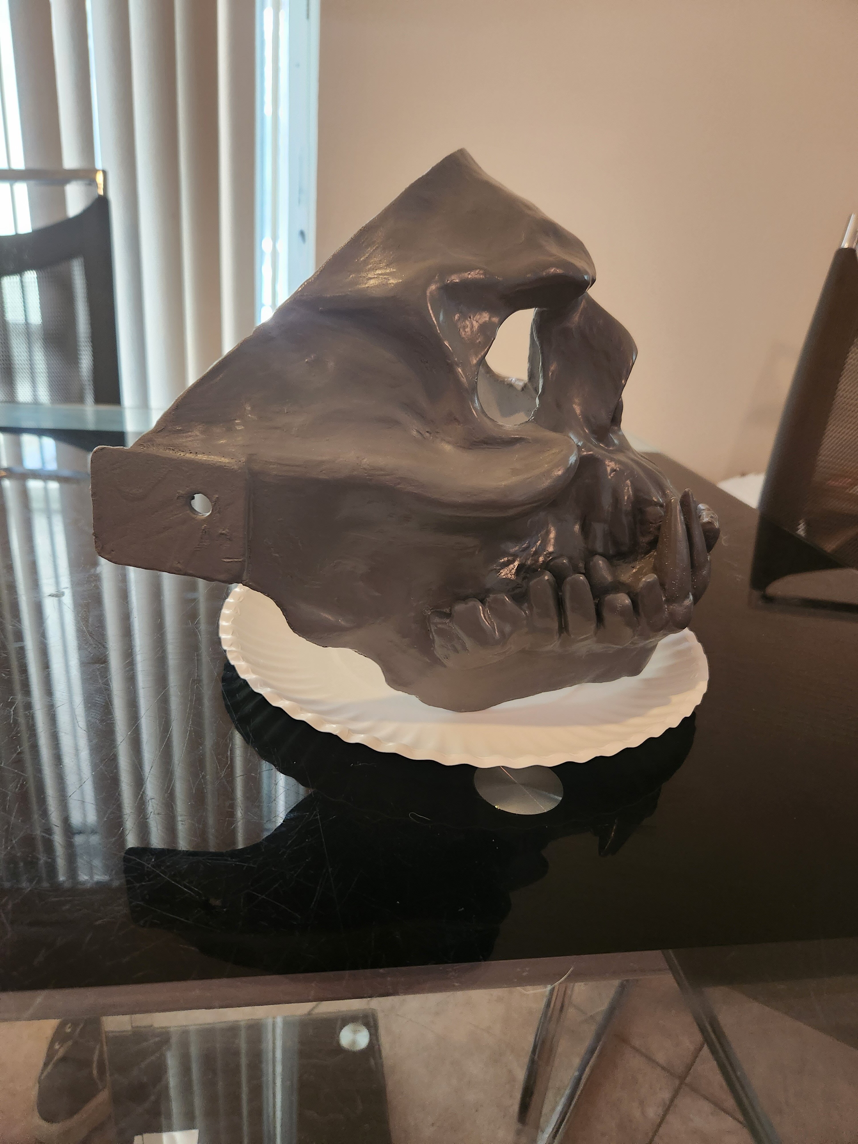

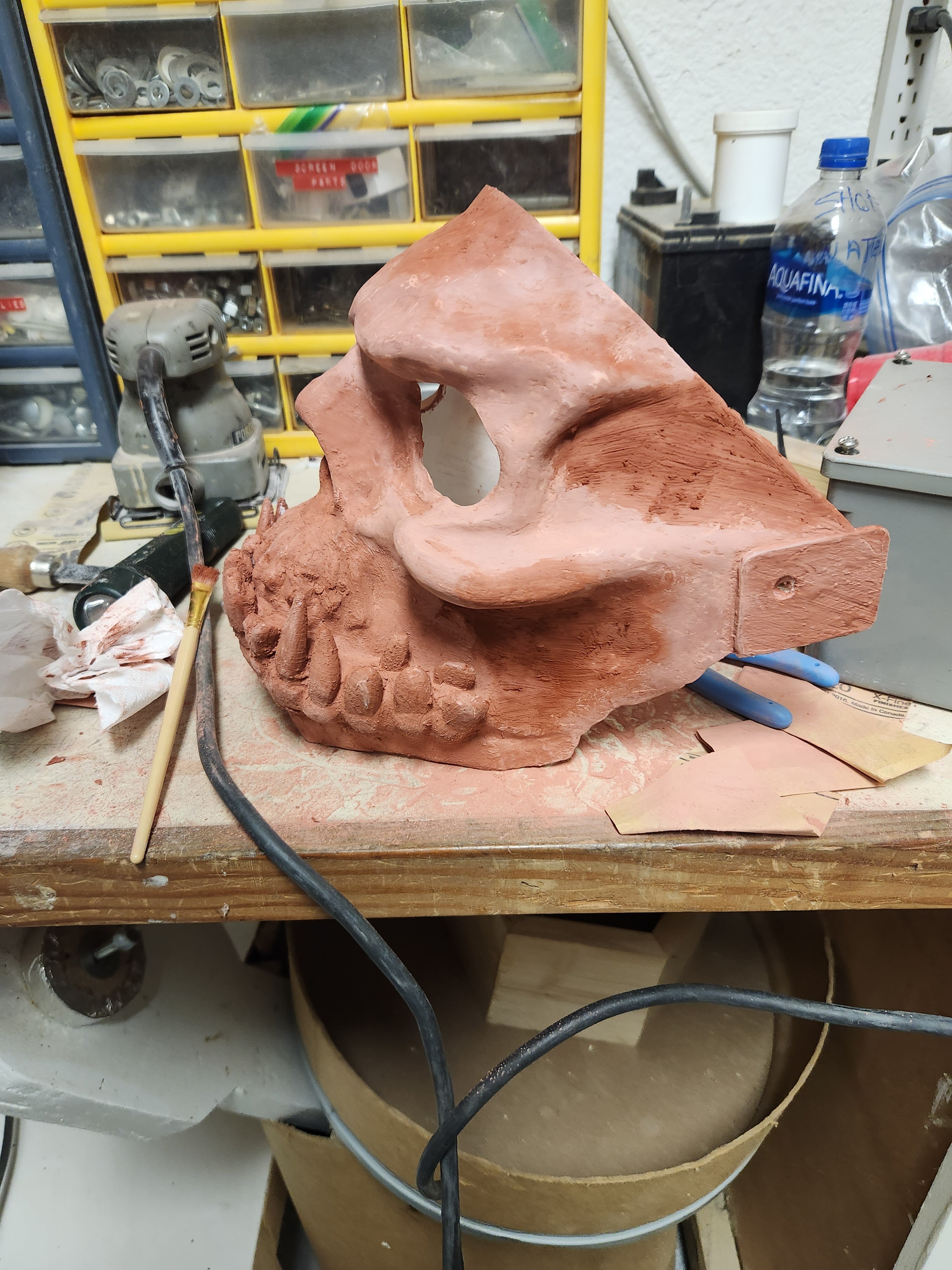

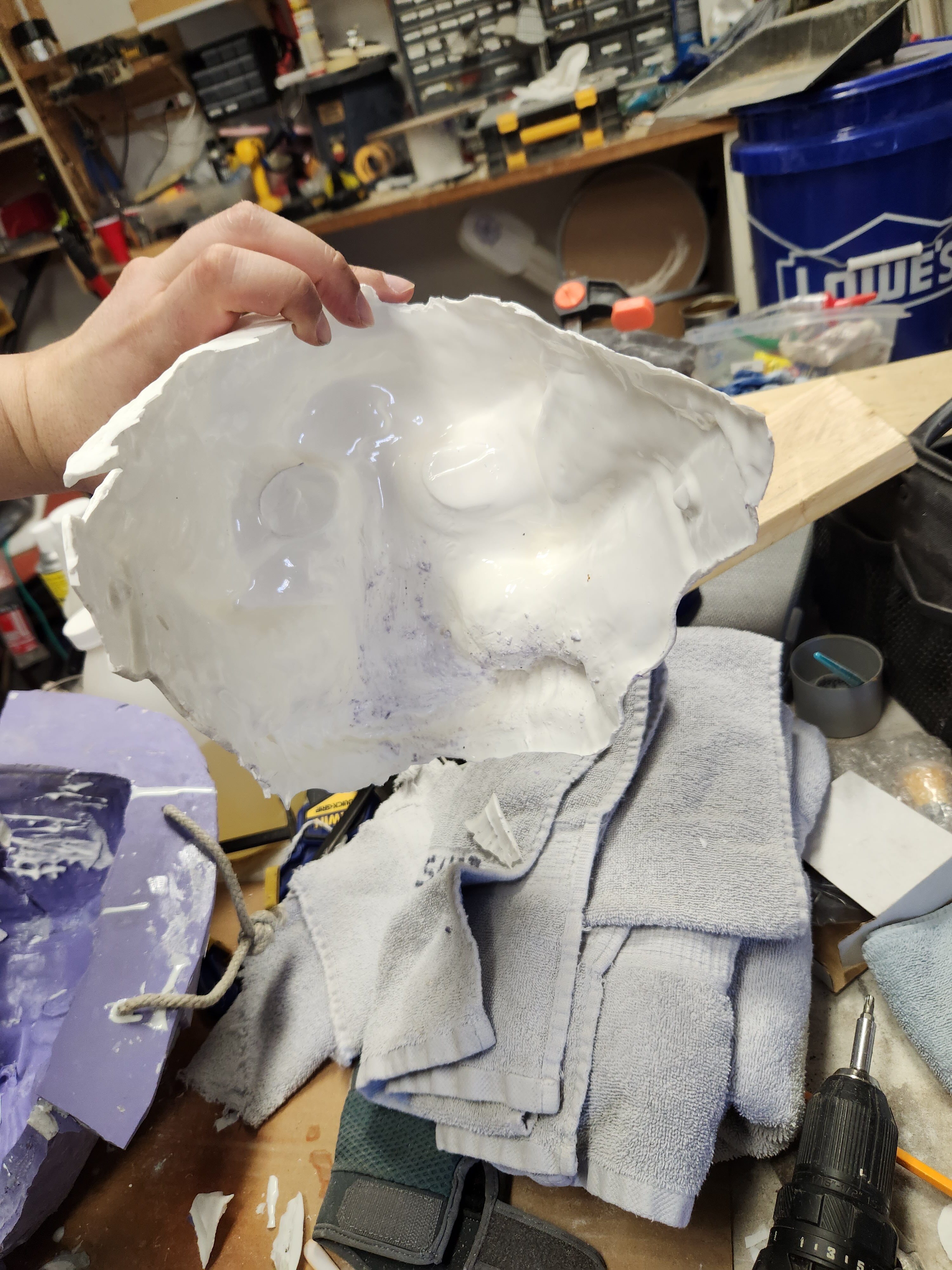

So I did a second casting the other day and the mold failed during demolding. The cast came out clean enough to reinforce and repair.
Unfortunately the mold is now unusable as it tore beyond repair. Mainly the nose section of the mold which tore off into several pieces.
I hope to eventually mold one of the cleaned up casts so I can continue making them.

What a cool project and sorry about your mold!! Based on the purple color, did you use Smooth-on Oomoo silicone? You might look into something from the Mold Star family for your new mold. Oomoo tends to tear easily (and becomes more brittle with even a few months age), while Mold Star has a much higher strength and long library life.
