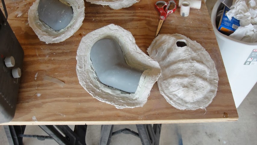

Woke up this morning and successfully separated my plaster mold jackets without destroying them. I forgot to take a picture before i started removing the clay from the master, oops.:
Smoothed out the clay seam and added some registration divots to line up the molds:
Replaced the jacket, clamped the 2 halves together and finally ready for molding:

Finely ready to pour that pink goo. This was my first time using silicon and was surprised at how thick it is. I always thought it would be thinner. So far, I have really enjoyed this process, I just hope the molds turn out decent. I don't expect perfect molds, sine this is my first time, but decent molds would make my day.

SUCCESS !!!!! My molds came out great. Better than i expected. I'll let them cure for another 5 hours, and then pour the second half.

In the future, don't demold the silicone until both halves are poured. When you place that first side back on the master, it won't fit 100%, and there's a chance that rubber from the second half will seep around the edges and bond to the first half. I'd spray release all over the inside of that first half before you put it back on the master to minimize the chance of boning the sides together.
Yeah, i was not attempting to release the part, but apparently the clay was stickier than the silicon, so it just kinda happened. And i will definetly coat the entire mold with release. Thanks.
