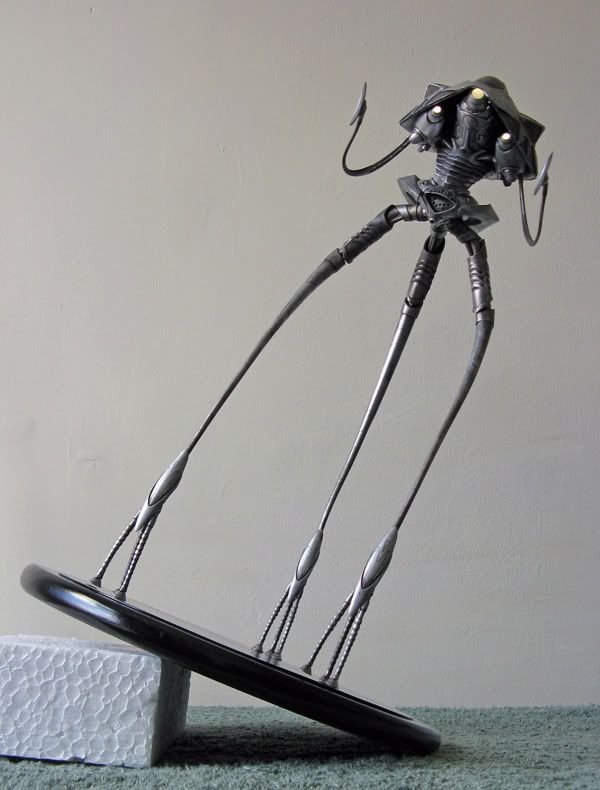

So only a small update, but I've got the base done which I wanted to do before attaching the tentacles and mandibles. You can see from the following pic that on it's own the tripod is a bit wonky in the legs. My ones rear leg had a bend to it's left and generally the whole thing wanted to lean that way.

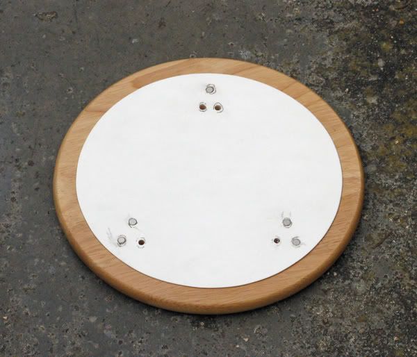

I'm using a cheap chopping board which I've given a smaller circular styrene raised section and then drawn around the toes as I placed it in a more ideal pose.
Initially the plan was to have one toe of each foot house a magnet and then have a pin and sleeve set-up for the remaining toes to lock the position but that was so much better as an idea in my head than a field tested theory as I found out. Much too fiddly, so I had two toes of each foot hold a magnet and a corresponding (stronger+bigger) magnet would be sunk in the base.
