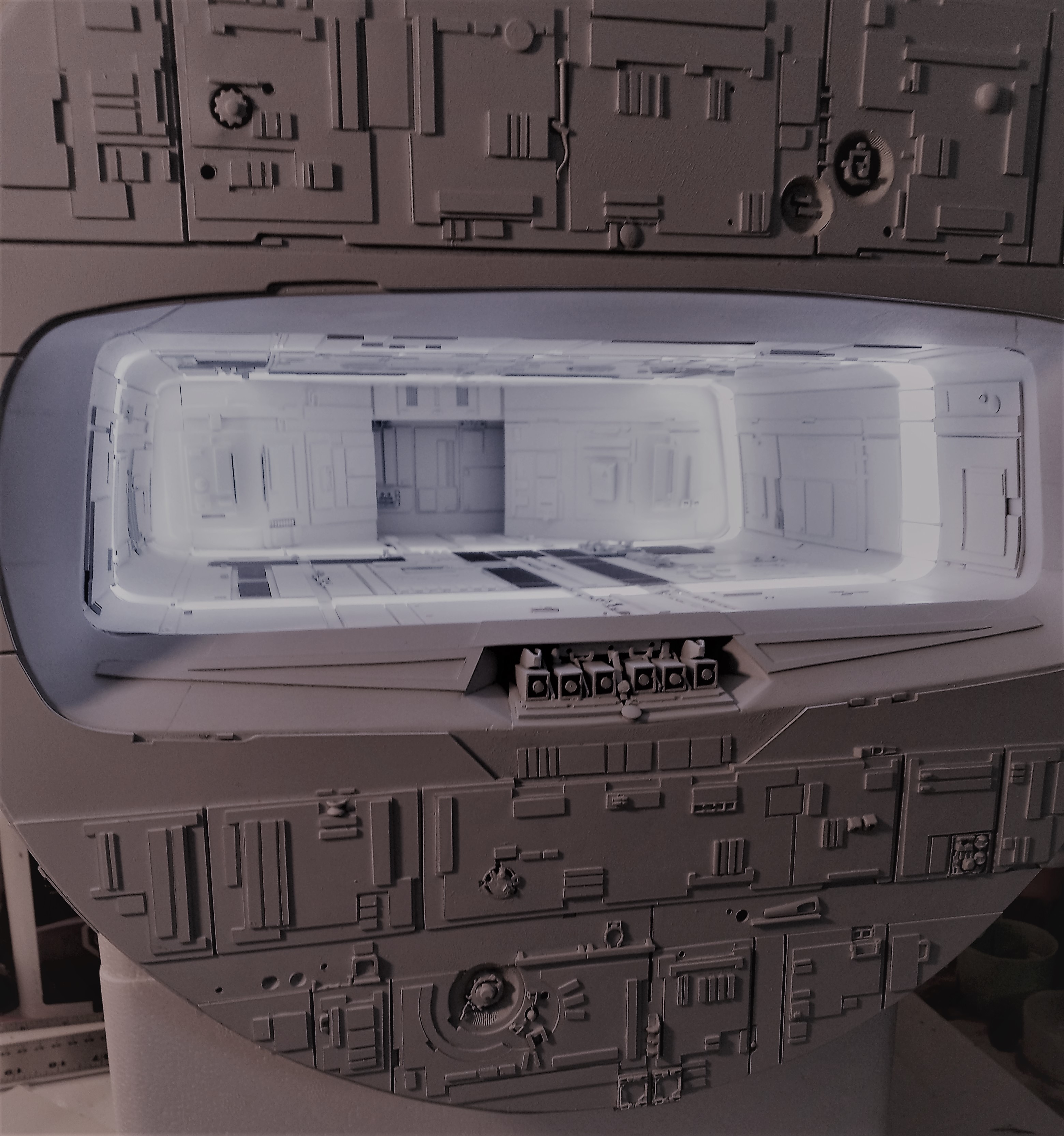

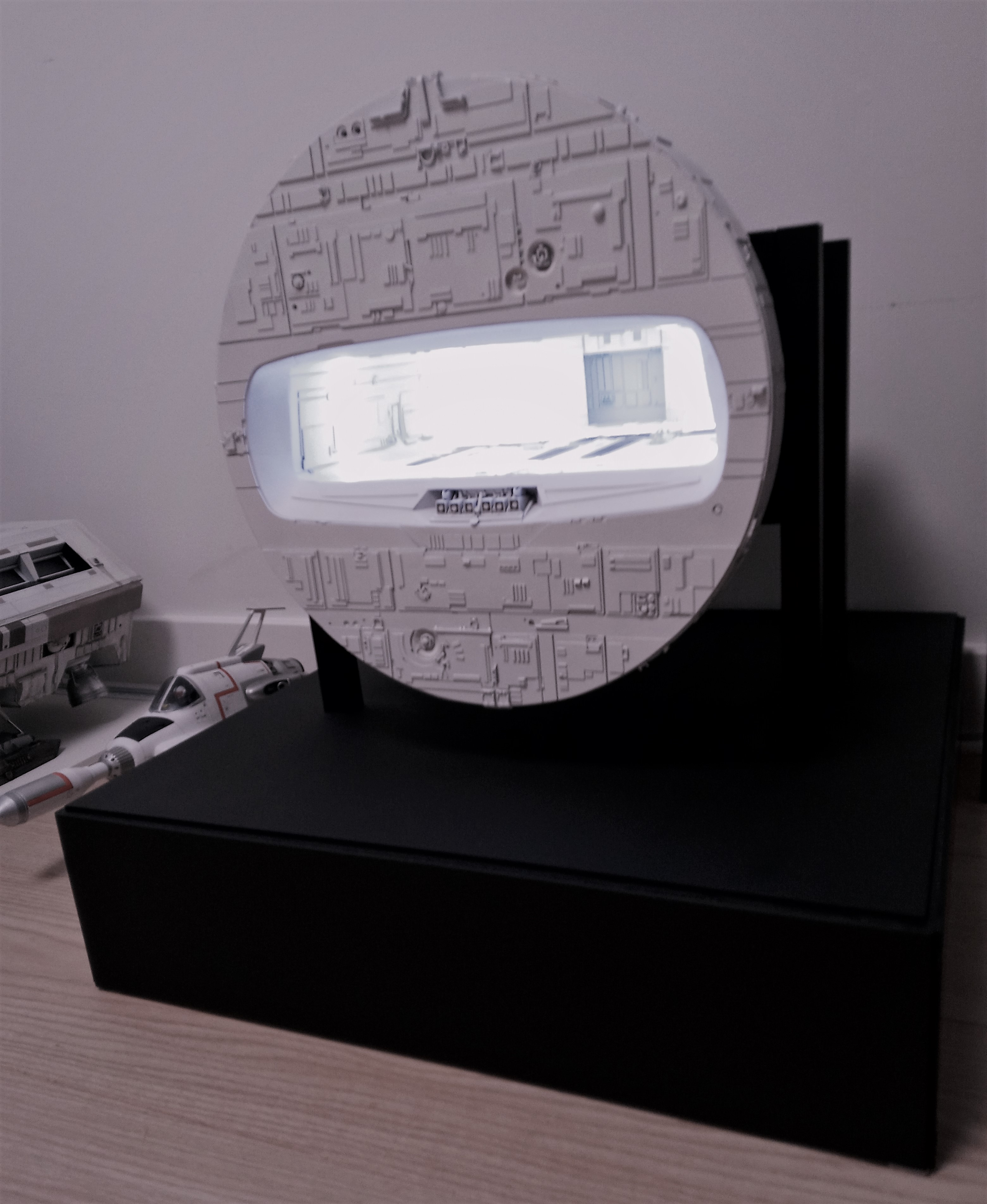

Done in terms of construction: I have to wire the lights, build the light wells and supports to display the "Plug" + a base.
Lots of work to do still;)

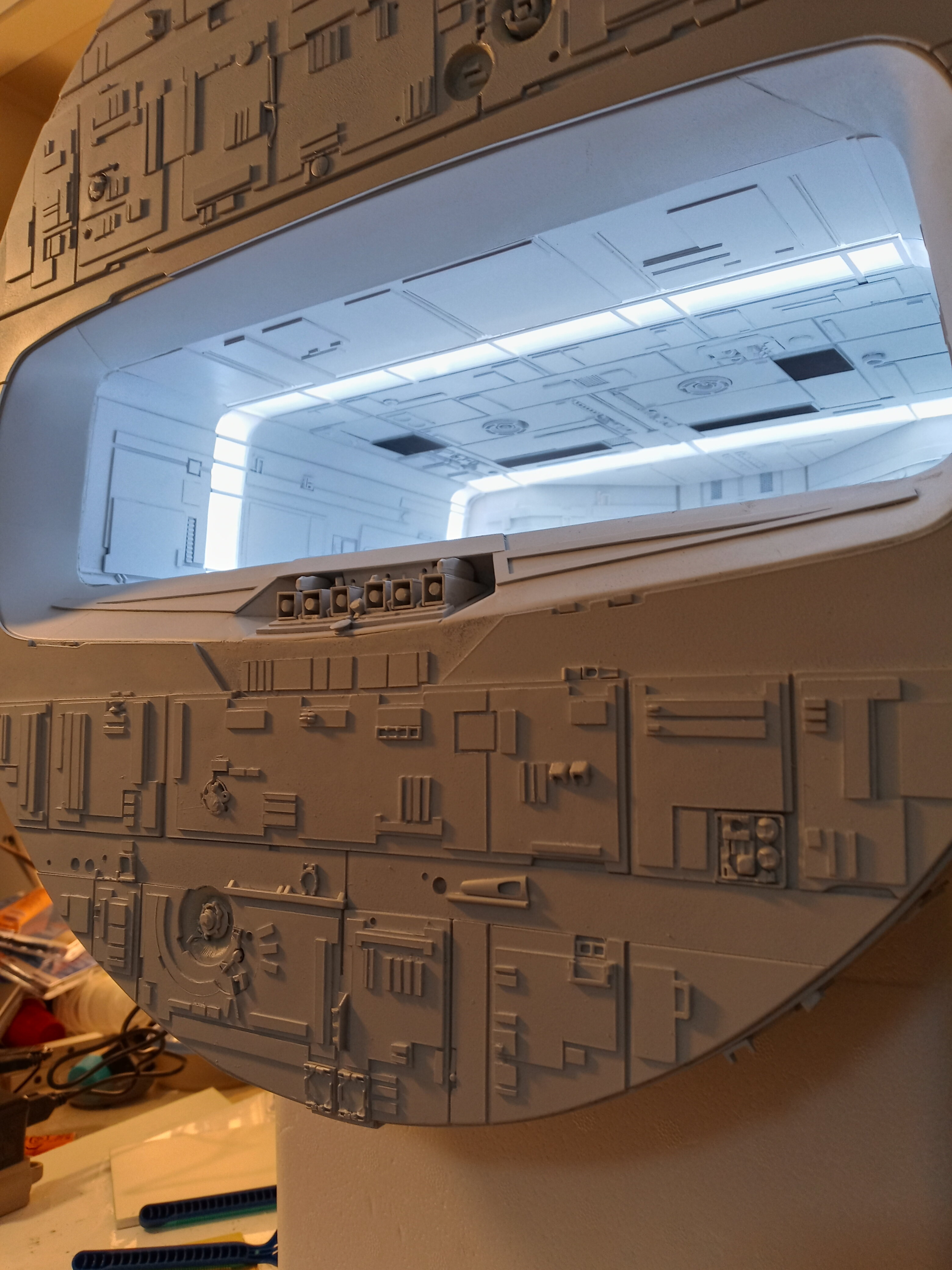

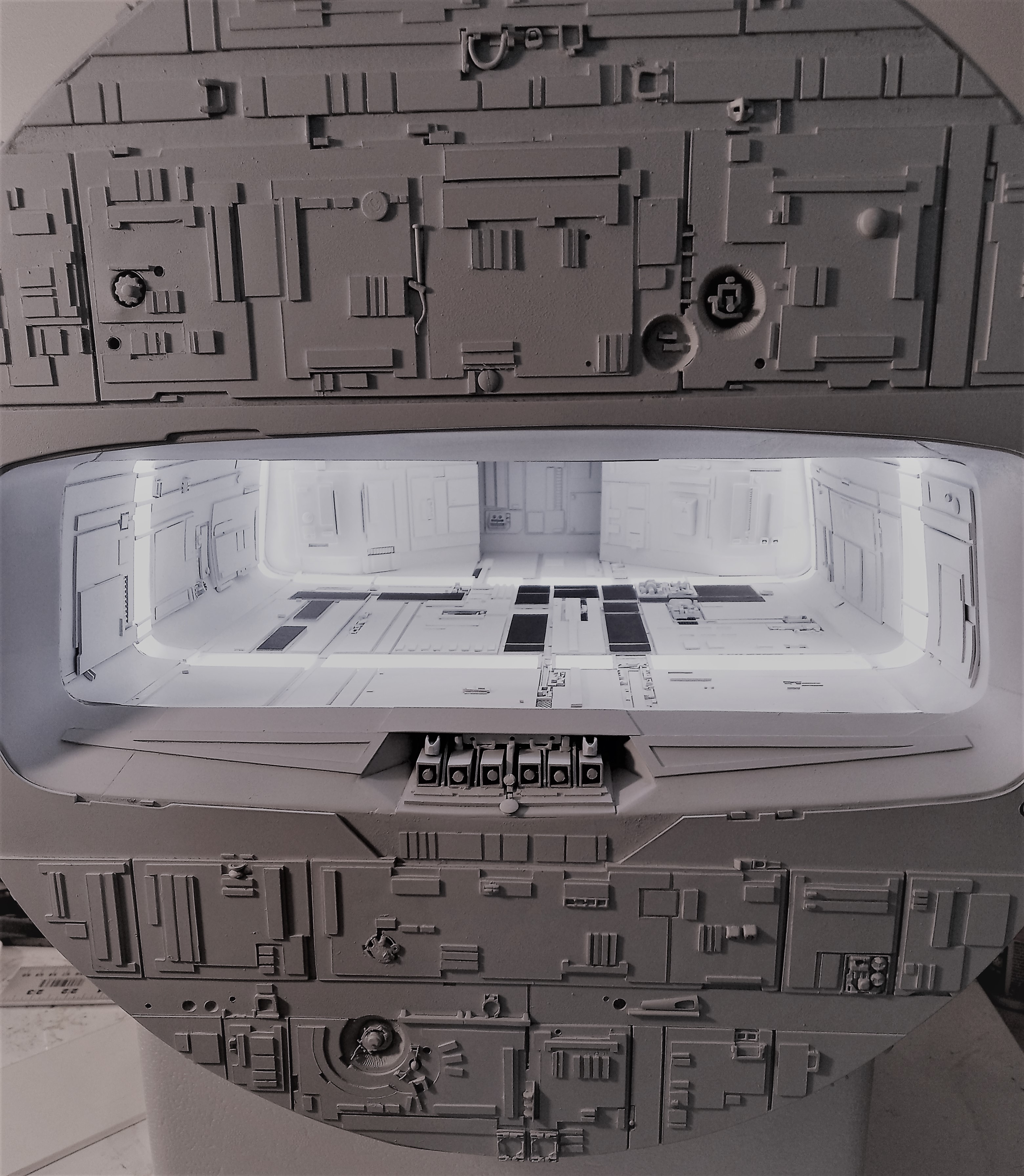

Have to agree with the other comments, the lights really do make the model pop and give it life.
Great work, joberg.
Thanks guys(y)The restored original doesn`t have working lighting. It was a pain trying to light those for sure:(
Your lighting looks fantastic!
Thanks:) I took 2 long LED strip made for cars and plugged it in a dual phone charger (12V), then plugged that one in a normal outlet.;)
Those strips also came with an On/Off control switch + different types of lighting: Clear, Day, Sun, etc...
The posted screencaps seems to show parallel walls...or am I miss-seeing that? By contrast, the side walls of your extraordinary!!! recreation appear to slant inward toward the back of the bay. Is it everyone's take that the miniature's bay did indeed taper? If so
1)Is this to be interpreted as a forced perspective element?
2)If so (direct question to joberg here) can you provide the angle of taper, width of bay's greater and lesser widths, and the "full width" section's depth (in relation to hub diameter, of course)?
Finally, should we presume the film's hub miniature was meant for filming from both "outside" and from within? (which is to say: can this be confirmed by posted photos of the hub miniature?)
Personally, it's always seemed to me the "from interior" shot appeared to show a forced perspective miniature whose bay width tapered inward TOWARD the bay's opening. Or am I misreading that also?

David, thanks for the comments/questions.:)
The base of the side walls, that is from the floor, is 12"1/4. The top of the side wall, ceiling, is 11"3/4. Slight angle as we can see on the screen-used model.
One part of the back walls is parallel to the opening of the docking bay, then slants toward the "hangar" opening at the end of the bay (see post #78 and #95).
Lens distortion is always a problem when researching/looking at pics:(. Unless I had direct physical interaction with the original model, or the person who did the restoration, had given me the actual measurements, all I could do was to blow the image on my computer screen until it was 15" wide.
From there, I measured each and every details/panels/greeblies using that screen pic (the real measurements are in the wonderful book titled: "2001: The Lost Science" by Adam K. Johnson (a member here and creator of AjaModels) are from the original blueprints.
The pics/video of the model can be found on post #60.
Another model was build for the scene showing the Orion approaching the Space Station V. This model was built in a bigger scale than the one built for the Space Station model. No one has found info/measurement/additional pics on that model to date:(
Again, no forced perspective or tapering of the walls...optical distortion from lens used (my IPhone cam included).
