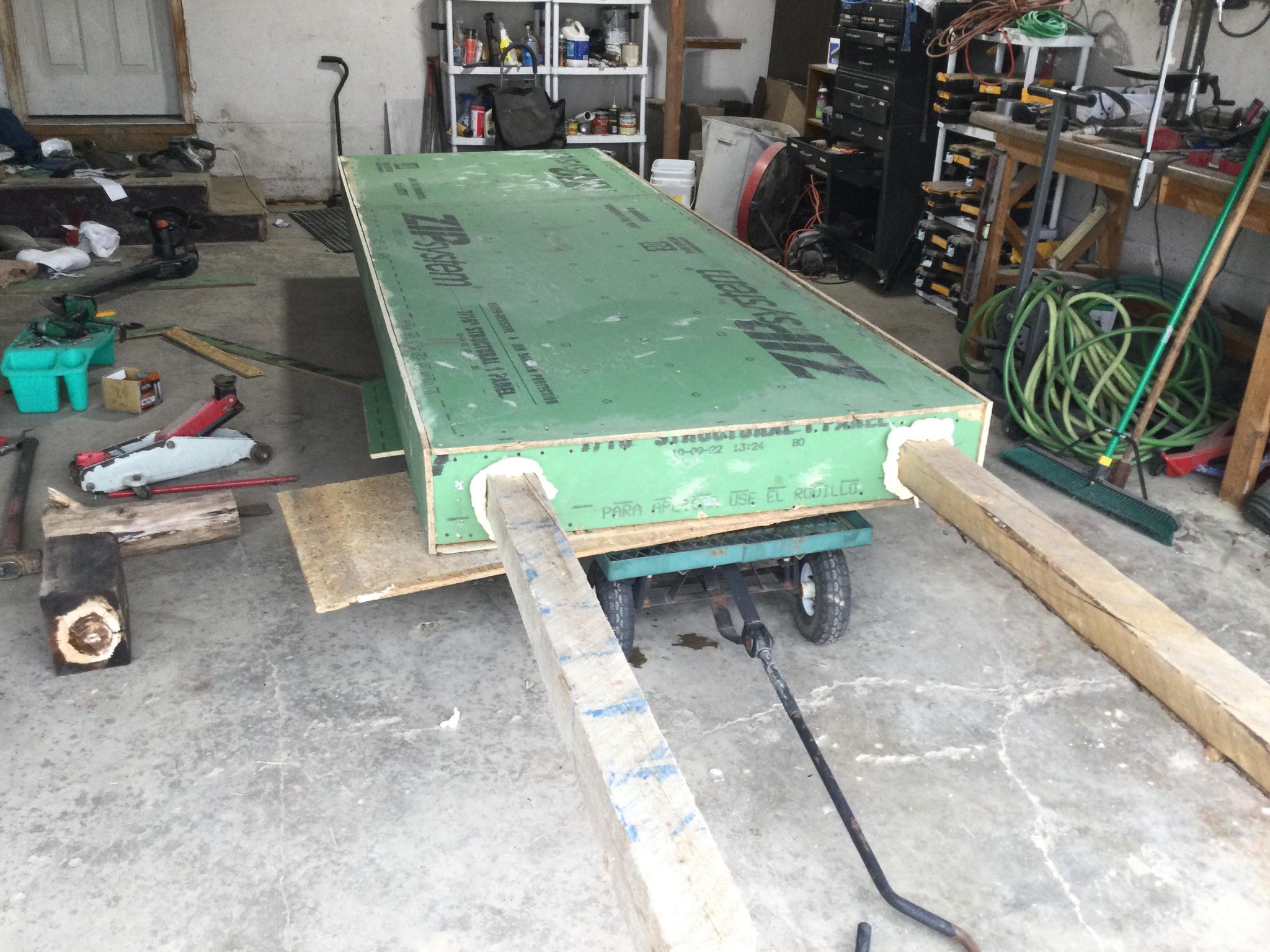

2001 Monolith build

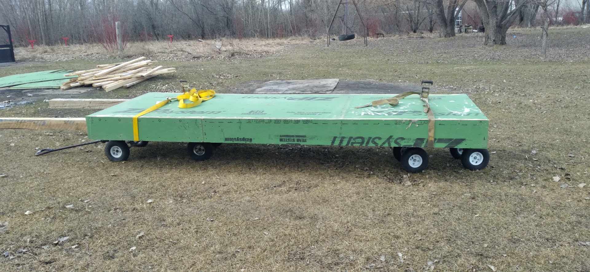

it took a bit of effort, but I felt it was now or never...I did not know how many tires on my little trailer would be destroyed soon?
Out of the garage!
I have to drag this about the distance of a football field into a woods along a curvy foot path,,,so this is going to be hard on this old retired guy...
but I like how things are sitting,,,

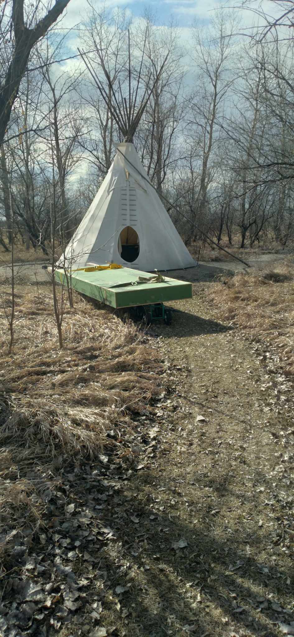

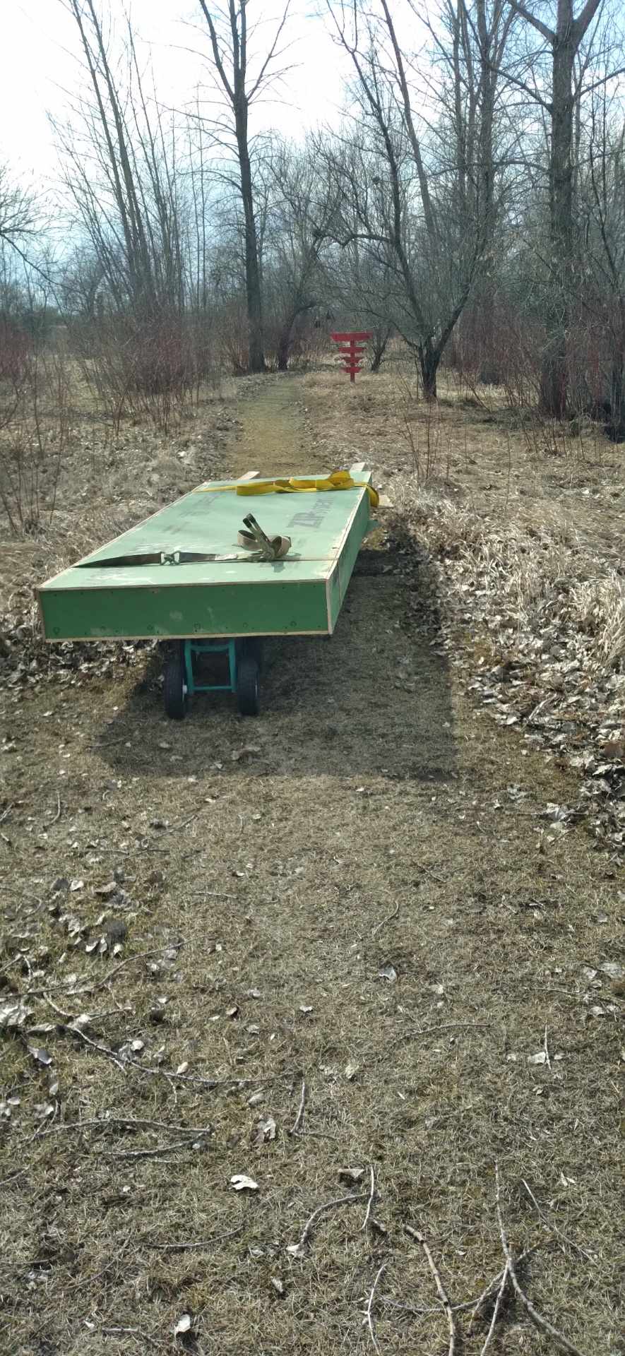

so I started to drag it by hand up the path.
Notice in the photo how the back set of wheels are not going to want to help at all.
They seem to think they know a different way to go?

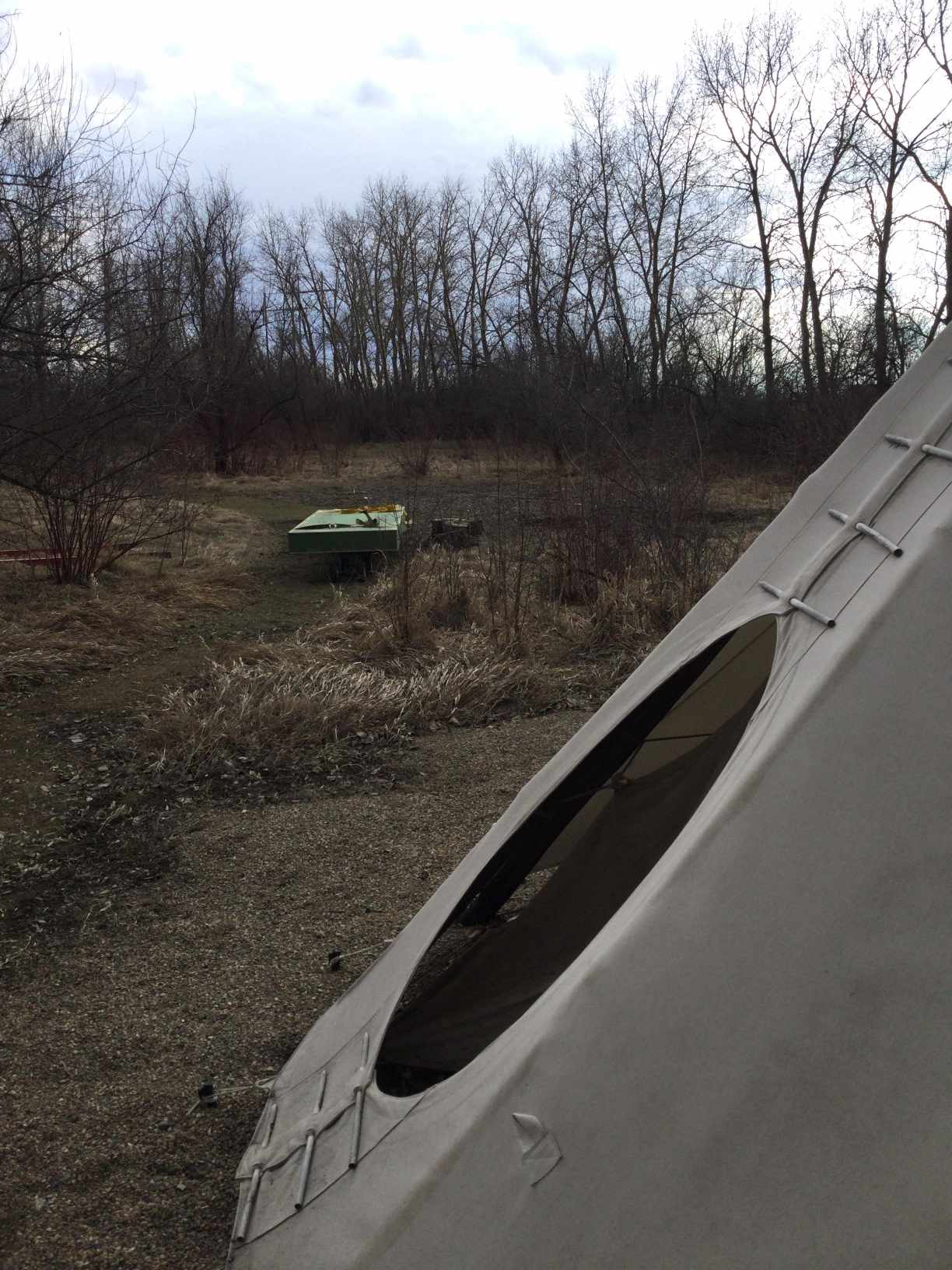

I would only yank on the trailer for about 10 feet at a time, then sit on the ground to catch my breath.

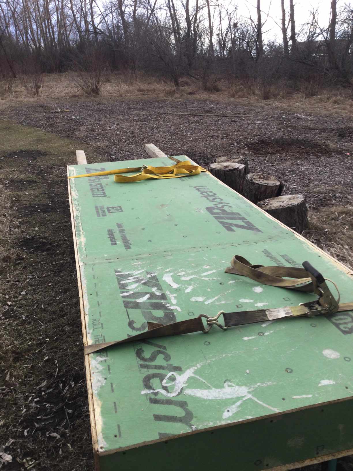

i had to constantly adjust the two trailers that were under the Monolith to keep them going in the same direction.

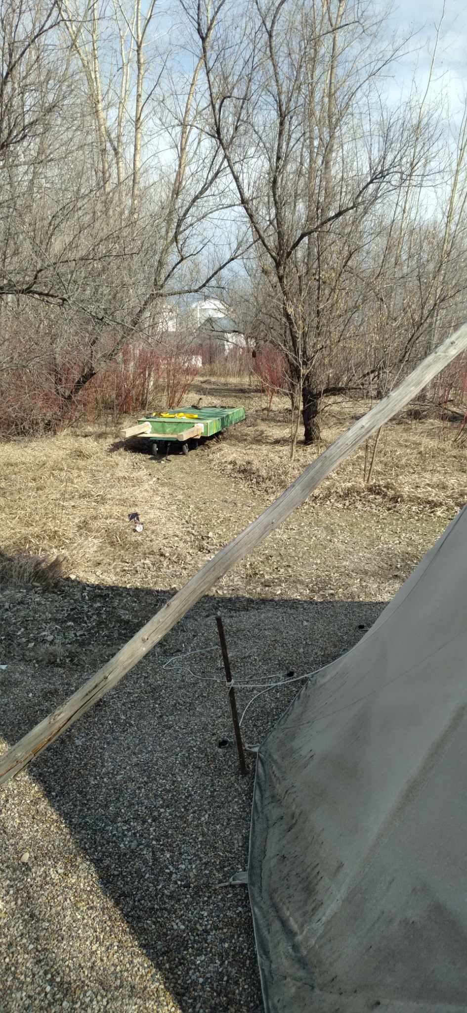

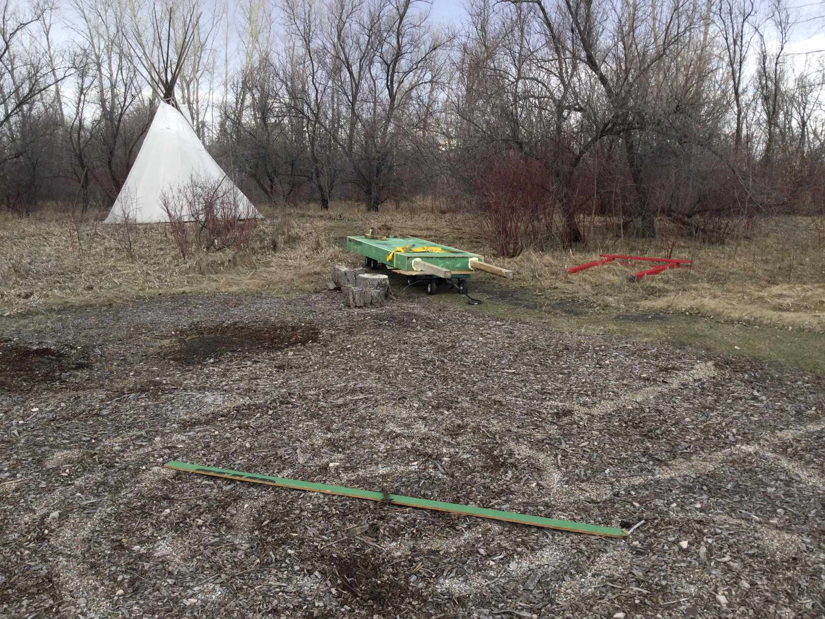

as I got closer to the TiPi, i knew it would be where I needed to make a sharp turn, but I was not sure how i would do this by myself.
the green strip of wood is where the Monolith will be positioned.
The angle will match the prevailing winds and will have a narrow side into the wind in an effort to have less wind load hitting the larger sides.
