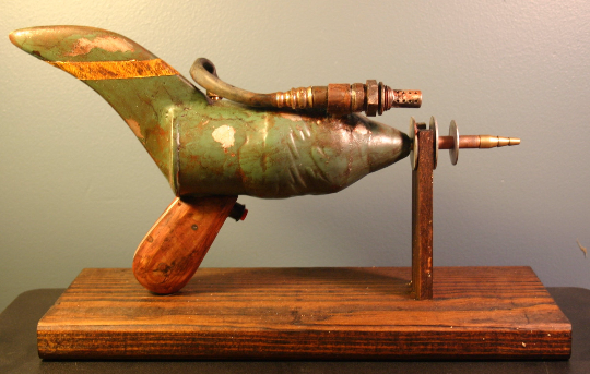

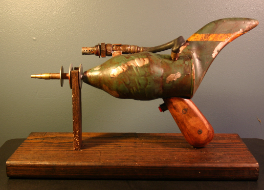

This is a Ray Gun I built a couple Months ago after watching those Adam Savage Tested videos. It was a lot of fun and my first from scratch, out of my mind build that isn't a replica or at least based on prop I've seen.
https://www.etsy.com/listing/502766146/raging-jaguar-ray-gun-one-of-a-kind
