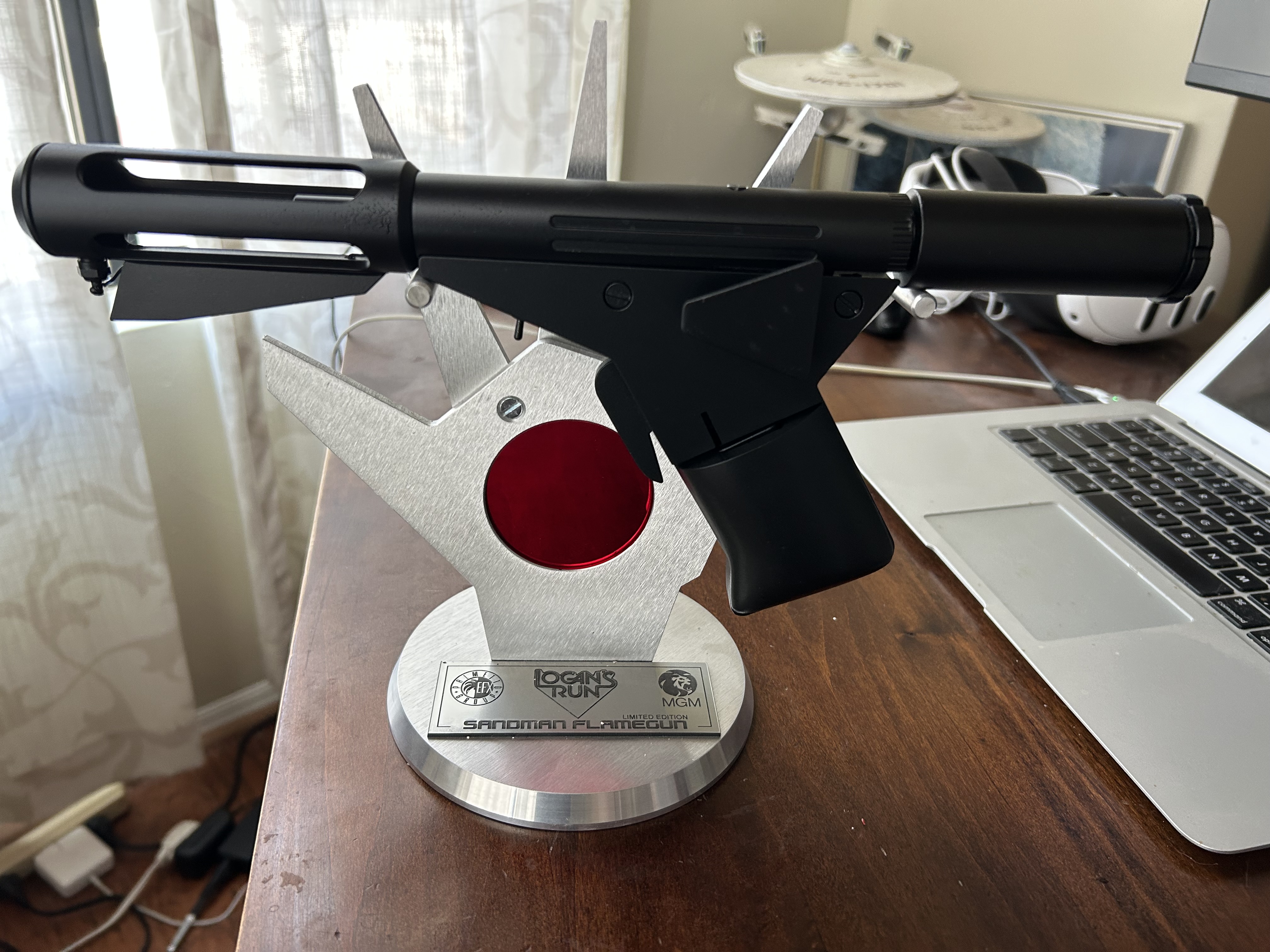

Ok here’s the follow up. Rich and I did some test fires with the cover plate on and off. With the plate off, the gun functions normally. With the plate on, it backfires. We think we need to seal the area around the tube where the gas is being expelled.
I think with the plate on the leak in the valve is allowing the gas to accumulate in the cavity. With the plate off, the gas just dissipates and can’t ignite.

I was able to flatten two sides of the double-threaded brass connector with the two o-rings and the gas tube with my dremel, and then I was able to use a box wrench to break it free from the firing chamber. My calcium carbide was still in good shape, not sure why, and so I did a test fire after cleaning the filter and so far so good, no leaks for me, but I will continue watching this thread for more info and insight. Best of luck to you, JediDunn!

Just wanted to circle back and report gun is fixed! Richard Coyle determined flame was traveling back into the gun through holes around the barrel tube. He used a flame resistant material to pack off that area and that solved it. I also gave the gun a fresh paint job.
I hope you used heat resistant paint on it.
