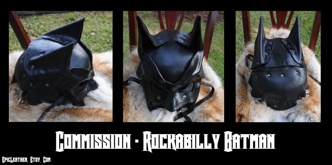

You can view the result of mine here.
2012-10-24-050801 | Flickr - Photo Sharing!
My comp is still dead and I've been using my PS Vita and it cant upload the photo. I made a flickr account just to post this.
I'm a little late to the party but just have to say that is amazing work by greatnsecret.
Hey greatnsecret do you have more pictures of your cowl like back part of it ! your it's so cool !!!
