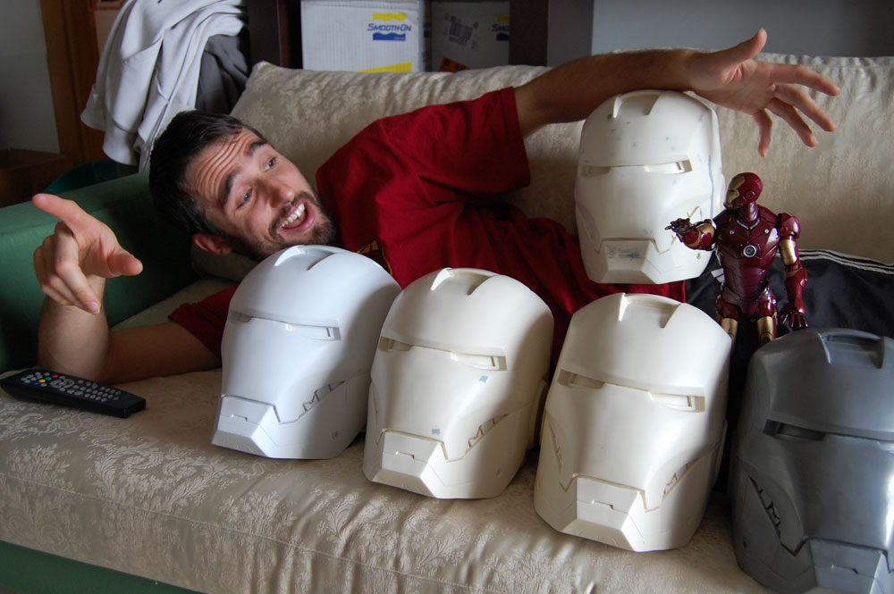

Here's a pic of my helmet made of sintra and bondo and as we say in italy: a lot of BUCIO DI CULO! Pronounced: boocheeo dee koolo means: "A PAIN IN THE A**" :D

That pic is too funny Gemini Khan! So is this pep smaller than the others? I just finished the dung beetle helmet and it makes me look like a bobble head. Its a nice helmet but its just huge. I guess If I had armor to go with it, I would look more proportioned but I always thought his helmet was smaller and barely larger than his head. I know I can just scale it down though. Pep is such a pain. Does anyone have measurements of an average sized Iron man helmet? So I can compare it to mine and see if I'm just crazy and its not really to big?
this helmet looks a little small, especially if it's just like the bust which it's believed to be a little less than 1:1 to avoid recasting.
I'd say scale it up by 10-15% ;)
Thanks for the pic :D
I have a small head, I scaled it down 5%
... Though I'm starting to think I should've done 10% down

Lol! I meant it when I commented and said you have the best helmet I've seen. Now I see why you defend your method so strongly!
