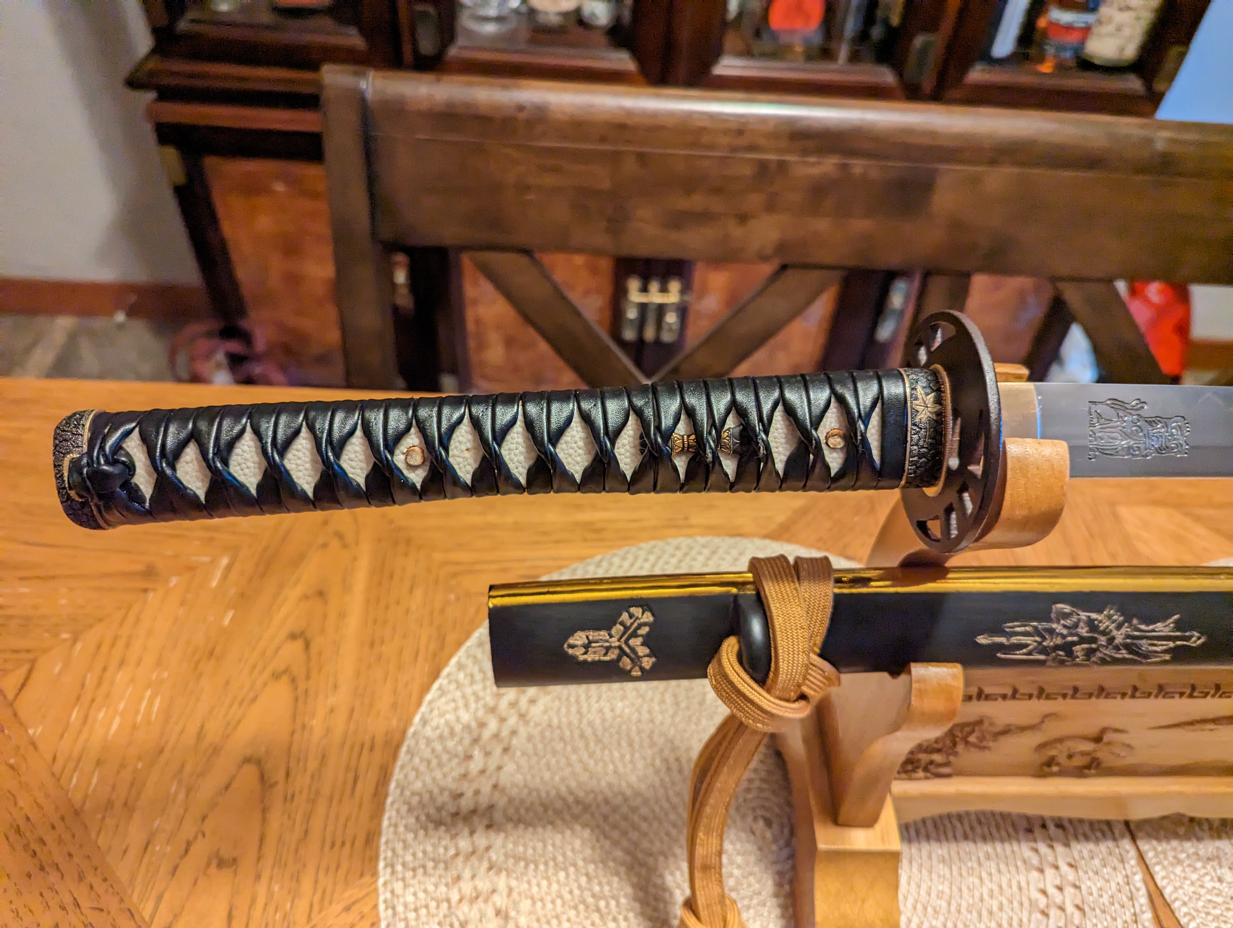

My fuchi and kashira showed up today so I am now tasked with taking my handle apart and attempting to rewrap it.
Wish me luck!

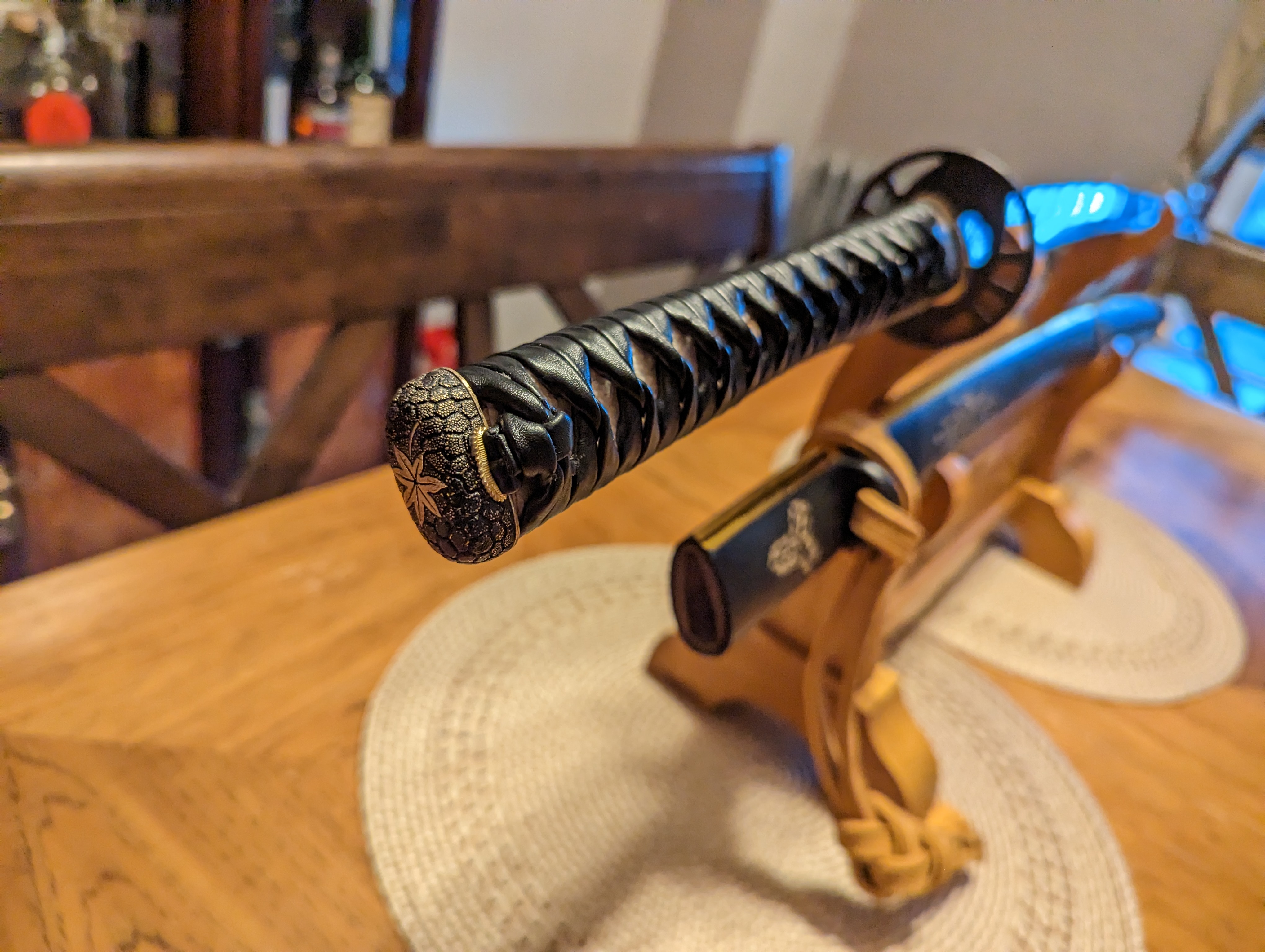

Rewrapping the tsuka was a success! It's not the best job but it is a serviceable job. I took the handle to my sander to try to give it a more hourglass shape before the rewrap.
PXL_20230224_224118998.jpgPXL_20230224_224133401.jpgPXL_20230224_224143289.jpgPXL_20230224_224220254.jpgPXL_20230224_224234484.jpg

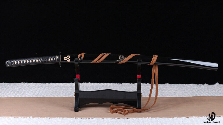

After recently watching the video that Adam Savage had posted 2 years ago on Tested.com regarding his replica of the Bride's katana from "Kill Bill;" I was reminded that I too have a cheap, $60 dollar stainless steel replicate I bought back in 2008. After realizing how horribly inaccurate my katana was, I felt compelled to try to create myself a more accurate replacement for my collection. This led to hours of searching the internet.
Down the rabbit hole we go. . .
After searching, I realized that no one makes an accurate replica for sale. There have been some created here on the RPF, but that is about it. That led me to the conclusion that I will have to try to replicate what Jason Blakey had done for his replica. Going down his path though leads to some challenges. First, the fuchi kashira used on the screen used props appears to have been discontinued almost 10 years ago and are extremely difficult to find. Second, I do not have a CNC machine to complete the engraving myself on an accurate Japanese Iaito blade.

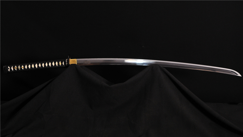

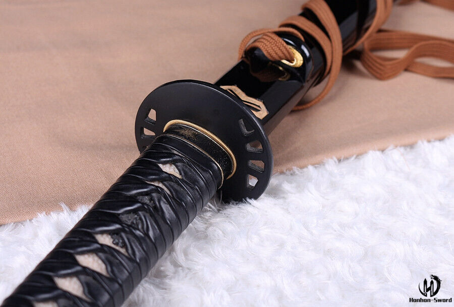

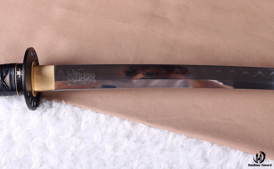

Because of these barriers to entry, I have to take a slightly different route. I would have to purchase an already created sword then modify it to be more accurate. After scouring the internet, I found one on eBay that I felt I could work with. It is a T10 spring steel blade that has been differentially hardened. This particular sword has many inaccuracies; but I purchased it for a few reasons. First, I liked the quality of the Foo Dog on the blade. Second, it had the most accurate fuchi kashira on the tsuka that I could find. Lastly, they let me modify the sword slightly by getting a real leather ito wrap and allowed me to swap out the inaccurate saya for a plain, gloss black one at no extra cost. I also liked the quality of the real hamon on the blade.

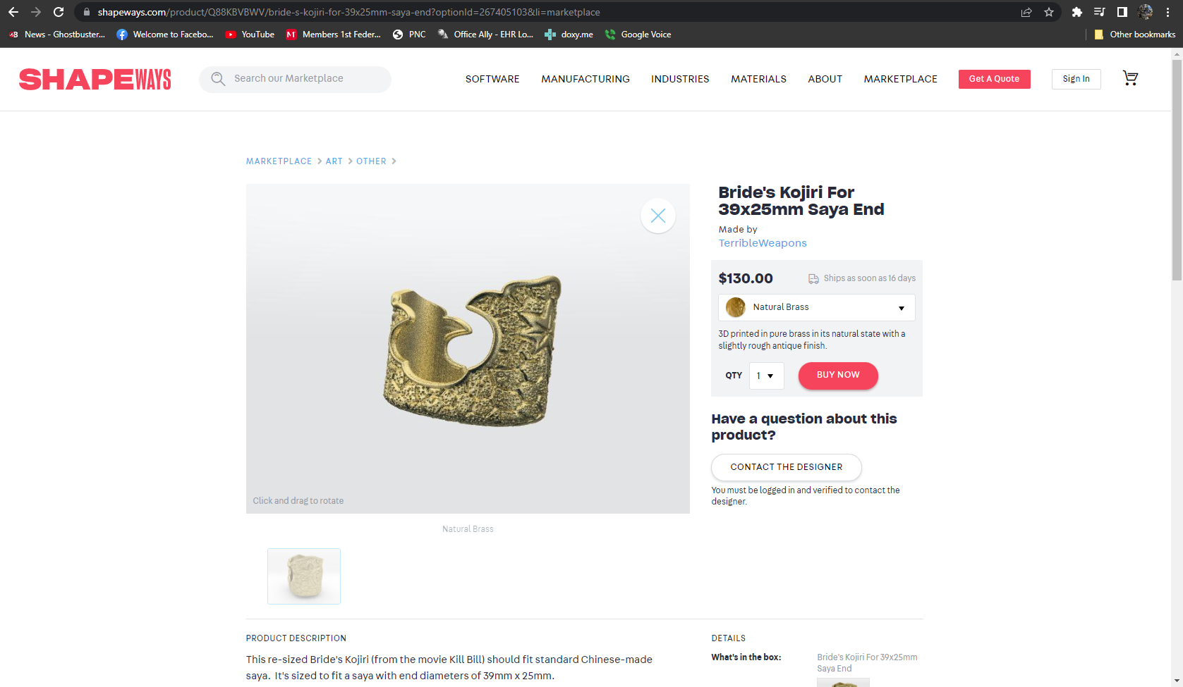

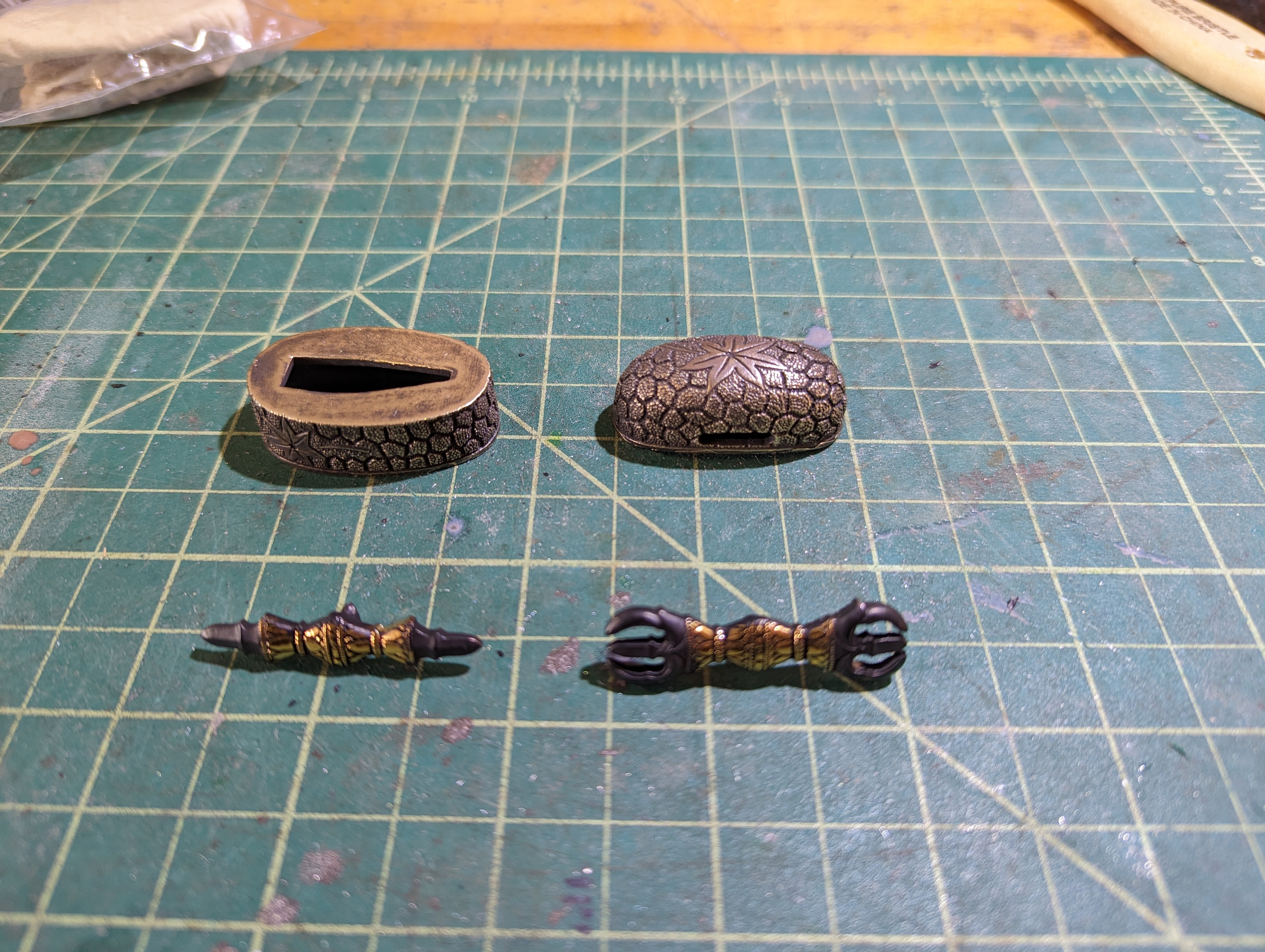

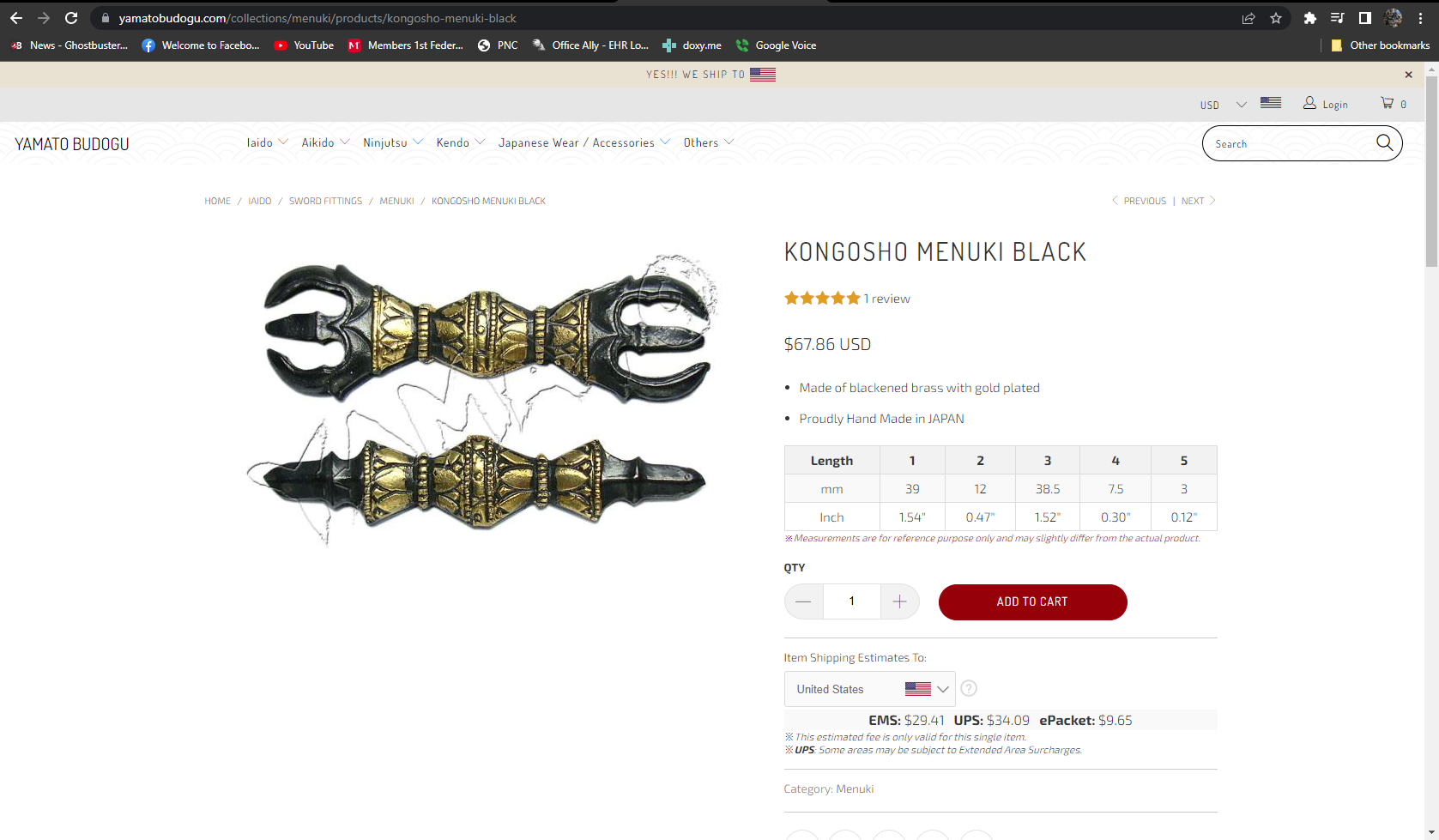

My plan is to replace some of the fittings on the sword, and then do my best to create an accurate saya from the plain black one that will be coming with the sword. This means I will need to take a stab at trying to carve the imagery into the saya myself, by hand. These are the fittings that I was able to source for this build. The kojiri is a 3D print designed by Jason Blakey that I am having printed in brass, then chemically aging myself.
View attachment 1667560View attachment 1667558View attachment 1667559View attachment 1667557

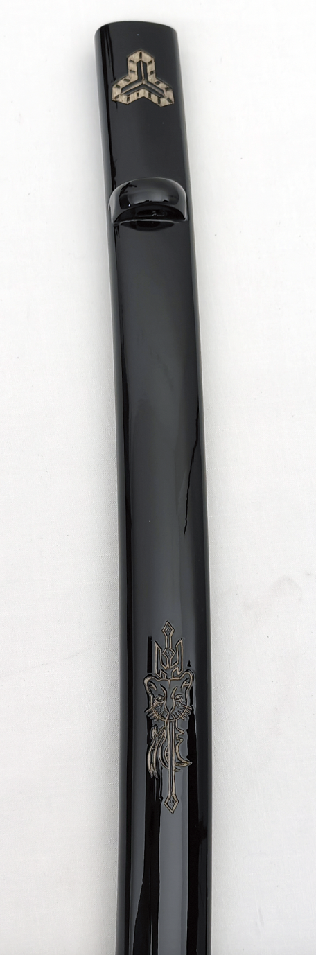

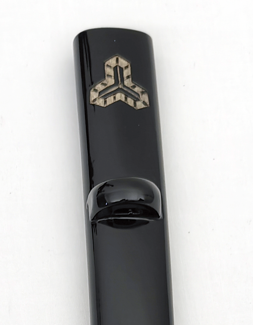

FINALLY got photos of the Saya that Swords of Northshire etched for me. It has taken them a while and I have had to harass them via email about once a month to get updates. I believe because it is just a Saya and not a whole sword, my order probably wasn't as significant as others; but that is just speculation on my part. Here are the photos they sent me this morning. Hopefully I will have it within the month. As long as my sword fits into it, I will then finish modifying it with the ring, end cap, brass sides, and the reinforced koiguchi.
At least in the photos, it looks like they did a good job. I will update once I get the Saya.

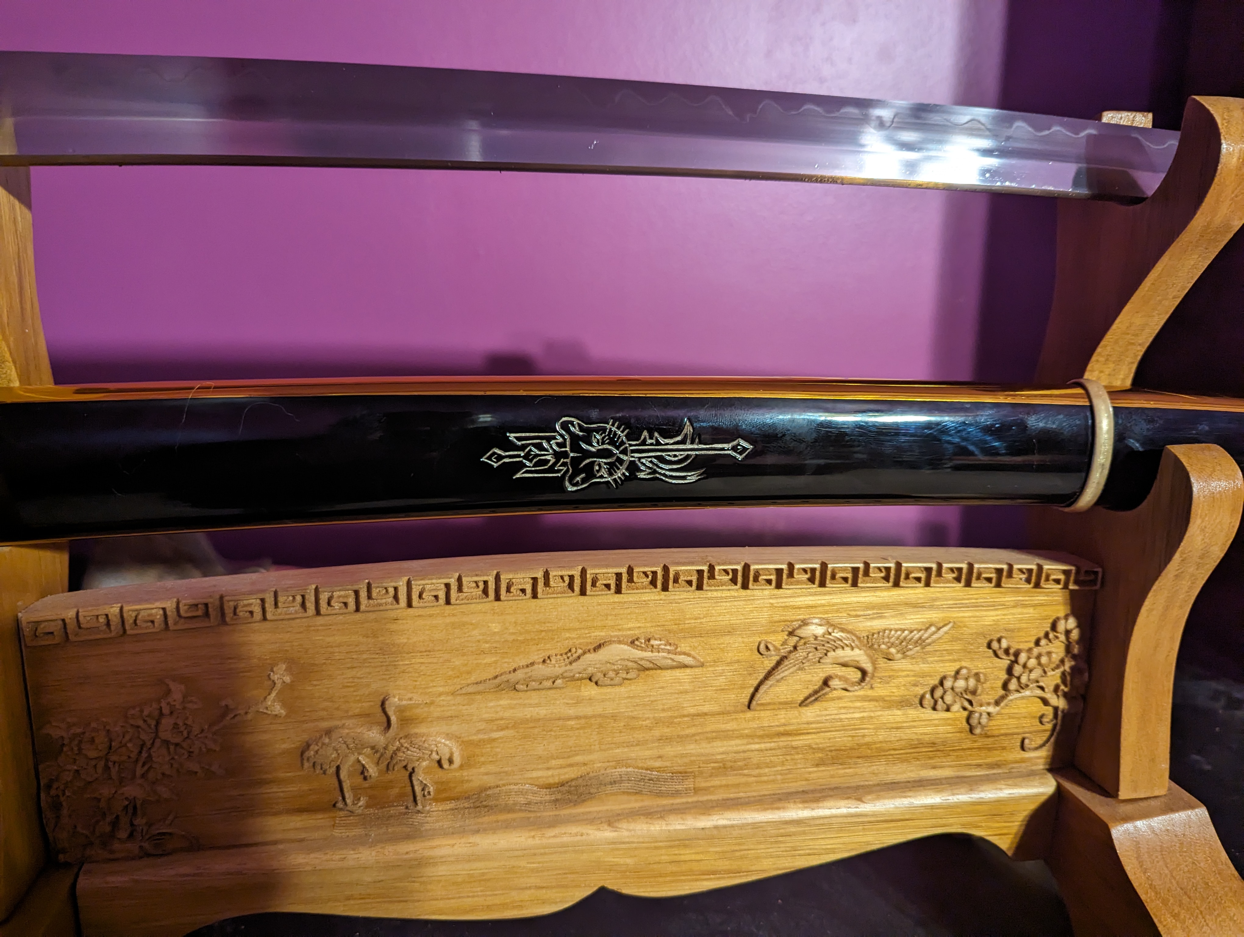

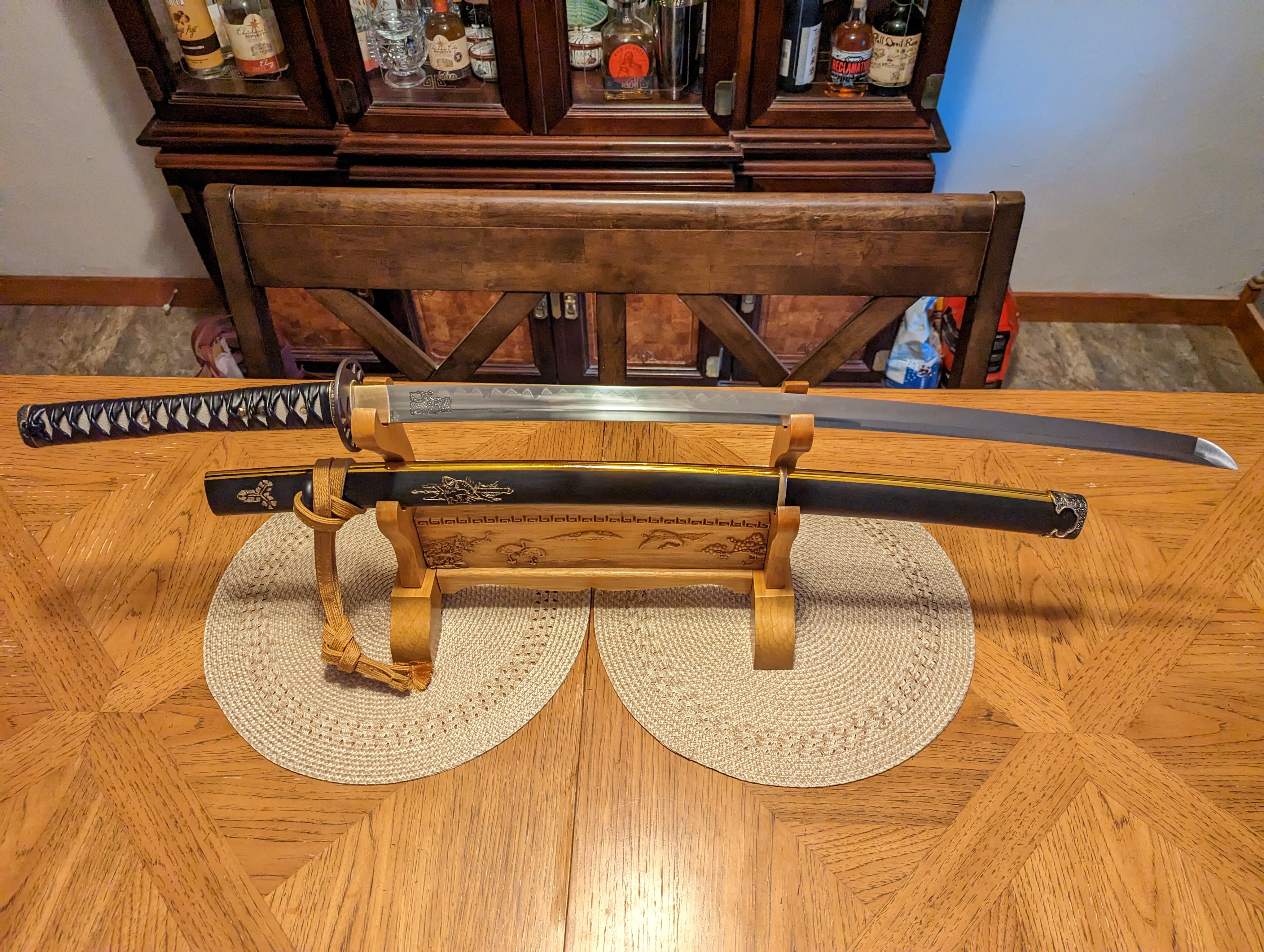

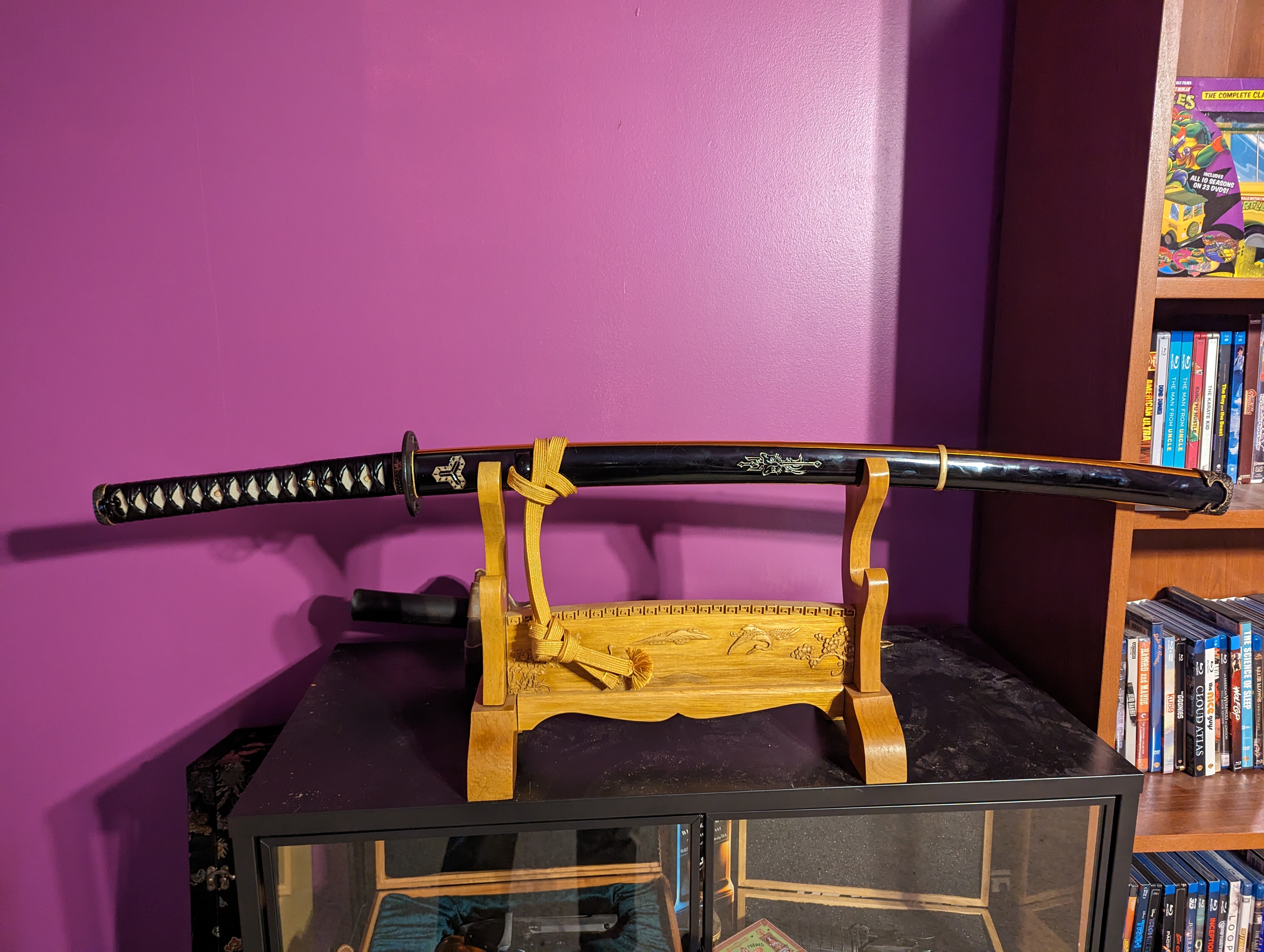

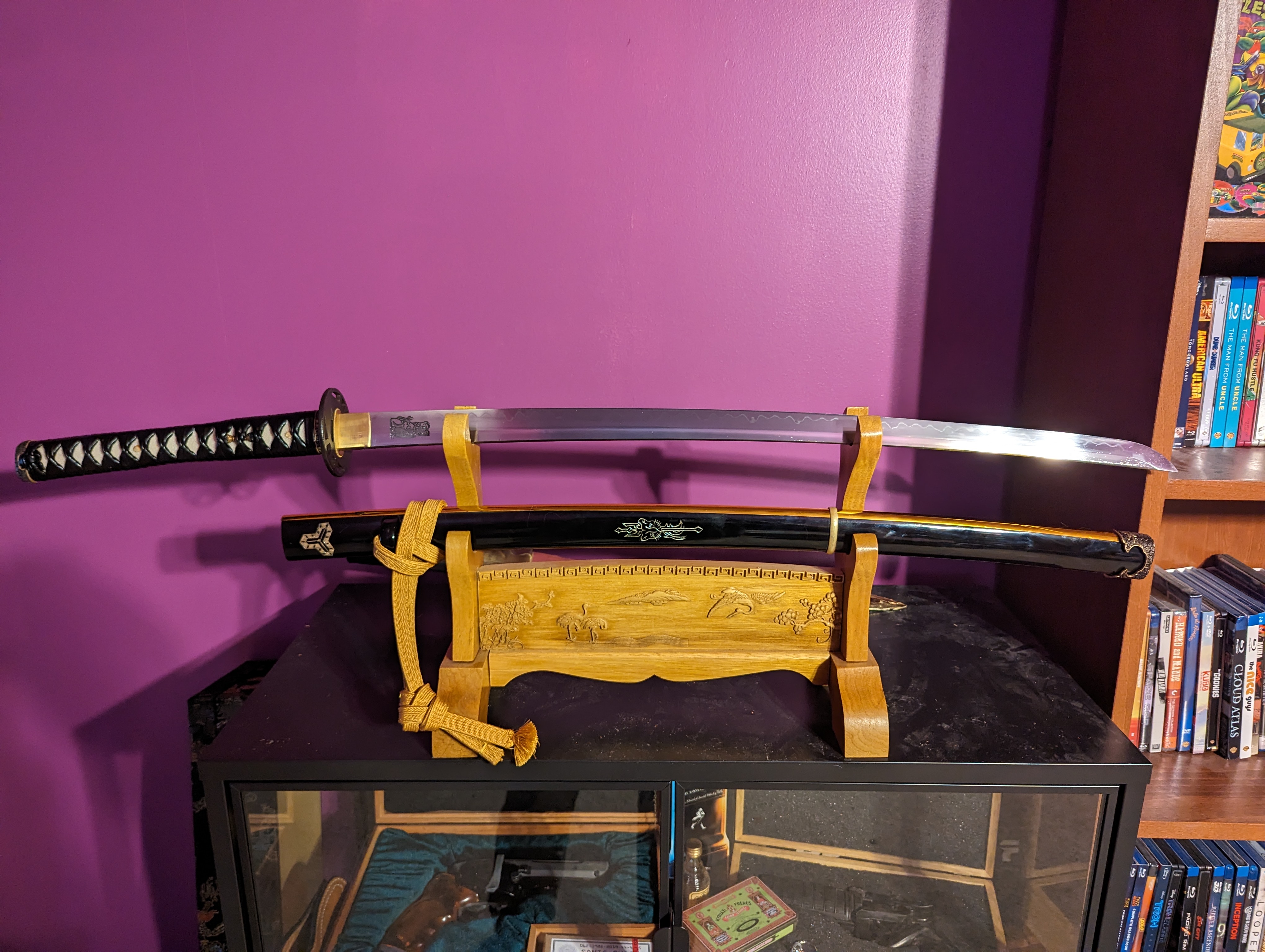

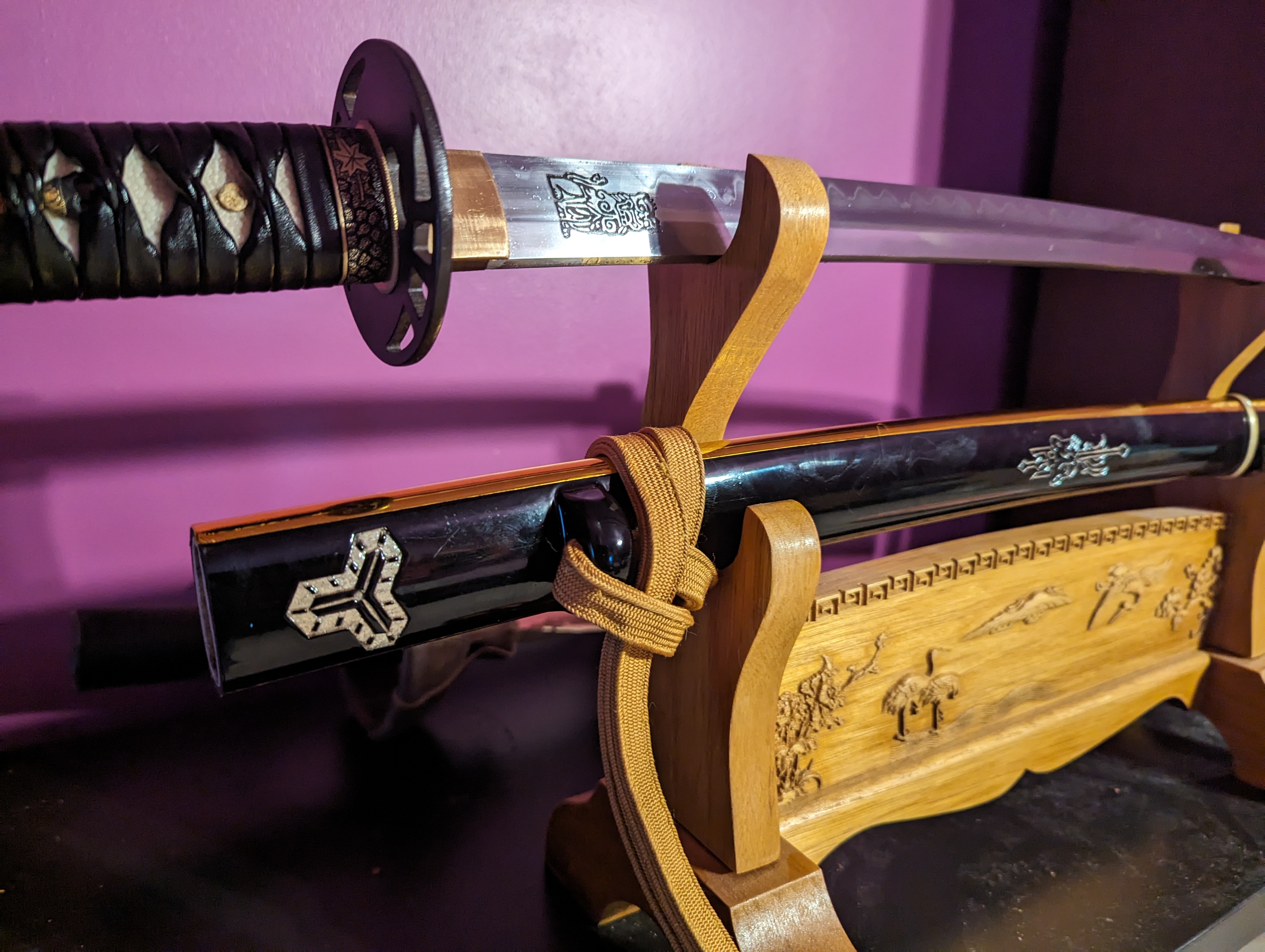

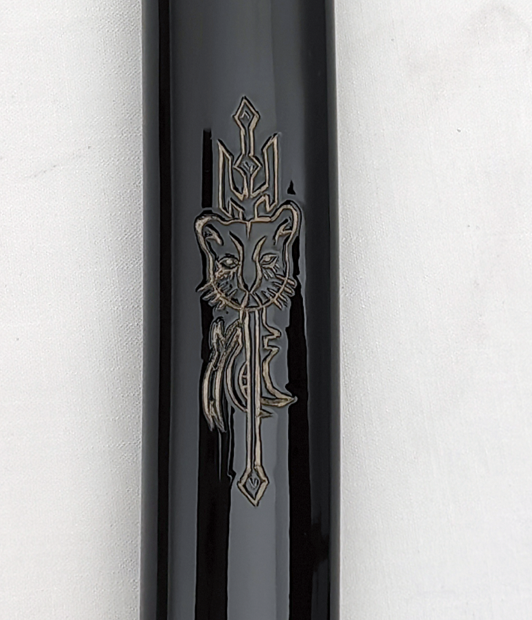

FINALLY got my new saya in for my sword. They did a good job with the carvings. I transitioned my hardware from my old saya to the new one. This is pretty much done except for the reinforcement for the koiguchi that I still need to make.
PXL_20230926_205859485.jpgPXL_20230926_205927482.jpgPXL_20230926_205934607.jpgPXL_20230926_205939146.jpg
View attachment 1725618 View attachment 1725619 View attachment 1725620
Their carving is cleaner. But yours is more accurate.
