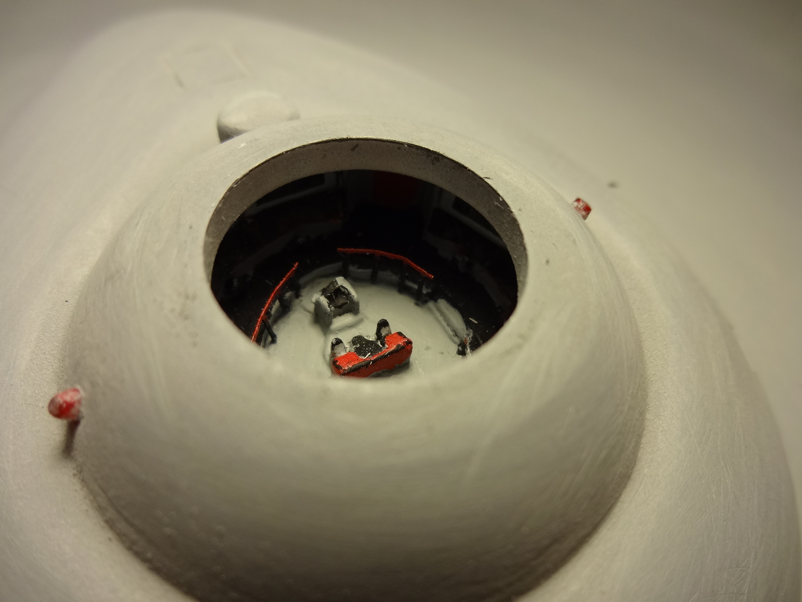

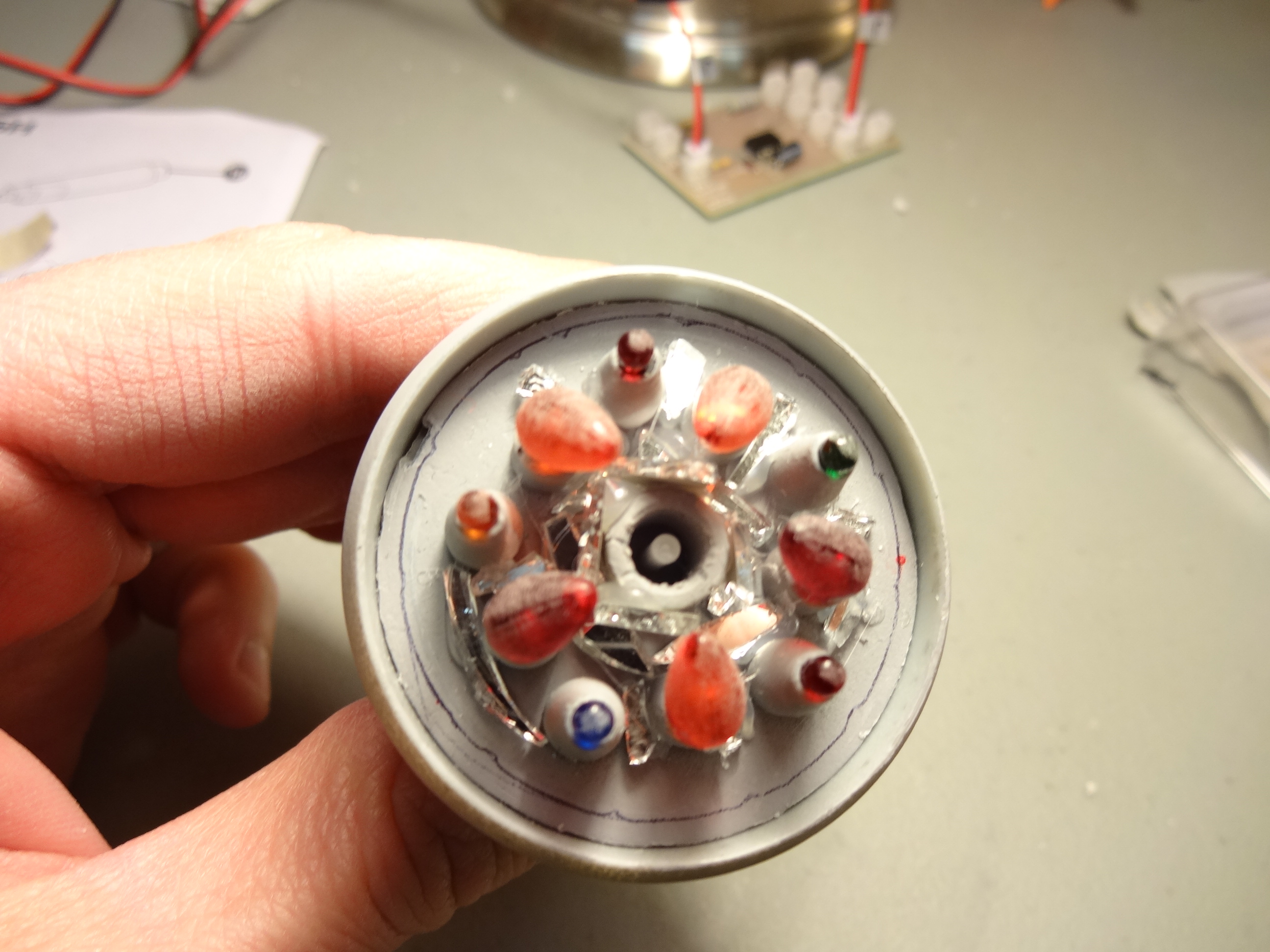

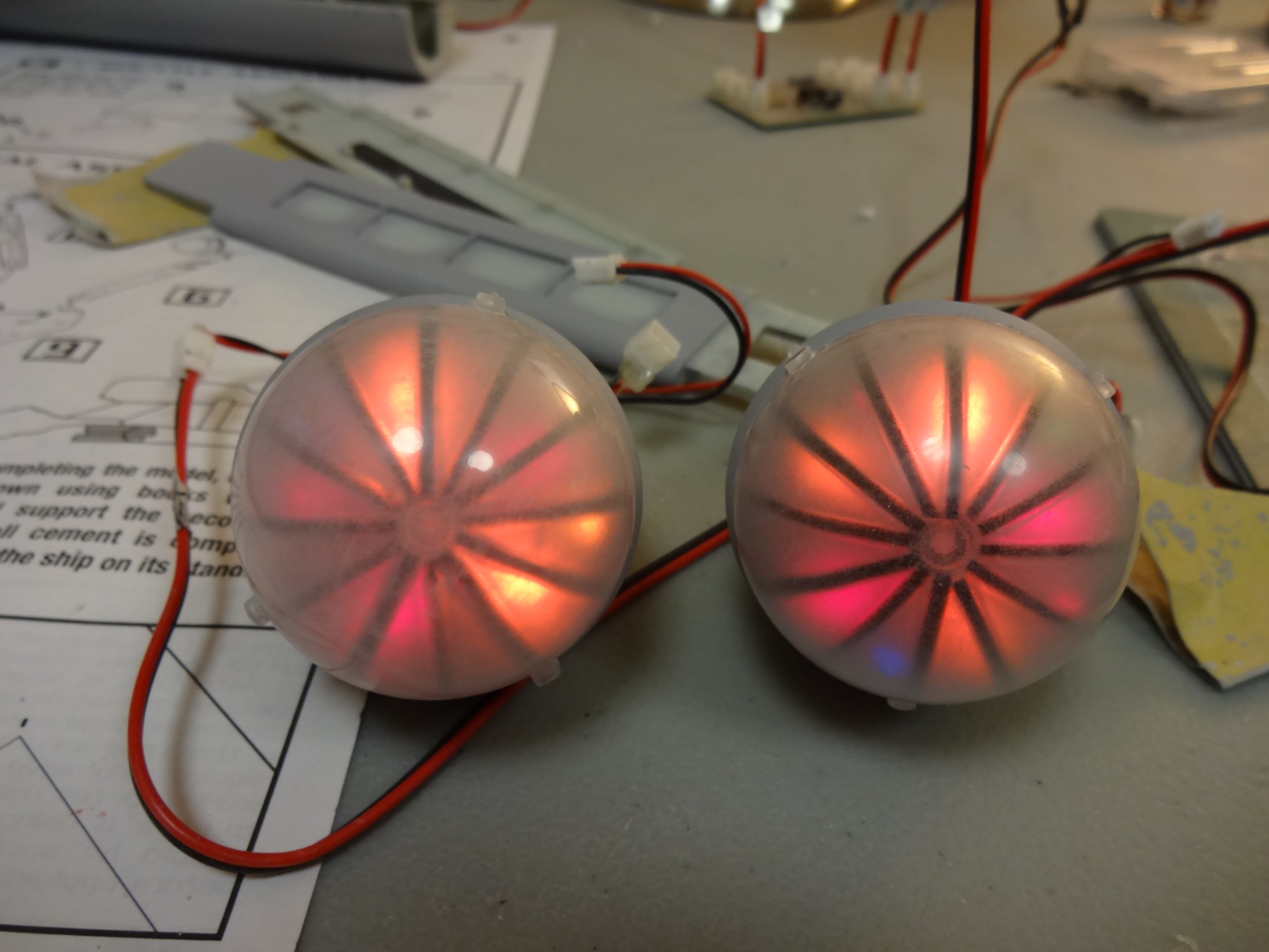

Anyhow, now that I'm happy with the saucer, I moved on to getting the Bussard Collectors right.
I went with someone else's suggestion of putting broken mirror pieces in, just like the original:

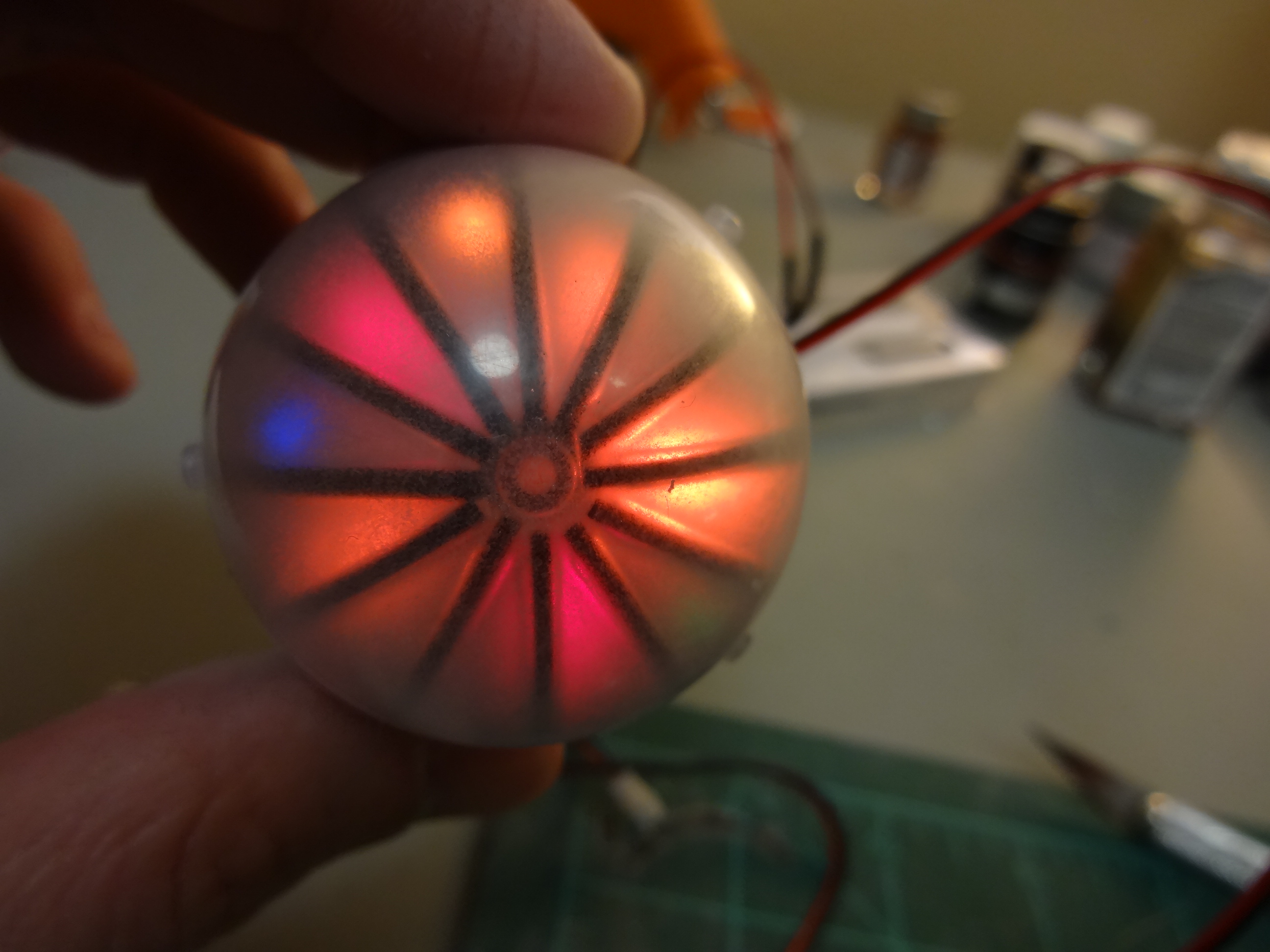

I'm not so sure it makes a whole lot of difference...the original Christmas lights were more Omni-directional and so the mirrors would pick up more light from them. With the R2 lighting kit, the actual LEDs are buried under the plate that the "bulbs" plug into. I'm fairly happy with the result though:
My only issue now is that in trying to dull the outer domes, I sanded the first one, but thought that was too dull so I only sprayed Dullcoat in the other one which I thought came out about right. So, now I have uneven domes:
I hope that maybe I can buff out the sanded dome a little so that maybe only I will notice.

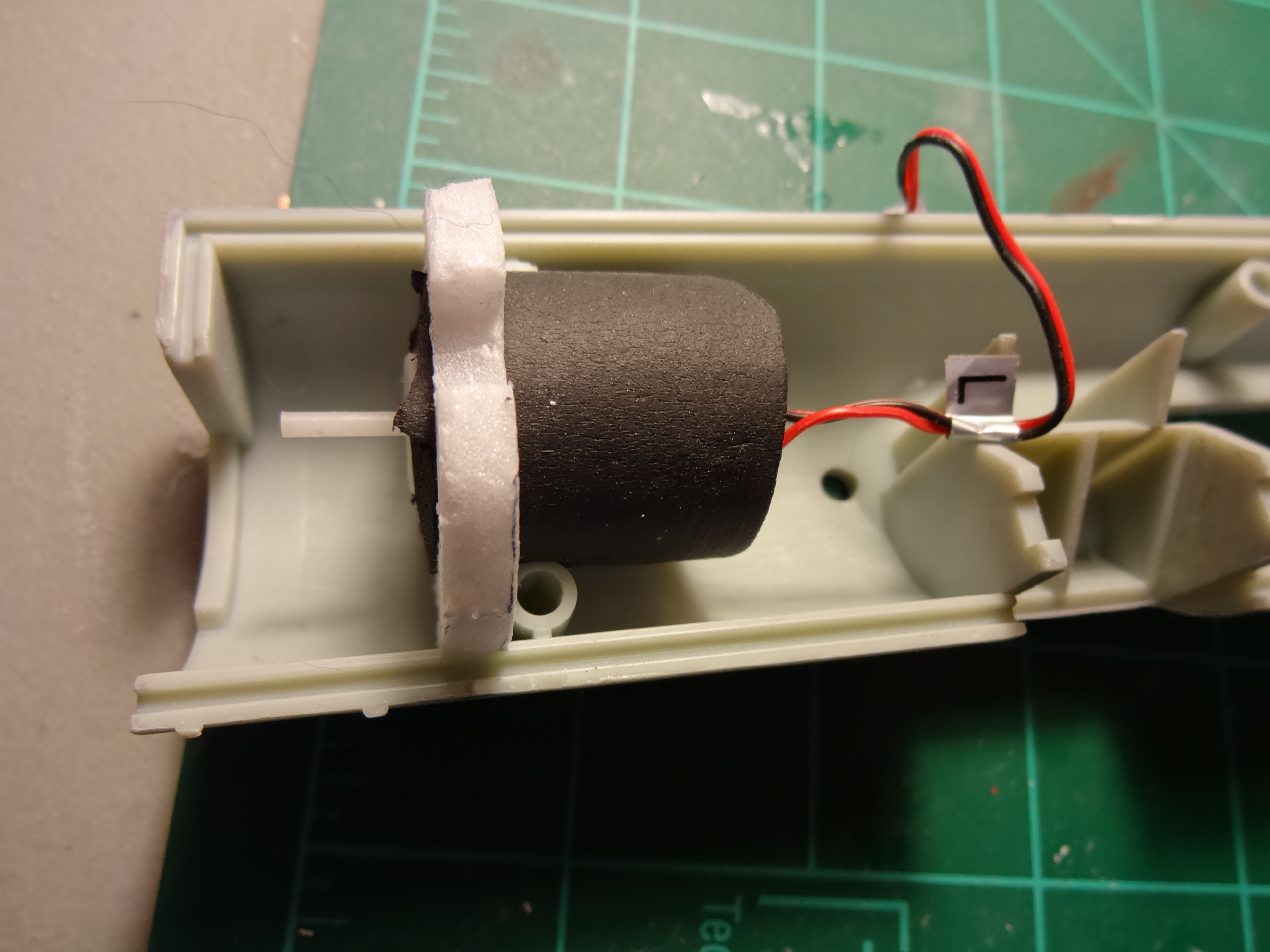

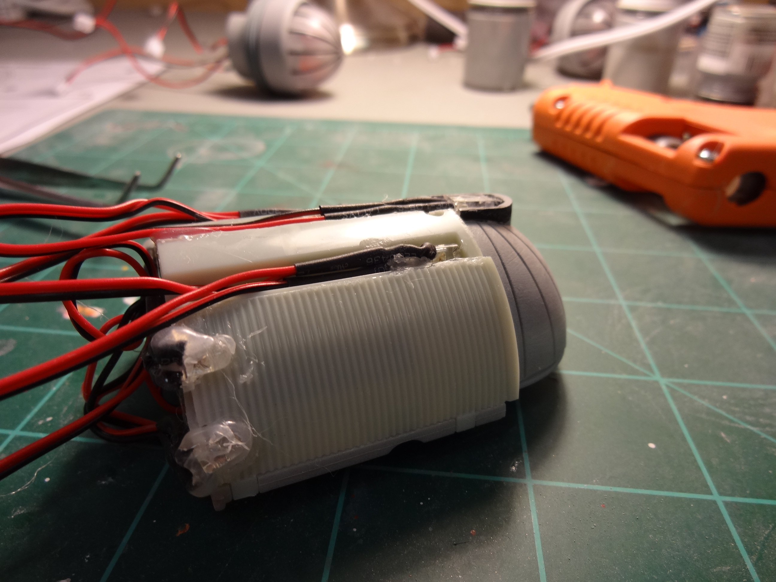

Slow work over the weekend....small details and some preening. I spent far too much time pursuing what ended up being not worth it...an attempt to quiet the Bussard motors a bit with some foam and rubber:
In the end, it wasn't quiet enough to warrant the effort. Add to that, my plan was to extend the motor shaft with some brass tubing. Not owning a vise grip, there was just no way for me to cut brass and keep it perfectly straight. So, lesson learned.

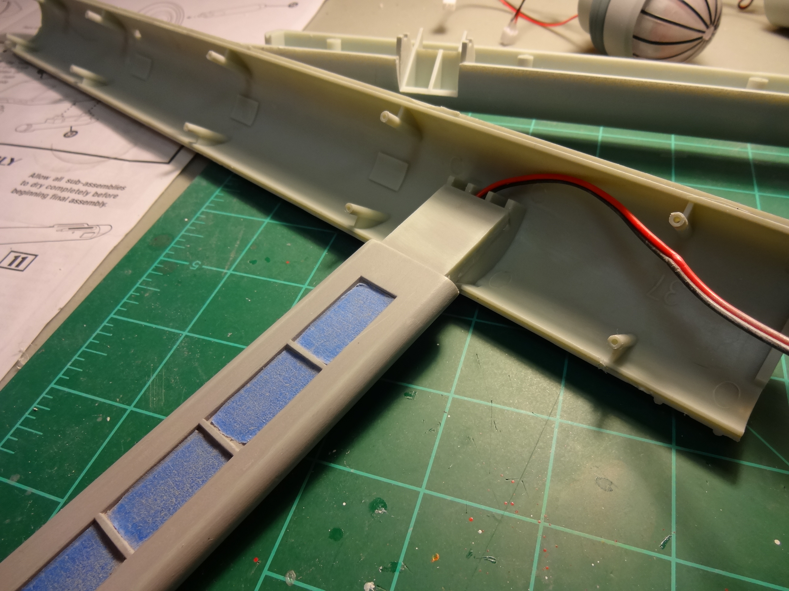

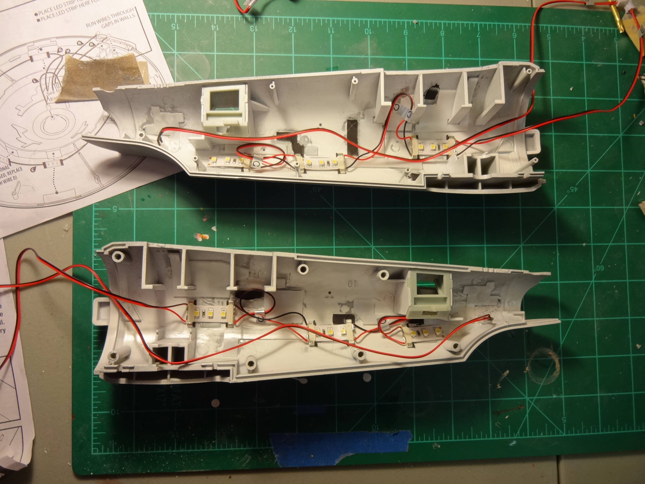

I moved on to finish the lighting in the secondary hull - I ended up having to hot glue the LED strips on since their own adhesive kept popping off:
I'm building it without the shuttle bay, as I'd rather have the bay doors closed, but then realized a lot of the lighting in the aft end relies on lights mounted on the shuttle bay structure. I suppose I could come up with another way to make it work, but it was just as easy to throw the shuttle bay together without worrying about painting it, and use it that way. That's next and then I think I'll be ready to close up the secondary hull. Every major sub assembly I glue together on this model seems to be a major emotional event. :eek

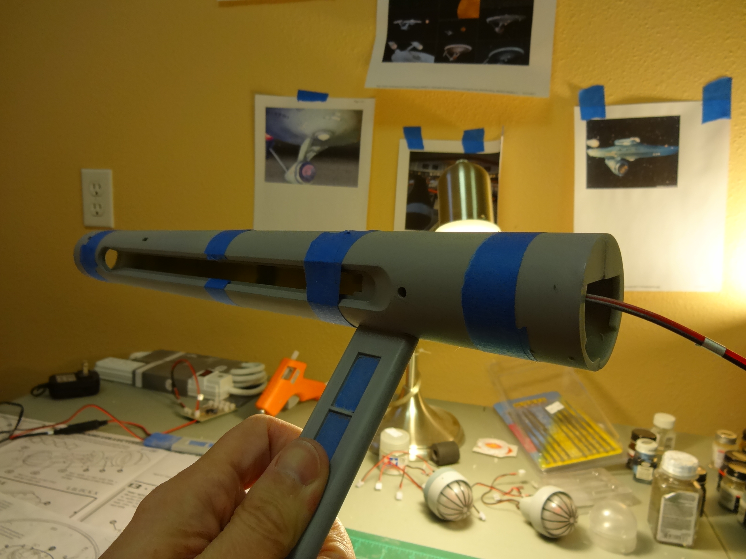

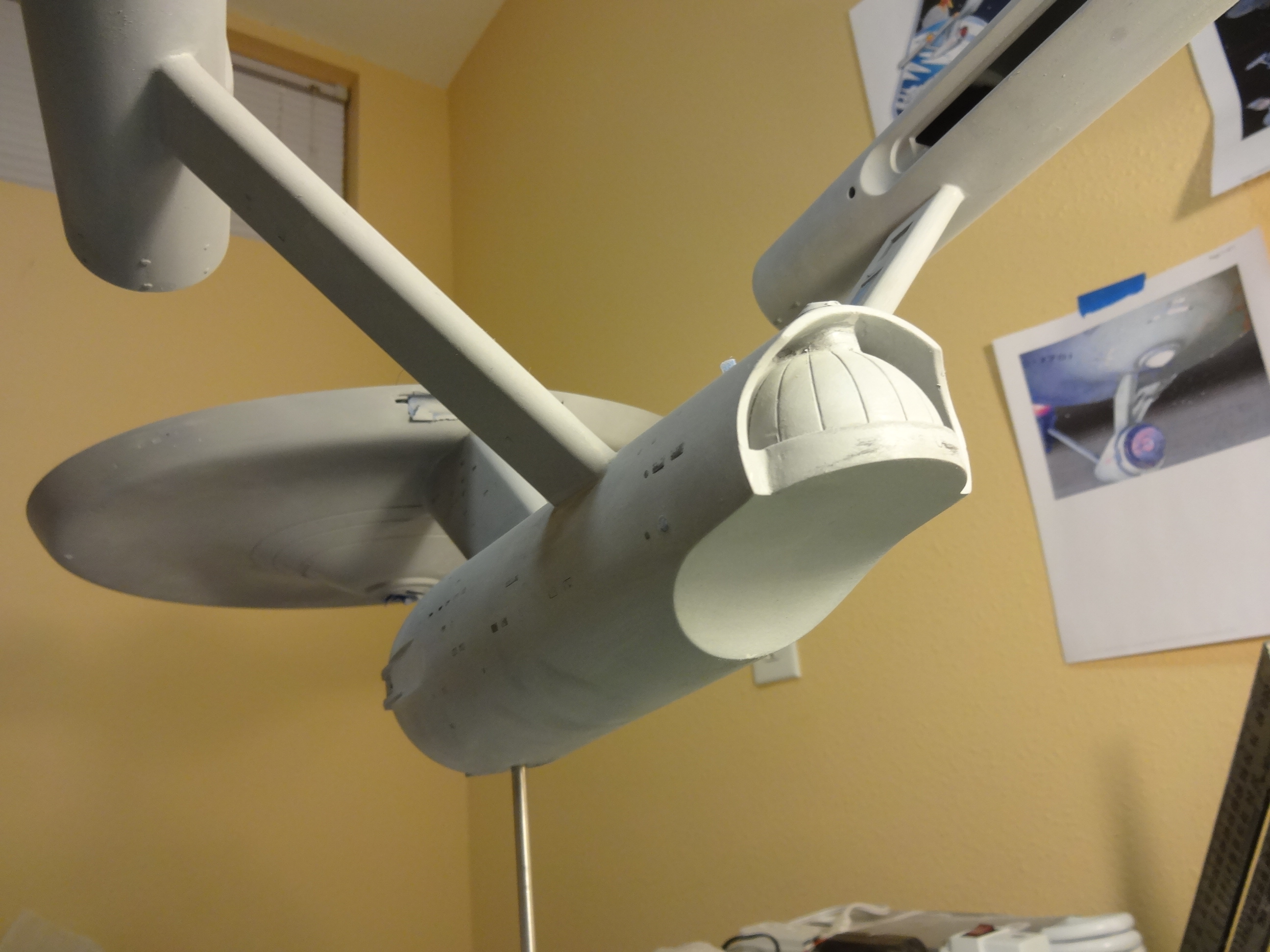

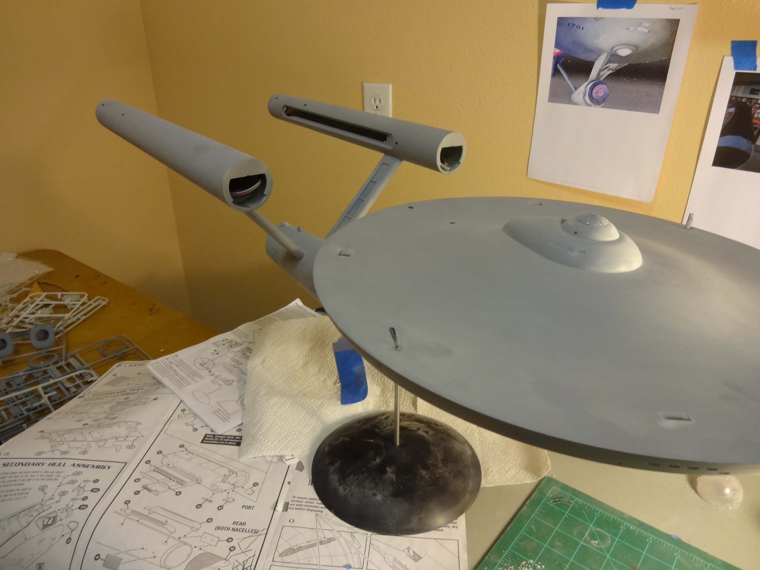

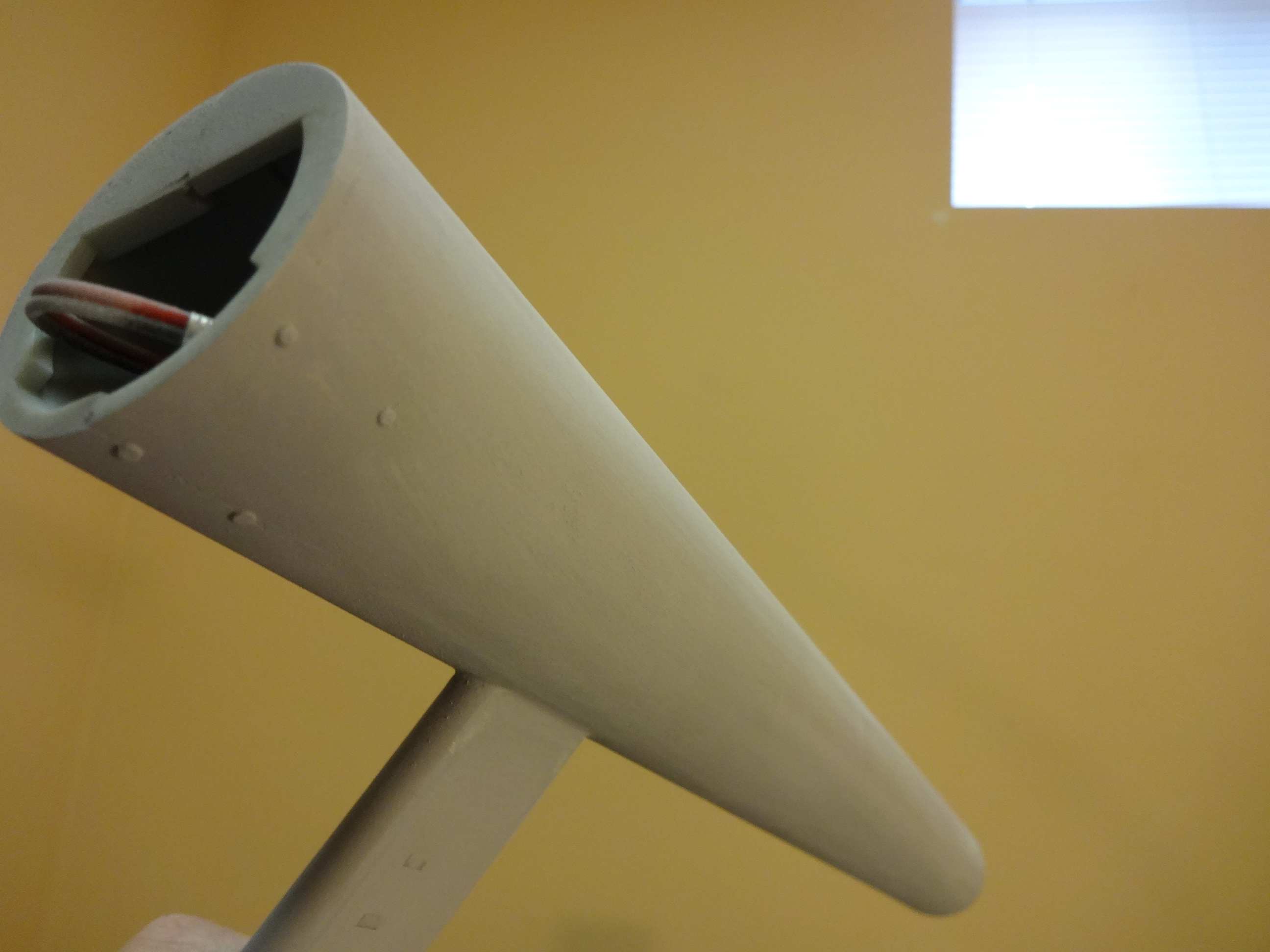

Today I worked on the nacelles. I figure I can glue the basic parts together and worry about tweaking the Bussards as the build goes on. I'm also waiting to install all the detail/darker gray accented parts until after the entire ship is together and painted its final color. I found it easier to glue the pylon into one side of the nacelle, so I could run the wire easier, and then glue the other nacelle half on:
I'm happy with how it worked out:
Probably won't get too much more done this week until the weekend. Next will be lighting around the shuttle bay, closing up the hull, and I've started experimenting with color mixes for the final color.

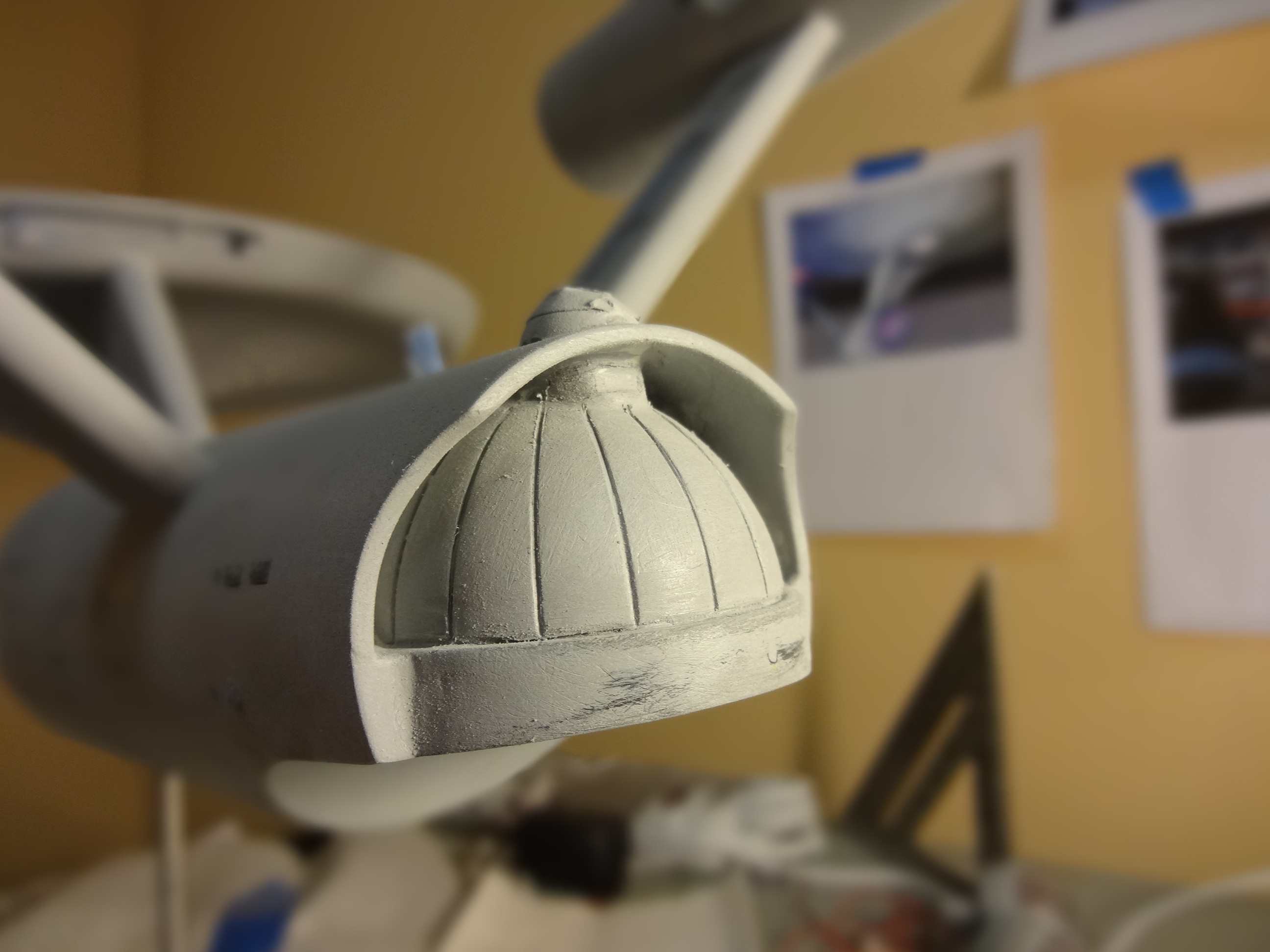

if the "sanded" bussard cap is the one where the black lines are less defined, I think that looks more
like the filming model.
Yes, the more faded one is the "sanded" bussard dome. I agree, it does look a bit more authentic, but in person the lights are fairly dim coming though it. If I had it to do over again, I might get a Tenacontrols PCB and forgo the spinning "blades". The plastic "bulbs in the R2 kit just don't transmit enough light from the LEDs for my taste.

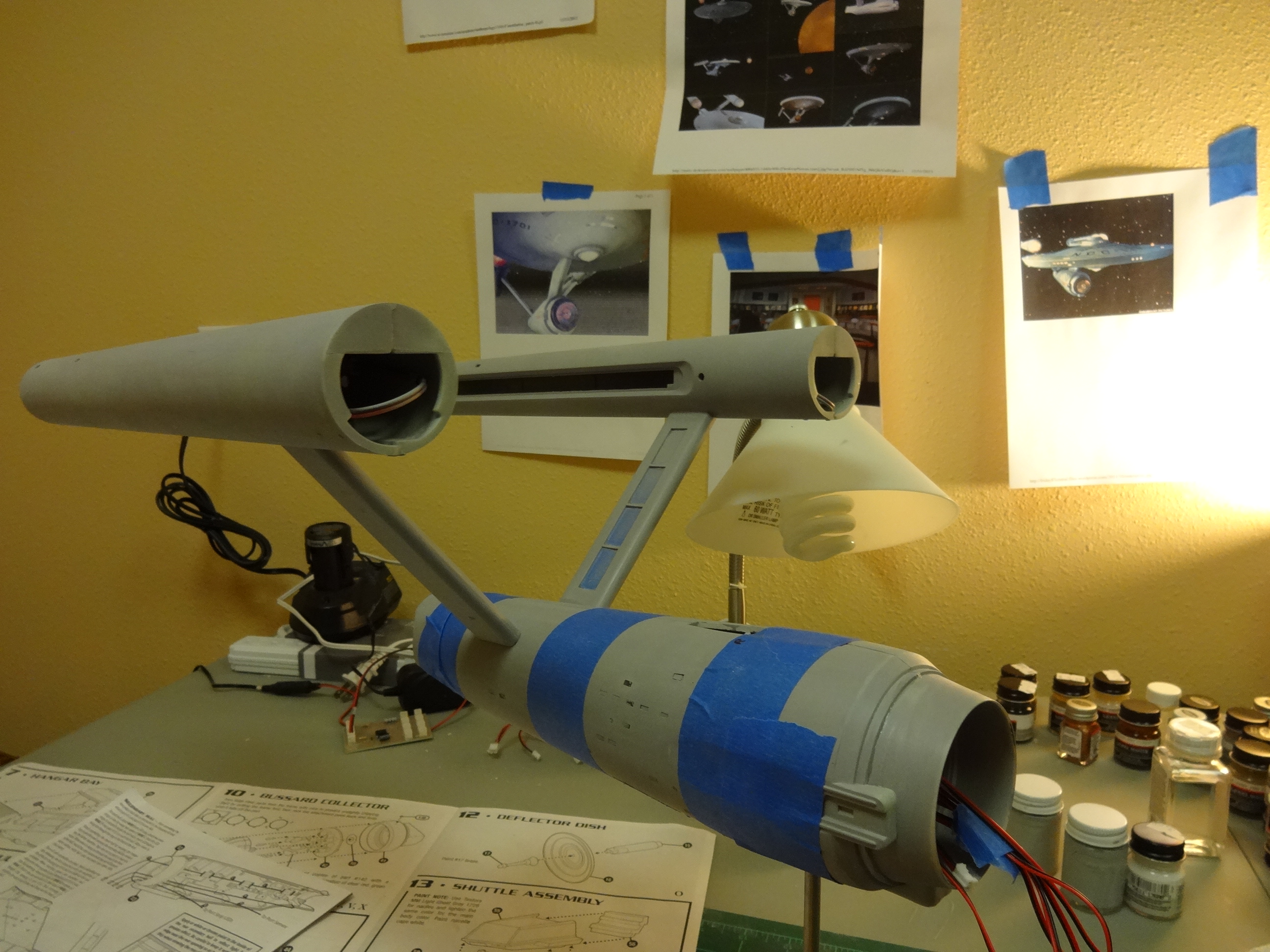

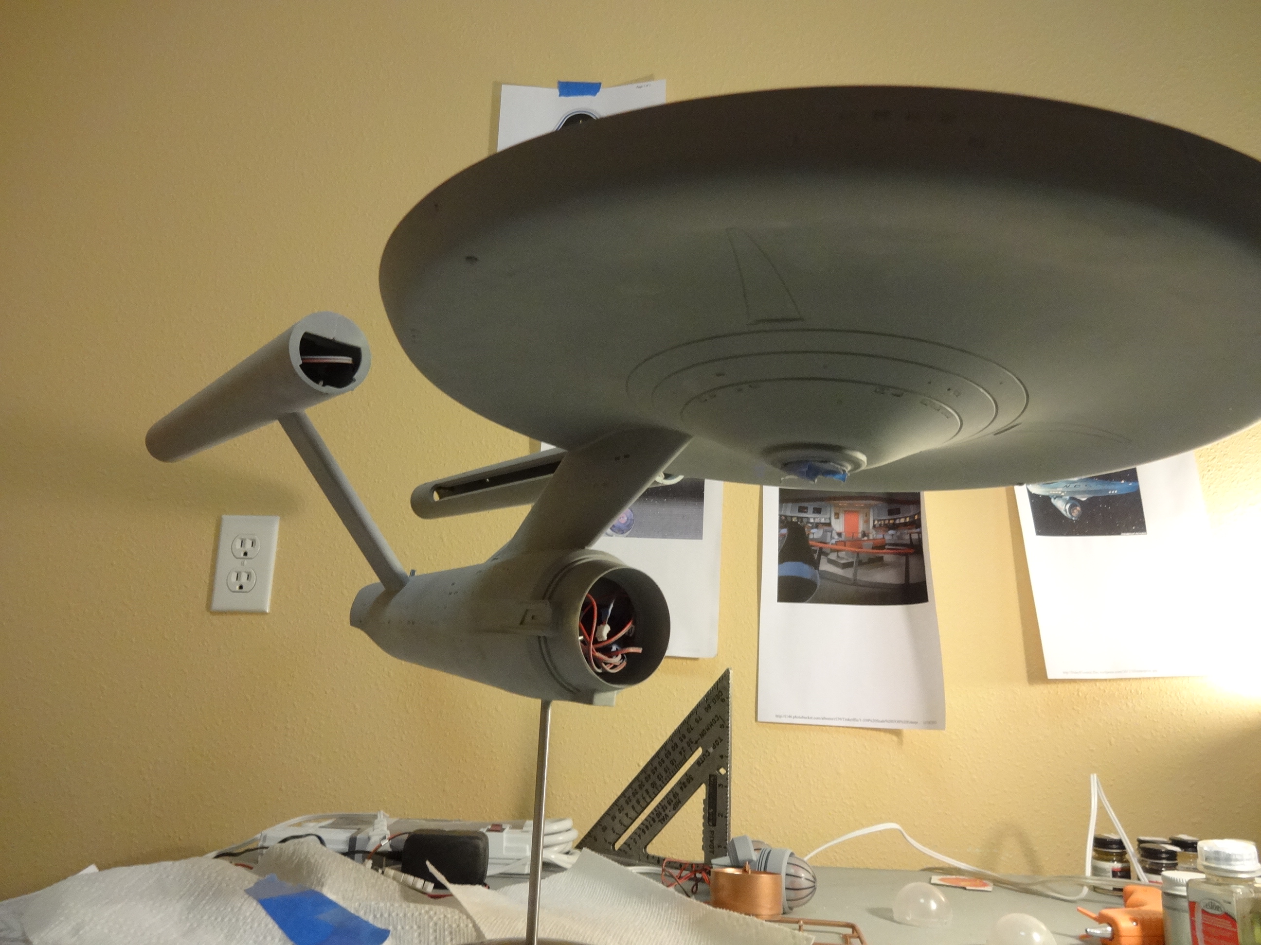

I was able to get some more preening done on the nacelles

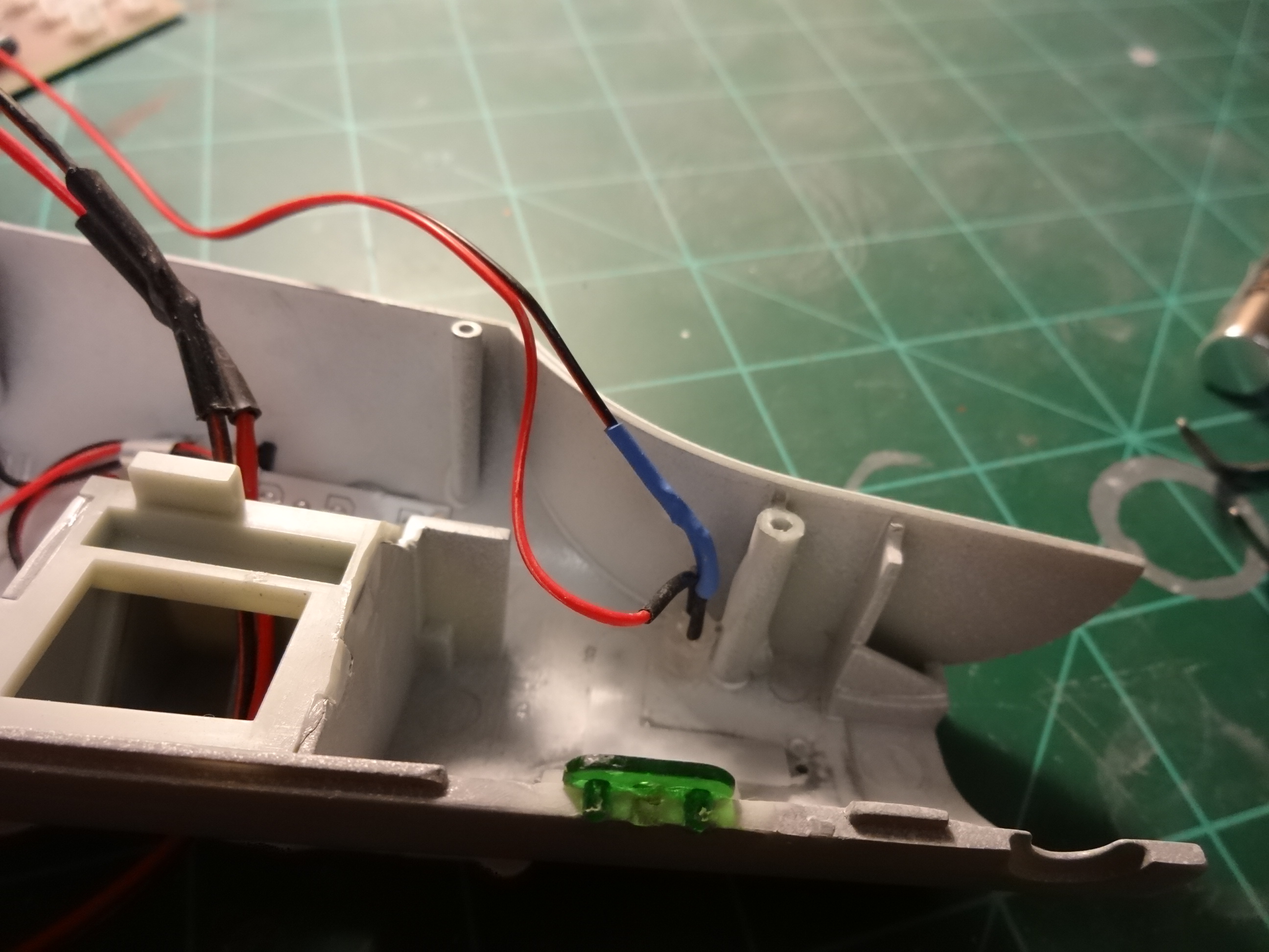

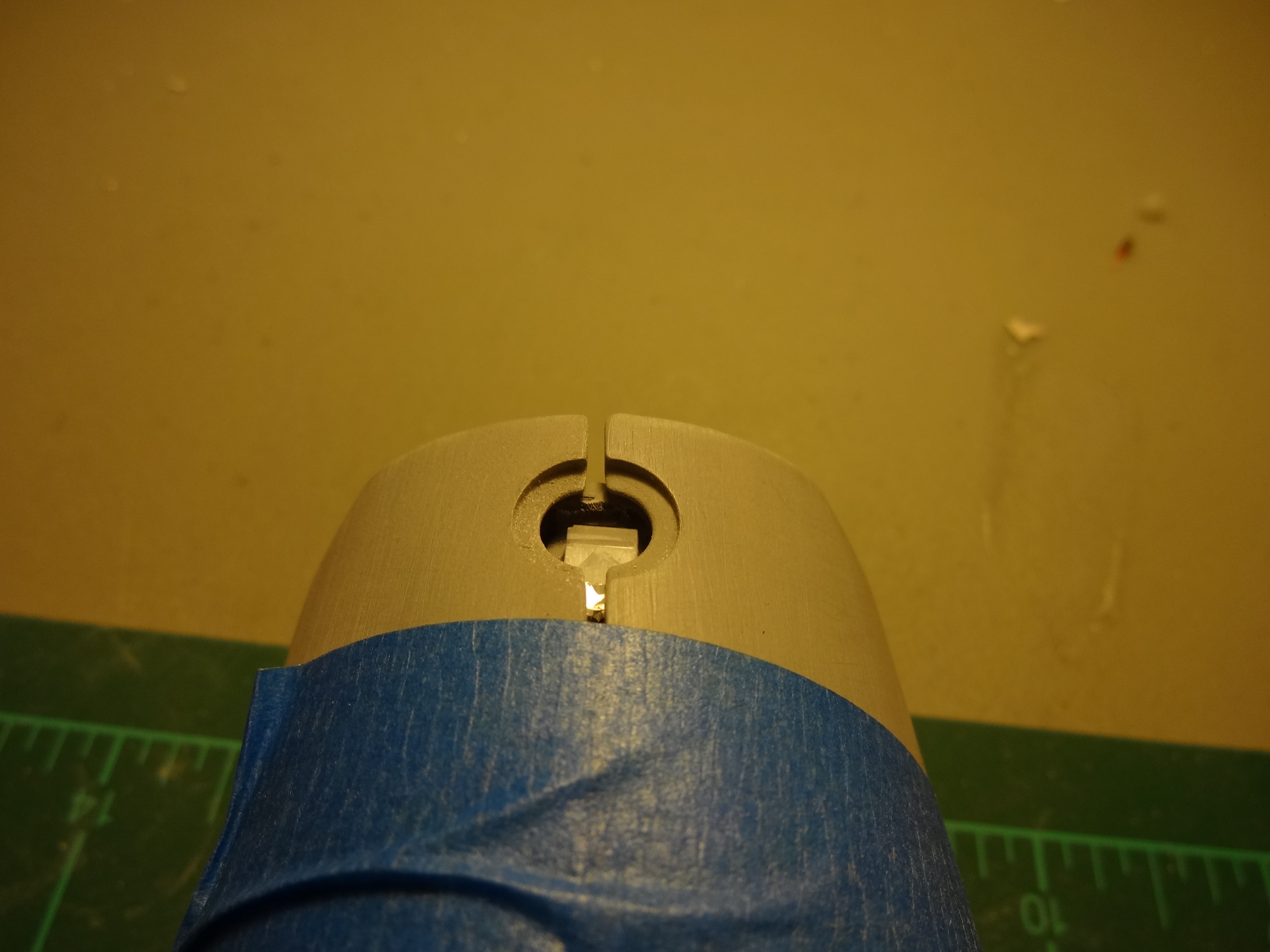

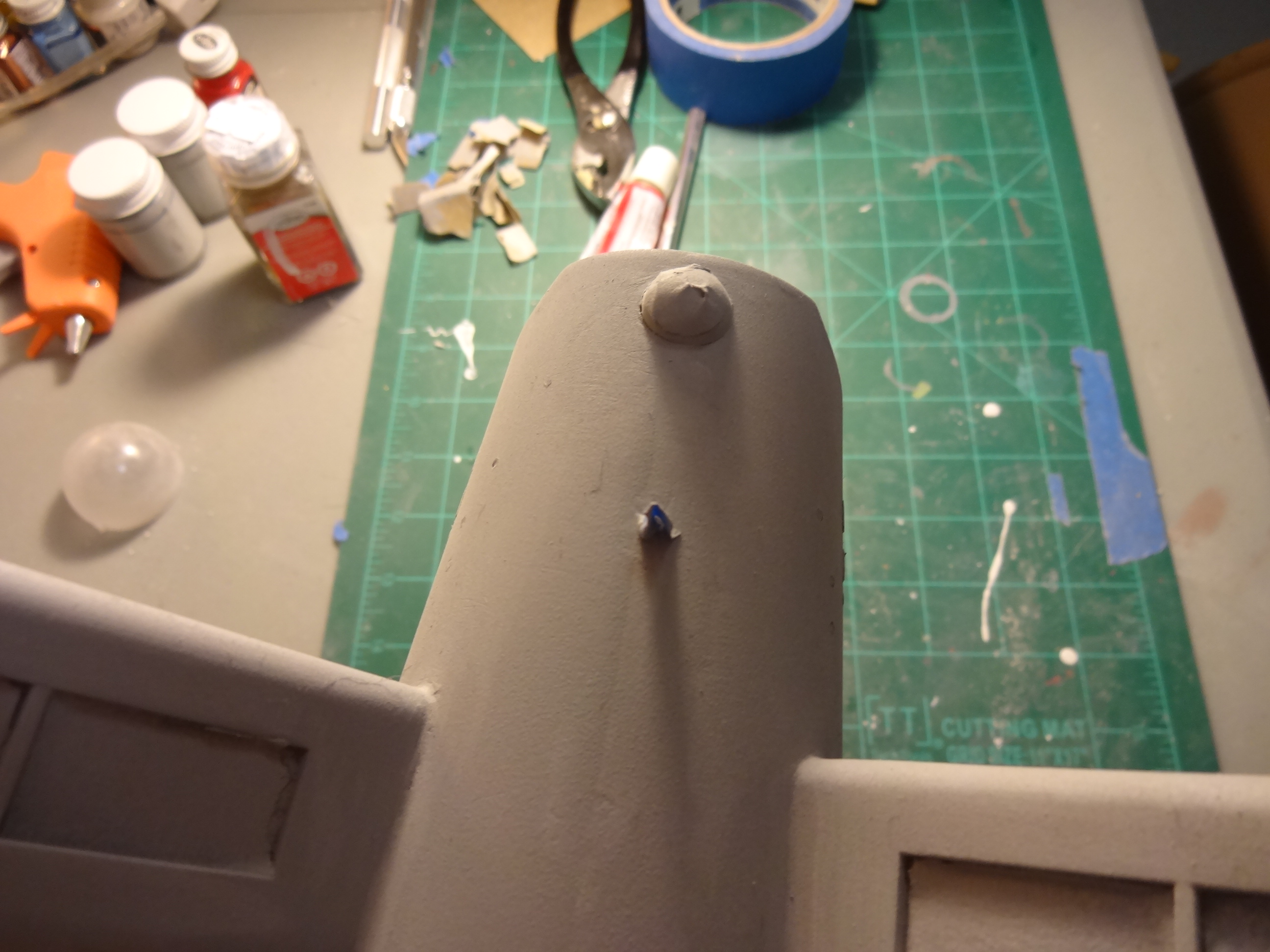

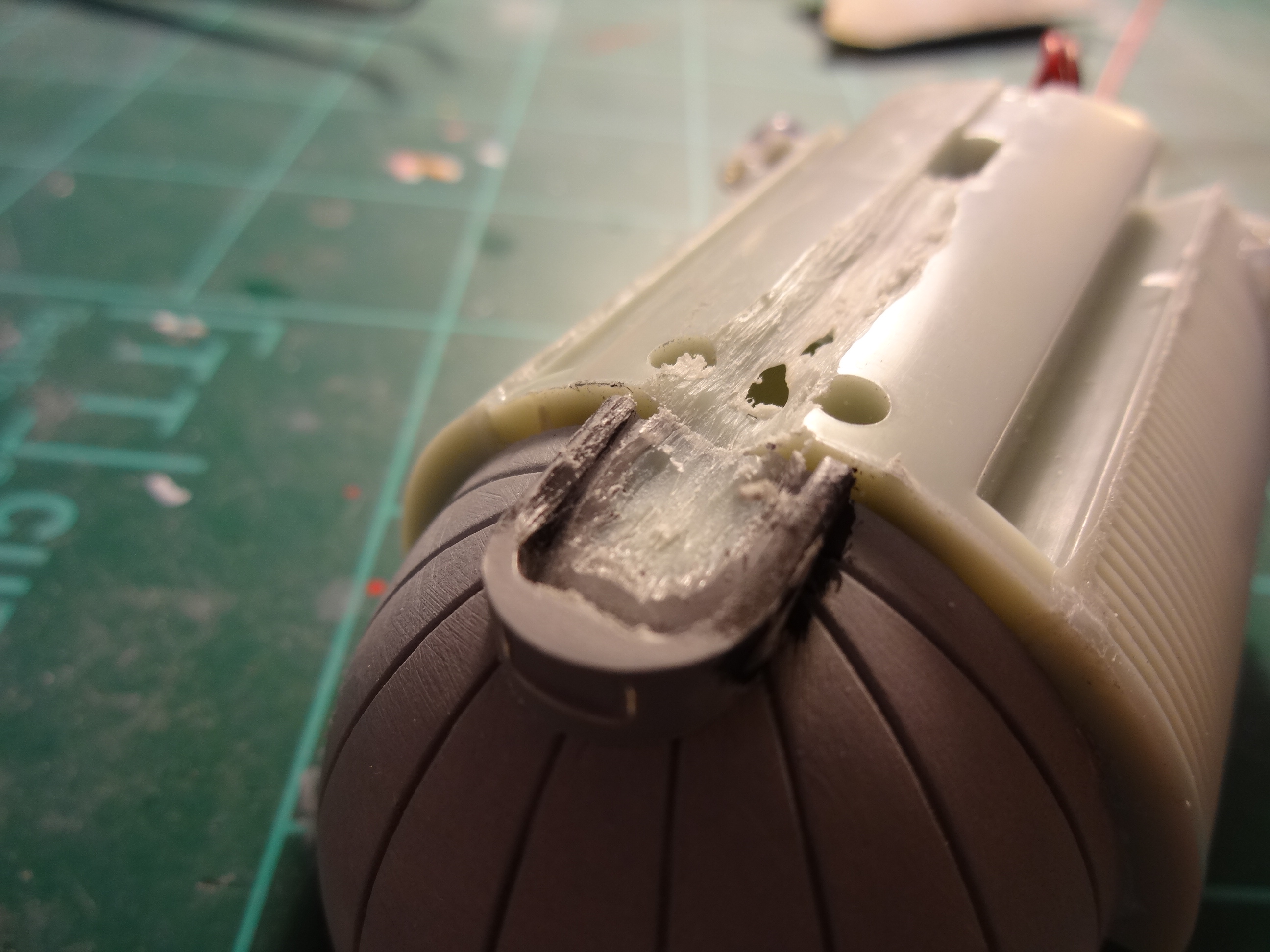

And then I continued on with the shuttlebay/light holder...I ended up trenching out a little more on the top, towards the rear and into the control room over the bay doors:
Looks pretty bad, but no one will ever see it. There was just no way that flat LED and wire were going to make it through the tiny space. Now everything fits rather snug, but a test fit of the shuttle bay and engineering hull revealed everything goes together fairly nicely. There's going to be about 1/32" gap towards the rear of the ship, but from what I've seen on the forums, that seems to be about par for the course. Not like it doesn't already have a couple of pounds of putty on it....
The test fit revealed that I needed to slice away just a bit of this part:
Not quite sure what you call that, but it seems like they intended to have a connection there, until the lighting kit came along. That's right where the LED for the fantail rests under the shuttlebay, and some of the initial trouble I had closing up the hull was because that was pressing against the LED.
So, that's all I got done. I found myself sitting there tonight thinking I'm probably ready to seal up the engineering hull, so I thought it best to walk away for the night, get some rest and let the cold medicine work. There's still plenty left to do, but I find I don't want to finish, I'm enjoying myself so much!

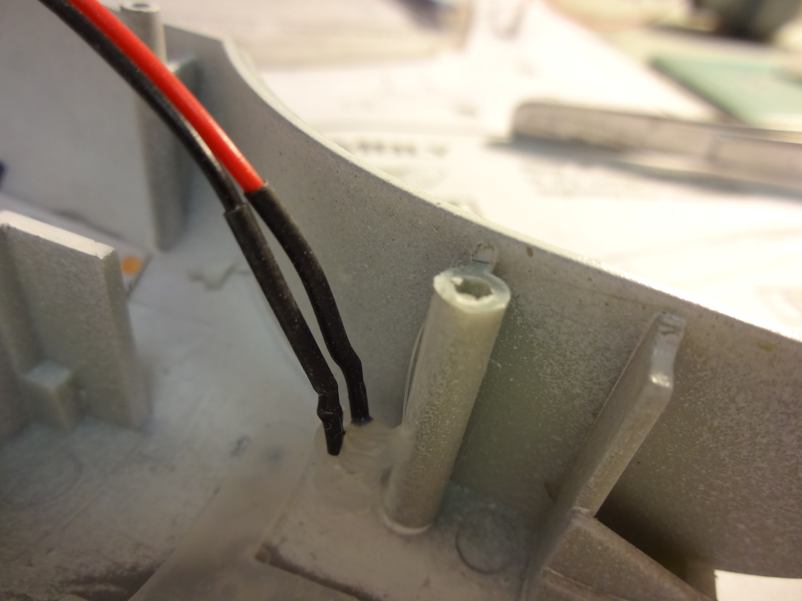

Well, I'm at a standstill until this weekend anyway - while test fitting the shuttlebay, engineering hull and nacelle pylons last night, somehow I managed to break one of the wires leading to the port ion pod. Not a big deal, but I need to get to a real hobby shop to get some more shrink tubing - Hobby Lobby won't have that. It's about a 40 minute drive for me to south St. Louis to get a decent hobby shop. I've been meaning to do that anyway as the tubing that came with the lighting kit is too big and doesn't shrink tight against the small wires.
Once I get that done I should be ready to close up the engineering hull and attach the nacelles and saucer.

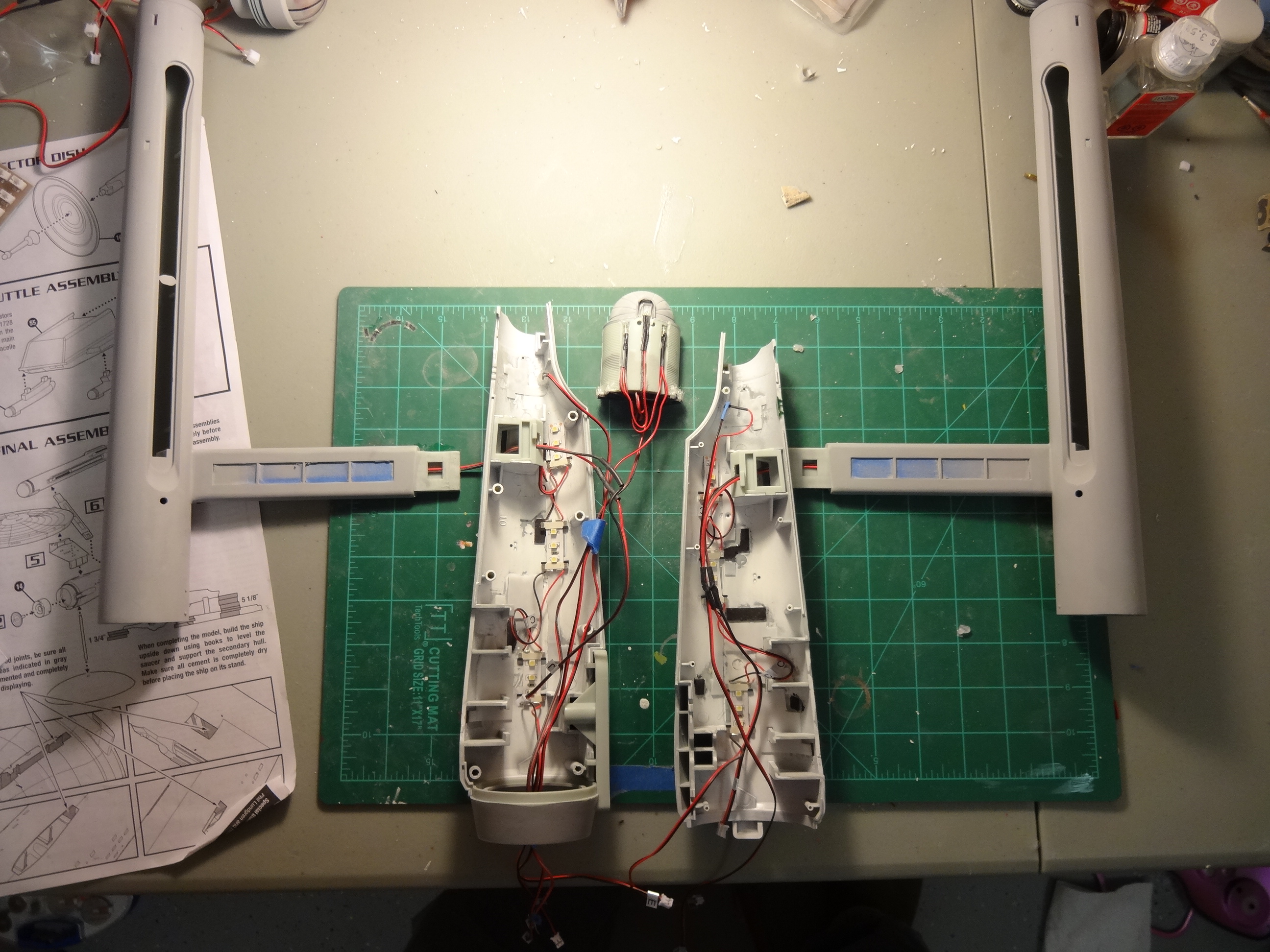

Well, I was able to make some decent progress in just a few hours this afternoon...

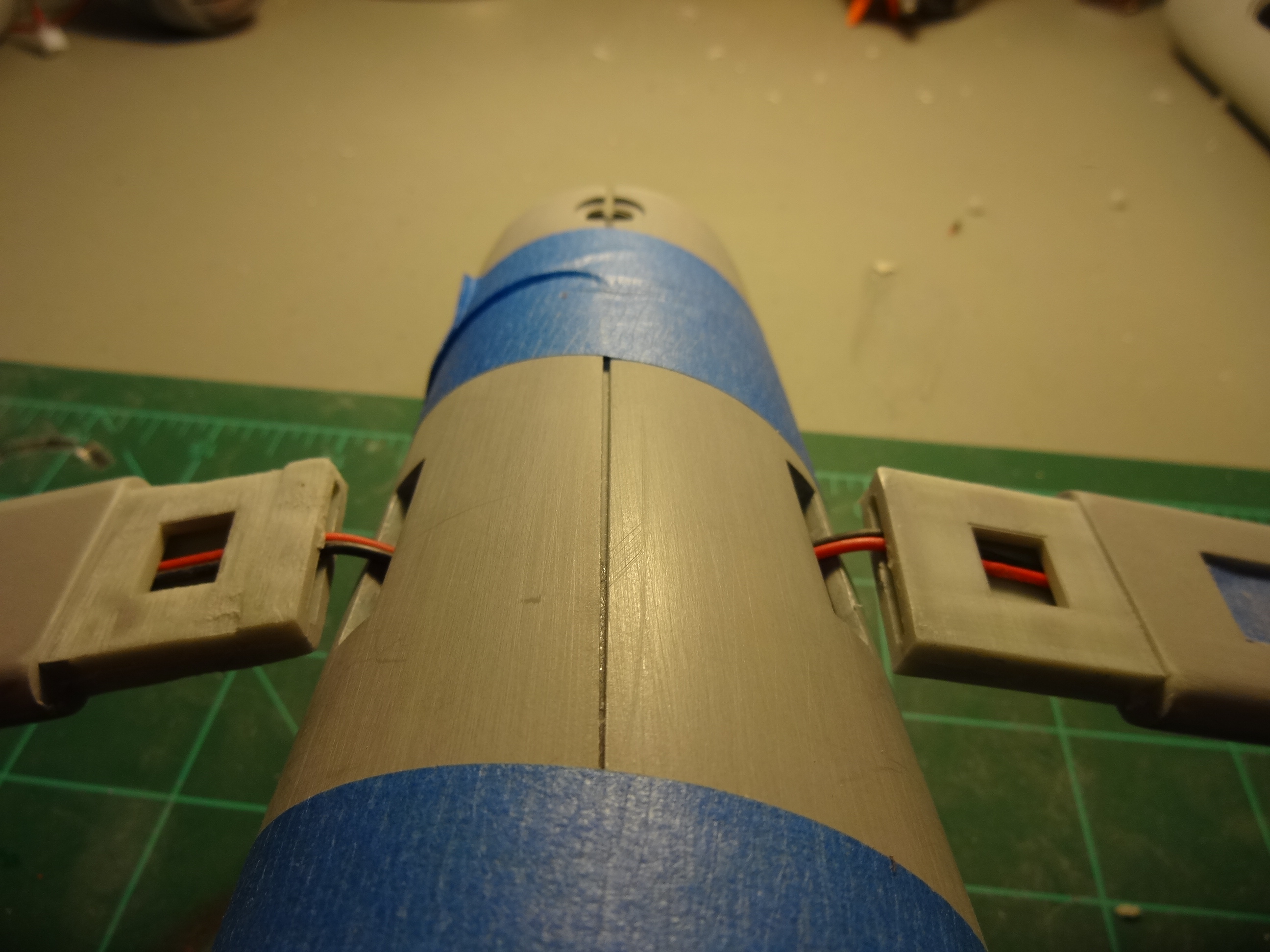

I got out to the LHS and got some decent shrink tubing and was able to fix my inadvertent break:

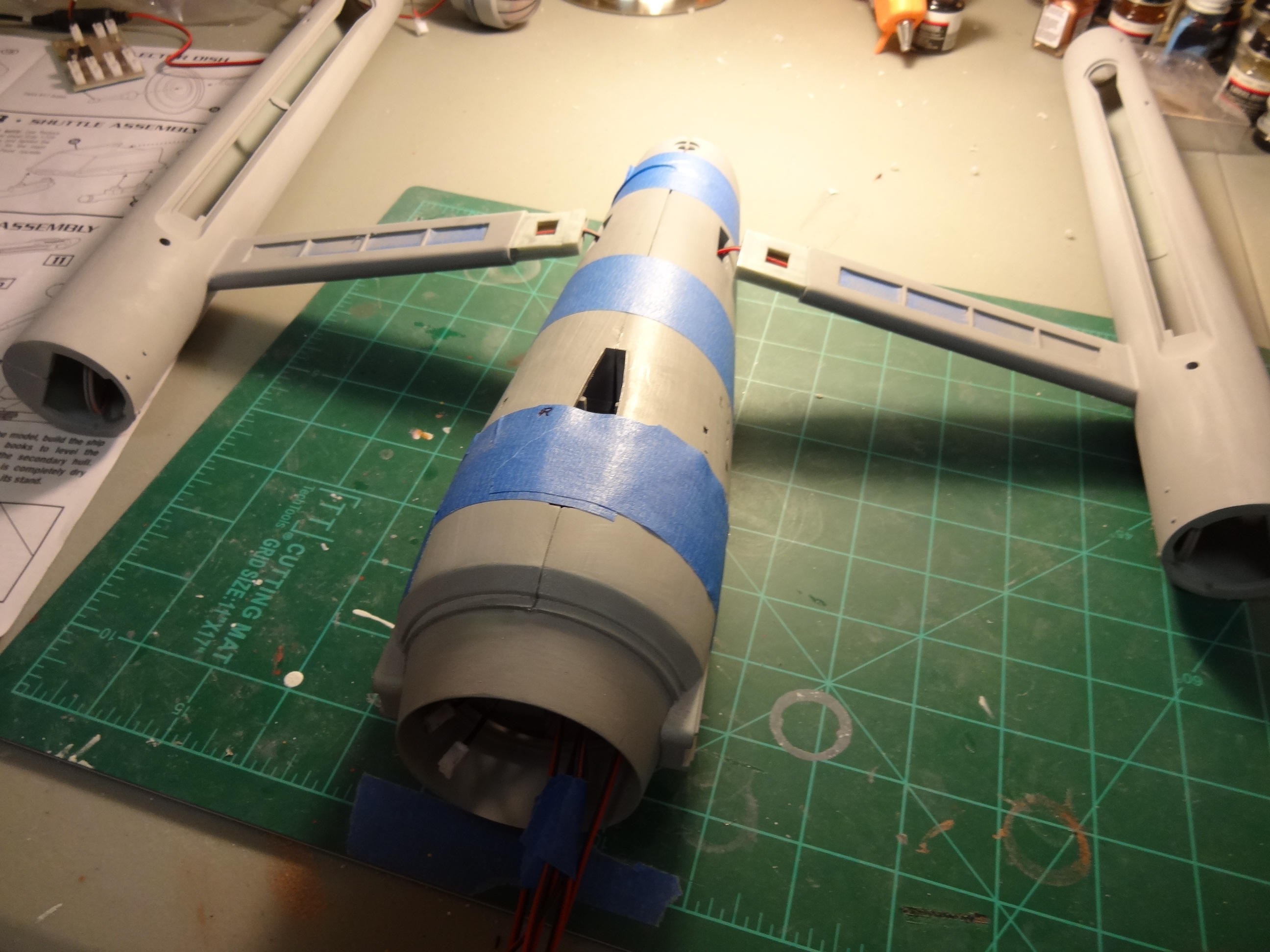

Engineering hull and warp pylons/nacelles ready for assembly:
And I took a deep breath and dove in:
There's a small gap at the rear, as expected...
Nothing some putty won't take care of! While that sat for a couple hours, I preened the saucer a bit more, and mixed up a color I'm pretty happy with...looking forward to seeing how it goes on though. Before coming back out of my cave, I couldn't resist attaching the nacelles too:
I'll let that simmer for about 6 hours or so, but before I go to bed I'm sure I won't be able to resist attaching the saucer/neck assembly. That's it for now! Hope these picture post....

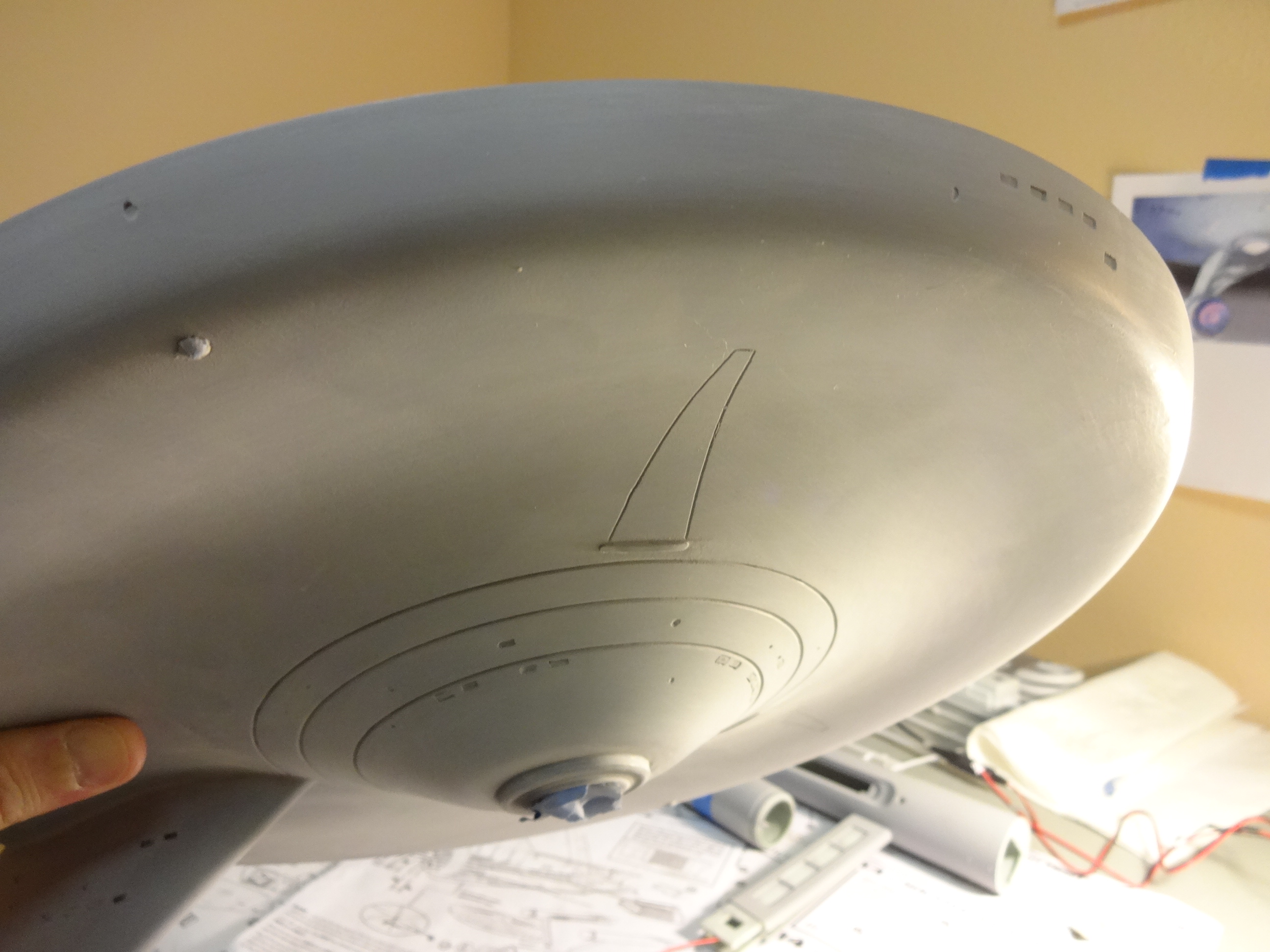

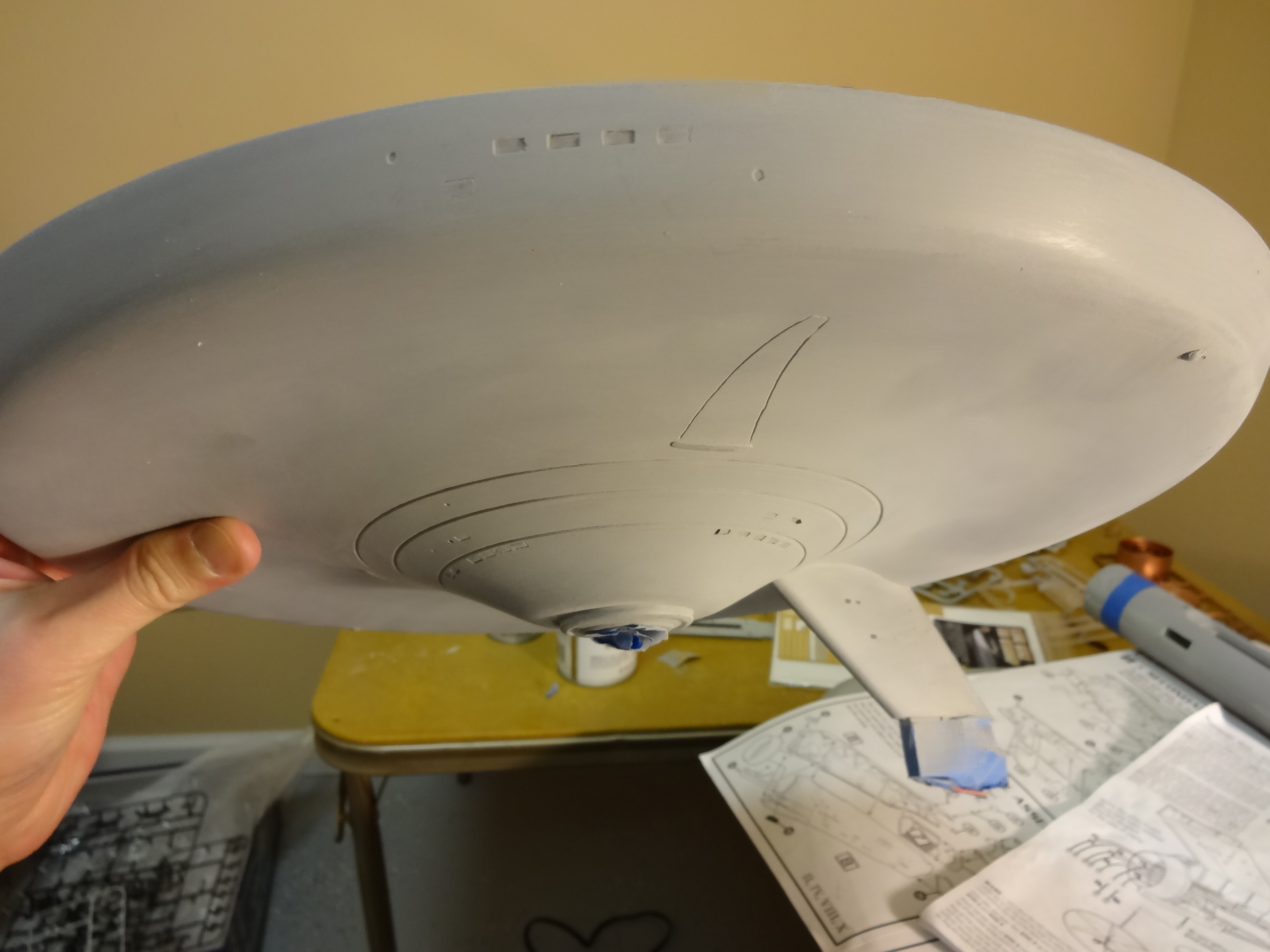

Hello all... been a slow week of preening. Putty...sand...prime...repeat.... But I'm quite happy with how things are turning out:
I feel pretty successful at filling the gap at the rear of the engineering hull:
This is about 90% there...I haven't done the final sanding after the last primer coat but I think it should come out pretty well.
I'm particularly proud of the underside, of all things:
That's mostly putty there under the shuttlebay. There was just a little lip from the way the fantail fit that needed to be blended in with the underside, and I have to say, it came out rather well.
One thing I wish I knew more about beforehand was the preening required around the shuttlebay itself. I haven't seen much discussion on it, so maybe its just me, but I had a dickens of a time getting in there to putty after it was installed. And then sanding was just a whole new level of pain, but after about 3 days just spent on that......well...its almost there:
All in all I'm quite happy with how its going. I'm going to be getting to a standstill though.....once all the puttying and sanding is done, I'll be ready to apply the final color to her. But I don't particularly want to asphyxiate myself in our little craft room, so I'll need to be up in the garage. However we're not expecting temps much above freezing here in the St. Louis area for the forseeable future.
