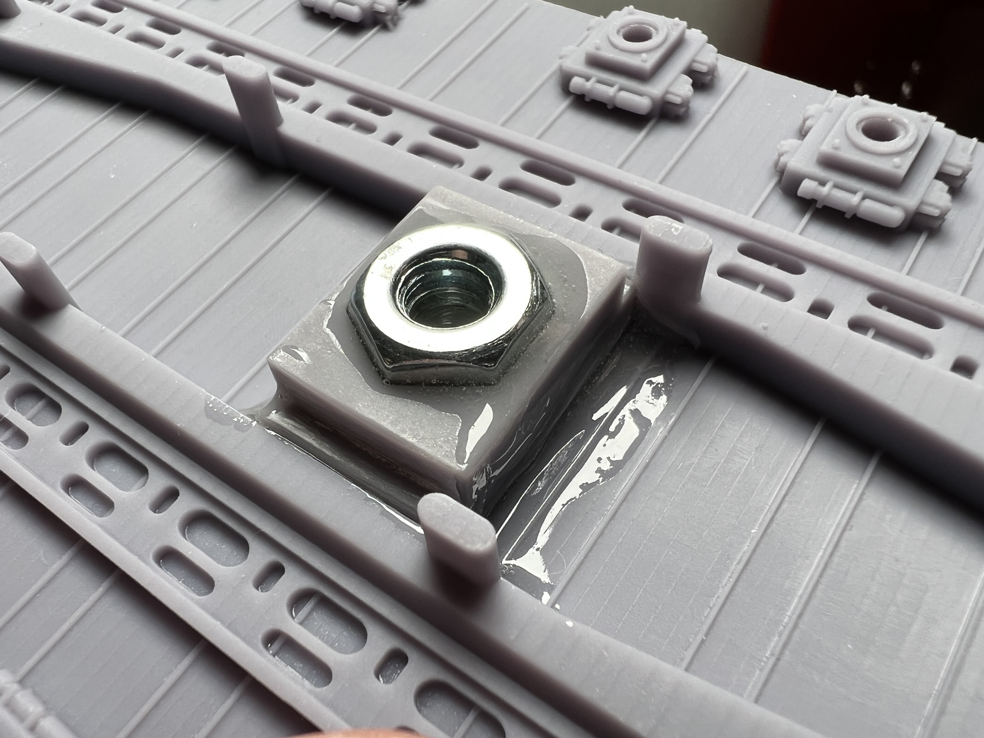

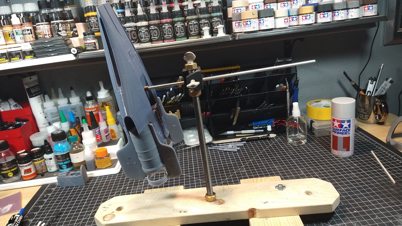

This is my 'contraption' I threw together a while back for working on these larger models, especially ones like this that have delicate parts. Makes it easier to paint and manipulate. All ready for primer.
I’m a big fan of contraptions. Tell me a little more about it. Is that 1/4-20 rod? What is the nut in the model? How is it secured? What is the clamp holding the rods?

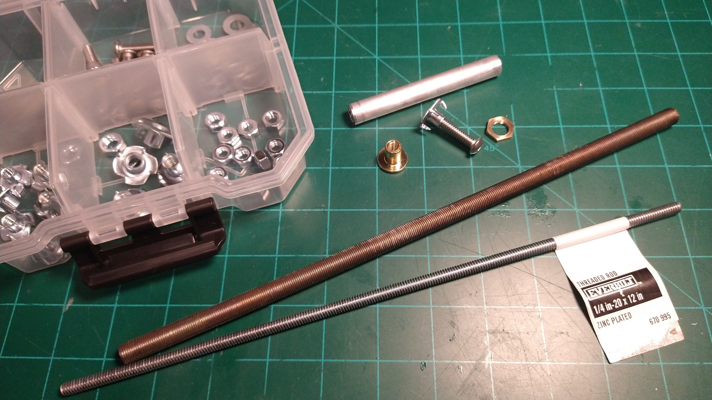

Yes, 1/4-20 is my standard when it comes to putting in a threaded insert. Sometimes I use it as the main support rod, other times I only have it stick out of the model about 6" and then insert that into a solid aluminum tube.
This is pretty much my standard spread of inserts, nuts, and bolts that I use:
The gold-colored threaded insert is what I embed into the model. Normally I just epoxy it in, though if the model is larger I will put a thin strip of aluminum over the top and then epoxy it all in.
That larger threaded rod is for lamps and is super easy to work with as it's hollow, that's my go-to if I intend to light something.
The larger rod I used in my rig to hold models while I paint is 1/2" and this is what I use to clamp it:
Here are a few other random parts I used both for this base and others:

Thanks for the info and the links. I use 1/4-20 for my builds as well. I'm always open to new ways of doing things.
