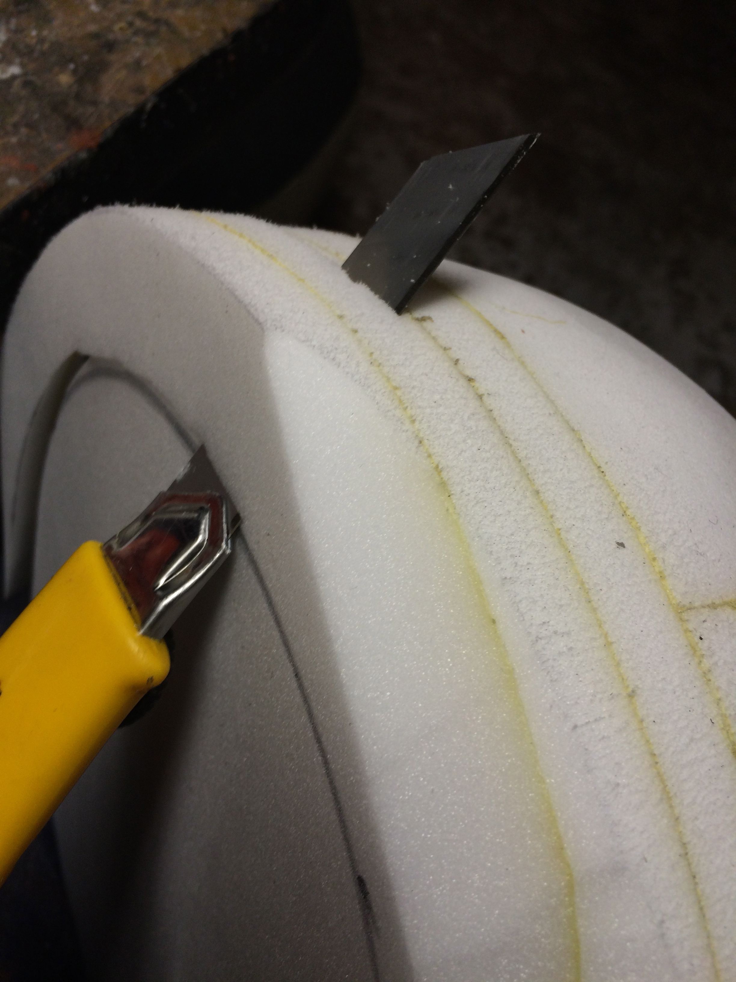

I then cut into the EVA foam, tracing all of the line work and then applying some heat to the foam. Doing so expands the foam and creates the illusion that each panel is it's own removable piece and added a little depth. This process also made masking the droid for paint a little easier.

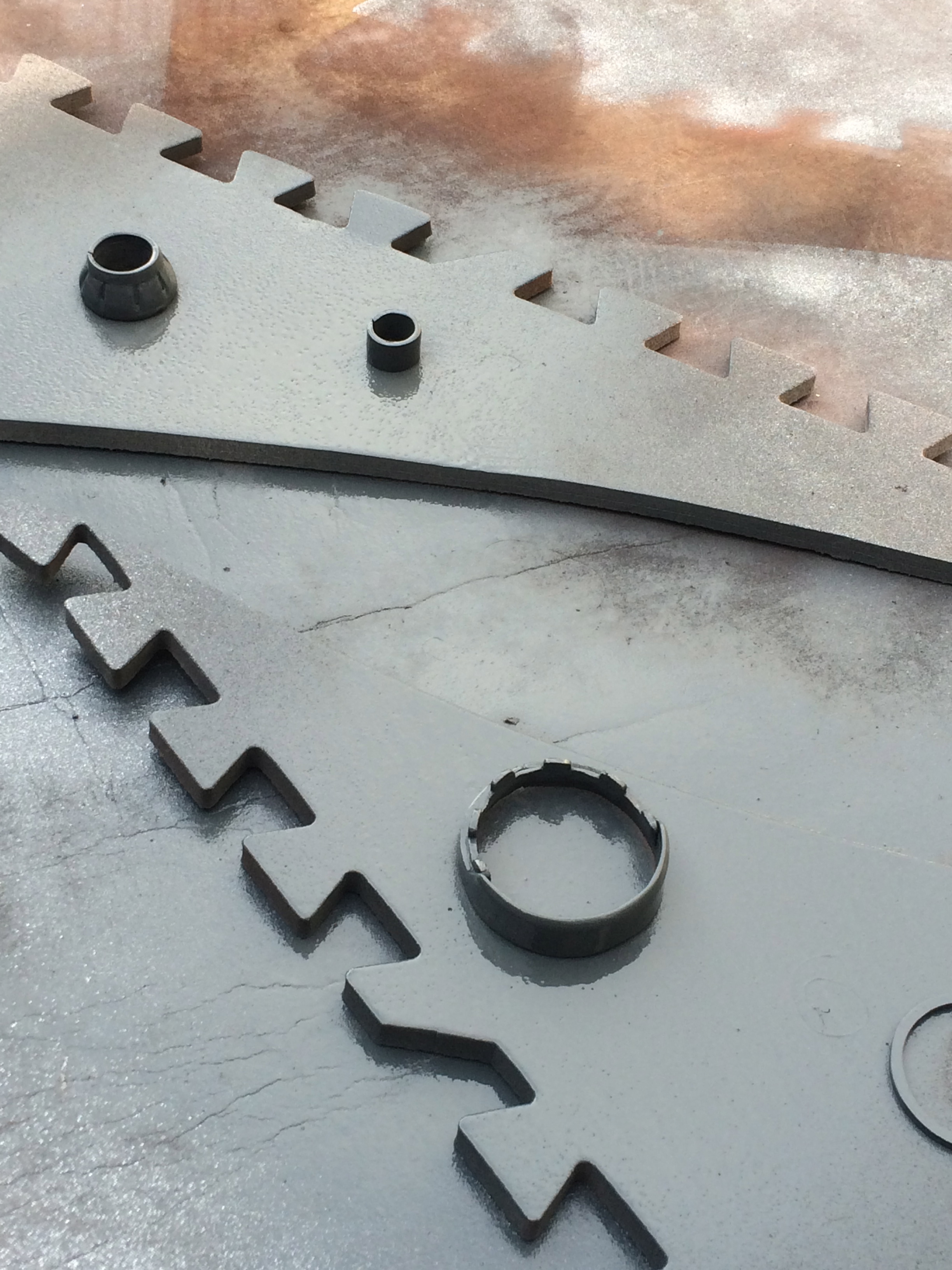

Painting BB-8 was a long and tedious process. After spraying the initial flat white base, I masked off each orange disc using automotive masking tape. The rest of the droid was covered to protect the base white. The metal parts were masked and a combination of chrome and grey spray paint was used to create the dulled metallic surface.
