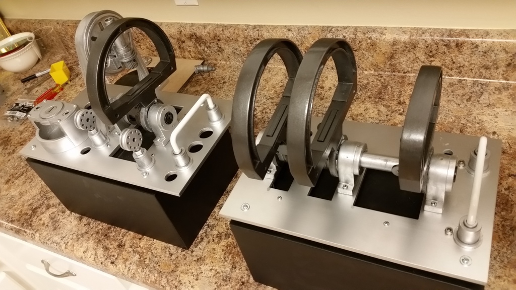

We've been calling those the "Canopy Boxes". They have several levers and greeblies attached. They are VERY prominent in that shot, but we think the boxes we're removed and just the greeblies that were attached remained and adhered to the canopy itself. I love the look of the boxes and I already have them built. Just waiting for when the canopy is ready to accept them! :)

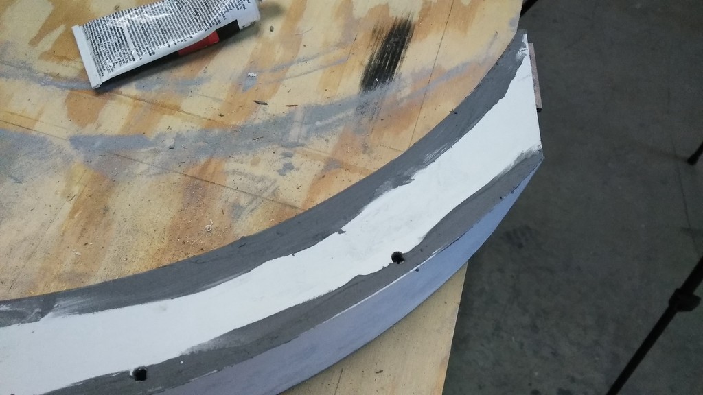

I continued work on the corridor ring
I added more styrene
Super glue is good stuff... until it doesn't work and you need tape to help as it cures
Lots of tape
I then added filler
What a mess!
HA... more tape
Seriously... the Super Glue just didn't want to adhere. I have to pick up some of that "Super Glue Actuator" spray. I hear its good stuff!

PART II: Corridor Ring (Cont'd)
Filler
Filler and tape
It's funny... a majority of this ring wont even be seen because of the ring pads and or its facing away from view ;)
First coat of primer after all the sanding
YUCK! Still lots to do
Not to worry... I'll make it smooth :)

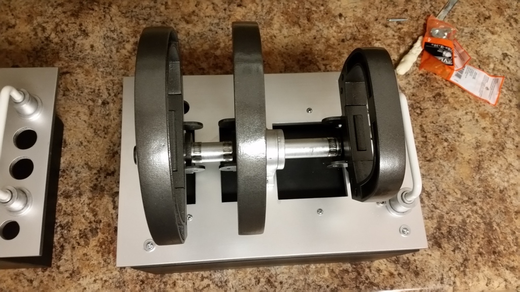

Oh not to worry! The guys in TX are working the canopy now. Once its ready, I'm going to step in and begin adding all the greeblies and details to include the canopy boxes. Here are a few photos of the finished boxes...
Can't wait to see these turned over and permanently mounted in place!

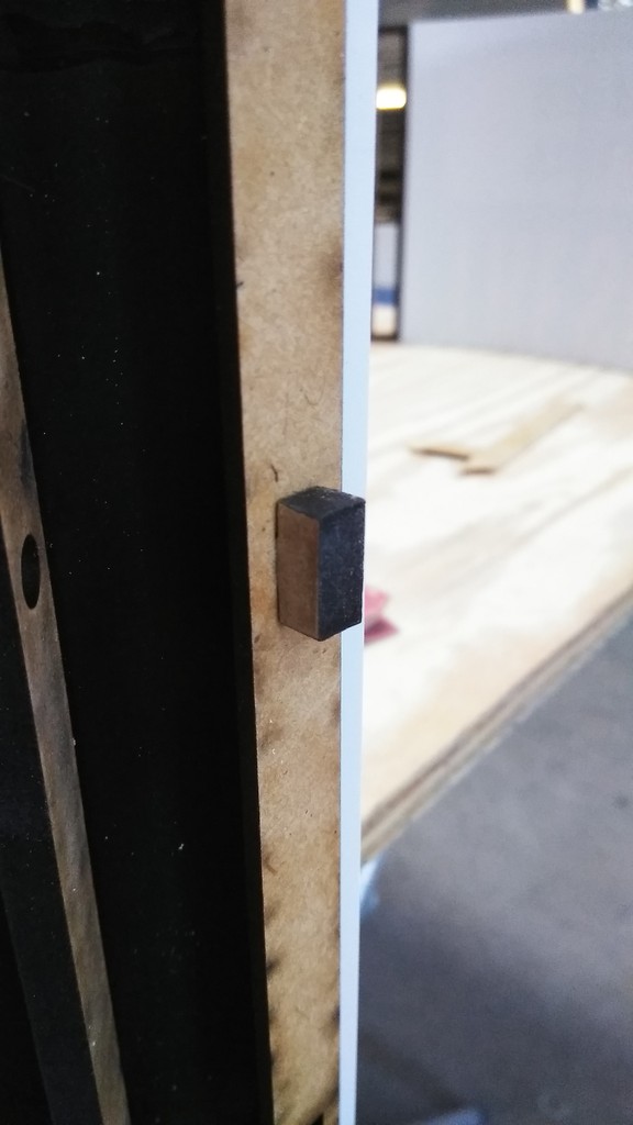

Its difficult to see but they are guides points on the bottoms of the frame to help with mounting into the floor - there are 6 points in all (3 ea side)
There's the famous blue tape!
The edges of the maint console fit perfectly!
