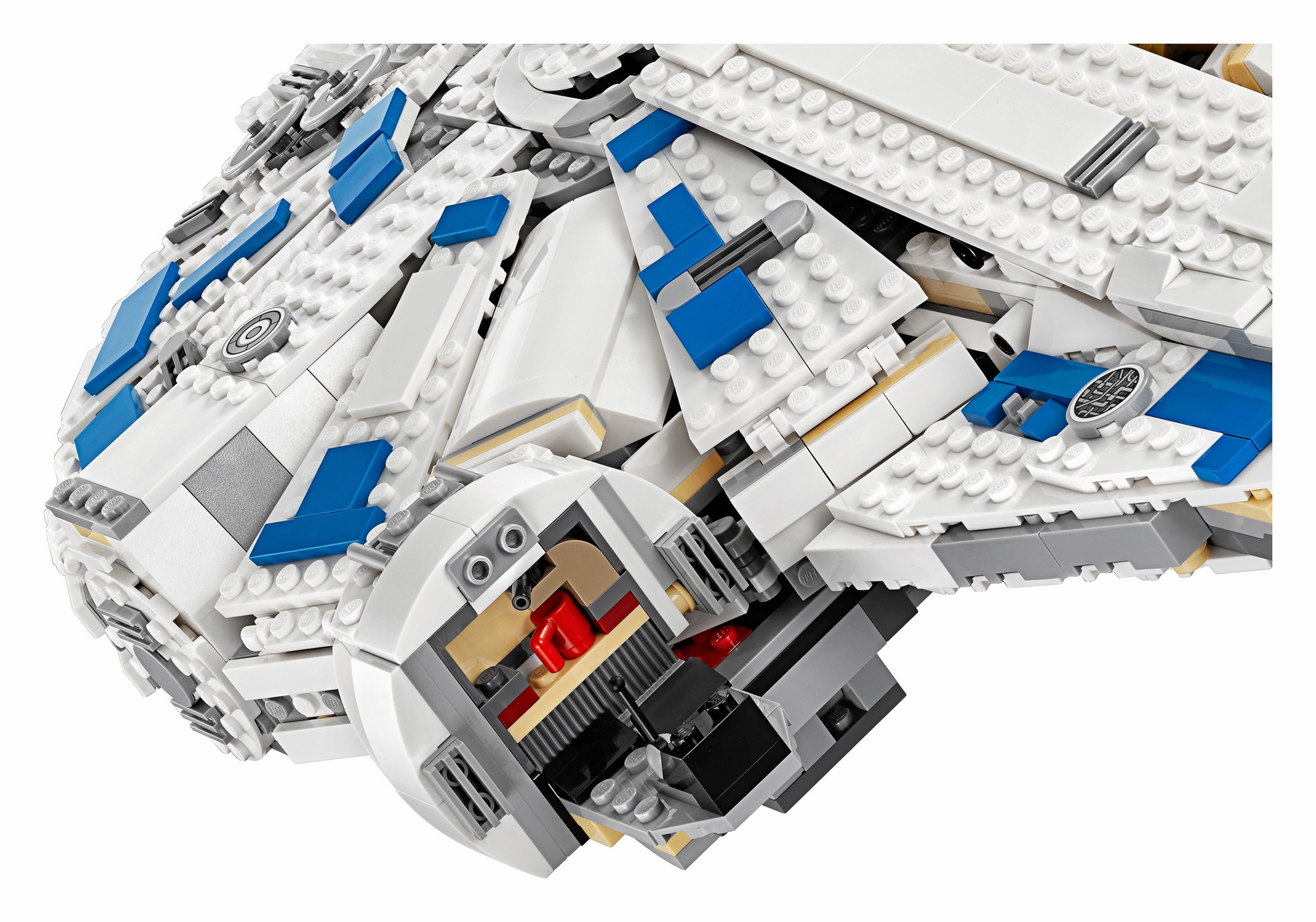

Sorry Sofa, Looks like you are going to have to redesign the interior again. The new images of the LEGO set show that the rear of the cockpit is just one big Mister Coffee!!!:lol
You don't make the Kessel Run without a big 'ol cup of Joe!!!
DANG IT! OK... I'll start over!
In the same Lego kit, Starkiller (who mentioned it last week) found that the blue and thicker armor plating DOES in fact fly away revealing the hunk of junk we all know and love! Someone ejects ALL the armor plating during the movie. Going to be so cool to see!

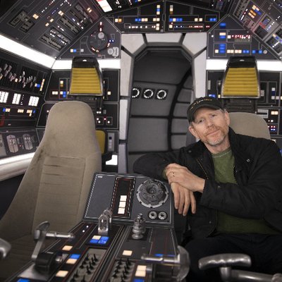

I'm going to hope when they lose the plating that the ship catches fire and all of the padded walls turn yellow from heat / smoke. Can't be much else to cause that unless the "sister ship" theory.
