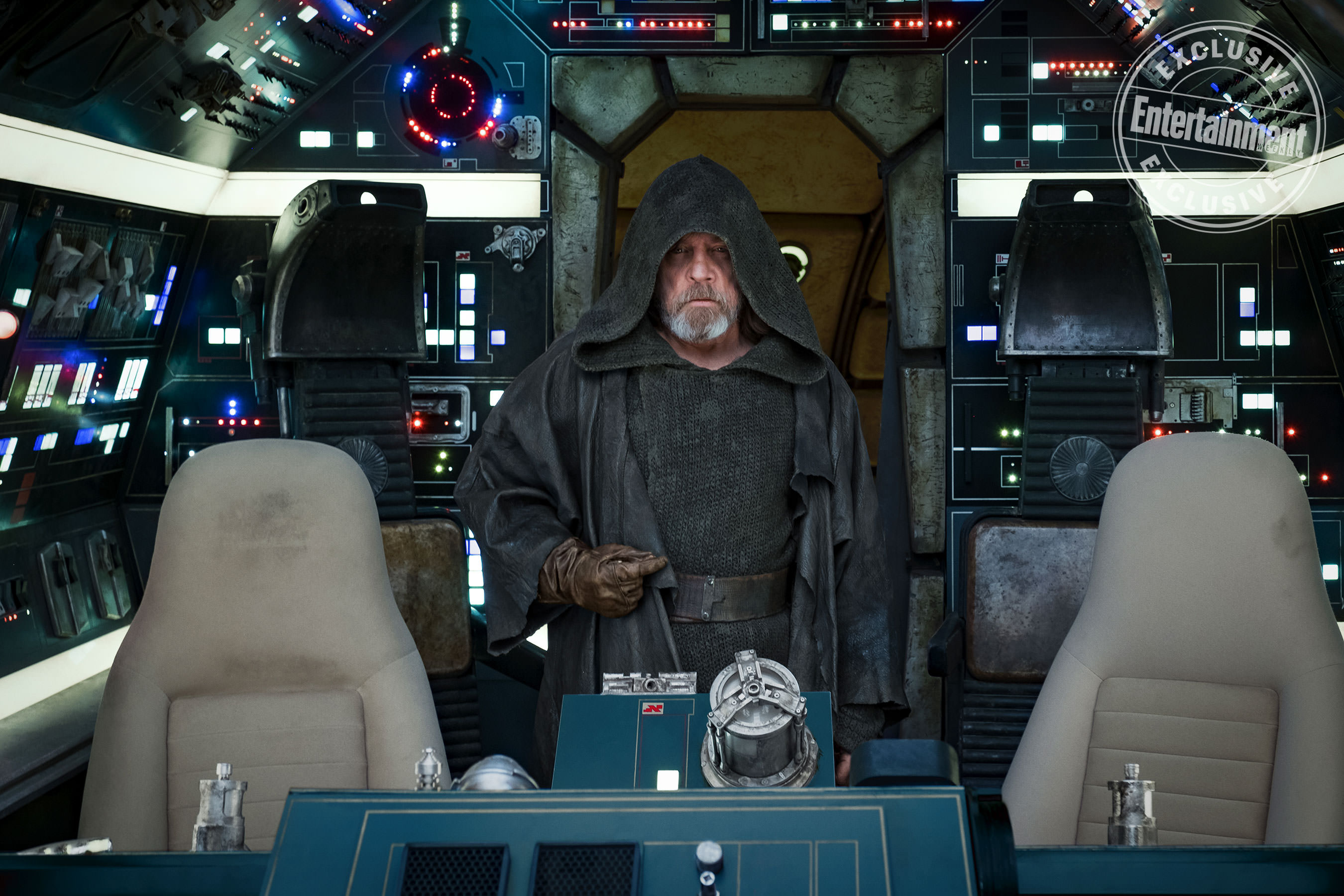

In the close-ups, there's a greeblie screwed into the pad, behind Luke. It looks like it presses into the surface.
Hey LtW,
Again... its just another mystery added to the increasing pile. I don't think we'll ever know the material used unless we talk to an actual person who was instrumental in their design and fabrication. Mostly... ;)
GREAT SHOT! It's amazing the color differences between the TFA/TLJ set and the OT sets.

Wow, I went back to see how long you have been working on the cockpit bulkhead and corridor. I didn't look at every page but a year ago this week the bulkhead was pretty sparse and you were cutting the rings. That's a big chunk of time for a relatively small area. Shows how much detail and thought has been put into something that's never been seen on screen.
Any nervousness on TLJ showing the bulkhead as completely different than your vision? Regardless of what it may look like (if it's ever shown) your design is brilliant and fits the ESB timeline perfectly.
Hi K,
Thanks so much! I'm sure you already know that the entrance is based very heavily on the TFA version. Once I finished the basic look of the entrance I stood back and thought it needed some ESB influence. So I decided to modify the TFA design using as many ESB related elements and greeblies as I could - taking design cues from various screen grabs and of course having fun with artistic liberty.
WOW I can't believe its already been a year since I started work on the corridor ring! With that, the basic build is just me. From design to laser cutting to primer and paint to mounting... its mostly been me. I get help from time to time but people have lives and their own projects so I get and certainly appreciate the help when it comes. :)
There is no real nervousness for TLJ entrance. TFA proved there were a LOT of changes in the 30 yrs since RotJ. Unless it's a lighting issue, the TLJ cockpit appears to have changed the white 1" square tiles to yellow. So it will be interesting to see what other changes were made. However, since my version is based on the never before seen ESB version I'm actually more worried what the designers did for the upcoming "Solo" movie. I have no doubt the MF will play a significant role and we're going to see areas of the ship yet to appear on screen. My thought is the entrance will be cleaner looking than TFA only with more greeblies and less hoses.
But the biggest visual change we've seen is the ANH version to ESB. So either way I think we'll be ok. I just want see her on screen again ;)

Hey Sofa.
Have just seen this pic on Pinterest. Have you seen it before? Is it a replica or one of the originals?

Hey Sofa.
Steve
https://uploads.tapatalk-cdn.com/20171121/4fcd9efbd4103fc474bf735c65ad0721.jpg
Sent from my iPad using Tapatalk
Hi S,
Great photo! I was going to post that Stormy is the resident Nav Chair expert. Low and behold. ;)
That tupperware lid definitely doesn't seem to be just straight black ...
