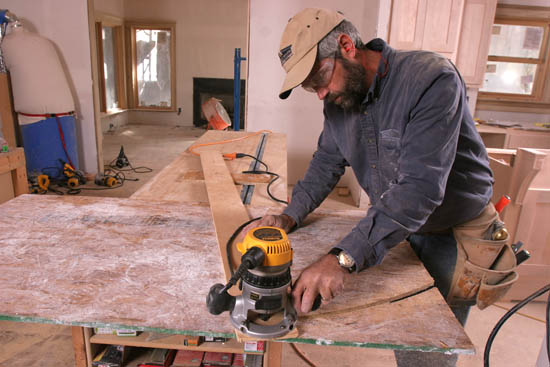

I too hate jigsaw cuts like those you're dealing with, but I have a solution! Did you know that you can cut curves with a circular saw? For curves this size, you can even do it with a regular blade, and for the number of curves you're cutting, the setup will be worth it, plus the laser will made it a lot simpler. You need to build a TRAMMEL. A honkin' big one. Here's a random pic I found on the internet that shows the idea with a router, but with the laser you could make yourself several "business end" attachments - one for a router, one for a circular saw, and one for a jigsaw.
It's a stick. You've got a series of holes for different radii (so you could laser cut and label them "hallway wall - outside radius" and "hallway wall - inside radius", for example), then your business end has some attachment for the saw, jigsaw, and router that puts all of their cutting edges at the same point. When using the circular saw, the only real trick is to make sure your blade depth is only just deep enough to get through the material, and that your centerpoint is connected to the piece you're cutting so it doesn't shift.
And to show I know what I'm talking about from experience, this is a 1.5" thick hardwood bar top and that curve on the left was done with a regular ol' circular saw on a homemade 9' trammel.

I didn't realize how angled the corridor frame edges were until I got them all aligned and in place. The jig saw is a wonderful tool but not for edges as long as these panels. It was ugly and there was no alibi to save them!
I've seen those trammels in action! VERY VERY COOL! One wouldn't think you could do a circular cut with a regular circular saw. I think the path forward for this last panel is to use the cockpit entrance frame piece as the template and use the router with a tracer bit. The entrance frame is near perfect. I might redo the other corridor frames as well. All depends how this new frame turns out.
As I mentioned I've gone through 4 bits (1 bit shattered and 3 bearings exploded). But, this latest bit has held up pretty well so fingers crossed!
I think the path forward for this last panel is to use the cockpit entrance frame piece as the template and use the router with a tracer bit. ... As I mentioned I've gone through 4 bits (1 bit shattered and 3 bearings exploded). But, this latest bit has held up pretty well so fingers crossed!
Yeah, the whole "curve with a circular saw" thing is pretty hard to wrap your brain around until you do it, then you go, "Huh. That was easy."
One thing I've found that helps tracer bits last is to make sure you give them as little work to do as possible - in this case, trace your line, then rough cut (you can even freehand it with a circular saw) about 1/8"-1/4" away from the line, so when you trace your pattern you're only cutting 1/4" or so, max. You might already be doing this, but in case that tip helps someone with their project... there it is.

I found that cutting anything 3/4" or deeper should be done with two passes. That way there isn't as much stress on the bit. However, in all my years I've never seen bearings fail within 2/3 minutes after turning on the router
