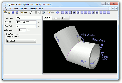

I still remind you that the corridor is angled to the cockpit... ;)
And a non-perpendicular miter joint of two tubes is not trivial

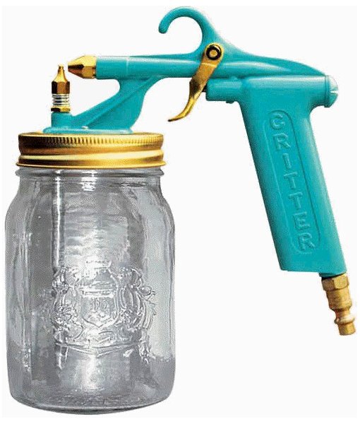

You could probably get away with a Critter gun. Relatively inexpensive, easy to clean.
Hey D,
I've got a Harbor Freight gun that I used on the quad laser. It worked really well and I didn't have any issues at all. So long as you keep it clean... should be fine. :)
